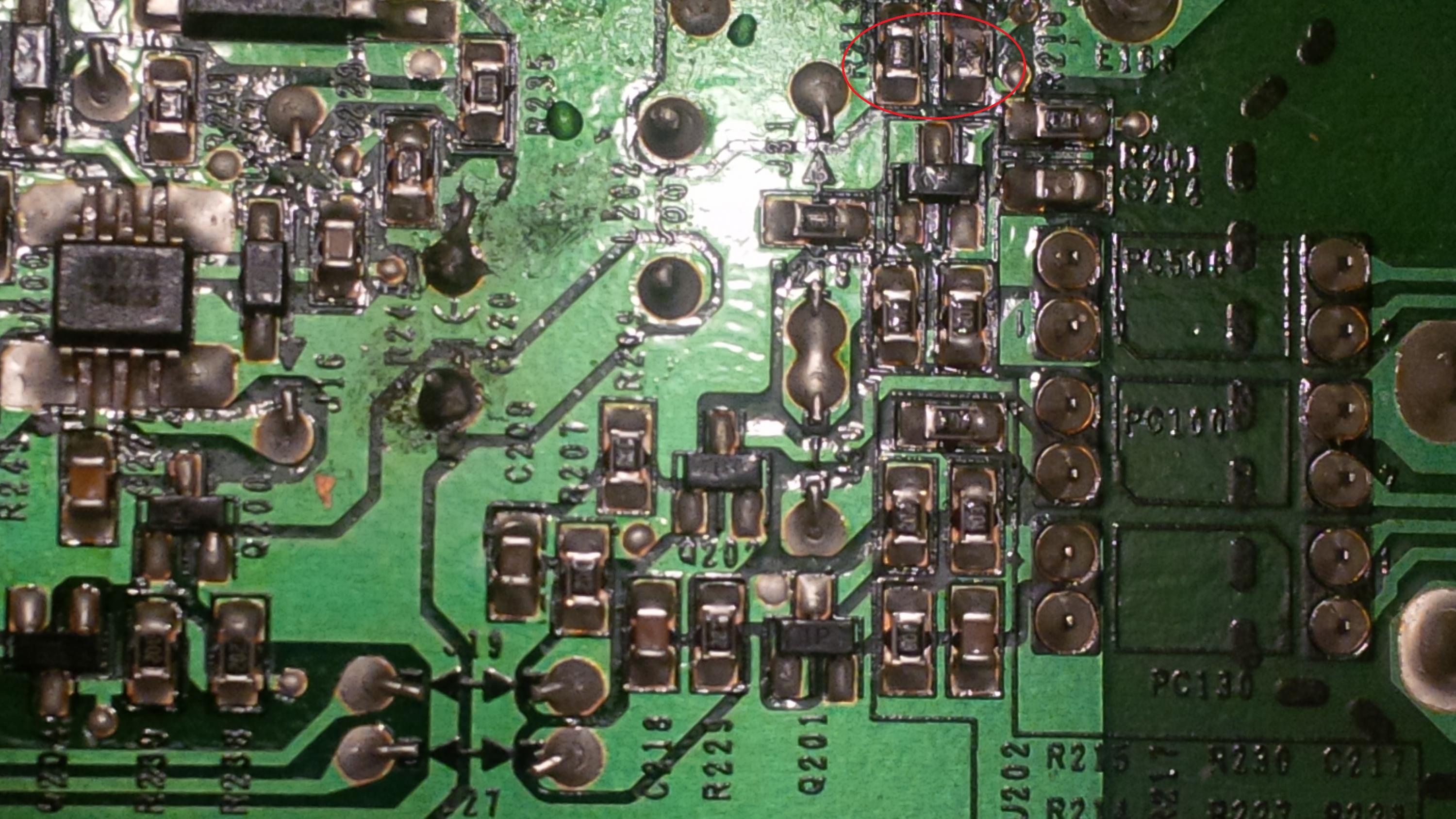

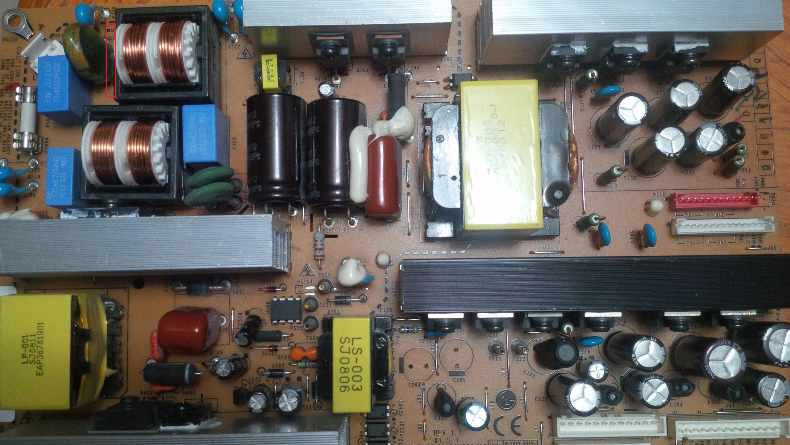

    Hi everyone - I was hoping that someone with an LG 37" (or thereabouts) with a EAX31845201/13 (Rev 1.2) PS board could verify a few values. I have countless schematics and have searched many posts, etc. and can't seem to find the matching schematic precisely.

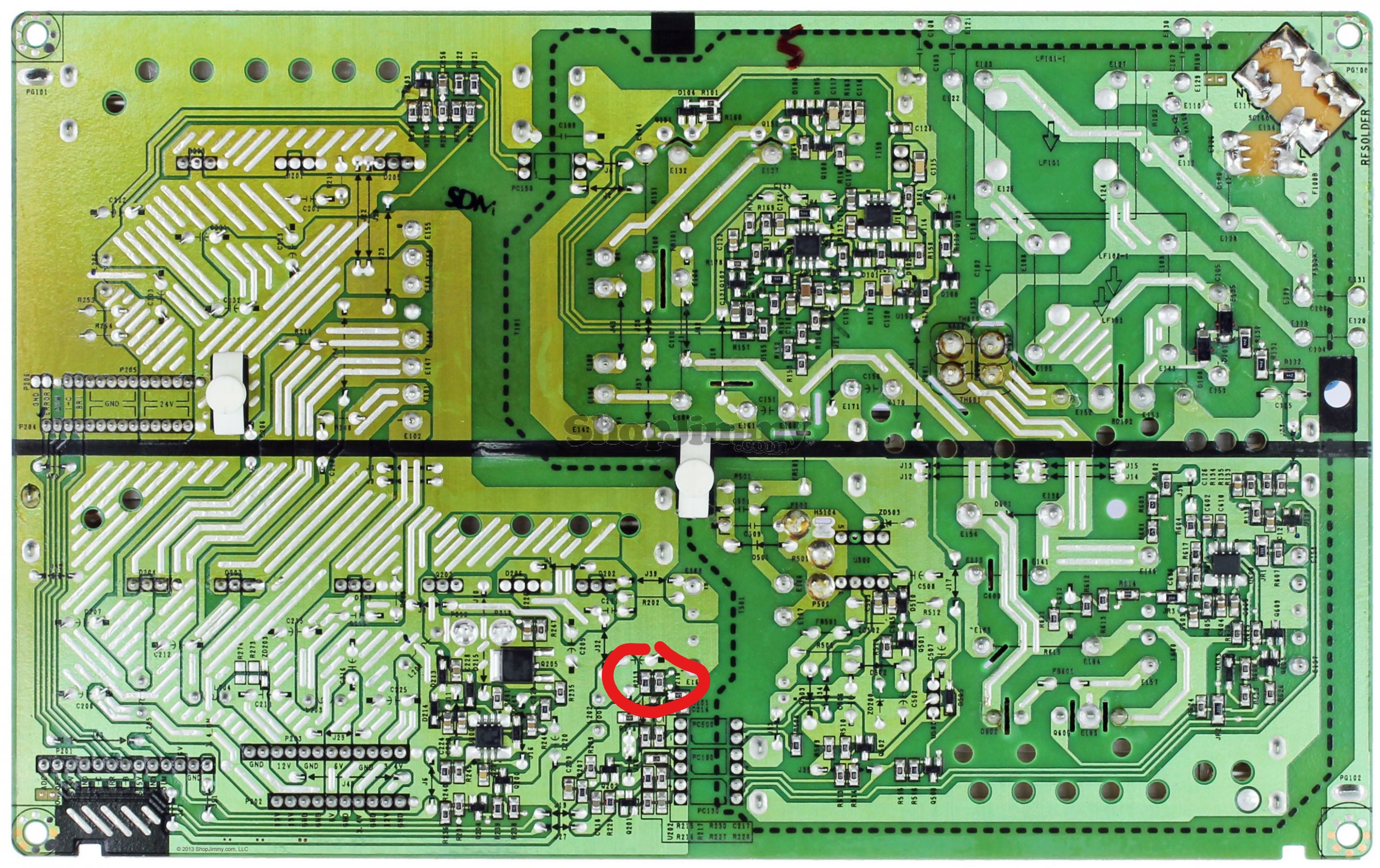

    R102 (it looks like maybe a 1/4 - 1W and based on what I've read/learned it sounds like it would be in the 1M range) - Can anyone help here?

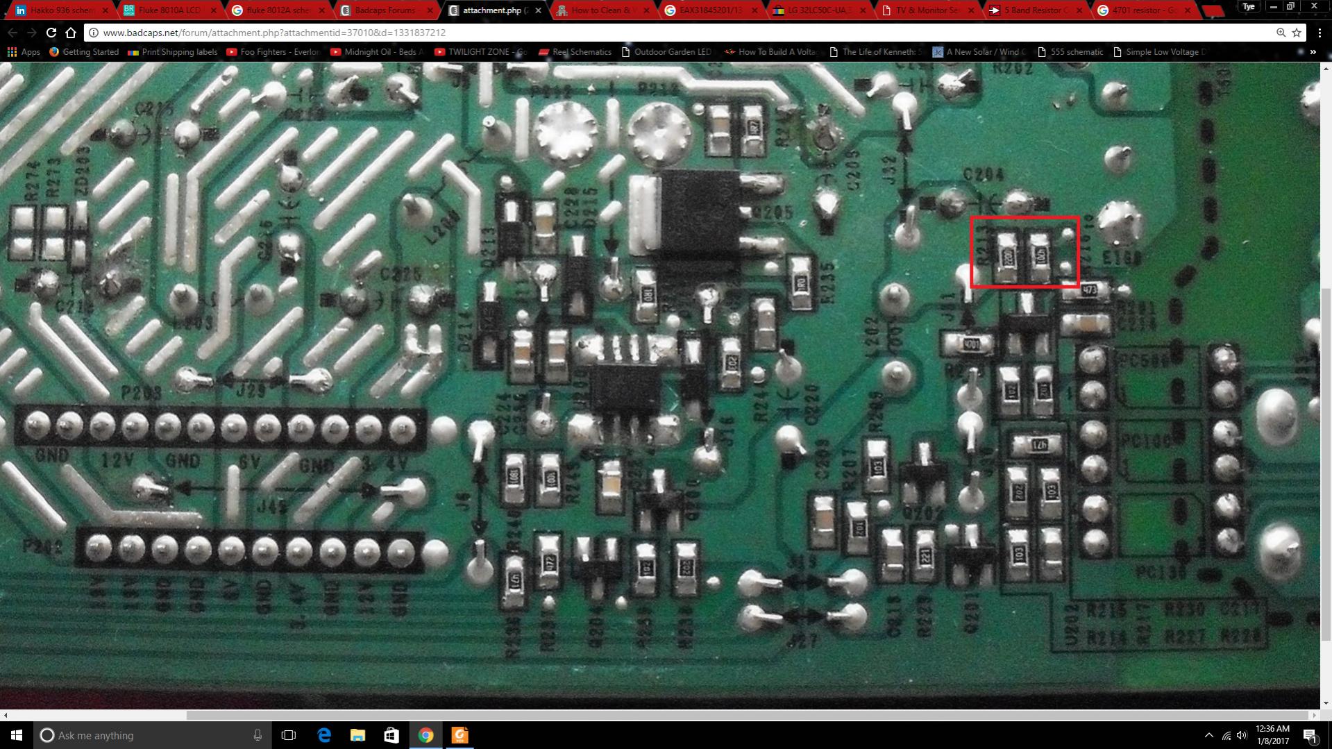

    Excuse the terrible pics of the other side (missing pad, flux, bad lighting)... Does anyone have the R213 and R216 SMD values?
    If you have the same board and follow from R202 straight down, you will see two SMD resistors in parallel (just below the +leg of C204). Those are the ones I need to verify if possible.
    Thanks for any help and sorry for the crappy photos - camera isn't charged so I had to use my cell.
    Thanks!

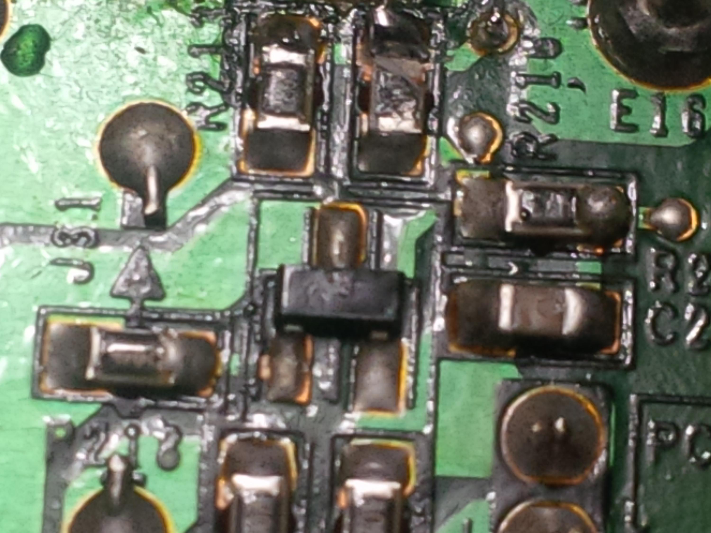

      The model number is 37LC5DC and no I can't read the numbers coded on the smd resistors. I even tried with my optical microscope. The board was victim to a lightning strike/bad power bad protection so the R216 was blown right in half (if you look closely) and the other side is charred too much to read. The board is actually is pretty good shape for the few kv that likely hit it.... I'll see if I can clean it with some iso and look through the scope again....
      clear as day now... used some lesser-than-top-shelf vodka as the iso was in the shop....
      R213 is a 2200 .... R216 is blown to bits...
      is it as simple as this: 220Ohm(2200) I feel a little foolish.... as I never thought it would be so easily cleanable....

        I managed to find the value for R216. It is a 4701 or 4.7k.

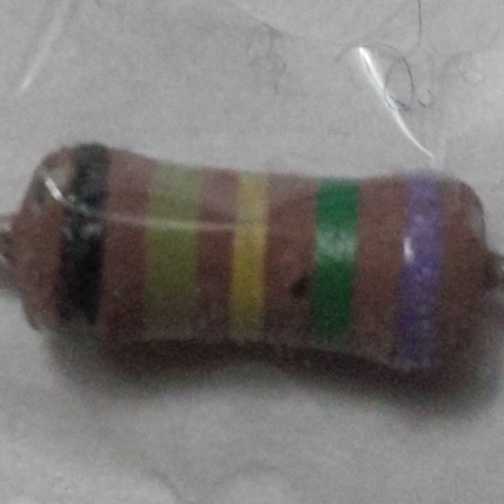

                  Ok, I found it on a picture of another board on the net. It is going to need a 1 watt. It was hard to tell exactly what color the bands are on the resistor, so a pic if possible would be good.
                    Re: LG LCD 37" EAY3306450/EAX31845201/13 (Rev 1.2) - please verify a few component va
                    pardon the lint/pet hair under the tape..

                        R102 = 750K, 1 watt 5%
