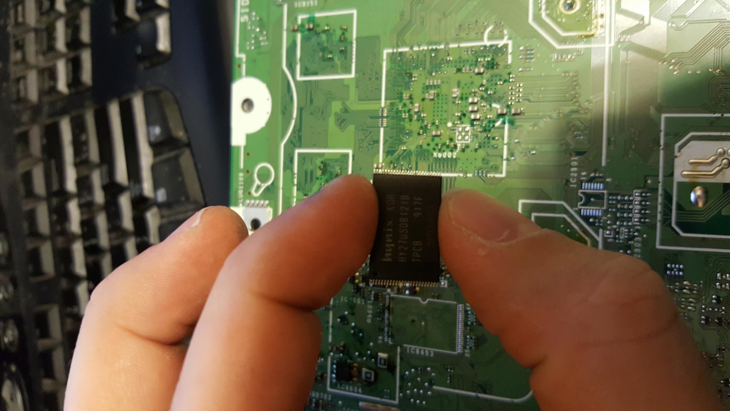

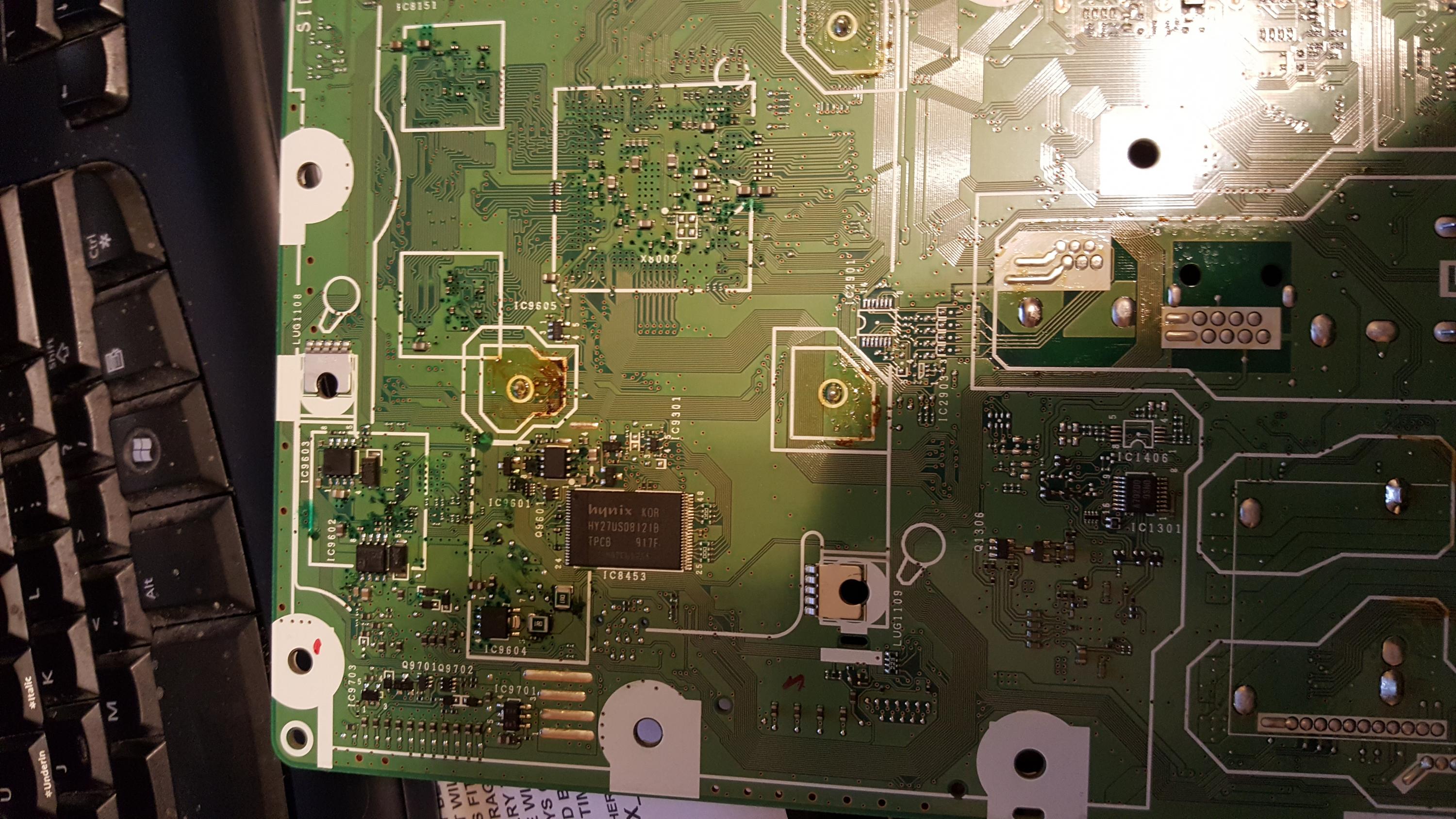

    i promised myself if i made this work i would share it with you all and it did so here it goes.
    finding the right board number may be easy but matching your software numbers are not always available. it can be pretty frustrating so after checking out the service manual and finally locating the program IC i was able to pull the IC from the old board and place in into my new board. this is IC8453. its on the bottom side of the board under the metal casing. attached pictures as well. easiest way to remove is just some hot air take your time dont heat it too fast or too long. then clean the paths on your new board and solder/flux away. check connections with a 10x loupe and your all set.
    models included with this board number are
    LC-46E77UN
    LC-46SB57UN
    LC-52E77UN
    LC-52SB57UN
    LC-C4677UN
    LC-C5277UN
    LC-52D85UN
    The board i had was damaged due to a surge and was a DUNTKE833FM11 but the only board i could find out there was a DUNTKE833FM07. set is working great now. hope this helps someone out there.
