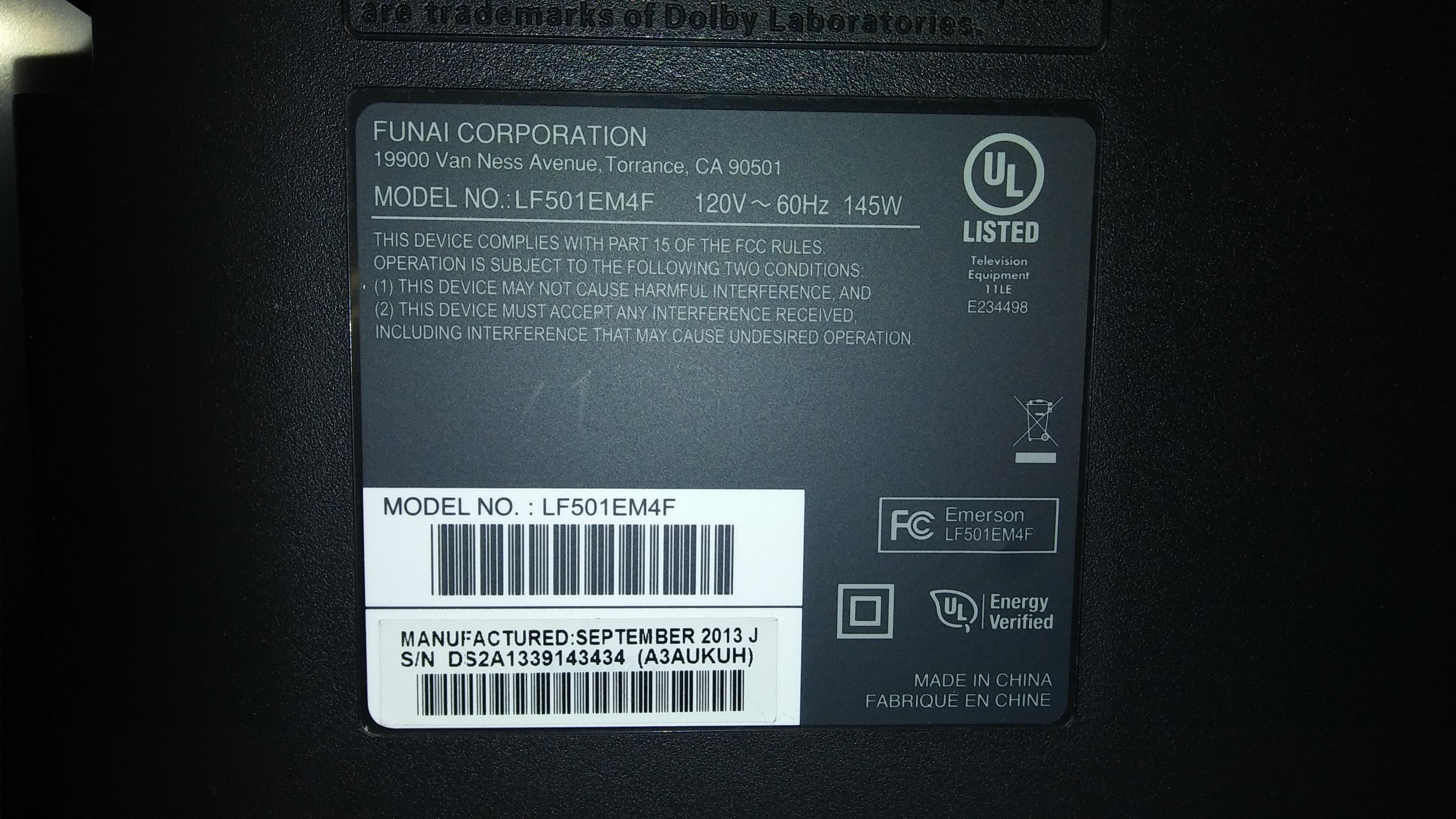

Emerson 50' LF501EM4F

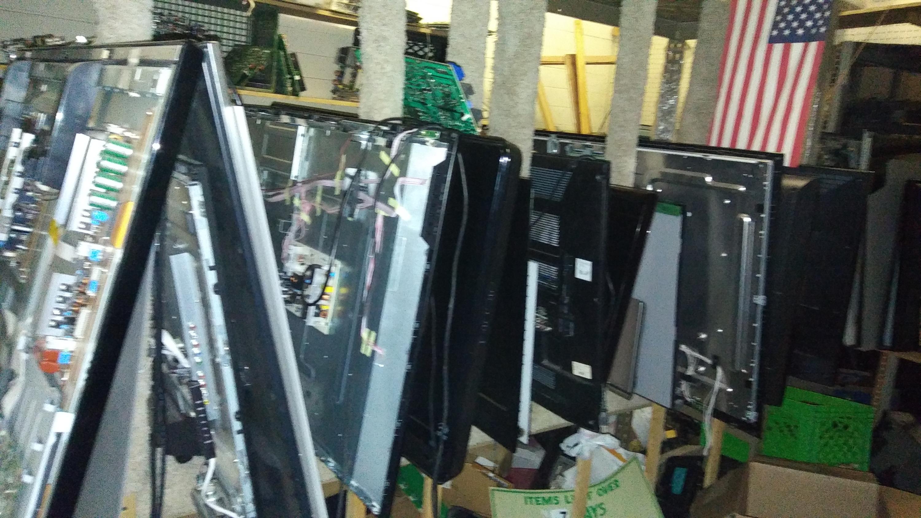

      and this is my First Priority shelf of TV...Sorry about the mess....I can't even walk in this place.....

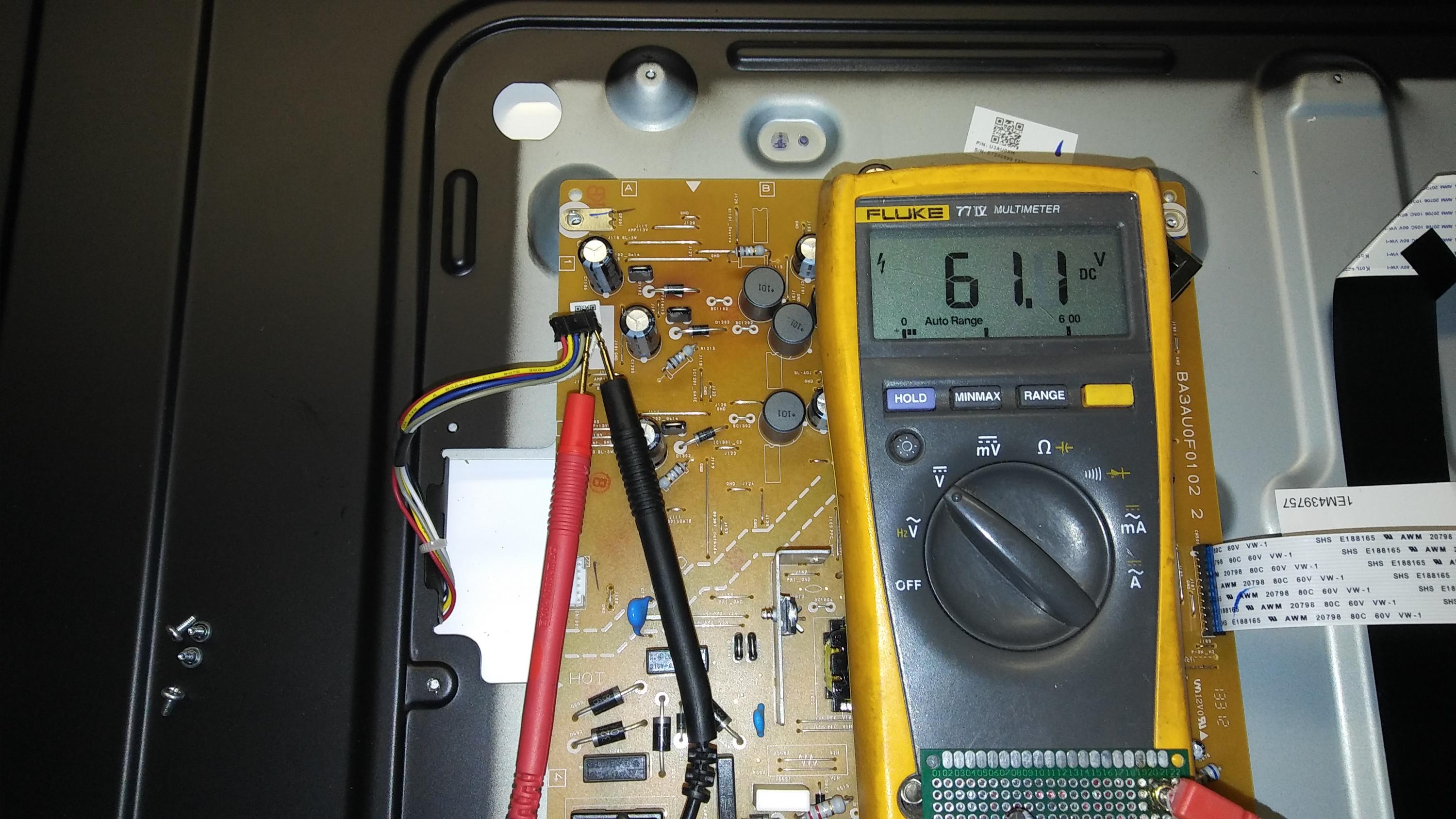

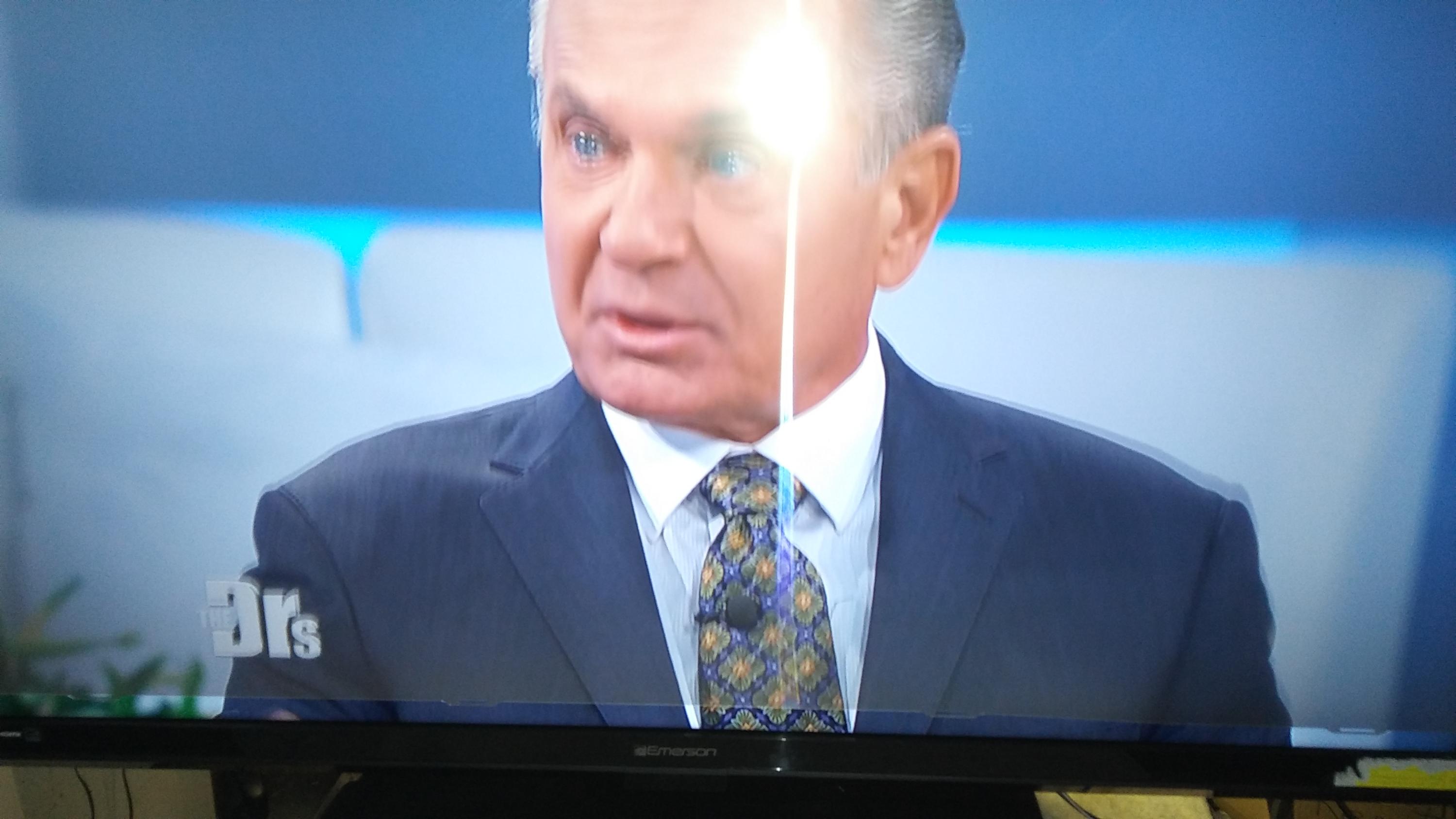

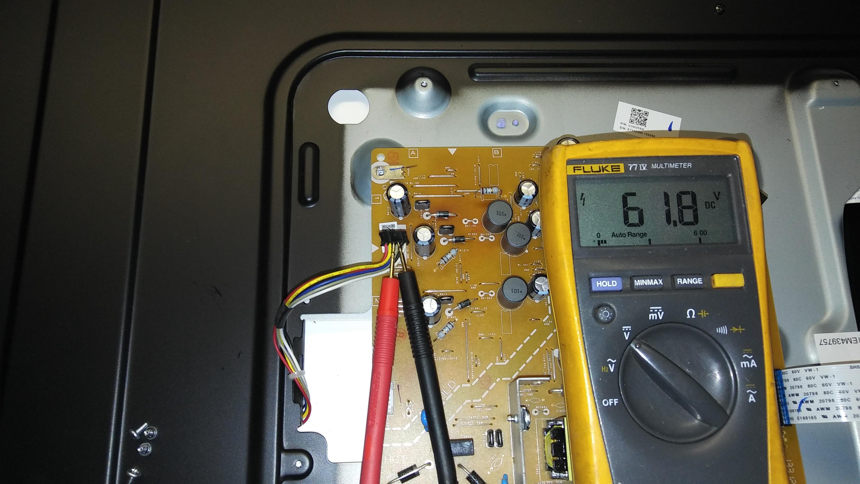

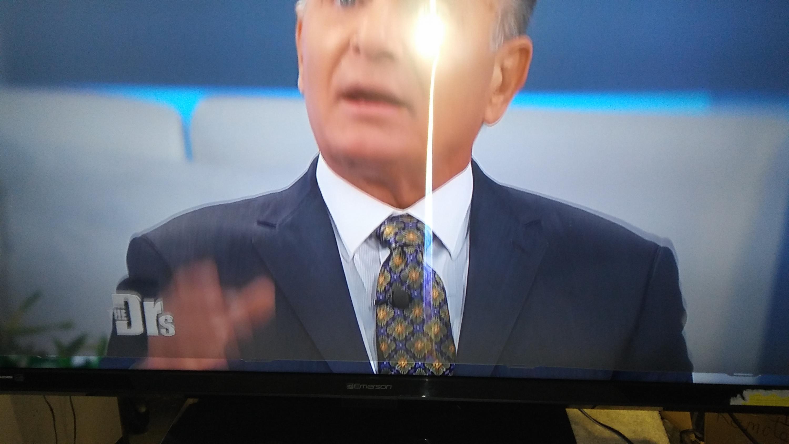

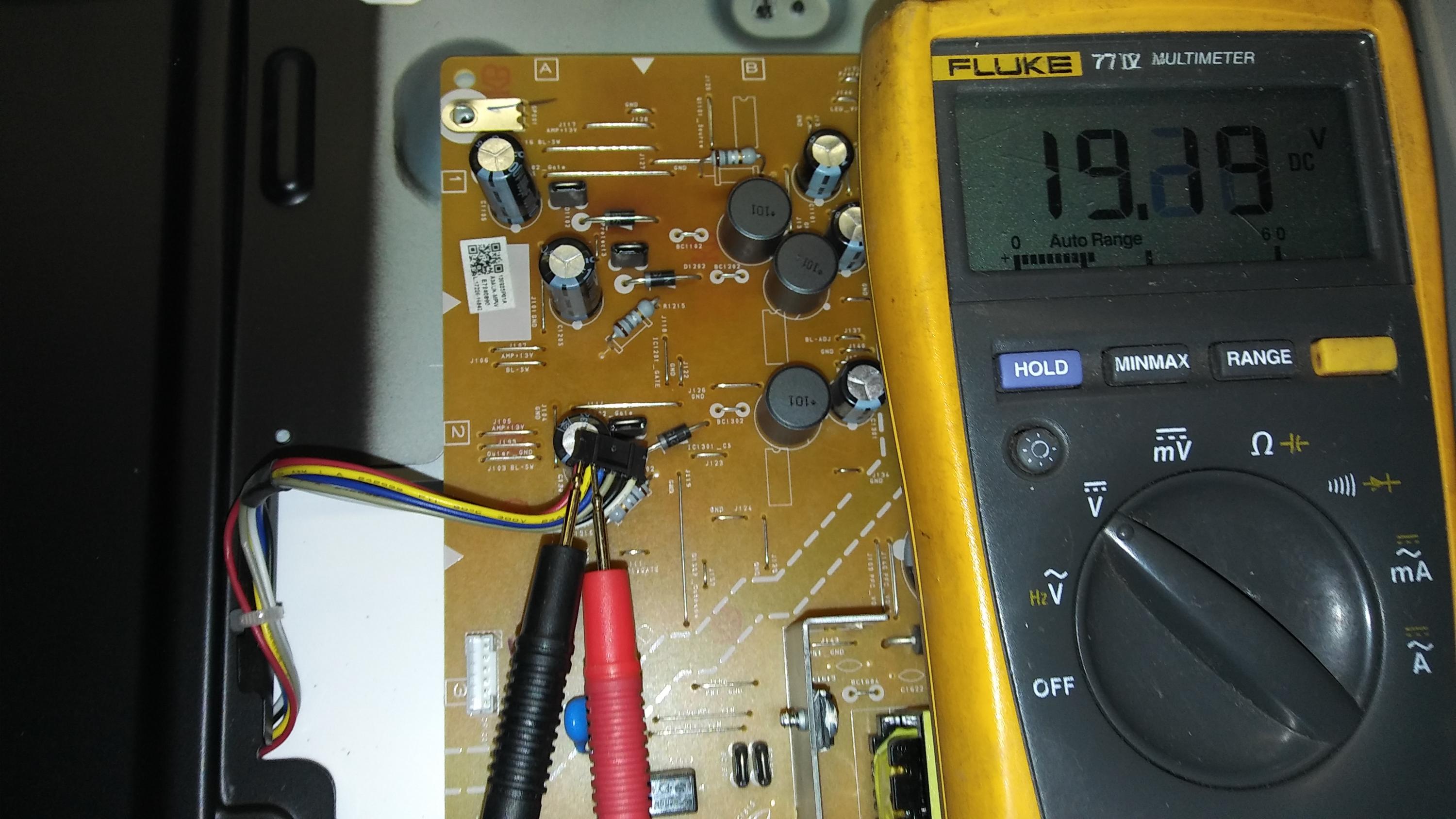

        OK, Let's go. First, my guess is the LED screen?... Unfortunately in TV repair business is no guess!
        Within 10 seconds ( with my poorman led tester), I knew problem is not the LCD screen....

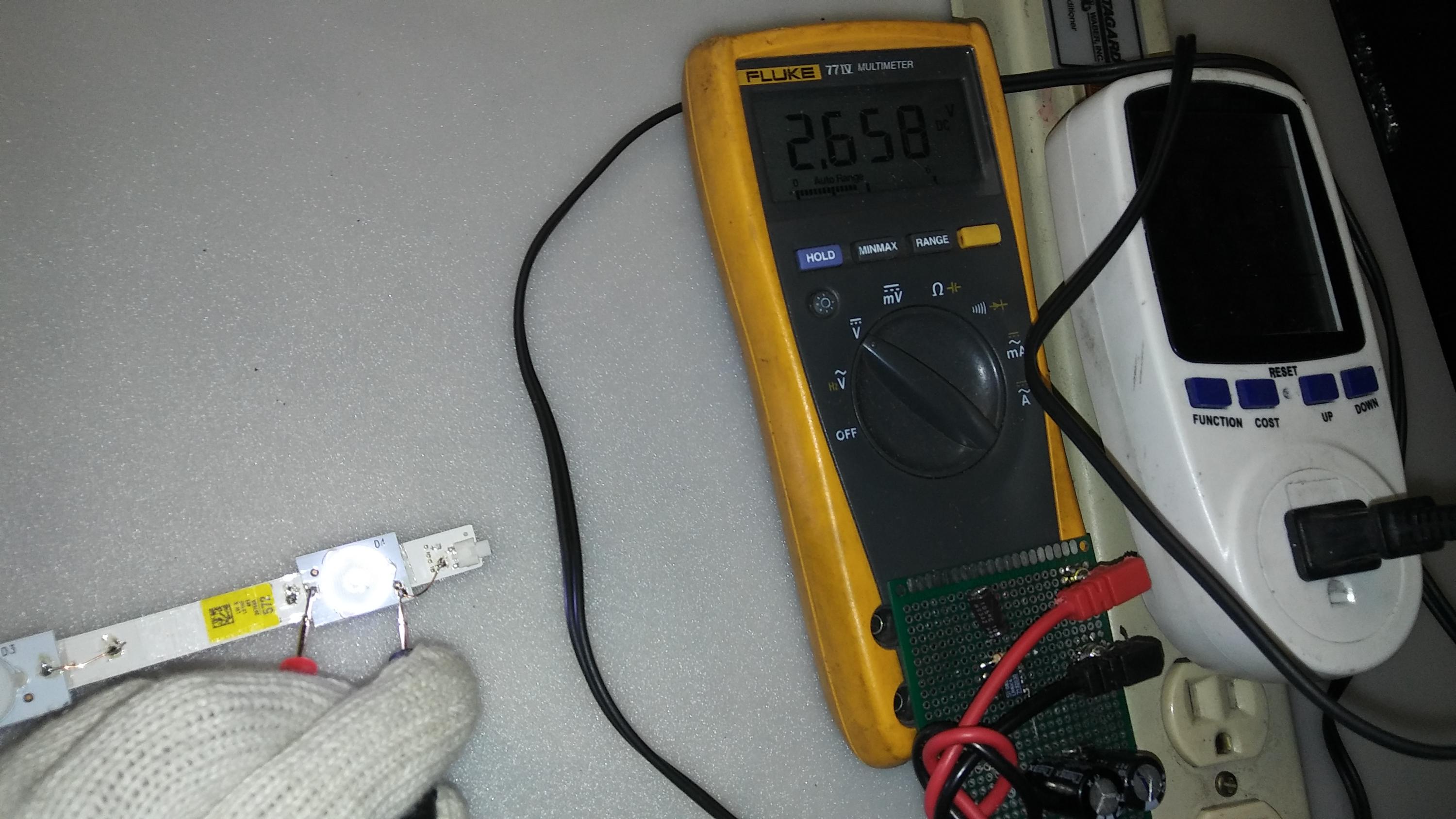

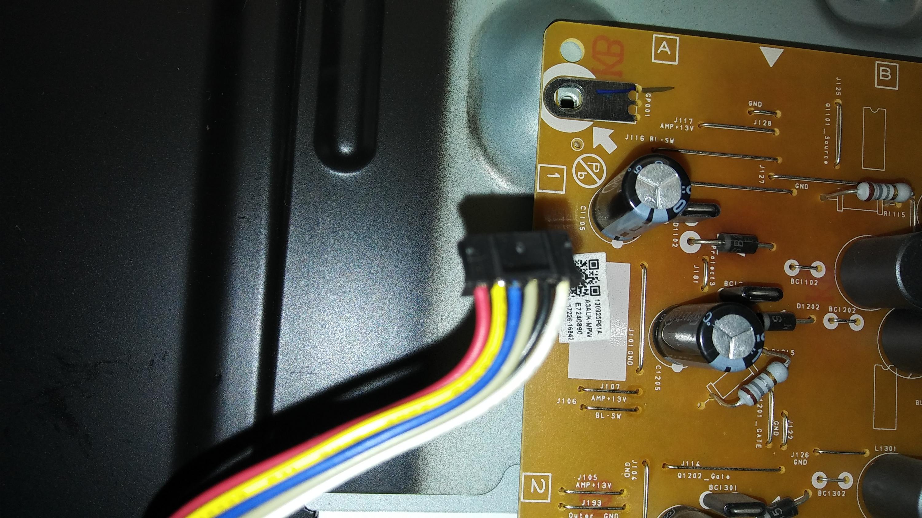

        pic2: 19.6v ..... 19.6v / 0.8v(diode reverse votage) = 24.5( diodes in series) so, I need to reverse the test lids.

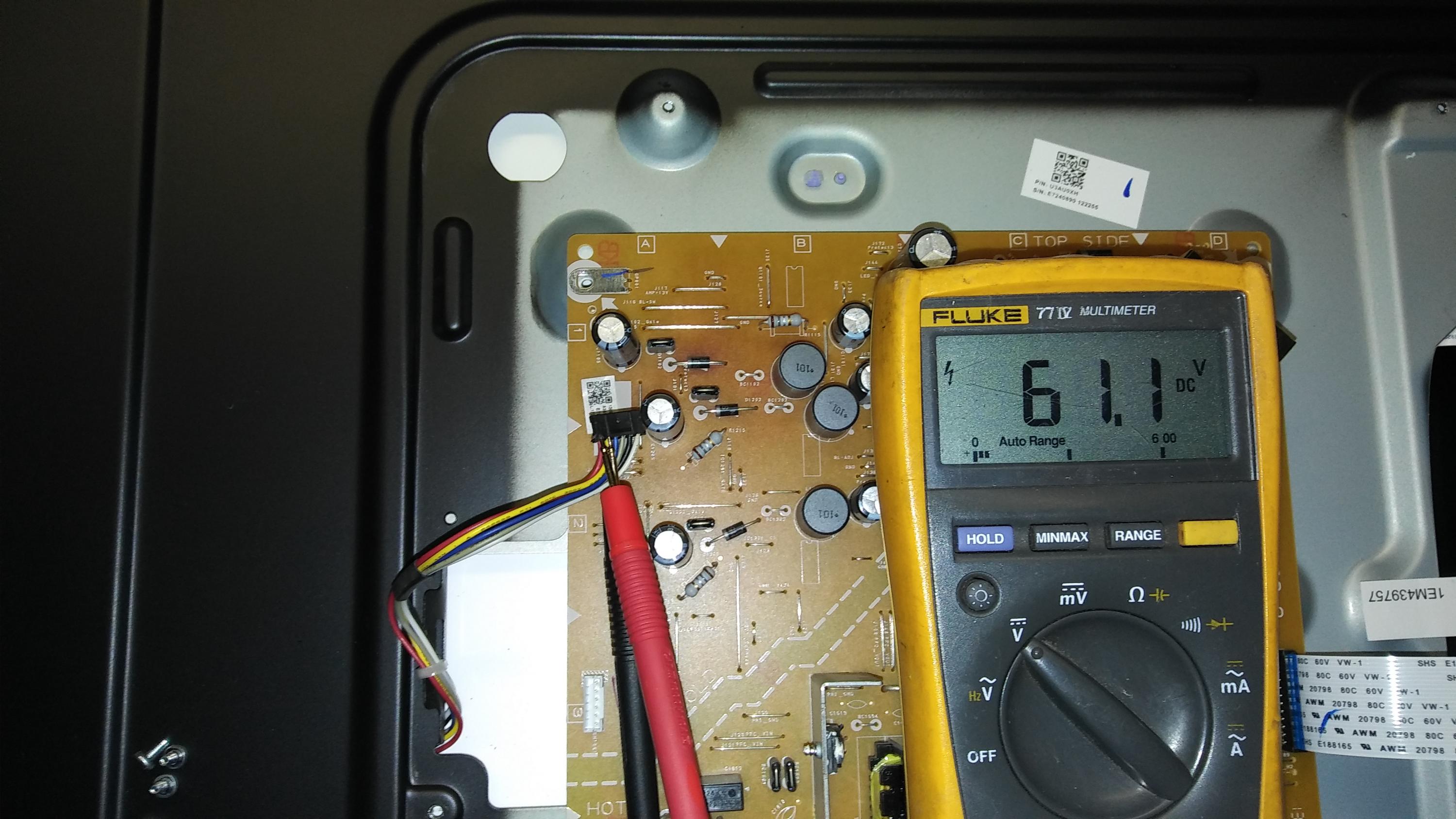

        pic3: 61.1v /2.65v (this tester with 1 TV LED show 2.65v at pic7) = 23.05 LEDs (in this circuit loop).

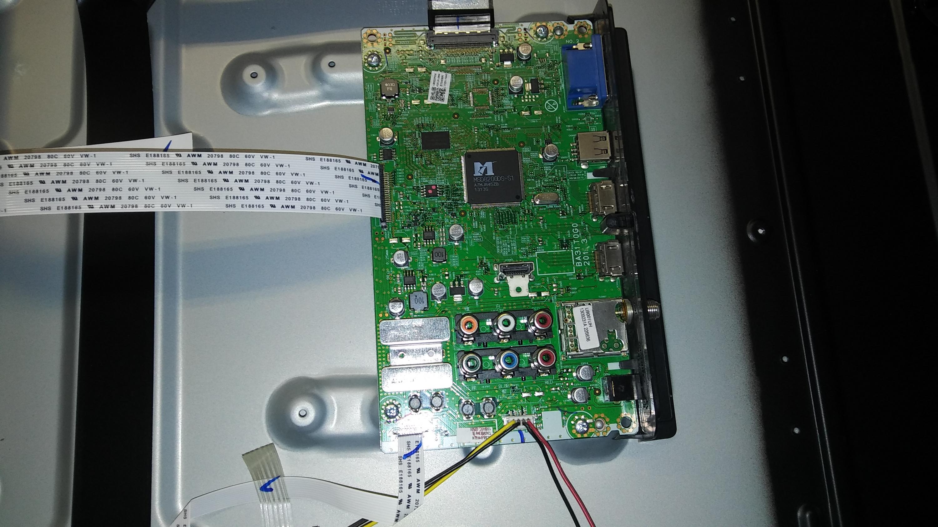

        pic4: 61.8v /2.65v (this tester with 1 LED show 2.65v) = 23.32 LEDs (in this circuit loop).
        pic5: 61.1v /2.65v (this tester on 1 LED show 2.65v) = 23.05 LEDs (in this circuit loop).
        The good LED screen has 23+23+23=69 LEDs and 3 loops each 23 LEDs
        I need to hunting the other problem!!!
        PS: Poorman's LED TV Backlight Tester.

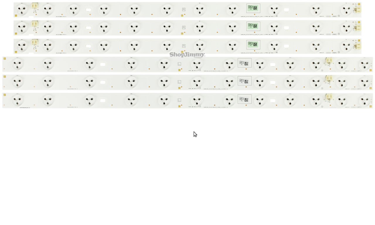

          Yes Im right, I never open the LED screen, and I do not need to... ... look Over shopJimmy:
          http://www.shopjimmy.com/emerson-v50...s-6-strips.htm
          Emerson V500HJ1-P01 LED Strips - 6 Strips
          PS:The LED screen has 23+23+23=69 LEDs and 3 loops each 23 LEDs, each loop has 2 strips....

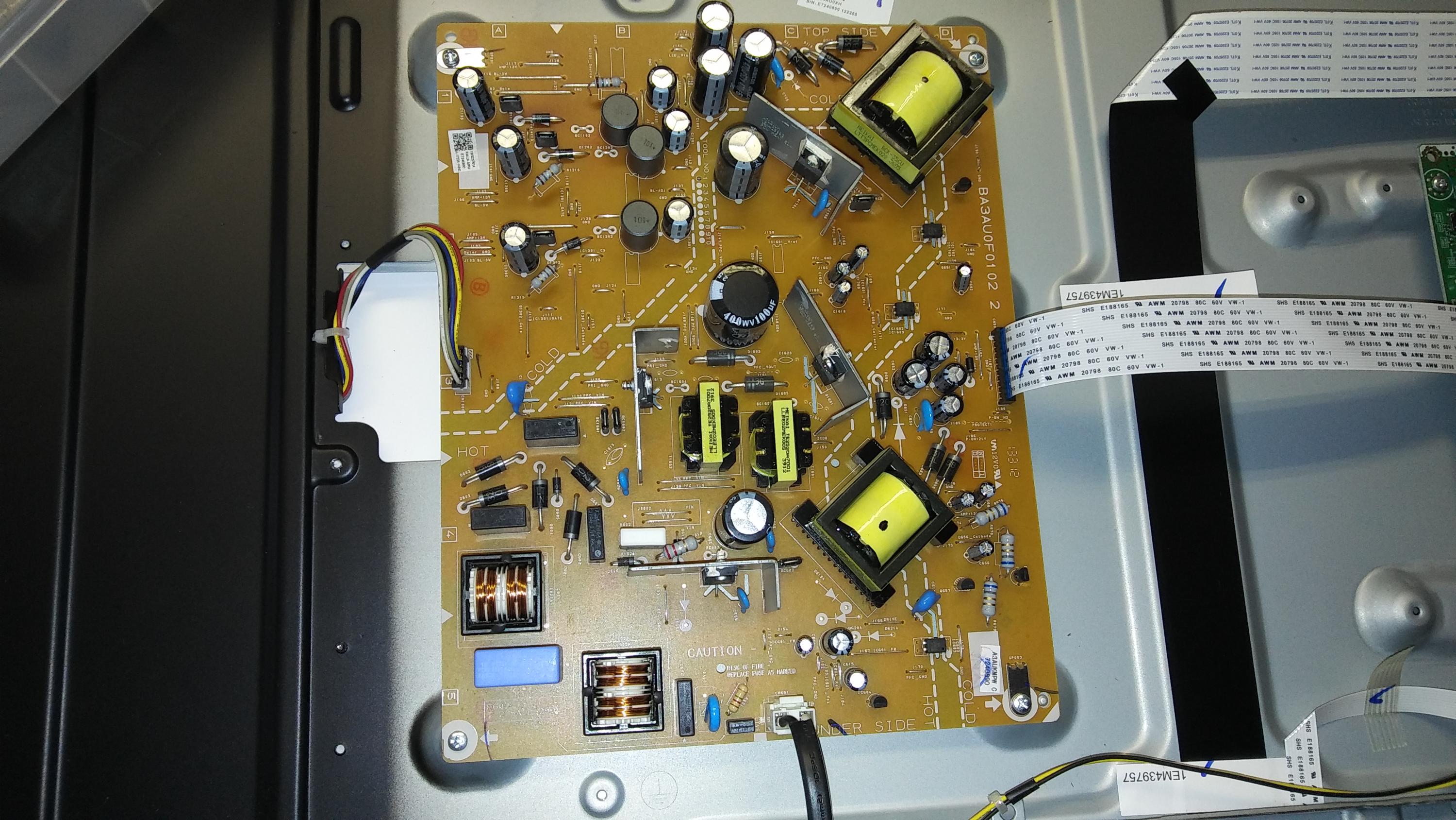

            I prepare to troubleshooting.........
            Emerson 50' LF501EM4F service manual:

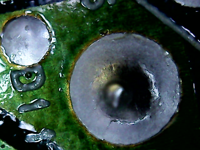

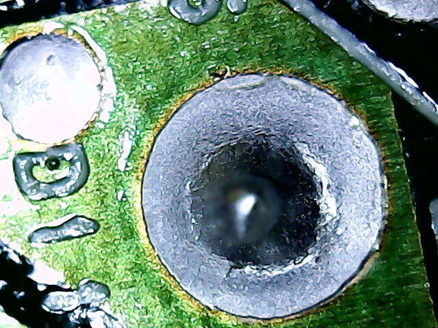

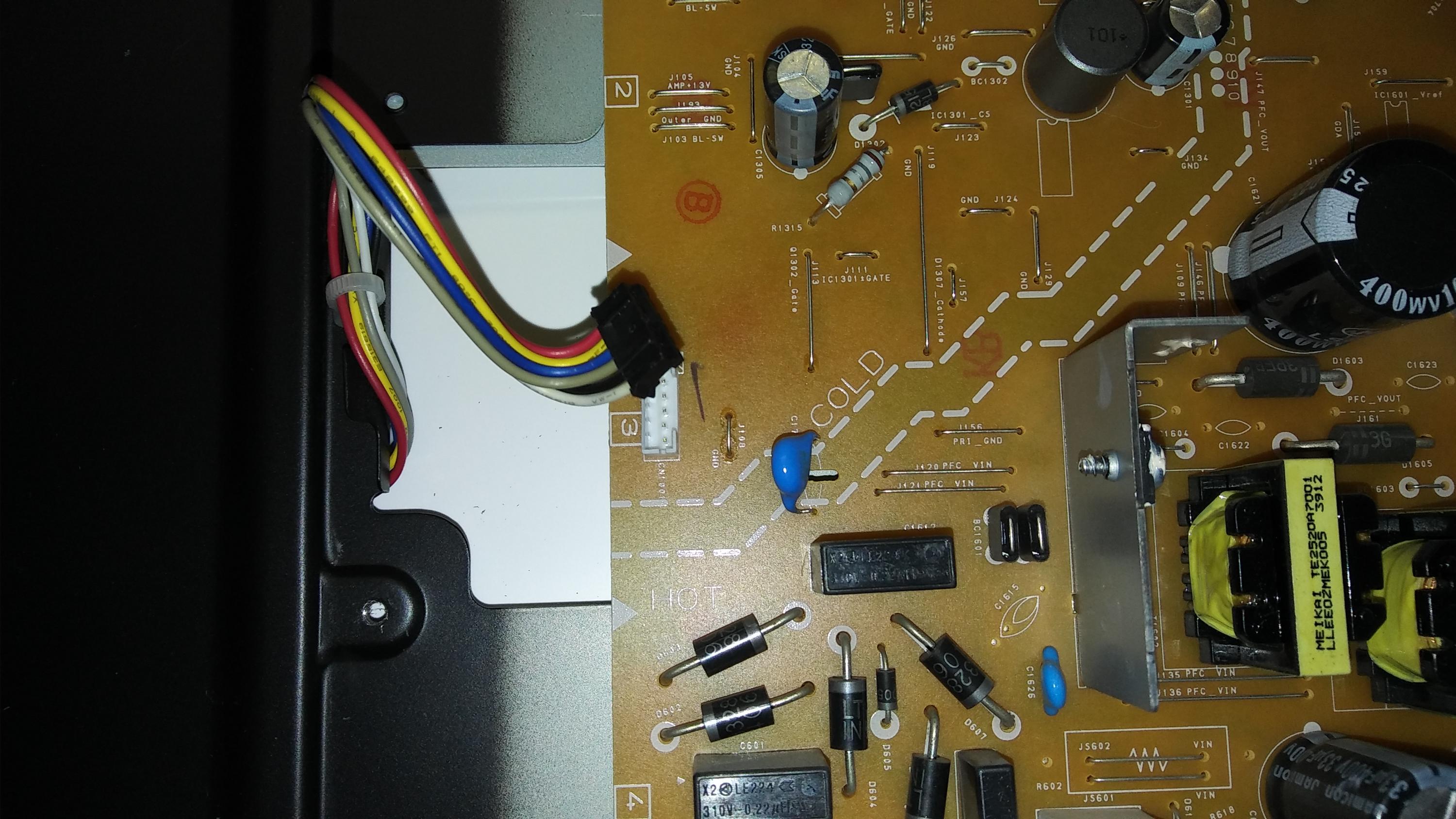

            Found bad connection at d1102

            I was about to give up on this but I think I found the problem. I have this power board and no TV to test it in because someone sent it to me hoping I could fix it. Board number BA3AU0F0102_2. I wasn't sure if the board was bad but I read this whole thread and it didn't help me much on this issue but I finally found D614 to be shorted. I have another board I am going to swap out the diode from but I will need to buy some new ones. I can not tell what this diode is. It is only marked "BR"
            I also suspect IC601 which I found to be FA5640 Switching Power Supply Control.
