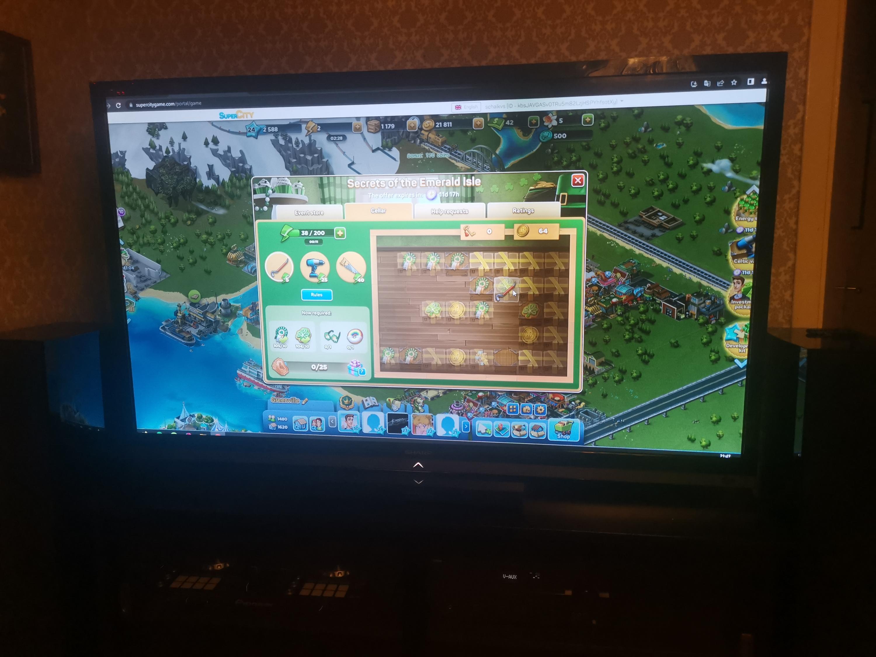

    I ended up with removing the whole tab chip on the right side from watching pov, worked like magic
    Still has a dark spot upper right but i dont know if there is something more that can be done with it
