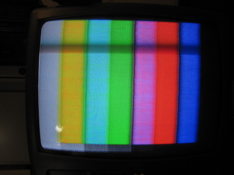

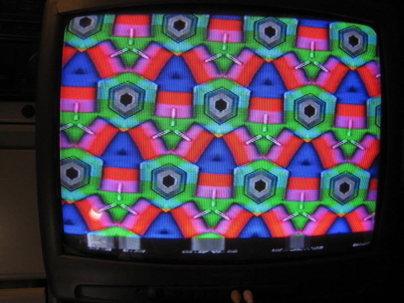

    I have a cheapo, probably not-worth-to-fix Funai mechanism (Magnavox MWD2206) VCR-DVD combo. When I play back prerecorded VHS tapes, the top ~ 7/8 of the screen looks fine, but the bottom 1/8 is messed up. The bottom 1/8 has no color, and looks like 2/3 of that 1/8 is streaking the bottom most line that does have color (luminance only, no chroma, so it looks like bars) and the bottom most 1/3 looks like it's showing the right luminance for the remainder of the frame, but very noisy and once again no chroma.)
    Other than this it seems to play back almost fine though it occasionally tracks funny.
    Recording seems to work but playing back its own recordings show this same behavior, and playing in other VCRs "works" if it has auto tracking but if you cue/review during play, it's completely messed up.
    I think that for some reason the sync timing is off between the head motor and capstan, but wonder if anyone has seen something like this before?

    Two sample images that I recorded on another VCR that I deemed "working"... yes this is the CRT TV I dropped. And no, the problem is not the TV, only this VCR seems to be generating this weirdness on the bottom... The crack in the plastic from the drop can be barely seen on the upper left of the TV...
    https://www.badcaps.net/forum/attach...1&d=1481959135
    Weird eh?
