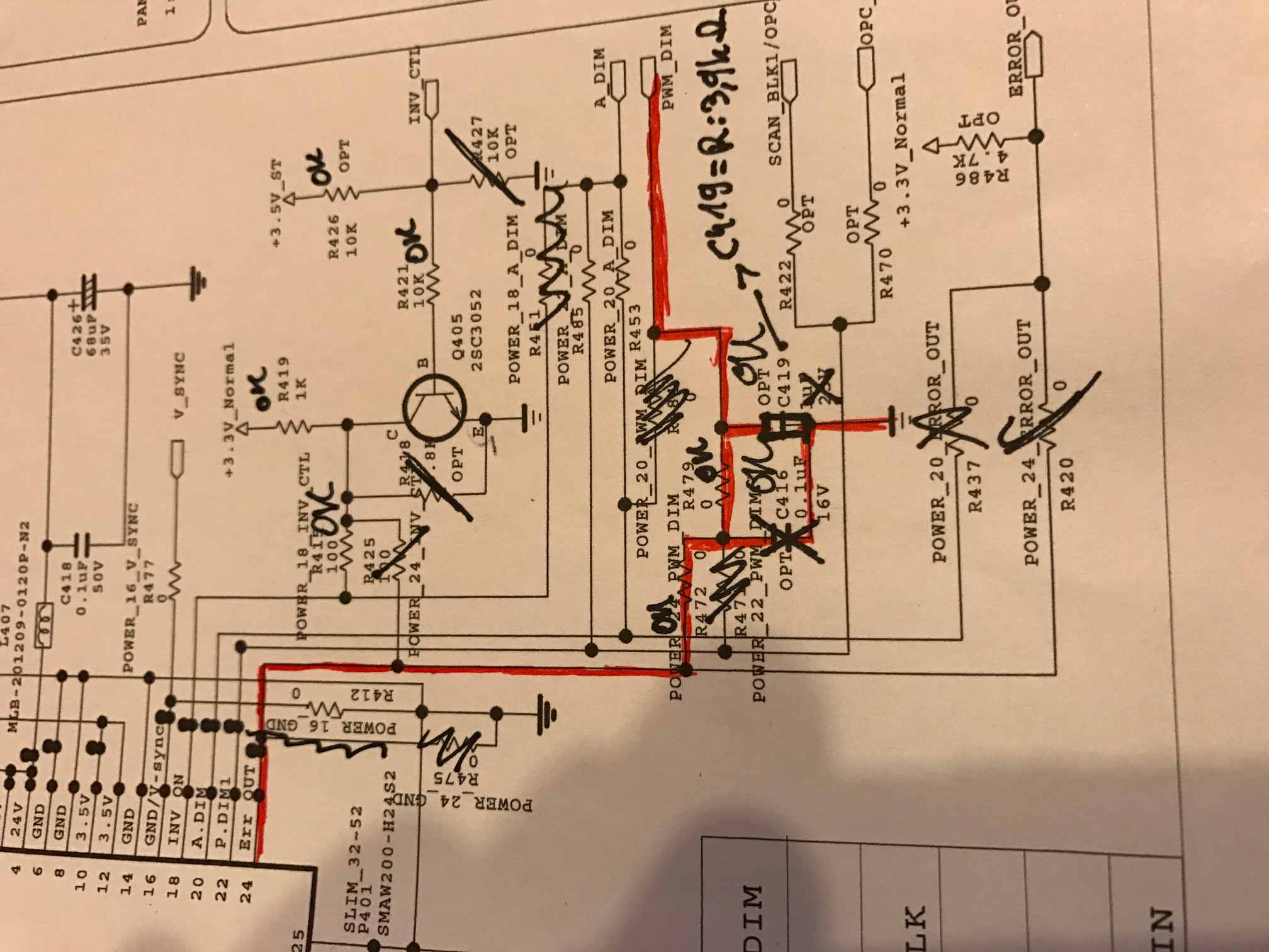

    Hello, The Tv Switches ok, Led turn from Red to White. Relais on power pcb = OK - Inverter stays out of order, Image black!
    Voltages on Powerboard all Ok. 3,5V / 12V / 24V
    Voltages from Mainboard to Powerboard:
    P-Dim 3,4V
    A-Dim 0V
    Inv 0V
    Error 0V
    The main Inv Transistor on Mainboard is working.
    What can I also try to find the fault?
    Thanks?

      Hi yes I have the circuit Diagramm, When I pull out the Error ligne from the connector, and when I took out the base resistor of the Transistor, then the backlight light up, so the Inverter board is Ok. I think the Mainboard does not send the Inv_on LOW Signal (The Signal on the Base Transistor stays all the time 1V) and it keeps the Error ligne to gnd. So its the Mainboard I think. But what on Mainboard. Also soemthing strange is that the LED of the digital outport (Sound) doesn't light up, but all the voltages are ok on the board. Thanks

          Hi have figure out the error line yes. When i disconnect Error Line and let the BL-Line connect theres no backlight. Same when I Change . I must disconnect BOTH lines to light up the Backlight. I try to upload it now yes.

              Error_Out looks like an output from the power supply to the main board. R486 is connected to it and should have 3.3V on it. Have you checked that it is there?
              Also have you checked the transistor Q405 using your meter in diode mode to check that it's OK and not shorted.
              INV_CTL is normally High so the collector will be at 0V. When INV_CTL goes low the collector should go to 3.3V

                Q405 is full operating, I have test it after desoldering with an Transistor tester, it's in good condition, same as R421, R426, R425, R419. I have 3m3V on Collector, and 0,8V on Base of Q405
                Error Out has 0V (pulled down to ground) , R486 is ok, an the 3,3V on R486 are also ok, but pulled down to ground.
                Why can Error be pulled to ground on the power supply, when all the voltages are ok at the PS?

                      Looking at the PS diagram, the power supply board does not generated the ERROR signal, the ERROR signal is generated by the backlights circuit, the signal is just being routed through the power supply board.
                      Same for the INV-ON, ADIM, PWM-DIM, they are routed through the power supply board for clean wiring.

                                        Hi, I will do a pic of the TV , I checked the error Signal, and it's right this Error Signal is the PWM Signal. Here are Voltages of the Invert Board, when I OPEN the Error Circuit (Inv Board to Mainboard)
                                        PDim = Error : 6,4V
                                        VDim = P.Dim: 4V
                                        Ena = A.Dim: 3,6V
                                        Det. = Inv ON: 0V
                                        When I Close the Error Line now, only the PDIM Voltage drop down to 0. The other Lines are OK. On the other pic you see the real schematic as it is on board.
