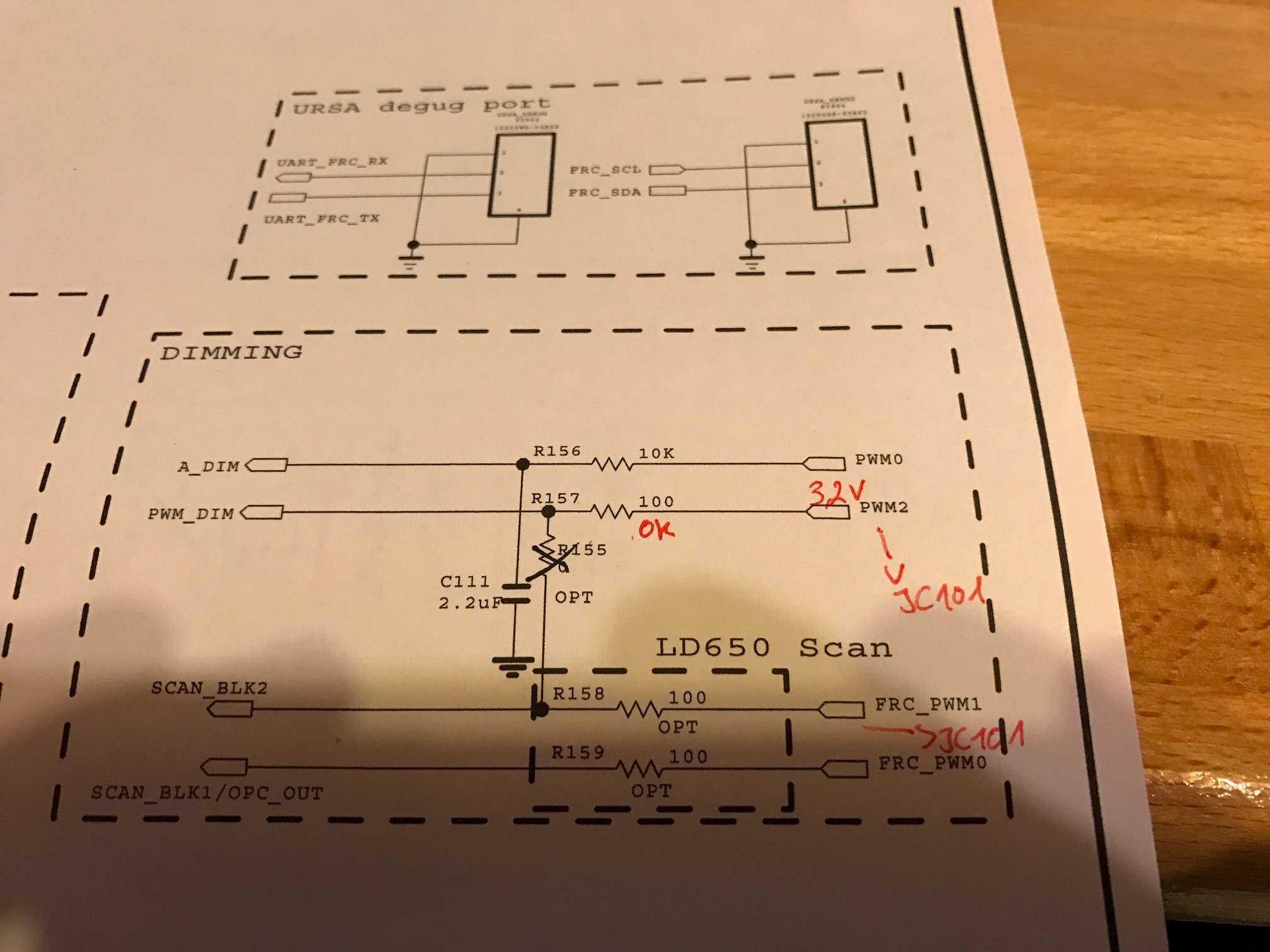

    After another test: I take out R157 , first resistor after IC101 , Resistor between PWM2 and PWM_DIM. 100 Ohm = OK. Without the resistor the PWM2 line has 3,2V. I think this a big Problem on the Mainboard or may it be another board?

                Hi all, i have the same problem. Power led red, then white but no picture. Measuring voltages IC1002 is not giving the ok for the inverter board and t-con board. Other voltages seem to be ok. There seem to be no error signals. Forced On the back lighting and all lit up well. Tried to reflow the processor but same result. At this point the tv is quite old and not worth is buying a replacement main board. If someone can give out some help, that would be great. Otherwise the tv unit is just scrap. Thanks
