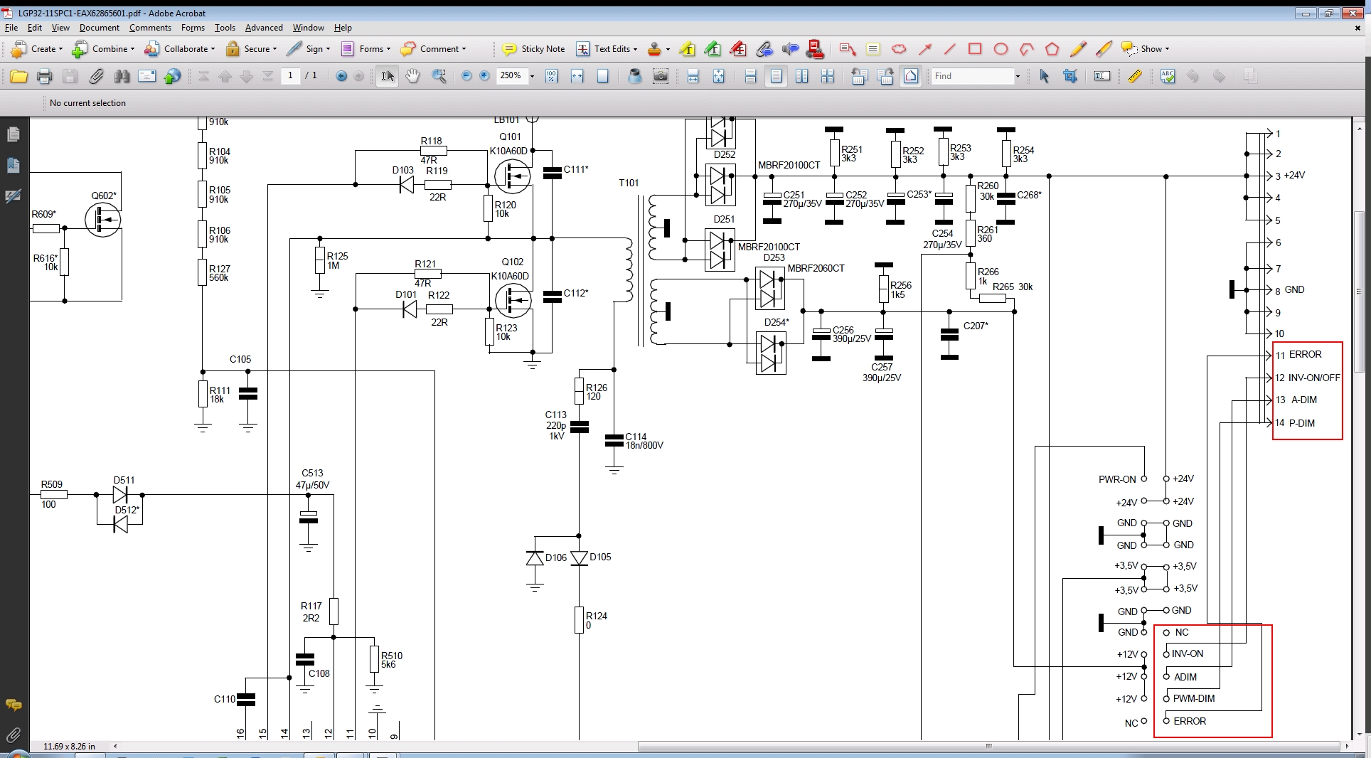

                  Re: LG 32LE4500 LD01D - stays black no pic
                  Hi just downloaded the circuit Diagramm of the PS, the error isn't connected to the PS.

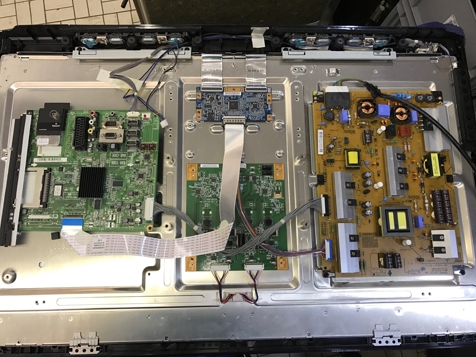

                      Looking at the PS diagram, the power supply board does not generated the ERROR signal, the ERROR signal is generated by the backlights circuit, the signal is just being routed through the power supply board.
                      Same for the INV-ON, ADIM, PWM-DIM, they are routed through the power supply board for clean wiring.
                        Can we see the pictures of the whole backside of the TV showing all the board?
                          I've also searched a schematic for the led Driver board, but I can't find it: Model Number of the Driver board: 37T06-D04
                          (TCON Board is: T370HW04)
                          Best regards
                            When I turn the Backlight on Manually (disconnect error and inv-on line from the Driver board) , the Screen is dark triggered, the LCD is black .. (closed) But nothing on the Screen, no OSD no Images, just black.

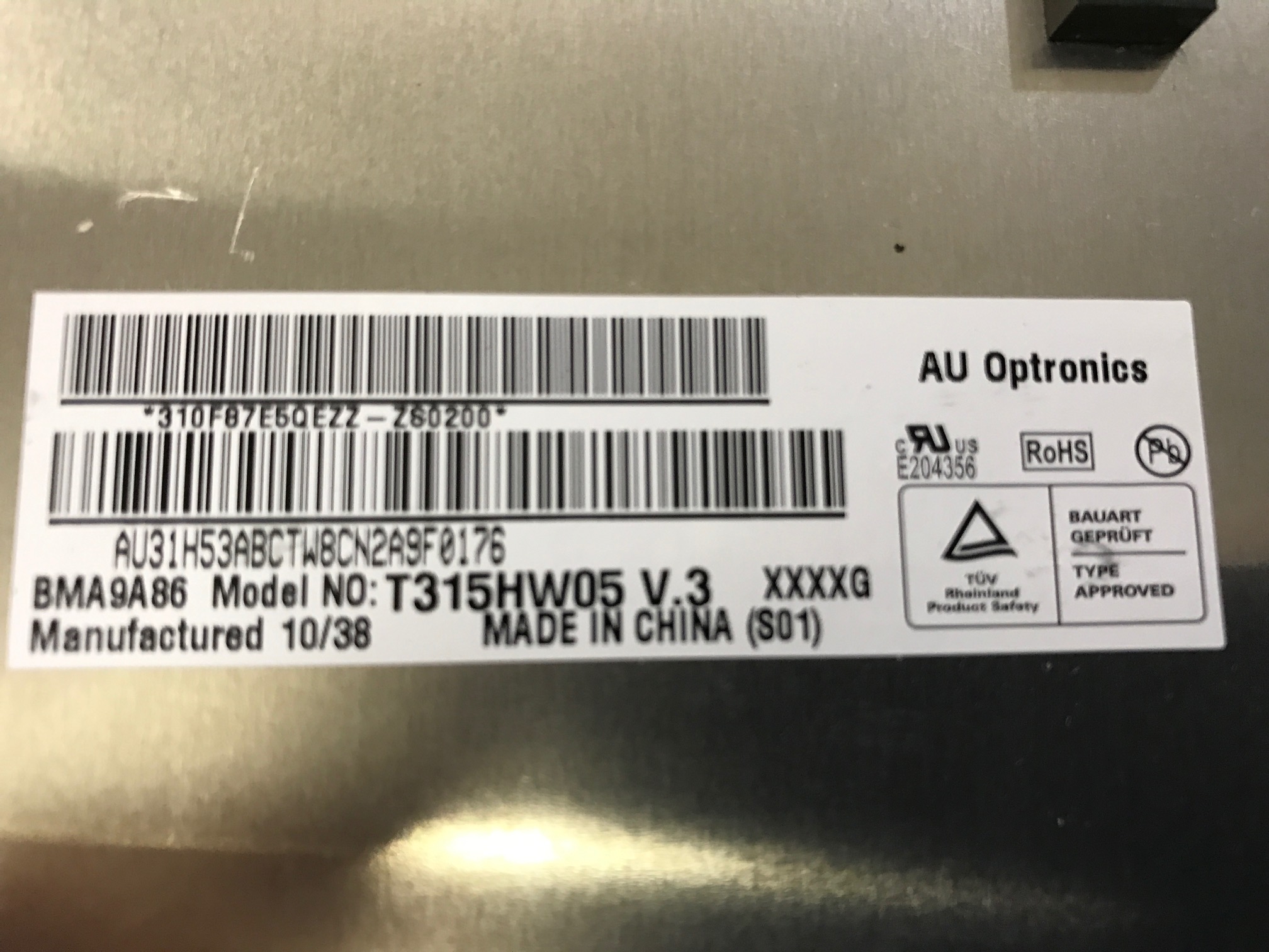

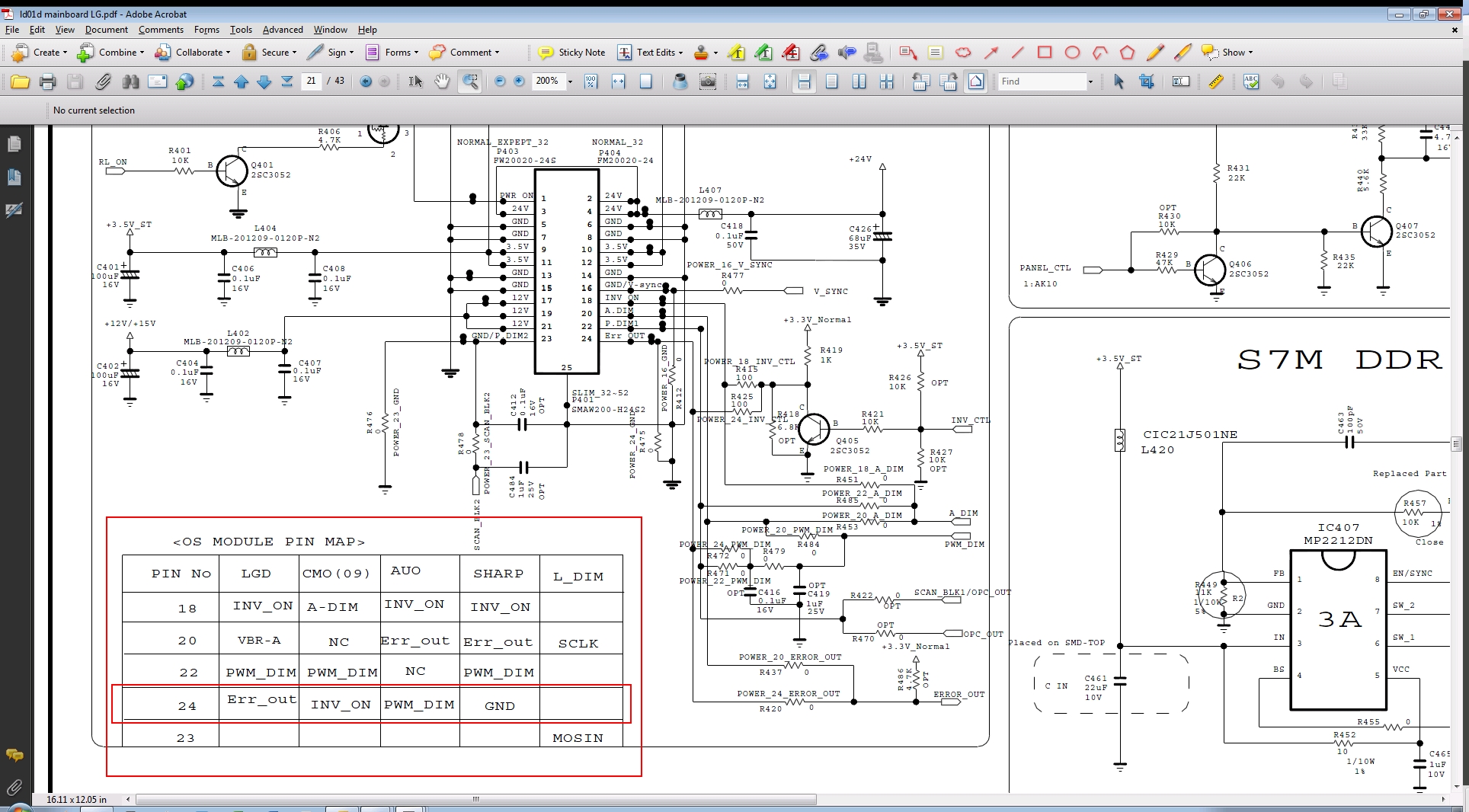

                                The ERROR pin may or may not be used, based on the maker of the LCD panel as shown in the chart, so lot of those resistors for PIN 24 may or may not be present.
                                What is the maker and model of the LCD panel?
                                  photos of whole back better than talking.. its had extra led driver connected with t-con ?
                                    What is the model number of the LCD panel? is it made by AUOPTO? if that is the case then pin 24 is not used and the ERROR out signal pin, it is PWM DIM pin per chart.
                                      Best regards
                                      Are you sure? Those numbers indicate 37" panel by AUOPTO.
                                        Hi, I will do a pic of the TV , I checked the error Signal, and it's right this Error Signal is the PWM Signal. Here are Voltages of the Invert Board, when I OPEN the Error Circuit (Inv Board to Mainboard)
                                        PDim = Error : 6,4V
                                        VDim = P.Dim: 4V
                                        Ena = A.Dim: 3,6V
                                        Det. = Inv ON: 0V
                                        When I Close the Error Line now, only the PDIM Voltage drop down to 0. The other Lines are OK. On the other pic you see the real schematic as it is on board.
