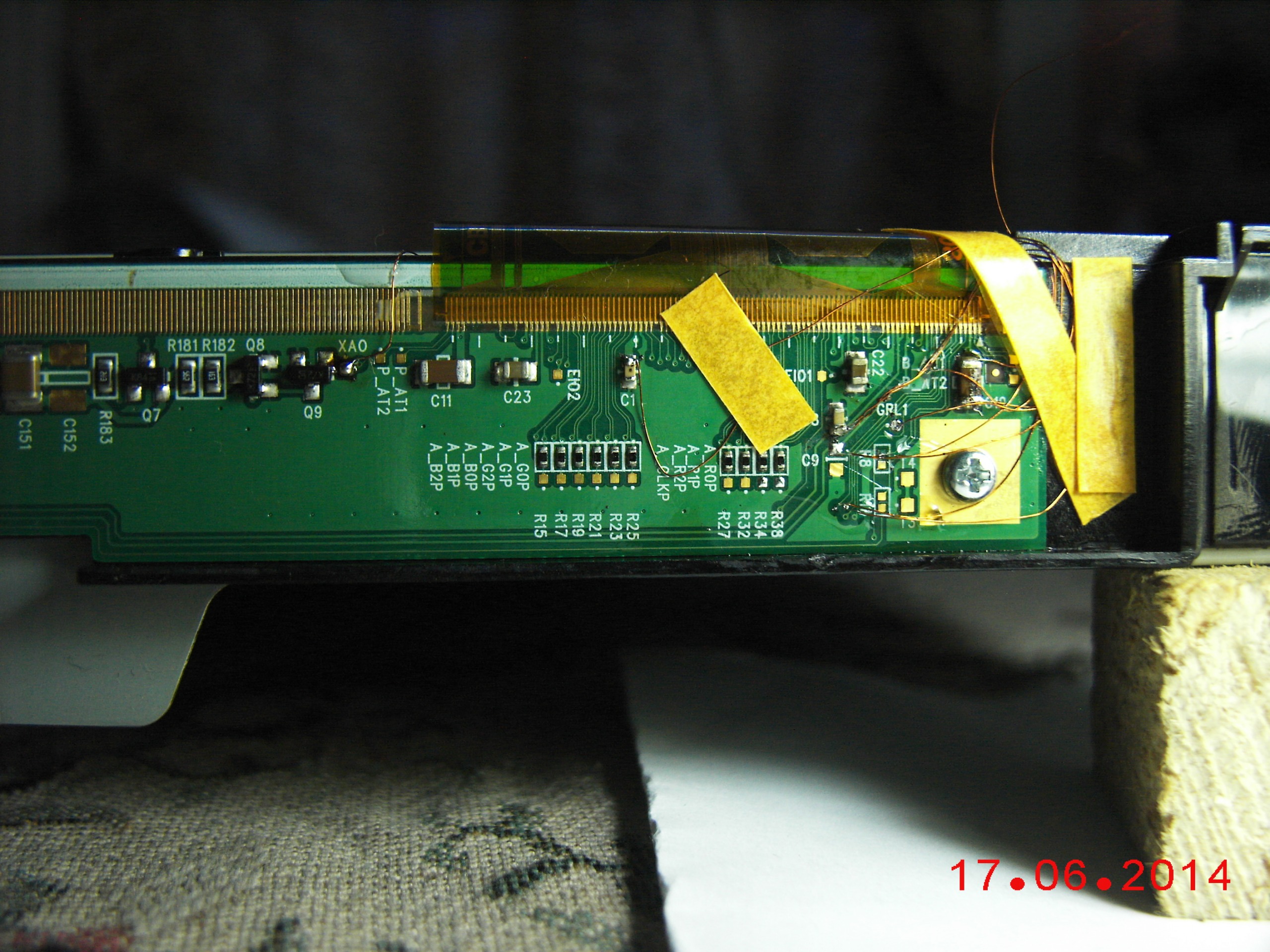

    I came across this pic, and wondered.
    What does this fix????

    Re: Fixing LCD Panel????????
    Haa haaa...Fix? made me laugh that,nearly choked on my beer!
    Wonder what they was thinking there..
