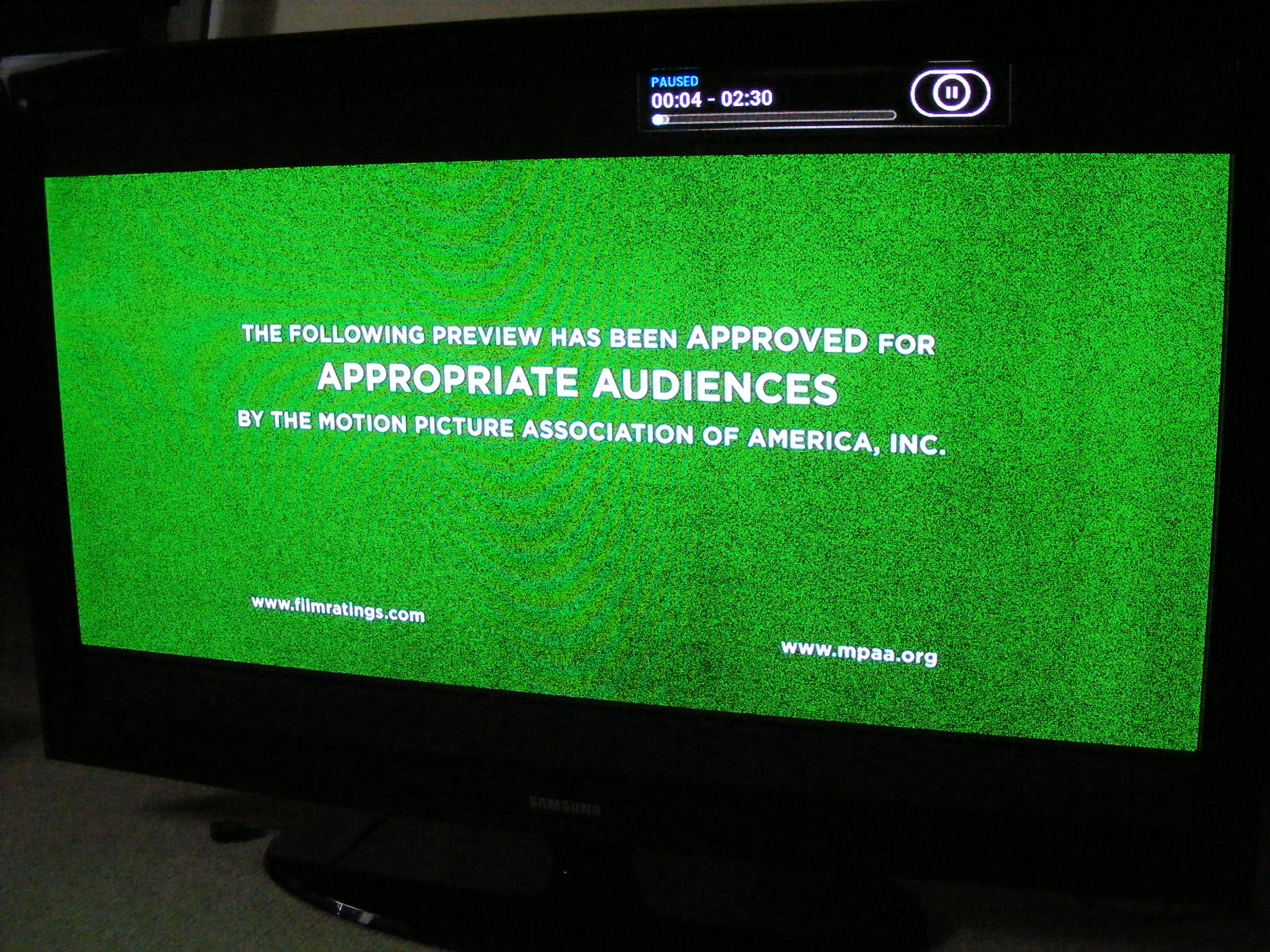

      Yes I have a scope. Wich waveform must be present? I have checked all the igbt, mosfet and diodes present on the heatsink one by one. All are OK
        Re: Plasma Pixelization SAMSUNG PS50B430

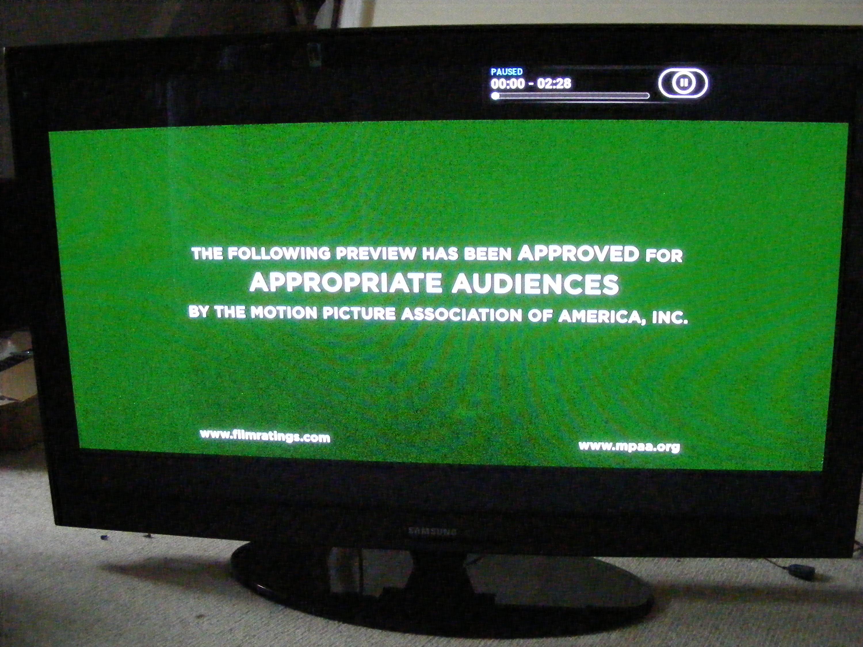

        I've currently got two of these open. One with a control board issue causing regular vertical lines across the screen, the other I bought as a "fully working" TV because someone was selling it cheap. Both of them with good control board in have a picture approaching what your photos show. Speckly mist, especially noticable on solid areas of green. They have big trouble with the "The Following Preview Has Been Approved For All Audiences" green splash screen before a trailer. Also some speckling in gradations of skin tone.
        Have checked voltages and reflowed joints with no effect. I'm thinking it's just crappy samsung plasmas and panel aging. I've worked on samsung panels in the past with similar maldischarge which I could never resolve completely. It gets better as the TV warms up and is perfectly watchable from normal viewing distance. There's also quite a bit of red sparkles when turned on from cold.

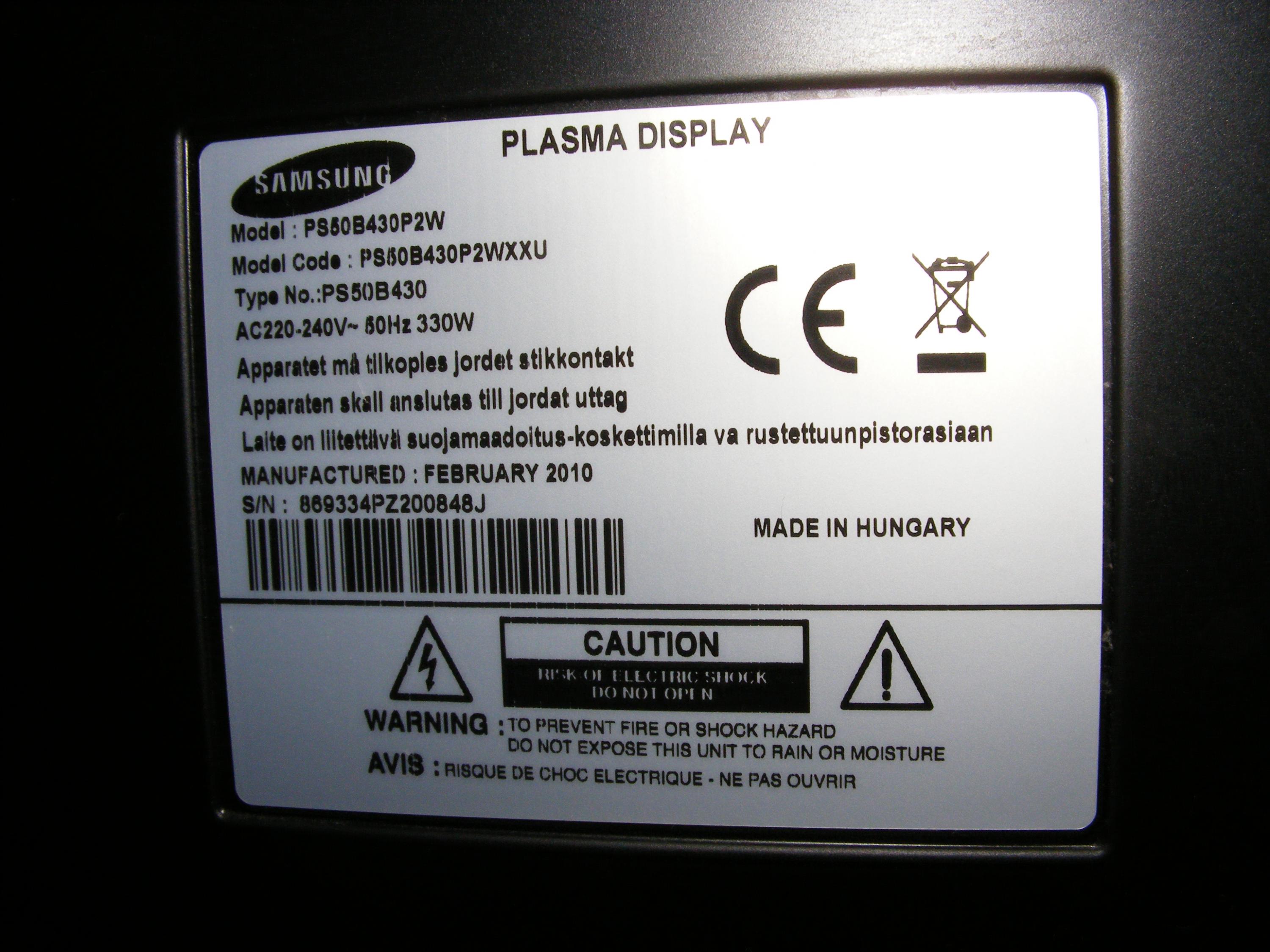

          Please post a picture of the sticker on the back of your TV

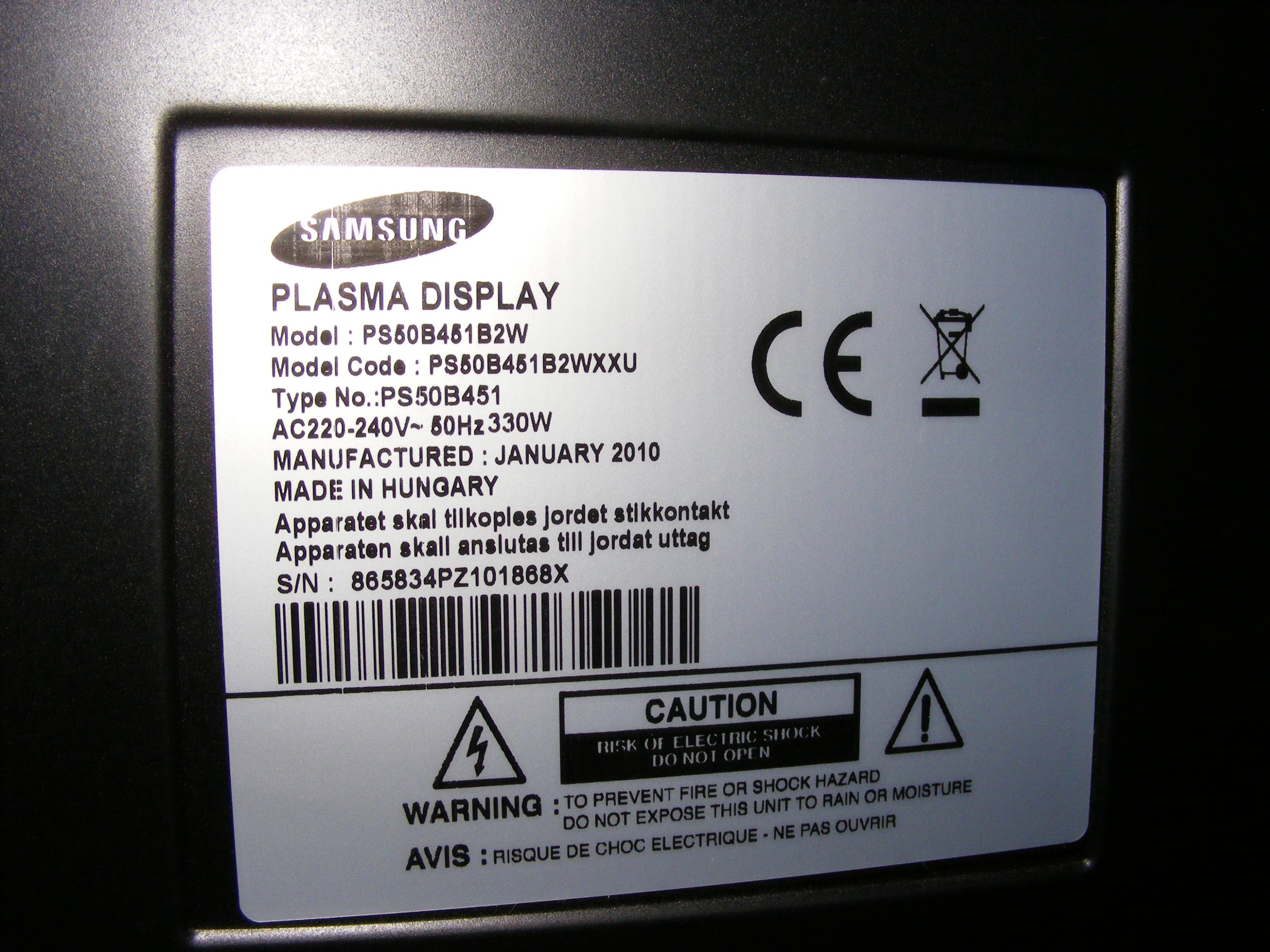

            Yes, here are some pics. In fact one of them is a PS50B451, but both use the same S50HW-YB05 panel and identical boards.
              If the VS and Va voltages match to the values printed on the board you should replace YSUS board

                      Just been working on the B451. Ve was in spec. I had a play with voltages. Upping Vs and -Vsc improved things a lot. Then I finally figured out my way around the Samsung website and did the firmware upgrade and it got way worse. So I put the voltages back where they were and it's pretty good now. A bit of faint image retention and the green trailer screen still doesn't look solid color but normal scenes are very watchable. So just panel aging which the firmware adjusted for it seems.
