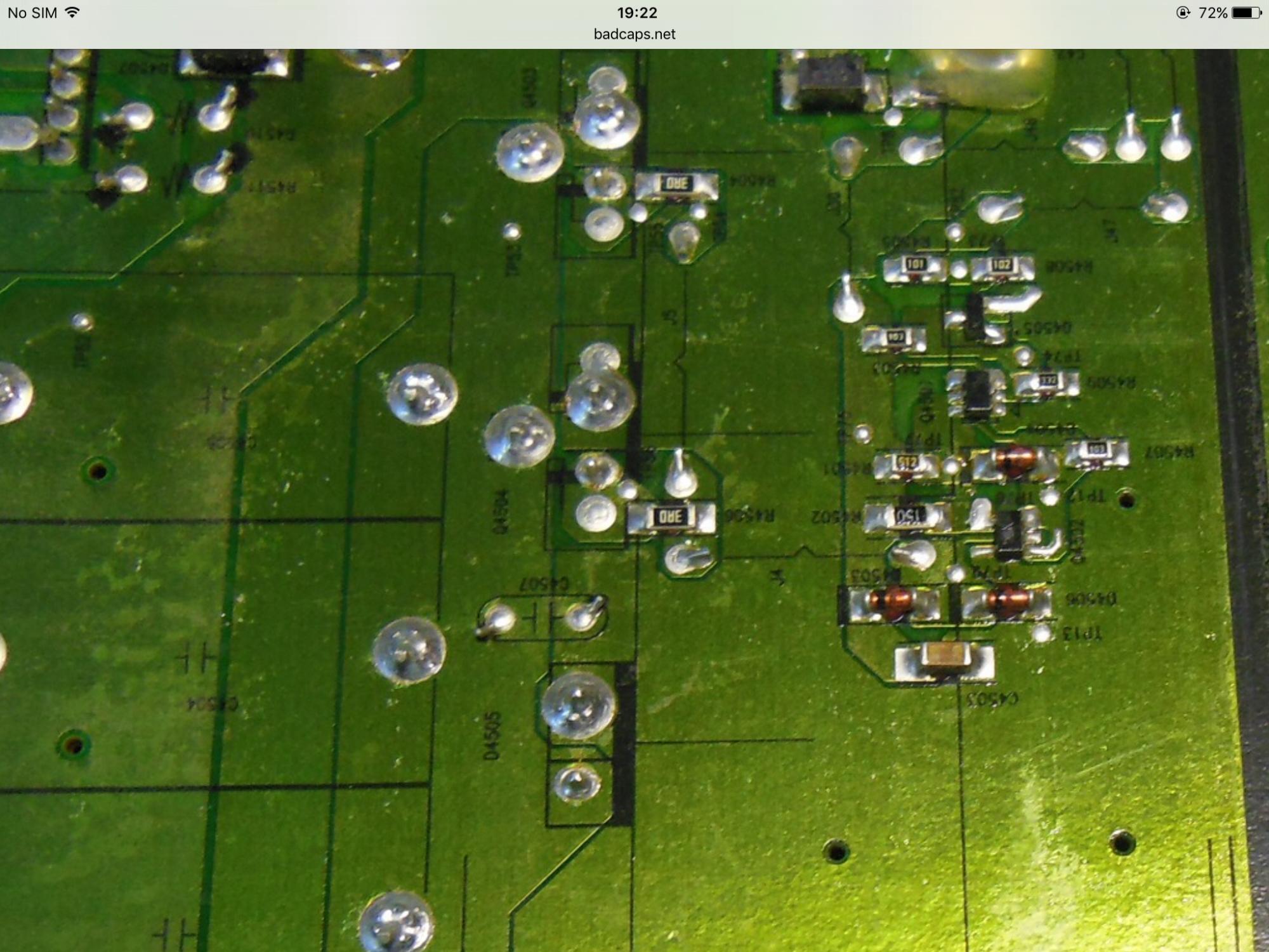

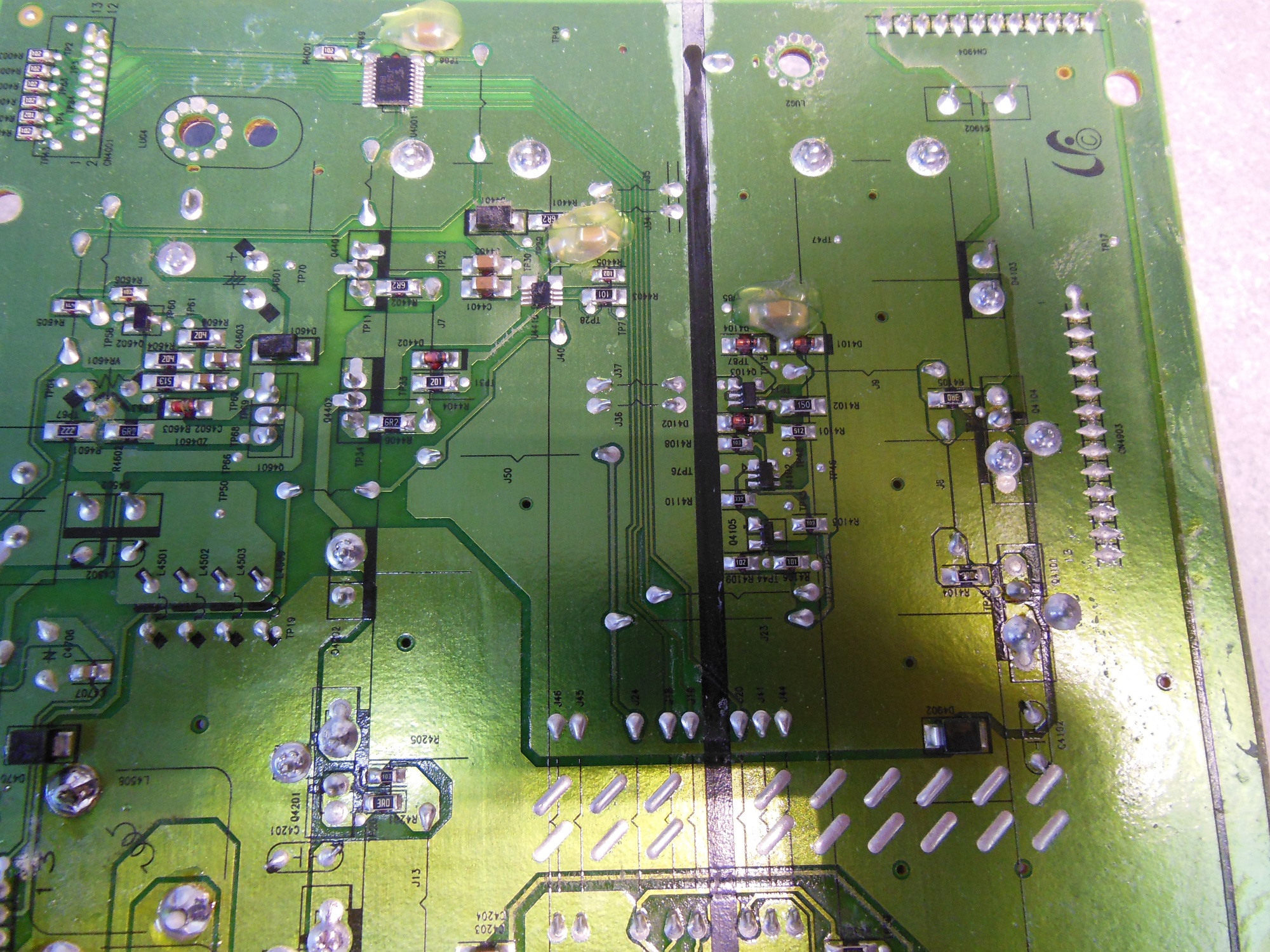

                          Here is the Xmain board solder side in two part. I have reflow all the joint and test ! no change idem with the Ymain.

                            Re: Plasma Pixelization SAMSUNG PS50B430
                            I can see a few I dont like the look of reflow everything mounted on a heatsink as ve is good could be an Erc fault.

                              As I said I remade all the welds. the photo are before! Ve is OK. What is ERC default
