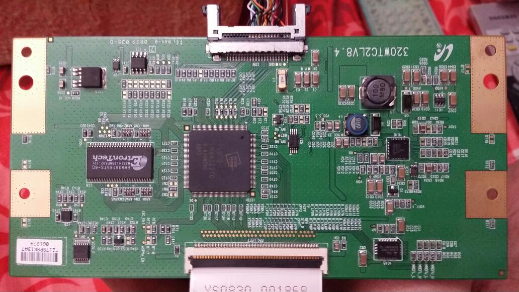

Re: Sony KDL-32U4000 T-con swap with a KDL-32v4500, possible ?
...and seeing how those bar codes do not match, it's almost certain it won't work. Another difference I spotted is that the "donor" TV has a single missing pin on the LVDS connector starting from right to left, whereas mine has 2 missing ones. As for the panel model, the ad for the parts TV (the V model) shows a sticker which reads "KDL-32v4500 E", so perhaps the panel model is the same as the TV model ? No, it's not the sticker on the back cover - it's clearly slapped onto a metal frame, so it's inside the cabinet. I can't really tell if there are other stickers to look at, since I don't have the TV on hand right now and the ad doesn't state any models either. Perhaps the EEPROM idea is feasible after all...makes sense at least.
Sony KDL-32U4000 T-con swap with a KDL-32v4500, possible ?
Re: Sony KDL-32U4000 T-con swap with a KDL-32v4500, possible ?
"320WTC2LV8.4." is the BLANK PCB P/N which can be stuffed many different ways to make many PCBA for different LCD Models, the numbers on the barcode are for the PCBA.Leave a comment:
Re: Sony KDL-32U4000 T-con swap with a KDL-32v4500, possible ?
Do you have the LCD panel model numbers of both of them?Leave a comment:
Re: Sony KDL-32U4000 T-con swap with a KDL-32v4500, possible ?
Which one do u think it is ? The 8-pin IC in the top left ? That would be really easy to swap in fact. Just getting the hang of T-cons, since I've mostly fixed power supplies so far
Leave a comment:
Re: Sony KDL-32U4000 T-con swap with a KDL-32v4500, possible ?
There is an eeprom on the T-CON Bd...that is the one to exchange....Although there is another eeprom on the Main Bd...but that one seems to be OK.Last edited by Andrew F. Ali; 11-22-2016, 02:20 PM.Leave a comment:
Re: Sony KDL-32U4000 T-con swap with a KDL-32v4500, possible ?
Swap eeprom if they look alikeLeave a comment:
Re: Sony KDL-32U4000 T-con swap with a KDL-32v4500, possible ?
As far as what I can see, they are alike physically. However. the eeprom may have different software to match the different screen model Nos.Leave a comment:
Sony KDL-32U4000 T-con swap with a KDL-32v4500, possible ?
Greetings folks, would like a bit of advice on this Sony KDL-32U4000 which I think has a bad T-con board or more specifically a failed gamma IC. The symptoms are what you see in the first picture I've attached: the colours are off (actually more so than they appear in the pictures - "solarized" picture as it's called) and the picture is slow to "refresh", that is, when something moves or disappears, be it a menu or in the case of my tests the mouse cursor, it leaves behind "ghosts" that take a few seconds to disappear. If the picture is still then it's unnoticeable, but what good is a TV on which you can't view moving images ? :| The T-con board is a 320WTC2LV8.4. Rather than replacing the gamma IC (which is a goose chase in its own, since I'm not entirely sure which one it is) I decided to find the whole board and I did find something on an auction site, but it's advertised as coming out of a KDL-32v4500 TV while mine is a KDL-32U4000 (no, it's not a typo - that one is a V and mine is an U). What made me consider this is that the boards are the same (320WTC2LV8.4) with the exception of some of the markings on them (just take a look at the pictures), but the models of the TVs differ. Don't know if you can see it too well, but to the right of the LVDS connector, there's a small square with a digit inside it - my board has a 4 and his board has a 7, just so you can tell them apart. Are T-con boards "coded" somehow to match a specific panel ? Will this board still work on the U model ? It's not very cheap, so I wouldn't want to waste money on it. Cheers.Attached Filesif you find these attachements useful please consider making a small donation to the site
Tags: None
by HakuuHi There,
More Details
TV Model - LG OLED77G1PUA
Got the same exact TCON board from TVPartsToday and replaced it. But didnt transfer the EPPROM data (didnt... -
Vizio e601i-A3 - Has Sound and Display, But No Backlight - Bad Power Supply Board or Bad LED Bulbs ?by Tynan DillI was given this TV from my great uncle. He said it just wouldn't turn on one day out of nowhere, replaced the TV, and gave it to me to possibly fix and use for myself.
Assuming...7 Photos -
by m1ch43lzmHi, this is my personal laptop, which the original board (lets call it Board A) blew up PU8700 (TPS51486), making a hole on the board, i had left the laptop at my desk one day with the battery fully charged and didn't touch it for a week, but when i tried to turn it on it didn't
Thought the battery was dead, so i plugged in the charger then tried to power on, the power LED blinked once, charged LED still orange, unplugged the charger, plugged in again and I noticed the "magic smoke" smell, so i unplugged the charger, removed the back cover and saw the blown IC (the "magic... -
by howardc64All left and right refers to looking from rear of TV (or looking from front with TV upside down)
- TV came with vertical bars and no image. Found faulty TVS on left buffer board. Also replaced T-Con (may have damaged the original while hot air removing components, board has slight warp) and have full image but few horizontal lines on the screen. Some of the lines appears to be 2 pixel tall while others are 1 pixel tall.
- Disconnecting left and right buffer board potentially reveals problems on both sides with different signals (unless this T-Con require jumper like Samsung FB_TRDY1&3) Fault
by delpiero3Hi everyone, newcomer in this forum, i watched tons of video from Sorin, i like the way i calmly explain things, i did quite some console repair, i am not that bad at micro-soldering, but troubleshooting where the issue is, is definitely where i still have progress to make. Usually i was able to fix the console because the failure was obvious, or because i was able to find someone with similar measures on the board and was pinpointing what to replace that way.
Nevertheless, let's say, i don't come as a total beginner.
I have this old laptop, which suit perfectly my needs, with the... - Loading...
- No more items.
Leave a comment:
