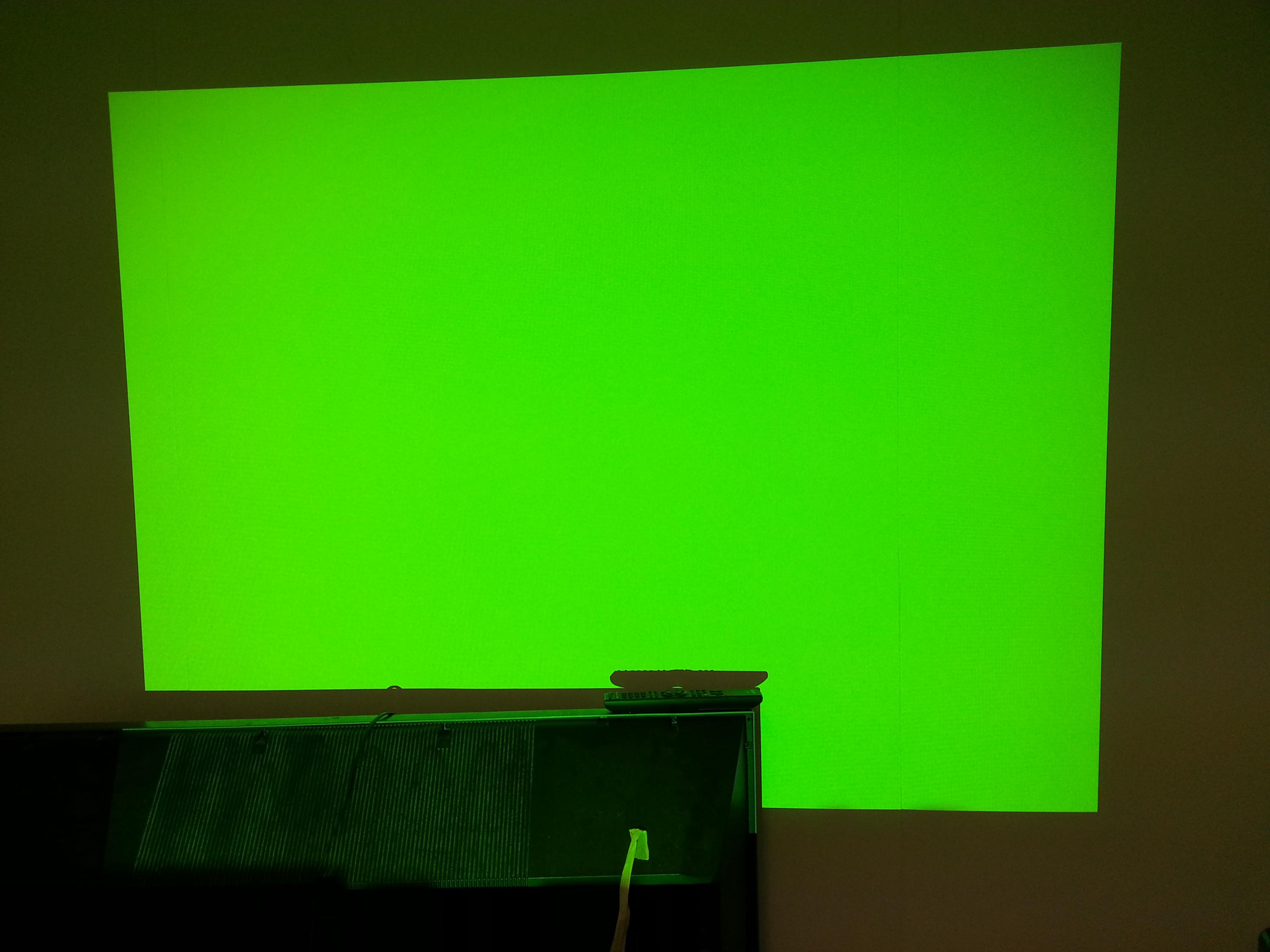

    I know it's not exactly a television, but maybe somebody has heard of this kind of issue before. Basically, this projector is just adding the color green to everywhere. Now, I've seen LCD projectors where the panels were getting worn and starting to discolor, but this isn't like that at all - the color green is added to the entire image with equal intensity. It covers menus and even the black bars that crop a 16:9 video source or the edges of the digital keystone correction.

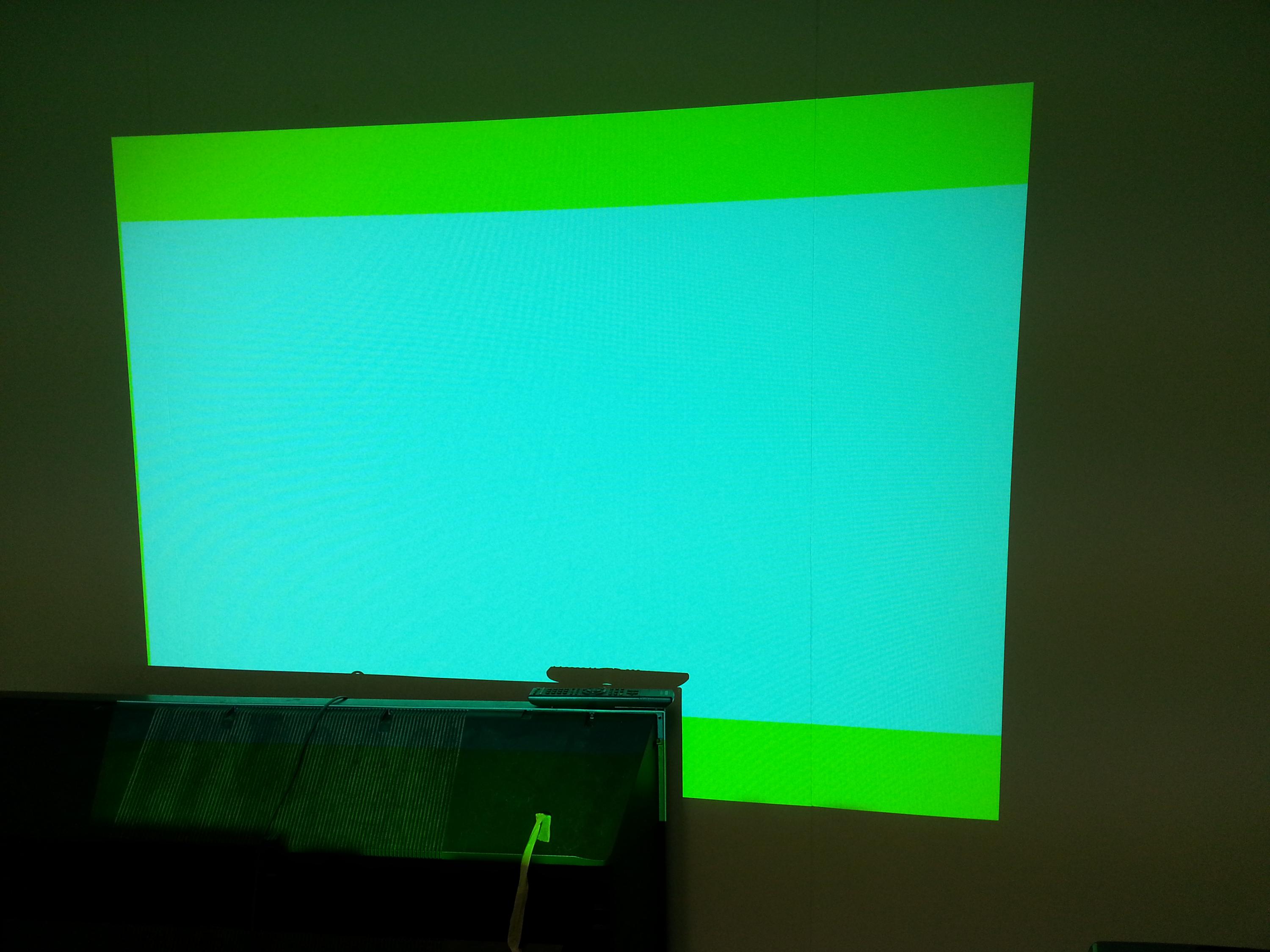

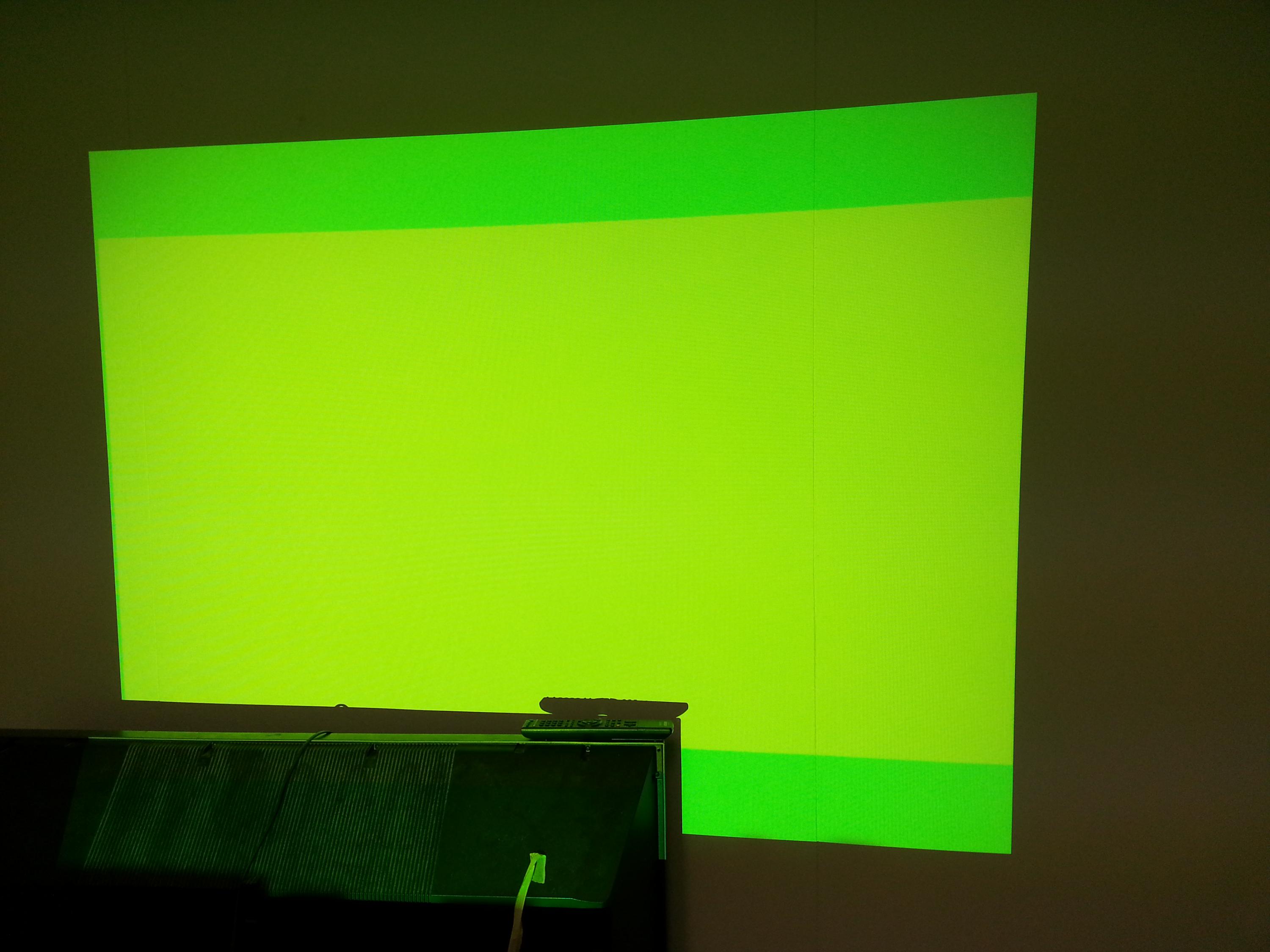

    What does this mean for the projected image? The color black appears green (pictured), the color red appears yellow (pictured), and the color blue appears blue-green (pictured). The color green, of course, is properly rendered. I ran a web search and found no mention of the issue on this or any other projector. Any ideas?

    It dawned on me that when the panel is displaying nothing, it will be fully passive to light, so I have to assume that it's either got a bad panel or mainboard. Cleaning and reseating connectors did not help.
    I guess you can't fix 'em all.
