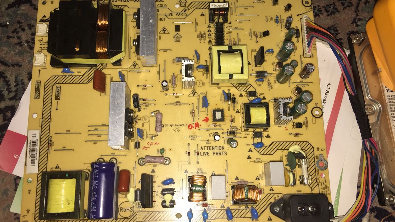

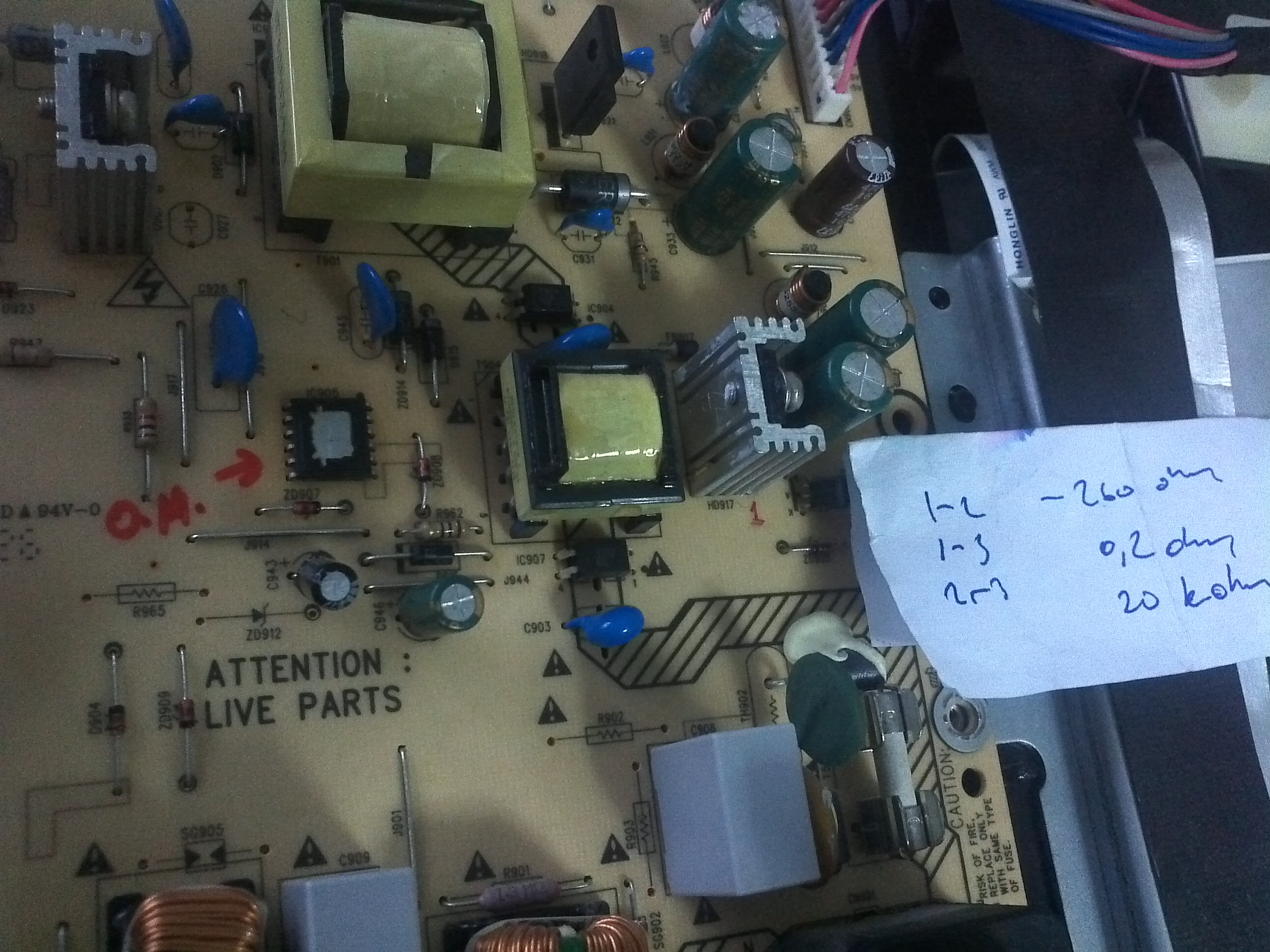

    philips 37pfl4606h LCD's shutting within
    20 seconds in first attempt.
    7 seconds in second attempt.
    4 second in third.
    i realise that it occurs overheated element.
    after unplug i touch the boards and find the guilty chip. (IC905)
    you can see at pic. can you suggest something about this board?

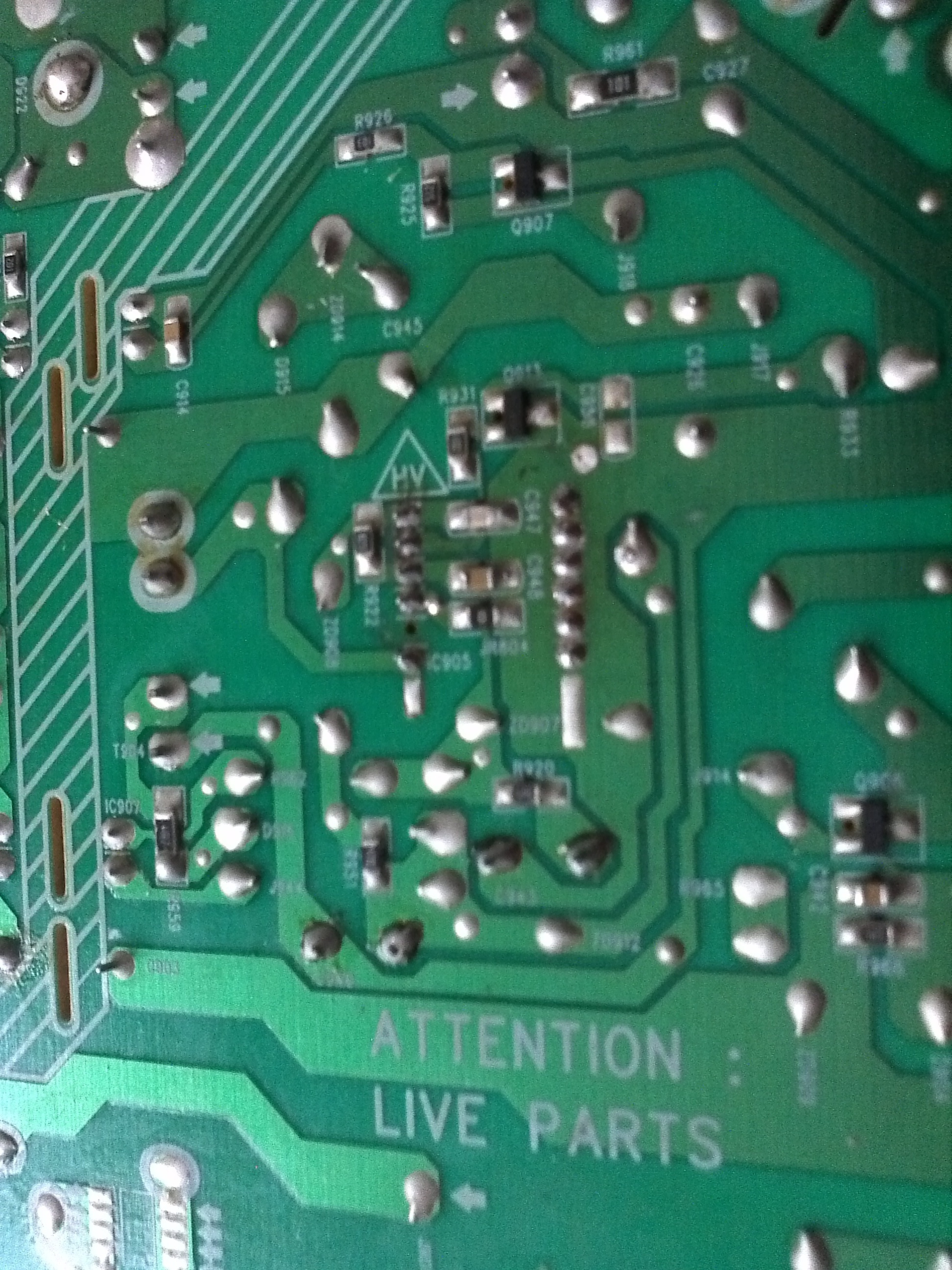

    and i measure one transistor right side of the chip.. is this normal?

    Re: Shutting off due to overheated chip on philips lcd
    what is printed on the chip?
      Is the top of it blown off ?

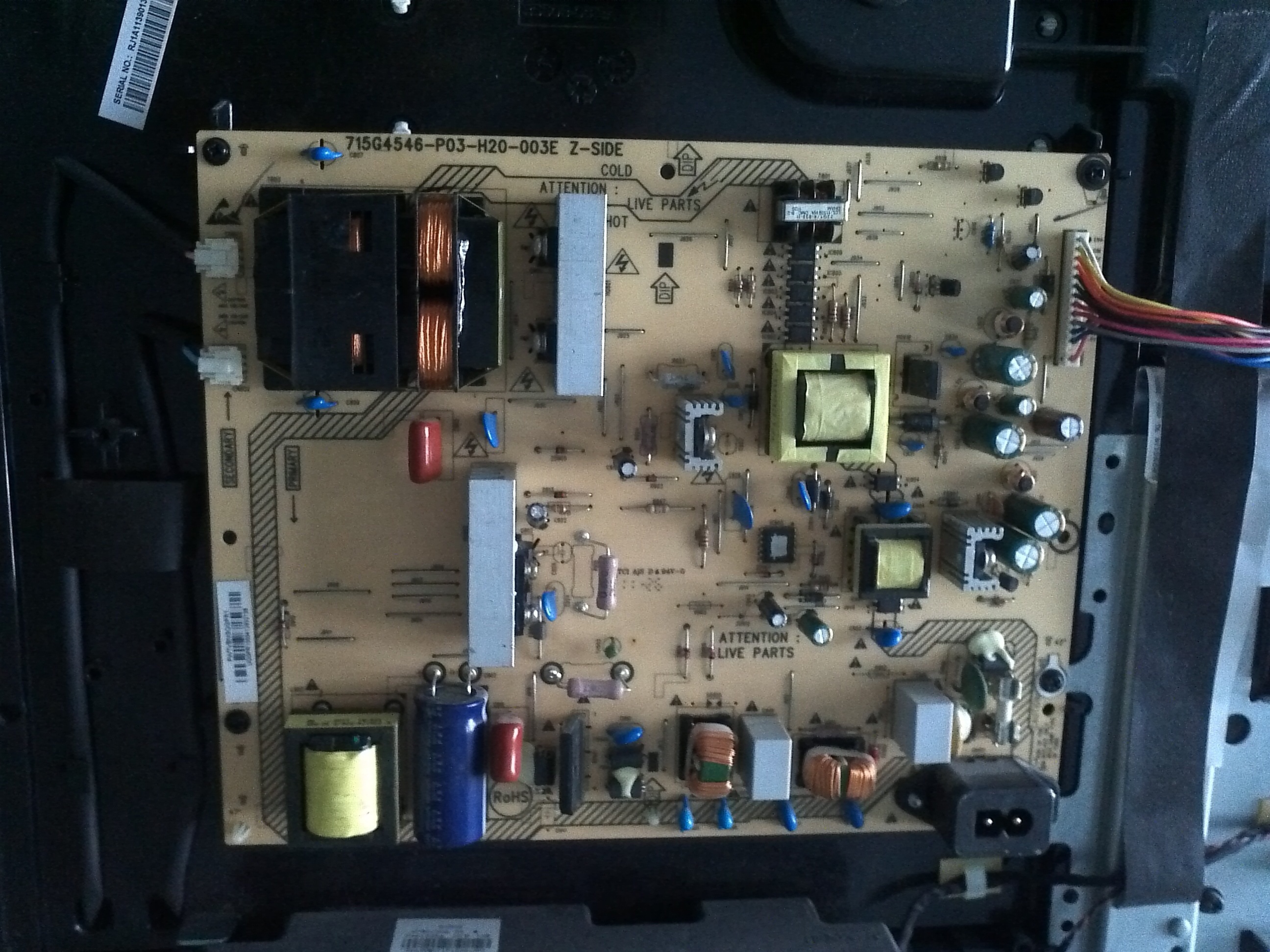

        What psu number is used in this set.
          i will try to read it.there is white area on it. like that.
          is it blown?
          and this is original psu pic..
            top264vg
            https://cdn.badcaps-static.com/pdfs/...55b6a4623a.pdf
            http://www.depanntout.com/t526-47PFL...2-en-panne.htm

              • 31070
              so bad diode(s) on the D pin will overload it.
                So what is the solution?
                is only swapping TOP264GW
                or only finding and swapping bad diod
                or both of them
                where is the D pin?
                i found diode-like component that was short.
                i think that was a resistor. 0,2 ohm
                please help..

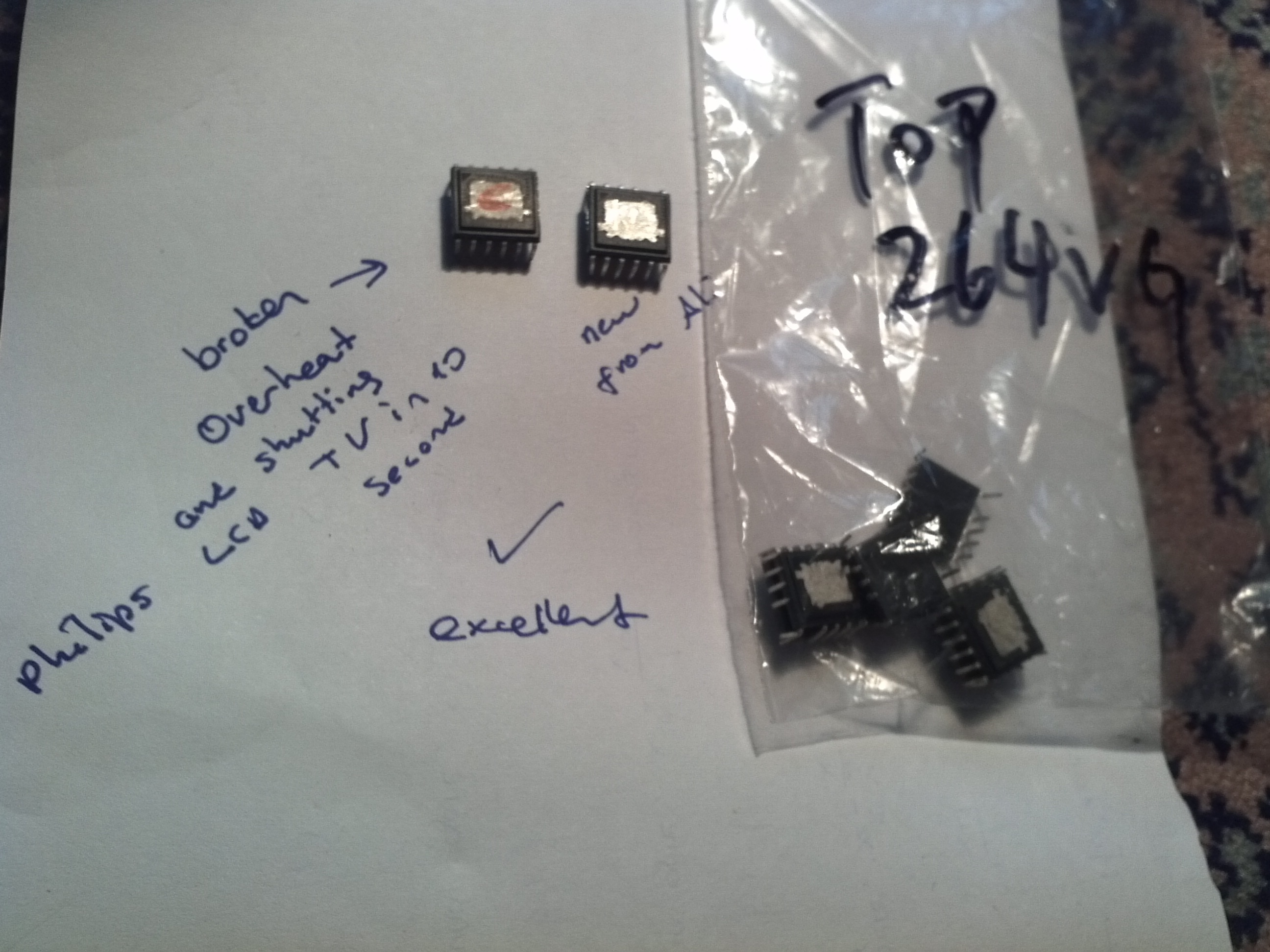

                  Re:SOLVED: Shutting off due to overheated chip on philips lcd.SOLVED
                  i ordered TOP264vg chips from Ali..
                  Swap and SUCCESS.
                  this is my first LCD TV experience.. thank you everyone.
