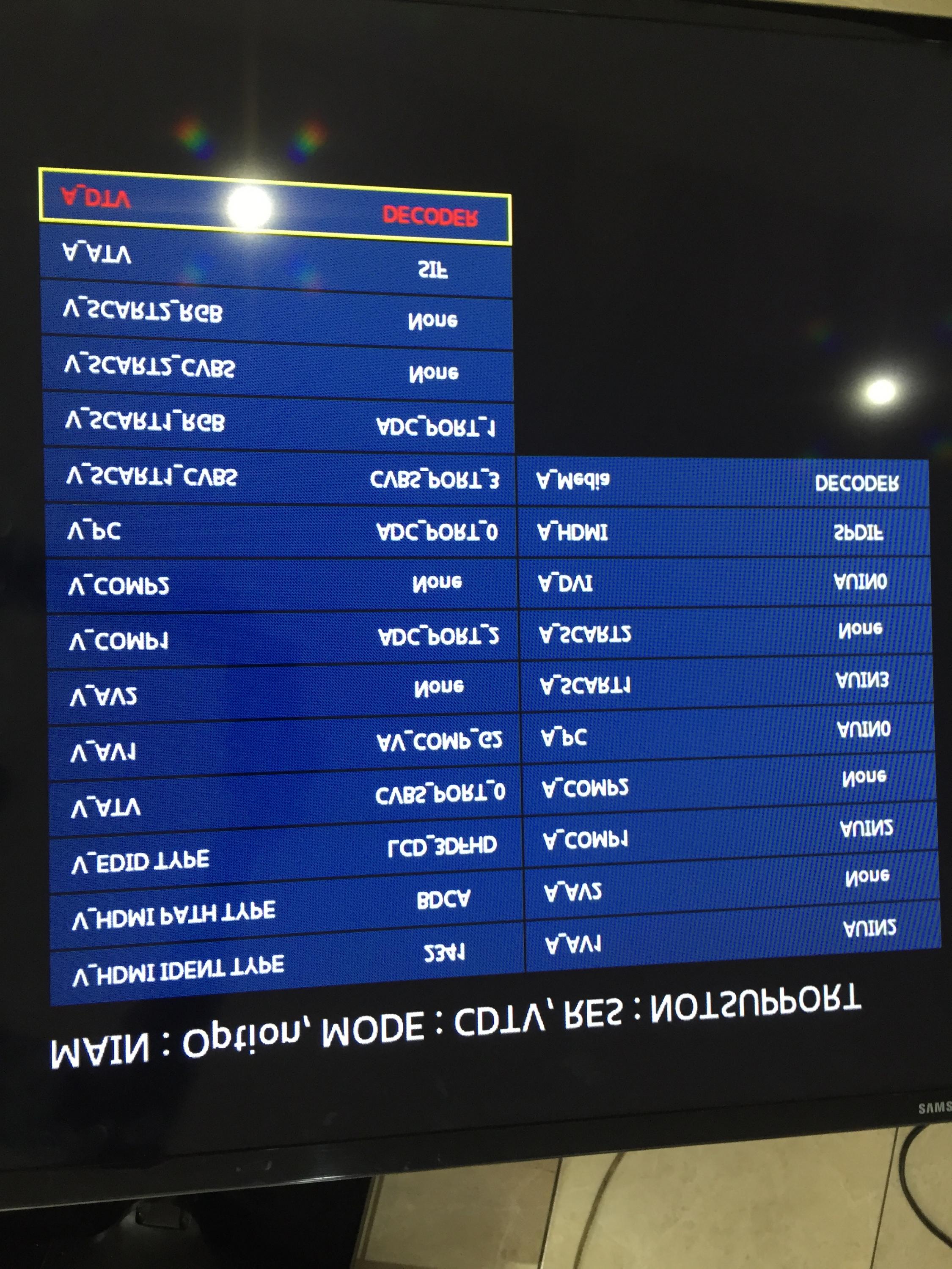

    LED Tv Samsung UE46F6400 image reversed
    LED Tv Samsung UE46F6400 image fliped
    - mainboard was fault , i buy another mainboard, but the image is reversed or flipped
    - i try to enter service menu and search for some settings but nothing
    any help ?

                Re: LED Tv Samsung UE46F6400 image reversed
                The image can be flipped by changing the screen type in the service menu until you find one that works. I just went through this not long ago with a UN60ES7100. I ended up using a board out of a much cheaper UN40EH5300. It took me about 20-30 tries in the service menu with different screen types but I finally got one that was made for use with the LCD panel reversed. The UN60ES7100 had the t-con at the bottom whereas the UN40EH5300 had it at the top.
                  i try in service menu , but for 46" have only 2 option for panel
                    I switch with a 32" panel and now it`s working, topic can be close

                            To anyone else that finds this thread.
                            On a UE46F6700 .. The type options are as below:
                            The ones marked x didn't fix the issue for me
                            The ones marked v did.
                            Everything else I didn't try
