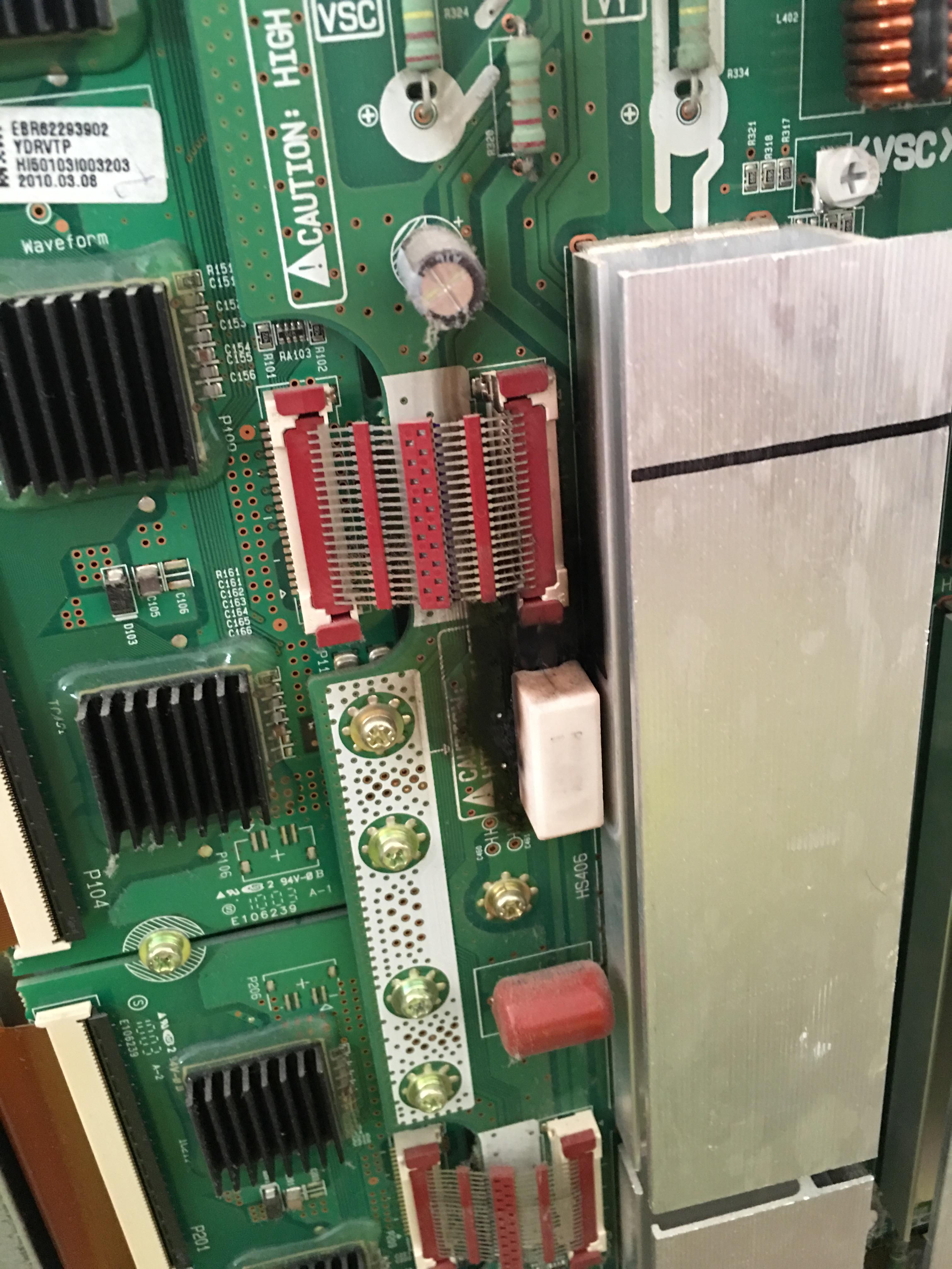

LG pk350 something caught on fire!
  • NoobCannon
    • Oct 2016
    • 3
    • England
    LG pk350 something caught on fire!
    First thread here so be kind
    Ive had my lgpk350 plasma for a good few years now (5/6) but 2016 seems to be the year of its demise. Ive so far this year had the power board repaired twice due to a stuck on standbye issue and today i had a frantic call whilst at work from the missus that the tv was "on fire"
    Ive stripped the unit down again and diagnosed (very easily i might add) that the ysus board is possibly faulty (lol). Ive found the part from a second hand suplier but was informed to replace both frame buffers at the same time as the yaus As these could have caused the fault.
    Looking for advice on if the frame buffers should be replaced at the same time also is it possible that these parts failing have caused my power board issues or is it the other way round? And is it worth replacing or is it just the end of the end for my favorite tv ever
  • howardc64
    by howardc64
    Problem
    08-04-2024, 10:36 PM
  • Kemer
    Graphics Card mounting frame
    by Kemer
    Hello, I removed the graphics card from my laptop and I want to heat it in the oven. What I want to ask is, is it okay to heat the card without removing the metal mounting frame on it?
    As you can see in the photo, there is a plastic (black) gasket between the metal frame and the card. It sticks the frame tightly to the card.
    I previously removed the metal frame while heating it, but it is quite difficult to separate it from the surface it is attached to. If there is no problem, I do not want to remove it.
    What worries me right now is the possibility that...
    09-14-2024, 08:57 AM
  • mecha1166
    Reattaching new edge to edge LCD panel to tv frame - Hisense 55a6g and others
    by mecha1166
    Some new tvs have an LCD screen attached to the outside of the frame with foam tape. These are "edge to edge" as they are called. I am trying to figure out how to reattach an LCD panel back up to the frame. The manufacturer used 3/16 inch foam tape along the top and rh/lh edges. I used a razor blade to separate the panel from the metal frame. The metal frame that the panel is taped to is 1/4 inch wide along the 2 sides and top. I completely removed the residue from the metal frame. There is some residue on the panel itself along the 3 edges, I removed almost all of it using alcohol and...
    06-13-2024, 02:28 PM
  • gatto
    LG 50PC56 keep burn Buffers Boards
    by gatto
    Hi, I’m new to the forum and this is my first post, so thank you in advance to having me, I have the fallowing problem, could someone please help
    I have this LG 50PC56 which not display image on screen
    I have already change Y-SUS and buffers 2 times! But this TV keep burning my buffers boards!
    When I do install the new Buffers board I been able to see only the top half part of the screen for about 10 min, and then it blow up again! The IC get very hot and I saw some smoke come out from it, so now I have another set of buffers burn out
    My question it is: I disconnect...
    05-04-2022, 01:35 AM
    Design of CCFL Backlight Inverters with Frame & Bar Cores
    Design of CCFL Backlight Inverters with Frame & Bar Cores
    Summary
    Portable devices, such as notebook computers and personal digital assistants are developed rapidly nowadays, which places an increasing demand on display technology. The LCD with cold cathode fluorescent back lighting satisfies the requirements on display performance, size and efficiency.
    The backlight inverter plays a crucial role in supplying the power to the lamps of these flat-panel displays.
    The frame and bar ferrite cores, described in this brochure, are especially designed...
    10-07-2024, 04:26 AM
