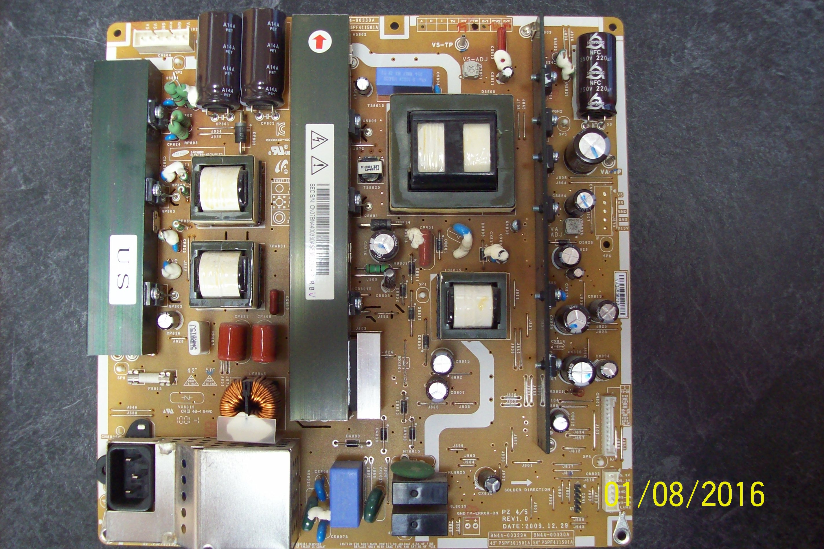

    I have a Samsung pn50c540g3f 50" plasma. When plugged in, the red power light comes on. when touched, the tv clicks a few times, and goes back to the red light. Screen does not come on. I looked around on the net a bit and it looks like it could be bad caps, or the buffer board. Just wondering if anybody here is familiar with this, and where I should start. Thanks!

      Sorry I should have clarified, I have taken the back off, all caps appear fine. It seems like from what I have found, there are usually two culprits, bad buffer boards, and power supply/bad caps. I was mostly wondering if people here were familiar enough with these to say which was more likely. If bad buffers are a strong possibility, I thought I would save everybody some time because I don't have the facilities to fix that. Bad caps are no problem for me to fix. I'll be doing some VA and VS checks shortly.

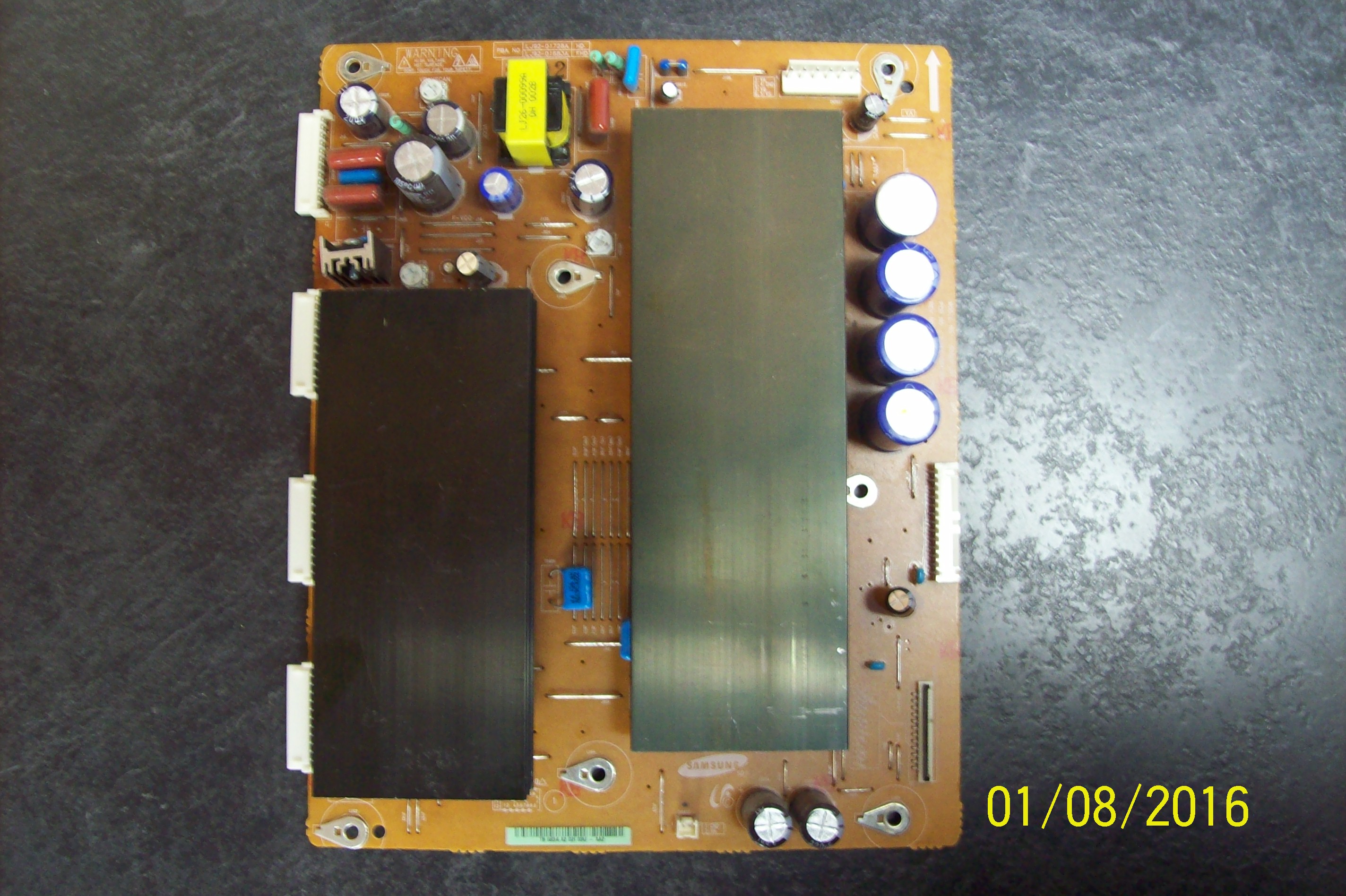

          Ok...so I've done a few tests. First to clarify, when first powered on, there are 2 back to back clicks, short pause then the third click. It will repeat that every time the power button is clicked. It happens fairly quick, so hard to get an accurate reading. Next I disconnected the cable going from the main power supply to the second board in my pics. Is that the Xsys or Ysus board? anyway, with that disconnected, I tested VA and VS on the main power supply. They momentarily read their specified voltages and then drop off. The tv also sings its little samsung song. I tested for shorts on what I assume is either the Ysus or Xsus, and sure enough, there is very little resistance from ground to VS. Not quite a dead short, but very close. So I'm guessing some component is shorted on that board.

            Looked up the board, it's the ysus

              Ok sounds like the Ysus then, could possibly be that the Xsus is damaged too when the Ysus blew as these use chained ERC (energy recovery) meaning if the Y blows it can kill the X basically. Does your meter have diode mode easier to test ?

                  Start testing the devices mounted on a heatsink but mainly if Vs is shorted to ground to diagnose the bad susboard.

                    So I think I found the culprit. a RJP30E2 transistor. Shorted in every direction. I was told that this would be a replacement:
                    https://www.digikey.com/product-sear...DPK-00%23T0-ND
                    Higher wattage, voltage, and current rating. I also found a small burnt trace and an assuming that it happened because of the shorted part. Should I check anything else out or hope that this is it?

                      I just removed and tested a rd2006 rectifier as well. It appears to be shorted as well? how are these tested?

                        Same as a transistor, you should have a voltage drop in one direction and not in the other. Also the diodes rarely rarely fail on sustain electronics. There might be other transistors shorted so keep checking the circuit before removing the diode.

                          The RD2006 is defiantly shorted in both directions. I will be double checking the other components as well.
