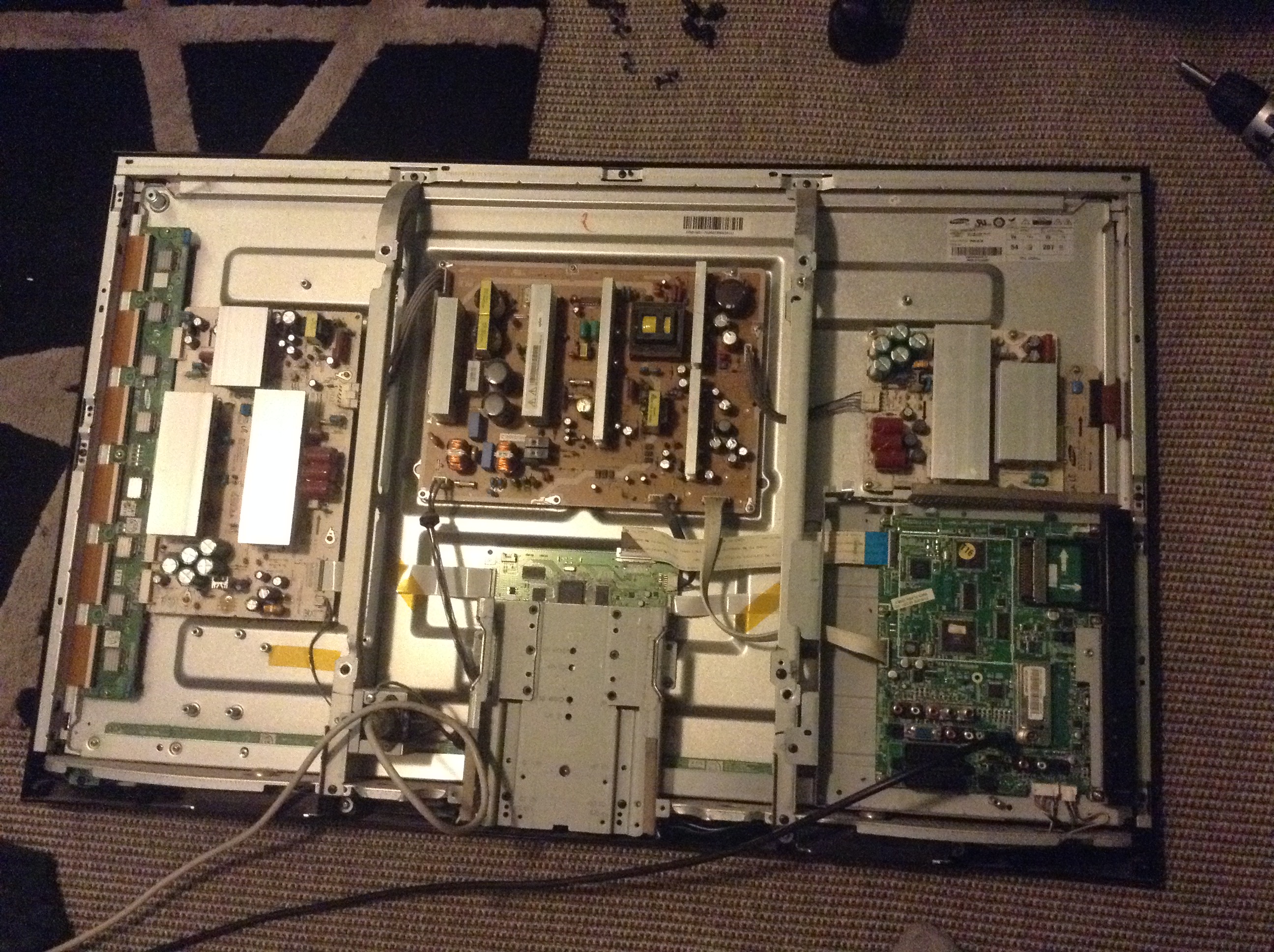

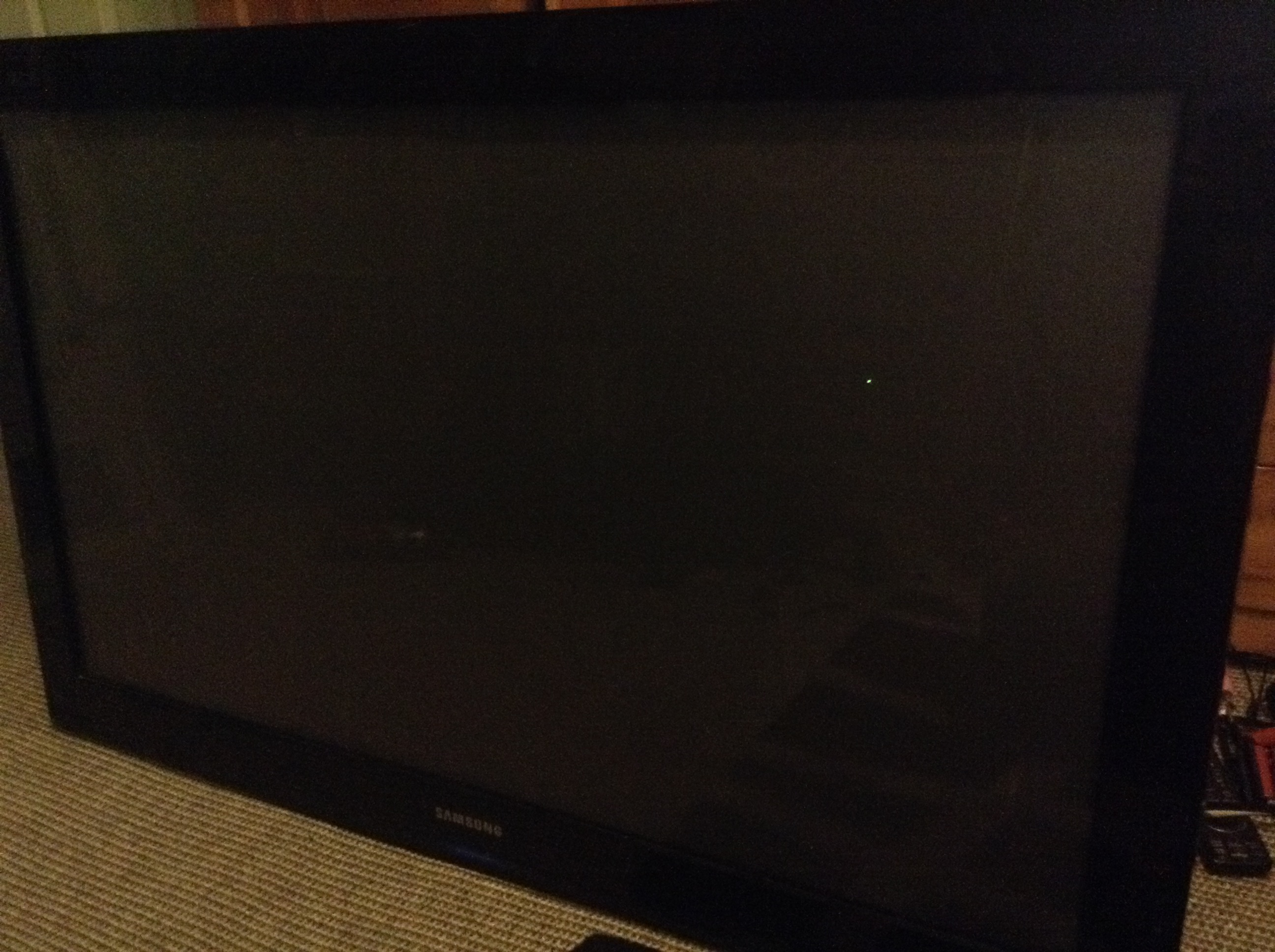

    my 2008 samsung plasma tv has developed a thick black bar down the screen. I am wondering if there is any chance i can repair my tv.

    Re: Samsung ps42a456p2d plasma HELP
    No that's almost certainly a failed COF. Not fixable im afraid.
      Thanks for the reply, is there a way i can test this to make 100 percent sure that it is the COF. is that the chip on the flat cable going to the display.
        Panel failure not fixable
          sometimes you can tell by feel, the ic in that section would/could be running hot. another way is to look at the chip with a magnifier, sometimes you can see that it is defective ie: cracked.
            Damn guess ill just scrap it then.

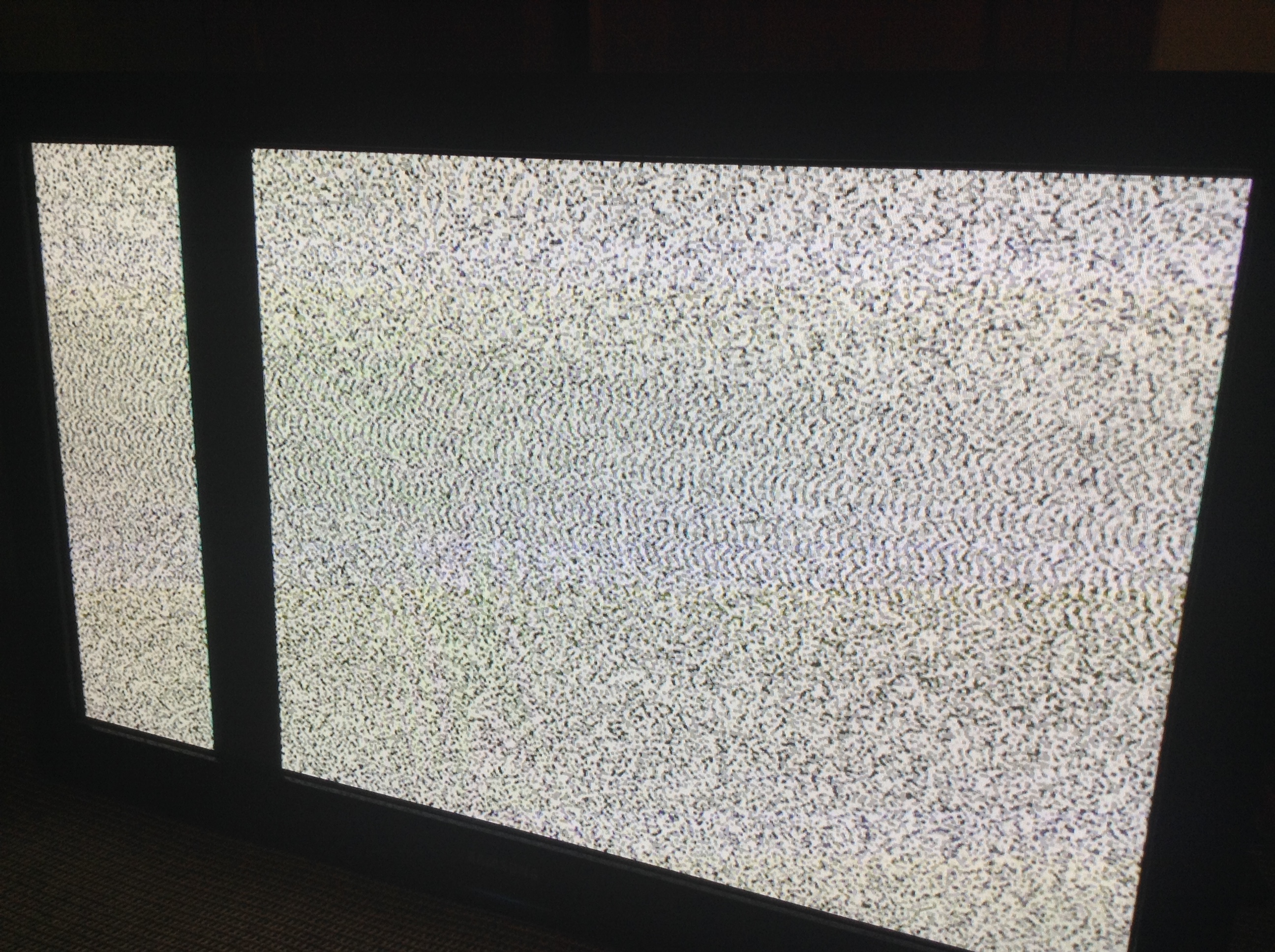

                redrooster i think that ReeceyBurger123 does not want people to ask for repair advice on his business facebook page and that i think is fair enough. You instead message him on here as this is the correct place to do so. also i unplugged half the screen and got this.
