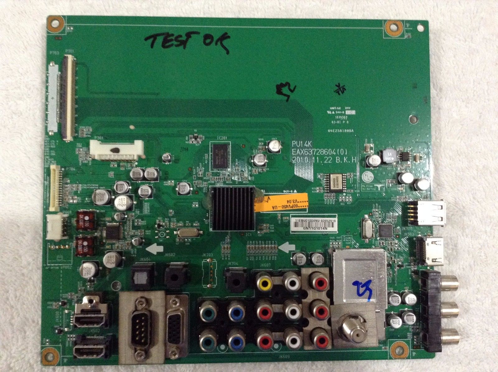

    I've seen several posts advising replacing the heat sink on various boards (in my case it's for the main board on a 60pv450 lg plasma (attached). Any general advice on where to get heat sinks that are improvements over the old one? Last thing I want to do is make it worse than before--is "bigger" all I'm trying to go with here? Also--is putting a fan in worth the effort--and any advice on what kind of fan and how to attach / wire it in?

    First is the heat sink really hot when the board is in use?

      it's a good looking sink.
      is it glued on, or held with tape?
      if tape then step1 is to remove it, clean it and refit with thermal glue.
      http://www.ebay.co.uk/itm/131516987160
      because the heatsink must take the heat from the chip.
      then it must transfer it to the air - so is there airflow?

        My advise follow what Stj said, replace the thermal pad with thermal glue. Then add a small fan over it.
