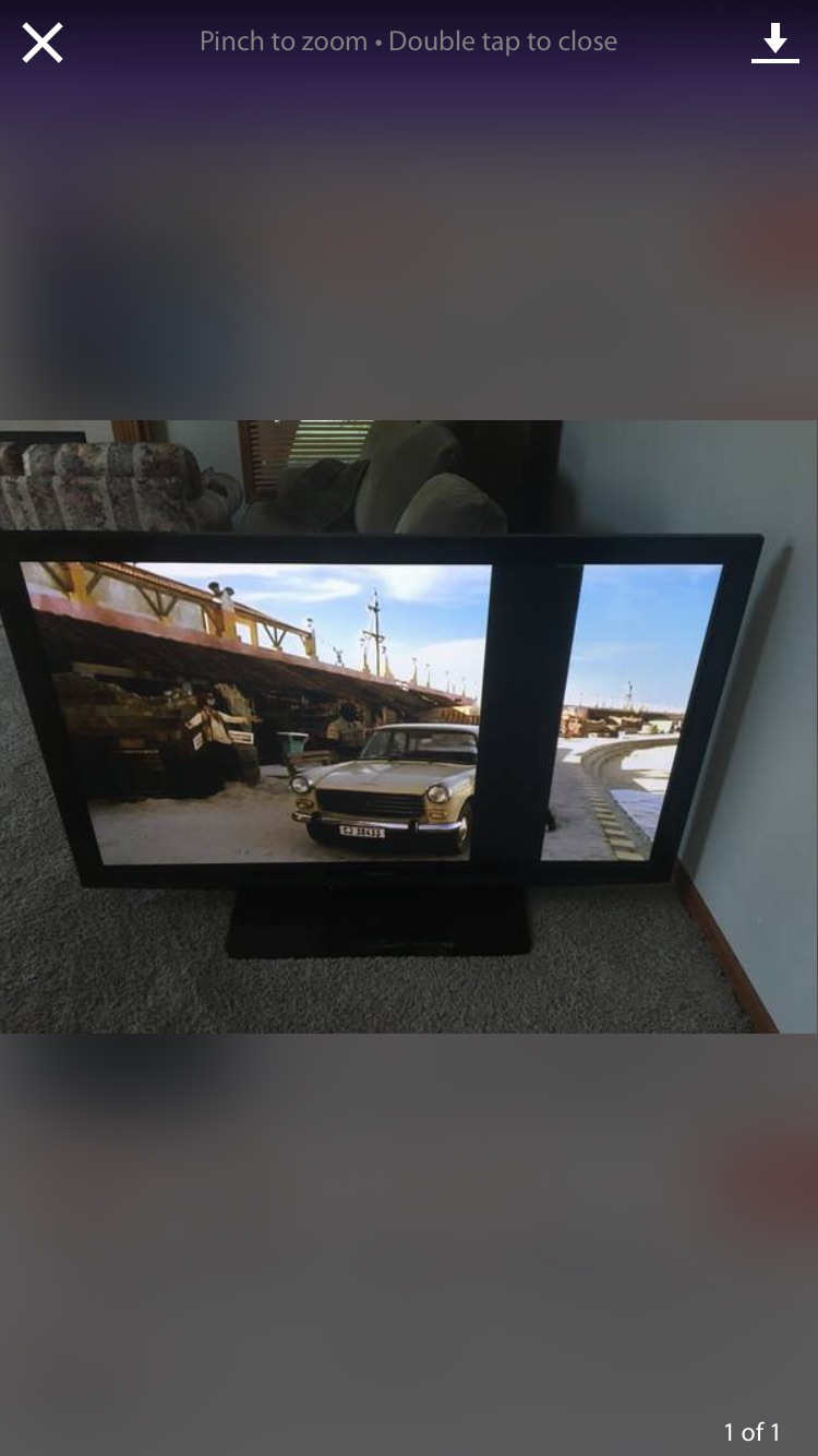

    Panasonic plasma 65 inch vertical bar
    I am buying this set and need to get a jump on the fix. I am thinking it could be the board that runs across the bottom,? Any thoughts,,?

    Re: Panasonic plasma 65 inch vertical bar
    That or panel failure, which isn't fixable.
      As John boy says , most likely panel failure or C board.
