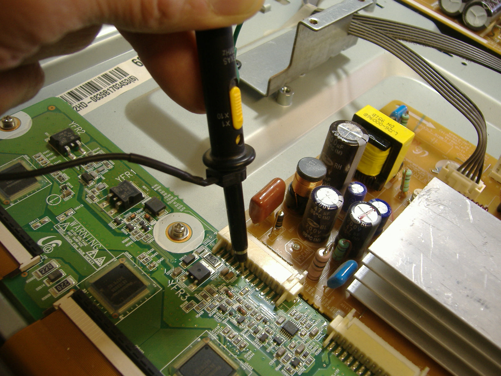

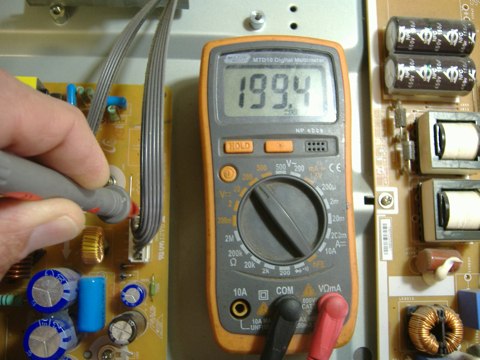

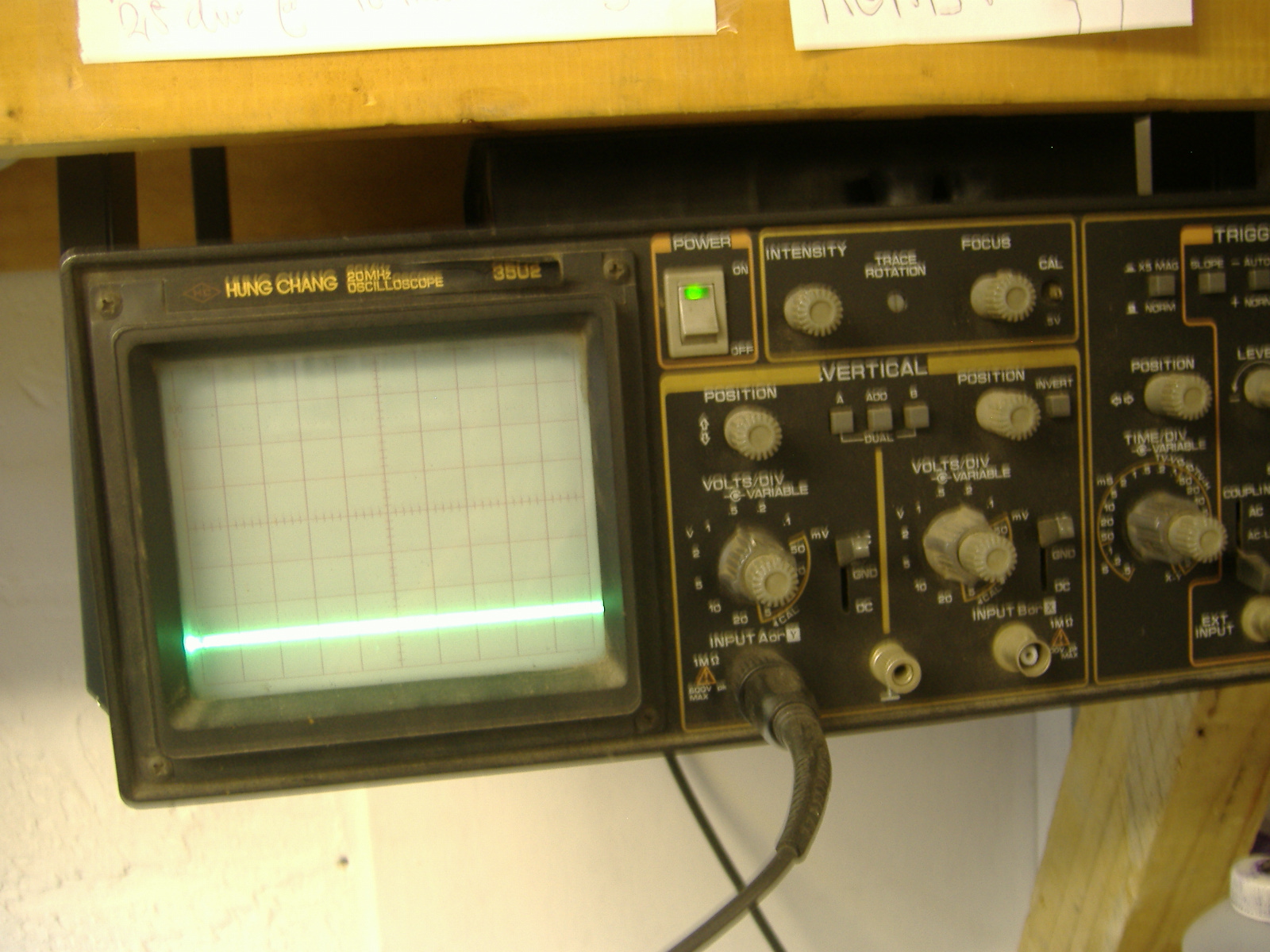

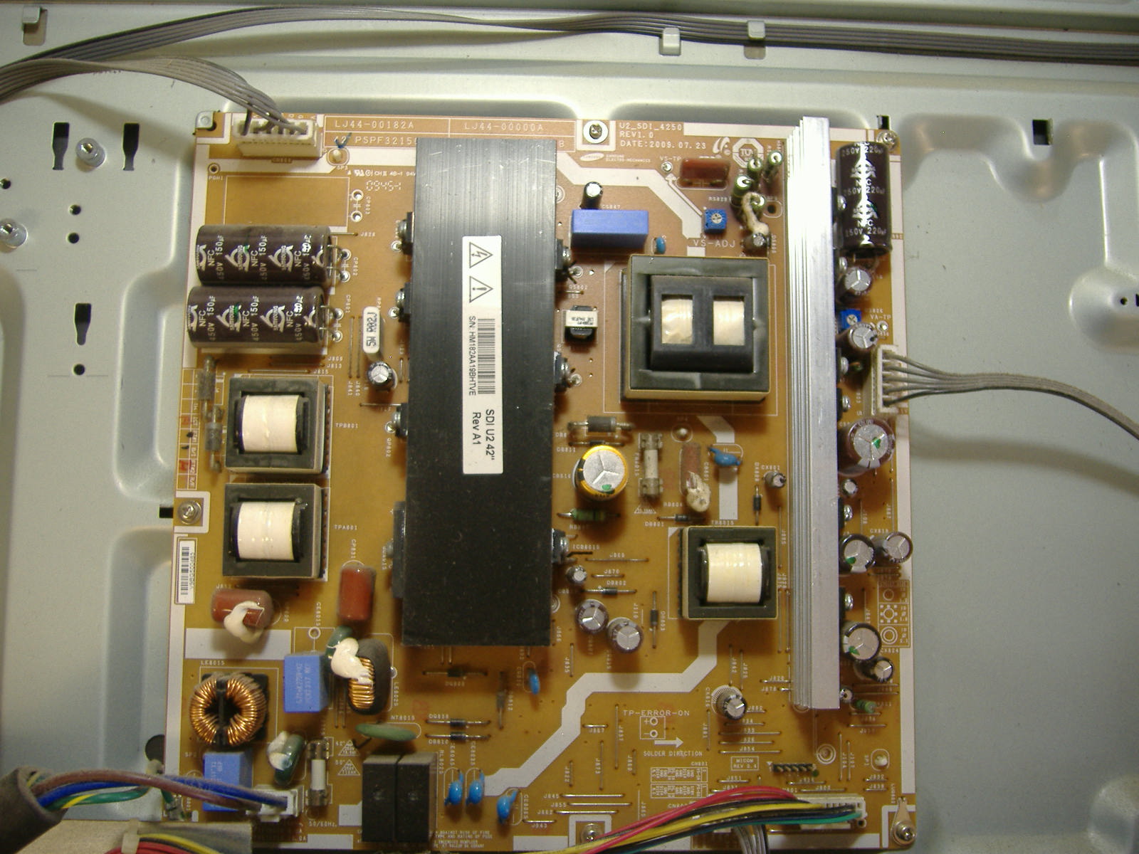

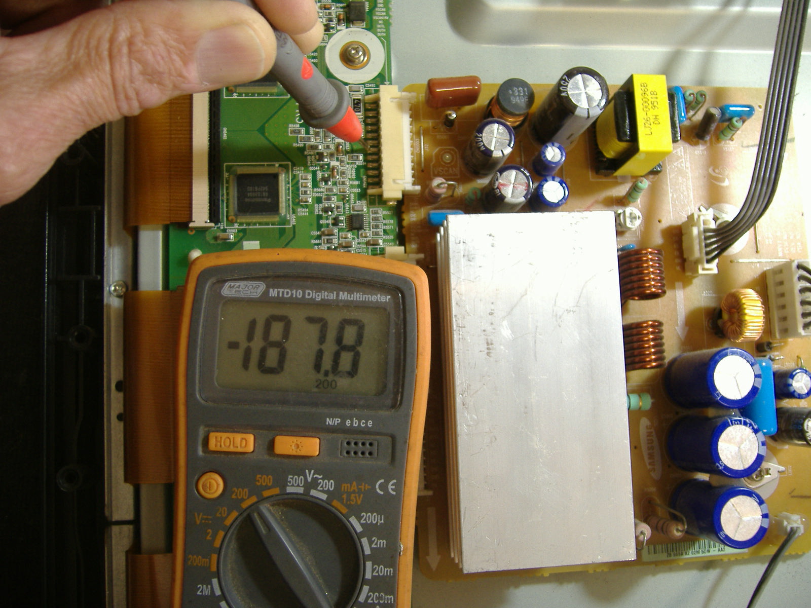

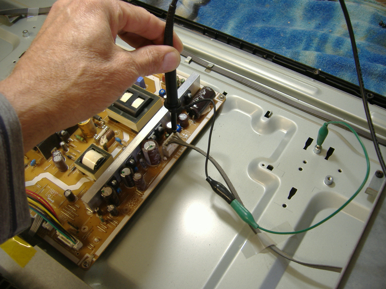

    Hi Guys, been repairing Lcd's, but sending Plasma's away.
    Now attempted to repair Telefunken TPM-420FHDB plasma, but got stuck, please help.
    Set switches on audio, no picture. (red led with mains in, then green led when pressing stdby button).
    Va = 55v

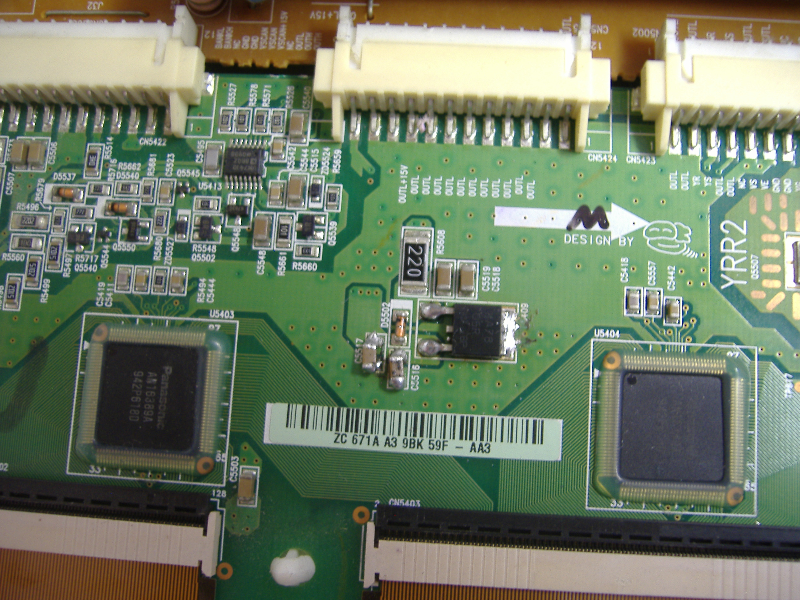

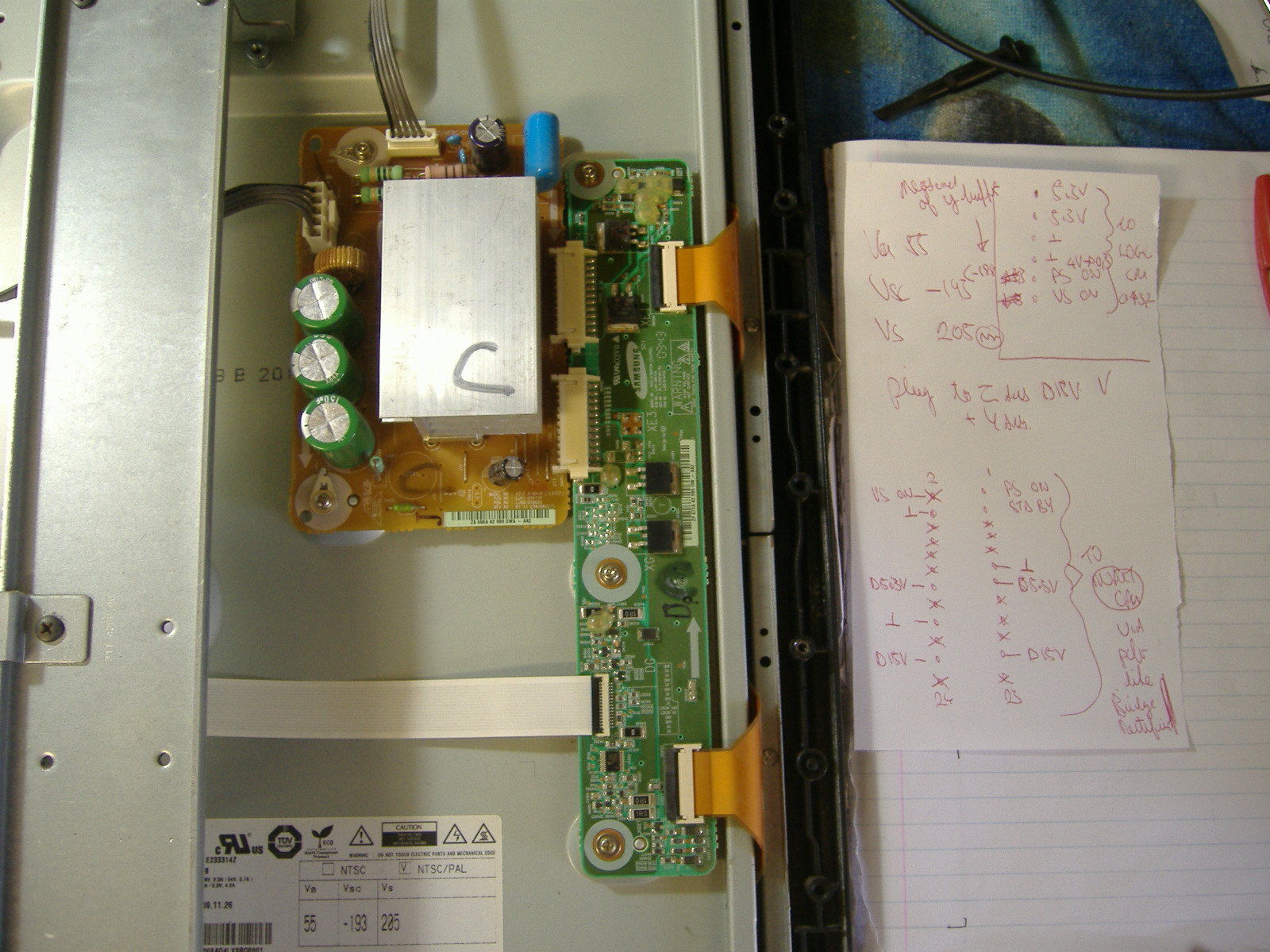

    Vs was 199 adj to 205 (photo 3)
    Vsc was -187.8 adj to -193 (photo 4)
    Vg = 15v
    Va = 54 (should be 55v)

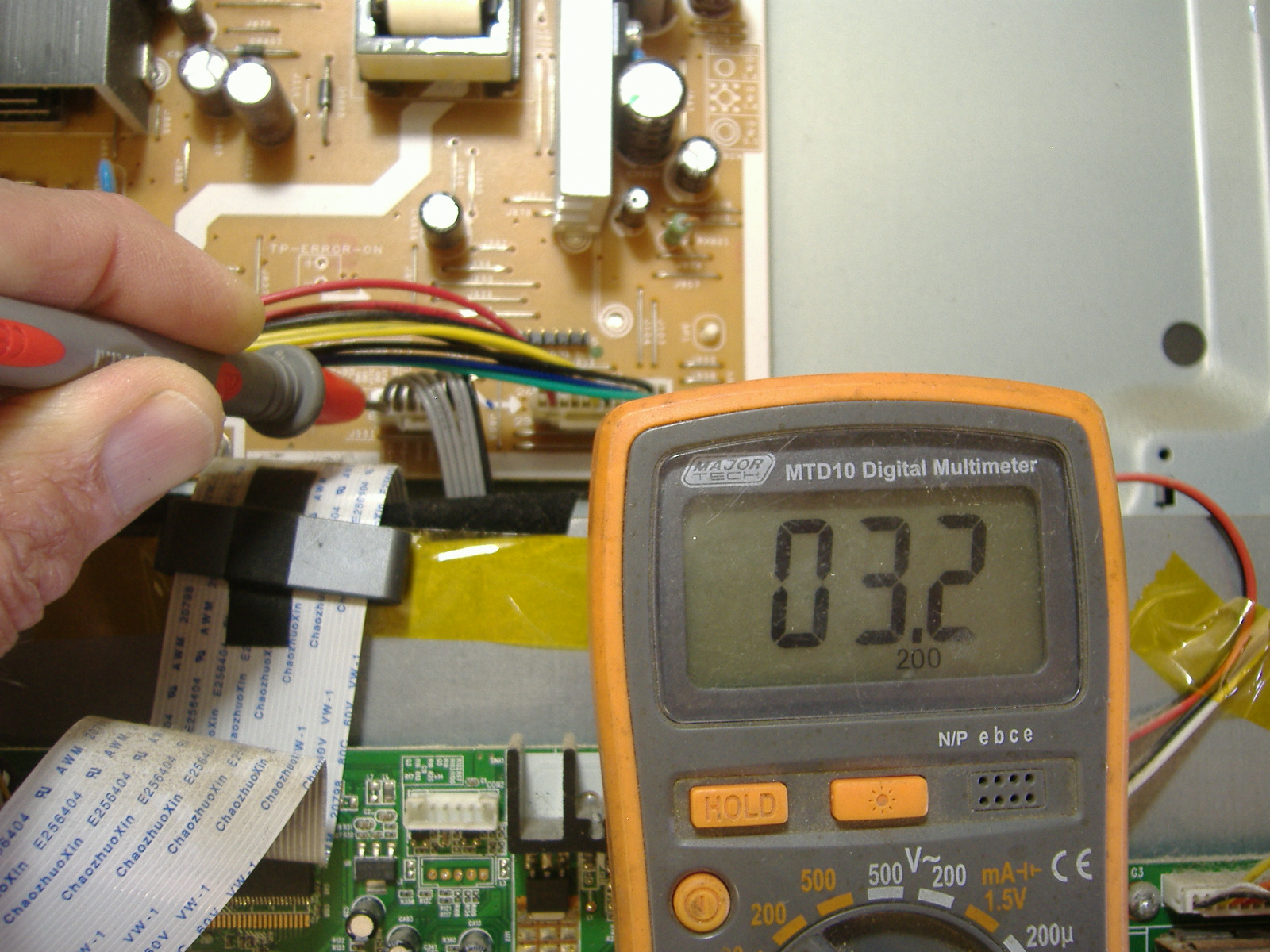

    Vs on = 3.2 ( photo 2)

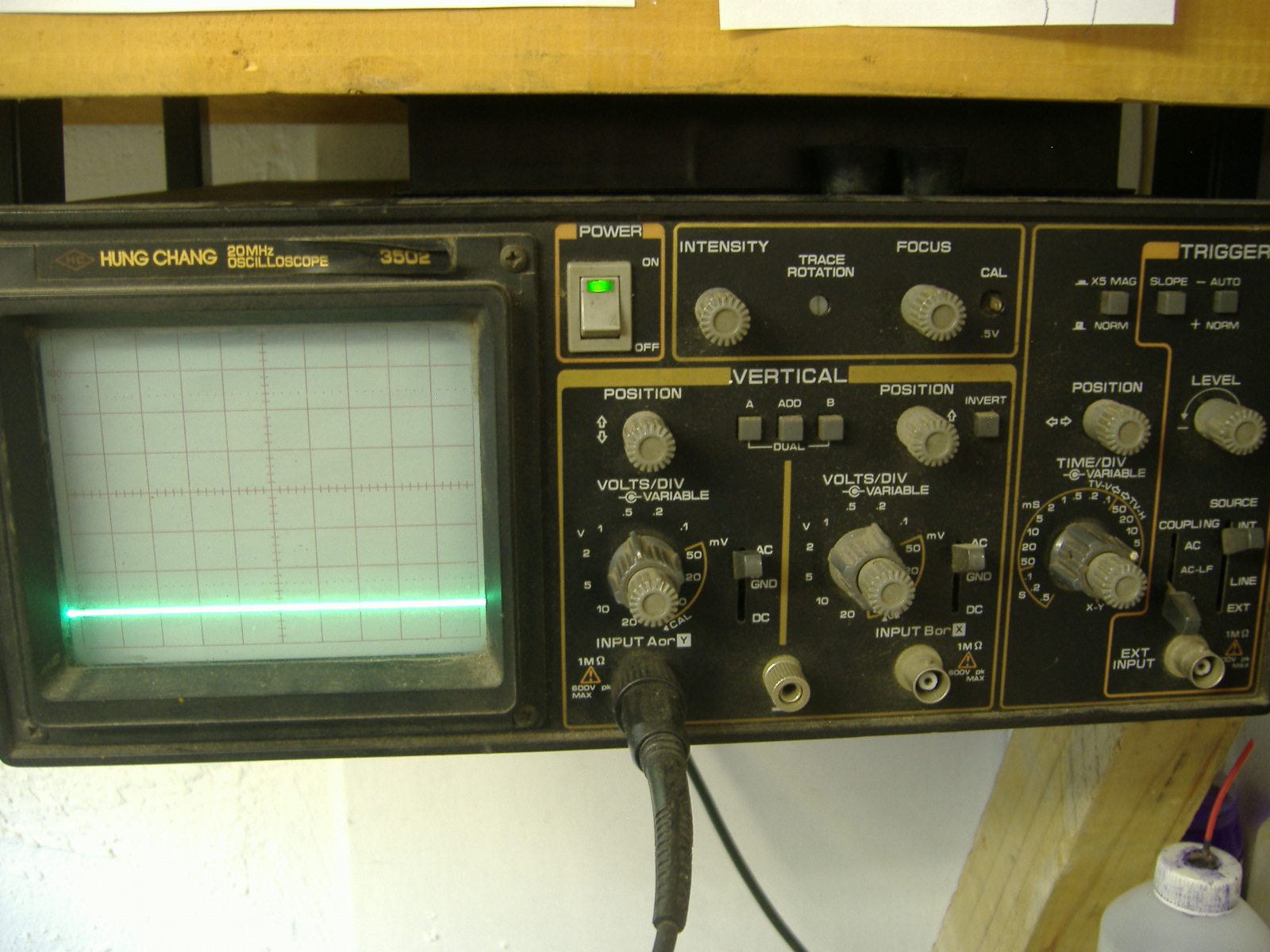

    Vs + Vsc scoped (photo's) 6+8)
    I see there is what I guess are two cpu pcb's one with the external inputs, and one that communicates to the Ysus & Zsus. The 15v Vg does get there, and so does the Vs on. So why am I not getting any illumination? Please Help.

    Seems odd that you dont get any panel emission as the sus voltages are up, do the voltages stay present and dont fluctuate rapidly or drop out ?

      There was/is a slight movement on the meter, say like 193.5 to 194.0 before I adjusted the Vs adjustment, but not a big fluctuation, or should it be rock steady? I also switched the light off (a bit of day light seeping in), but see absolutely no illumination at all.

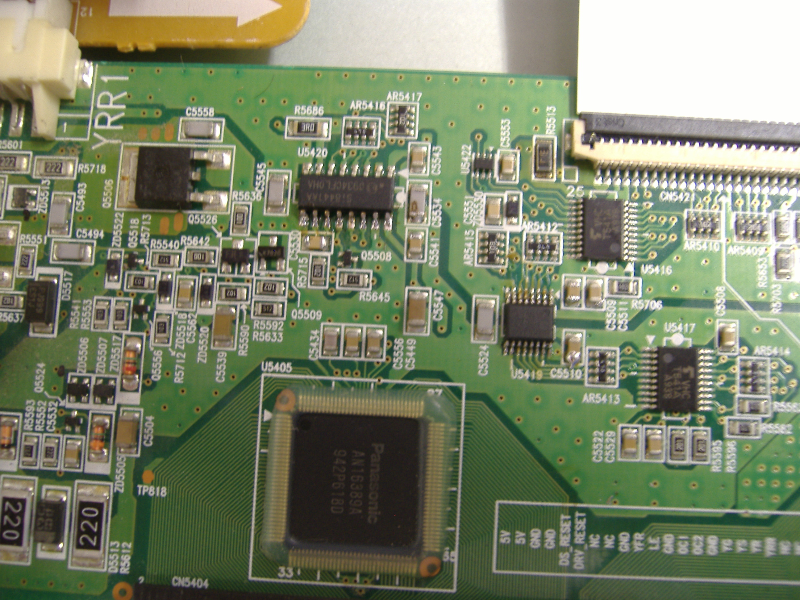

                      Yes thanks Reecey, there was a short on the buffer board. The output of (U4509 see photo) a KA7805R 5.5v regulator read 2.5 ohms to gnd. I traced the short to (u5419 see photo) UM7410 1Kv Quad channel digital isolator pin 16, which I changed but alas the symptom remains. The 5.5 volts came up, but I guess either the one I fitted was faulty, or that there is other damage?
