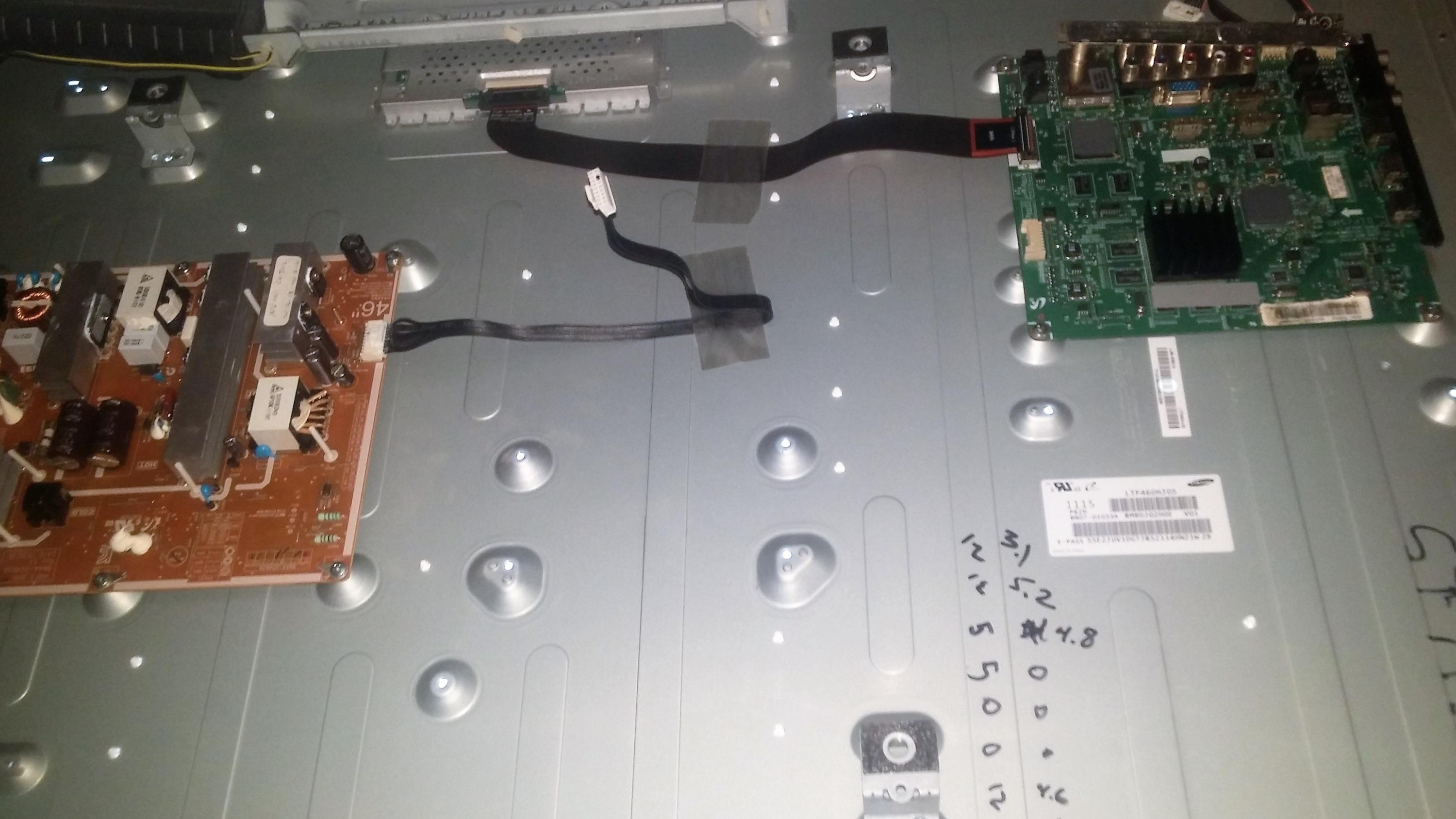

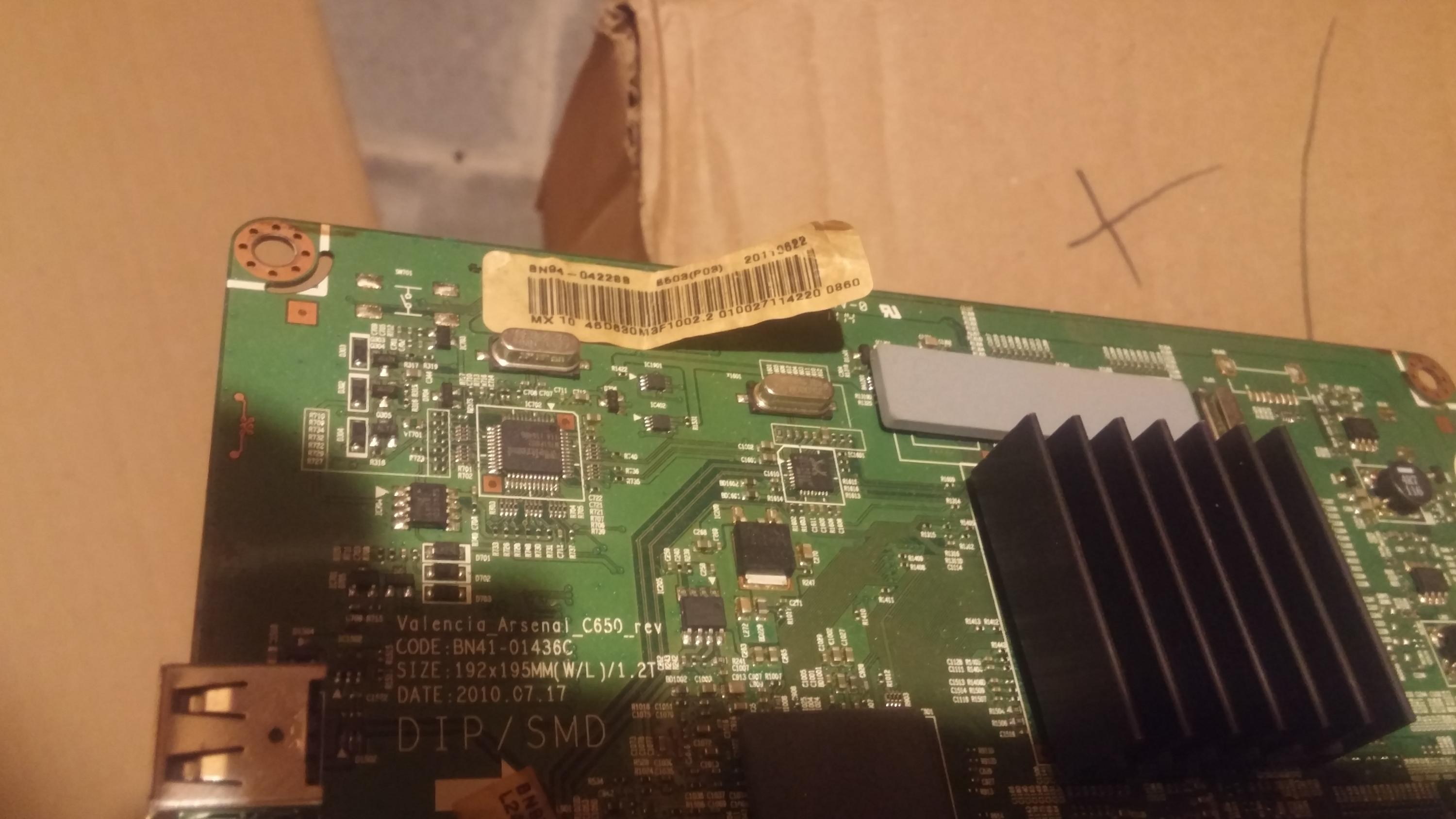

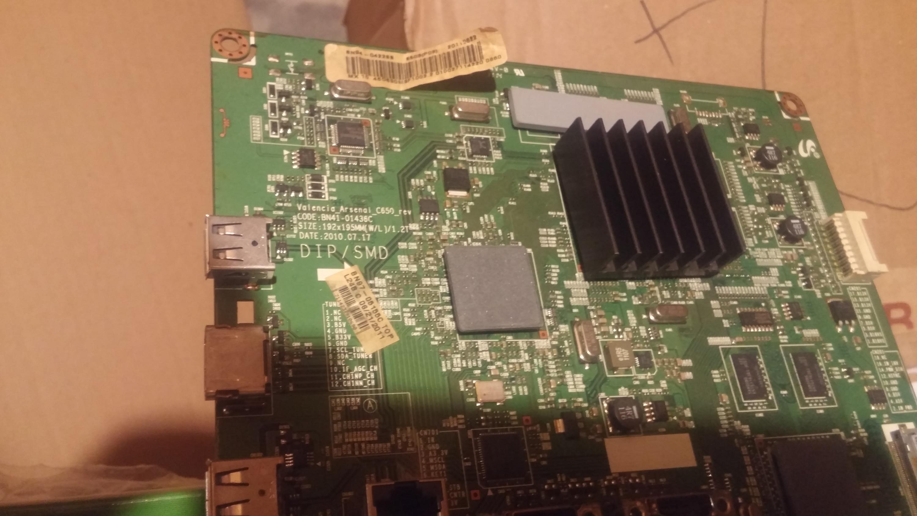

    This TV has no sound or picture. When turned on, the TV standby LED blinks three or four times repeatedly a few times, then stays off. The backlight comes on when the Power Supply-Main Board cable is left unplugged. Neither Power Supply or Main Board show any visibly damaged components. Leaving the LVDS cable disconnected makes no difference.
    I have replaced the main board twice with used parts, once with a substitute and once with the same part number. Symptoms stay the same.

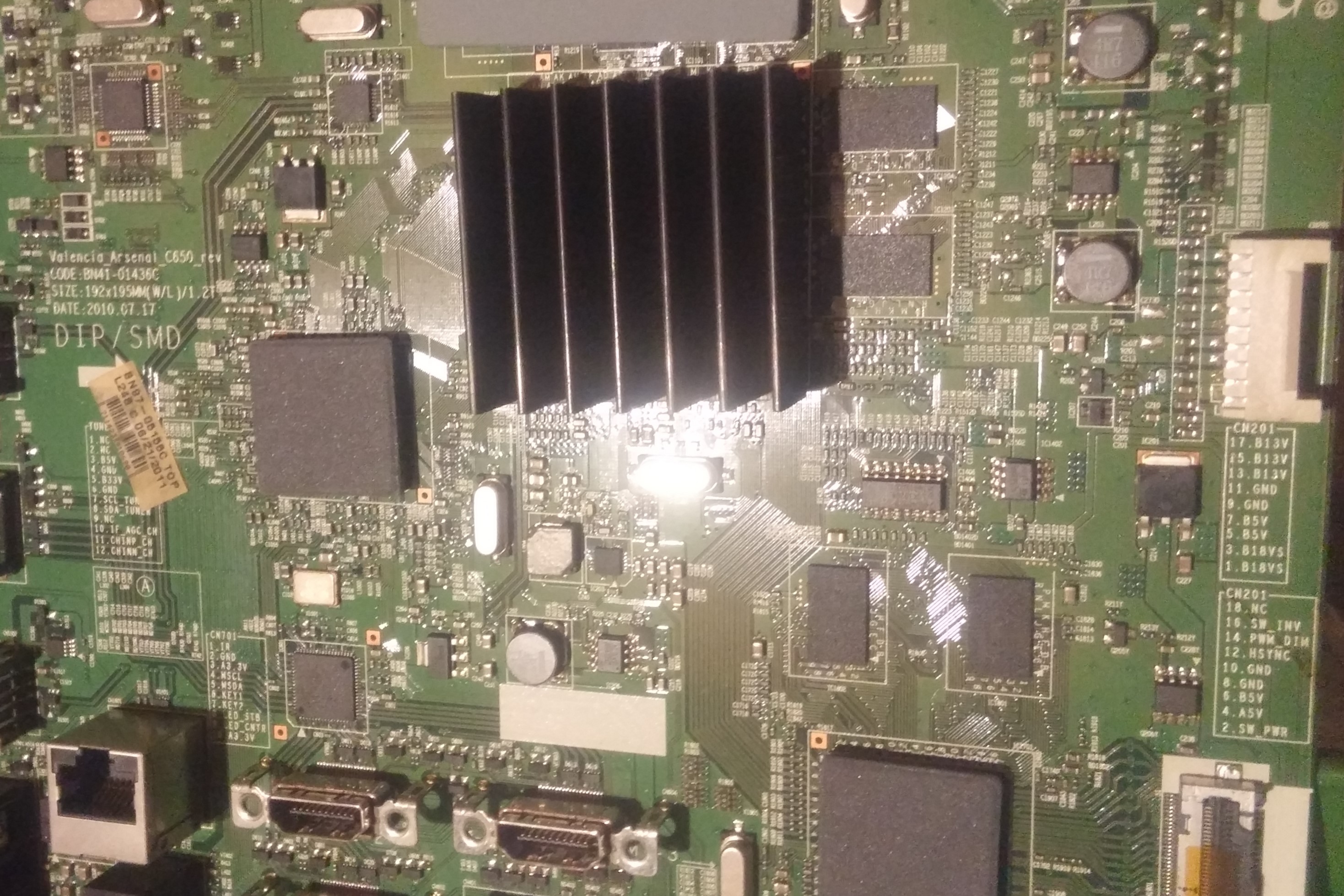

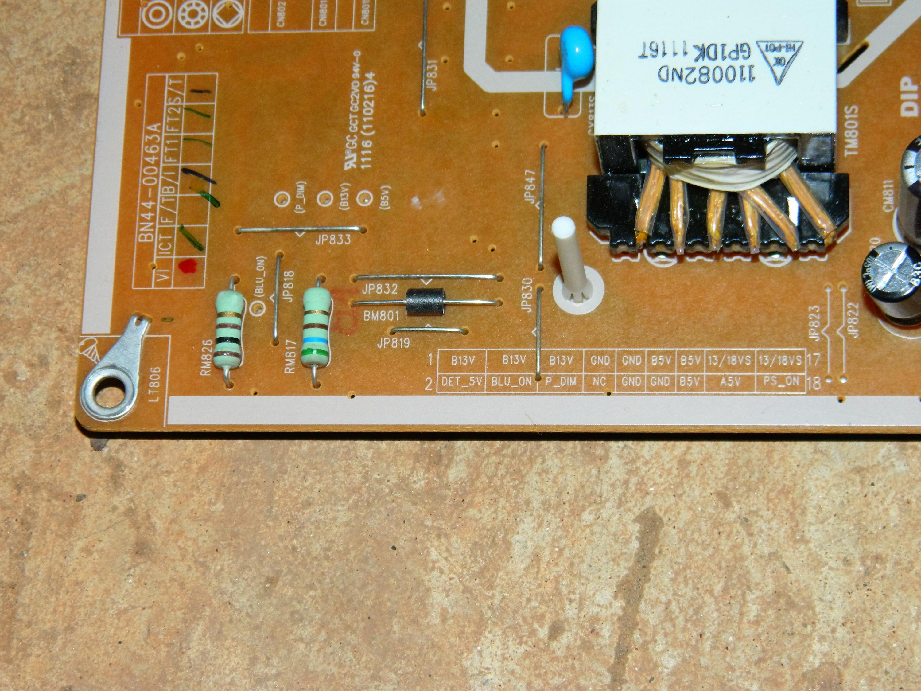

    I am posting photos of voltage readings at the PS/MB connector. After two unsuccessful Main Board replacements I'm not sure the PS is working.
    Voltages with CN201 disconnected is at the top of the fourth photo. Differences when CN201 is connected to the Main Board are noted below.
    Second opinions please?

      Here they are:
      CN201 connected:
      Pin Signal Reading Connected: Reading CN201 unplugged if diff:
      1,3 B18VS 12.0V 12.6V
      5,6,7 B5V 3.8V 4.8V
      8-11 GND 0V
      12 HSYNC 0V
      13,15,17 B13V 12.6V
      14 PWM_DIM 4.6V
      16 SW_INV 4.8V
      18 N/C
      4 A5V (STBY) 5.2V

        Could you post a high resolution, straight shot picture of your PSU front and back, please?
        Only thing I can see is something doesn't rhyme up on pin 1 and 3. Label sez 18V and you get 12V? But then the backlight shouldn't be working either when the main board is unplugged... weird.

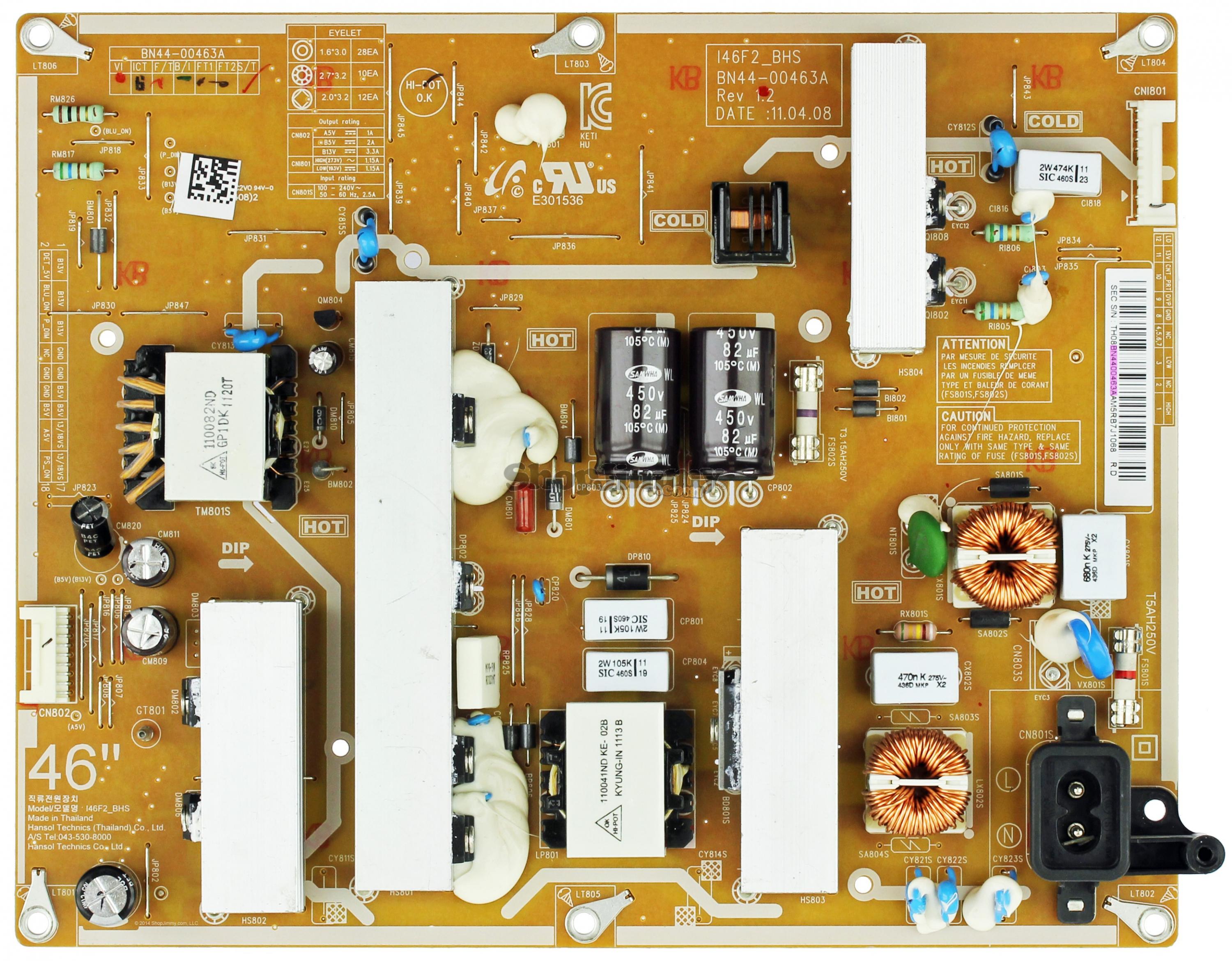

          On the PSB those pins are referenced 13/18VS. The backlight receives power thru a different connector, CN1802. I have downloaded the quickstart service manual for the tv. It shows 13V on that pin.

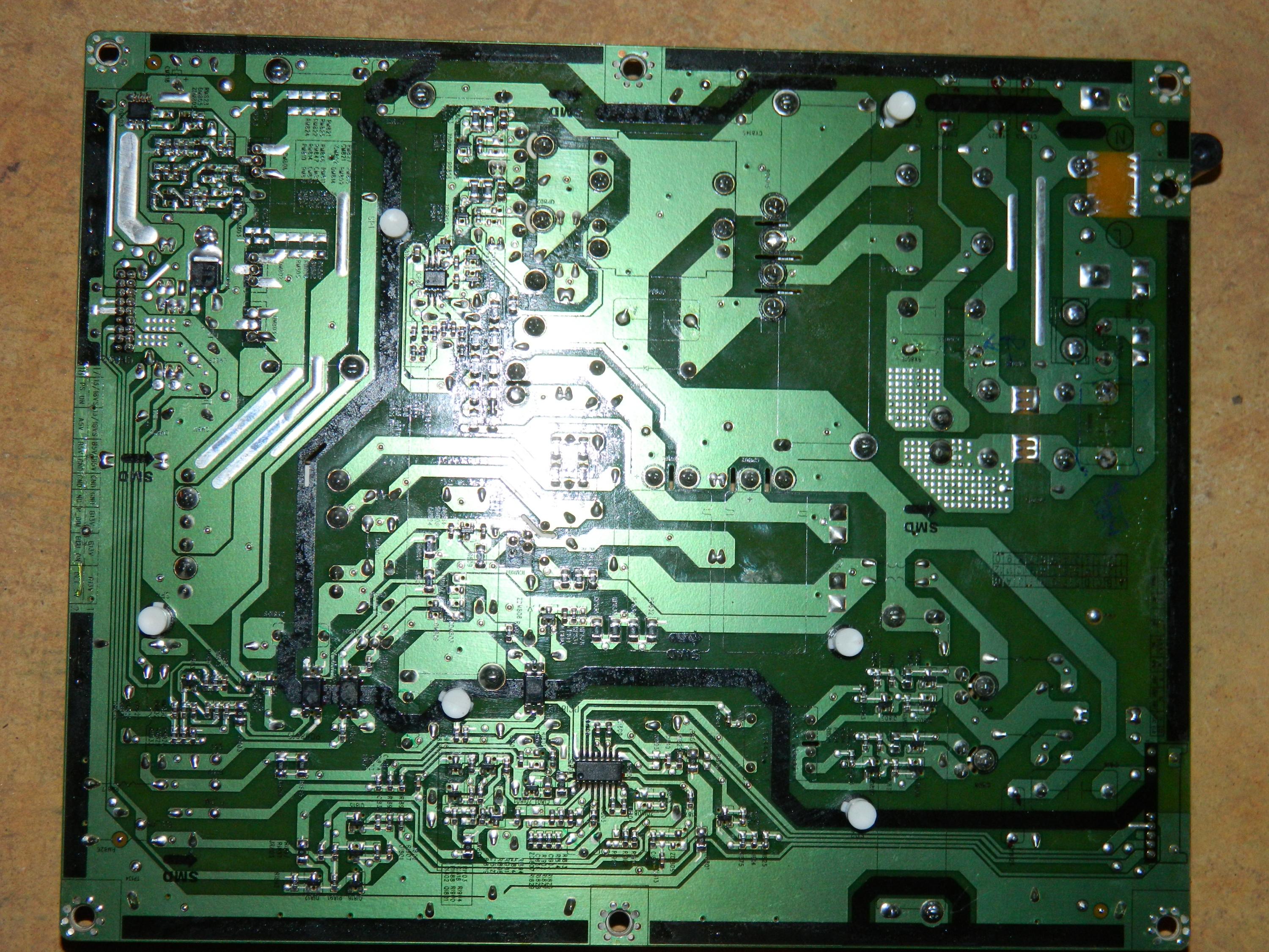

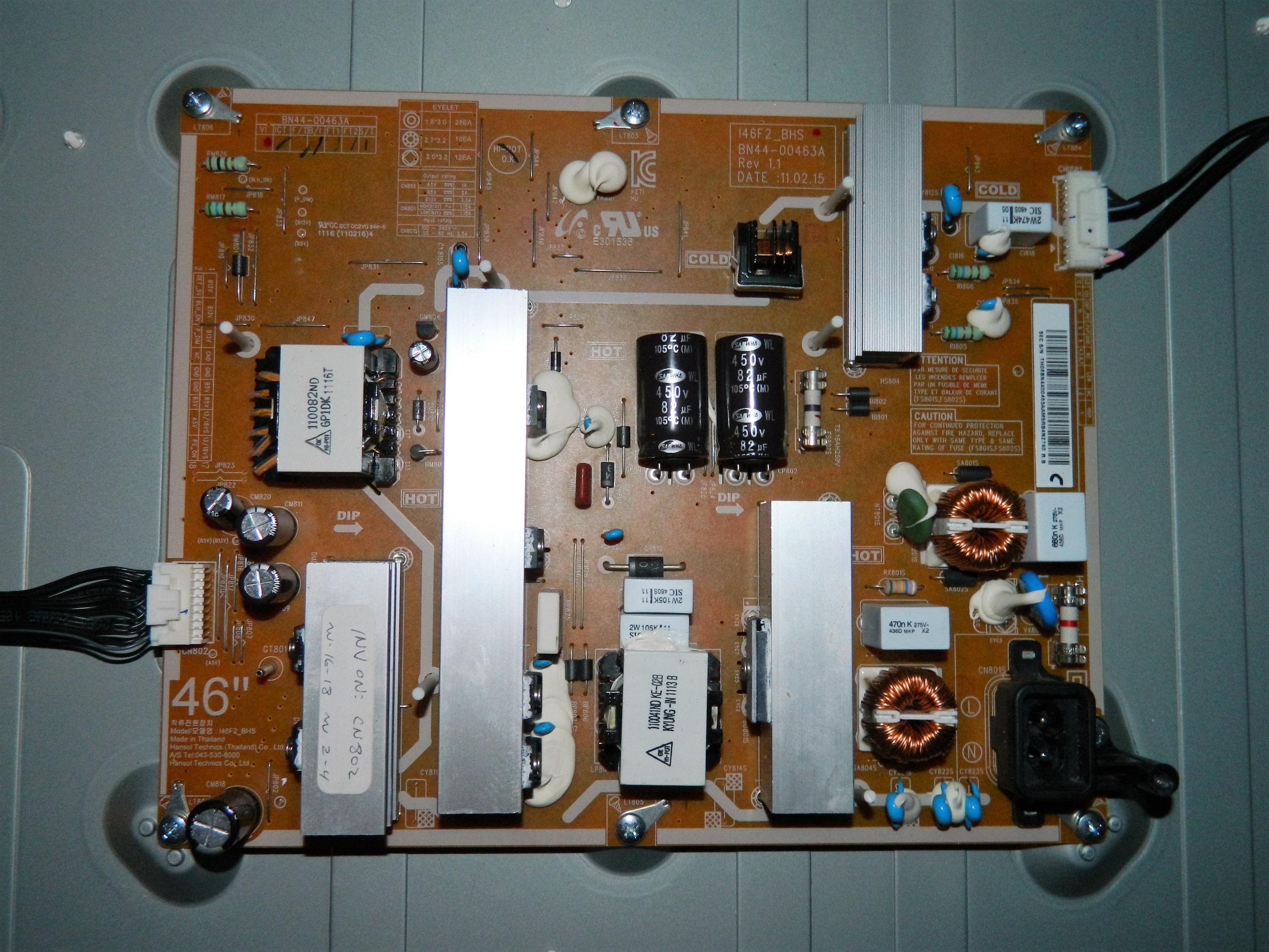

          Attaching board photos of the Power Supply BN44-00463A.

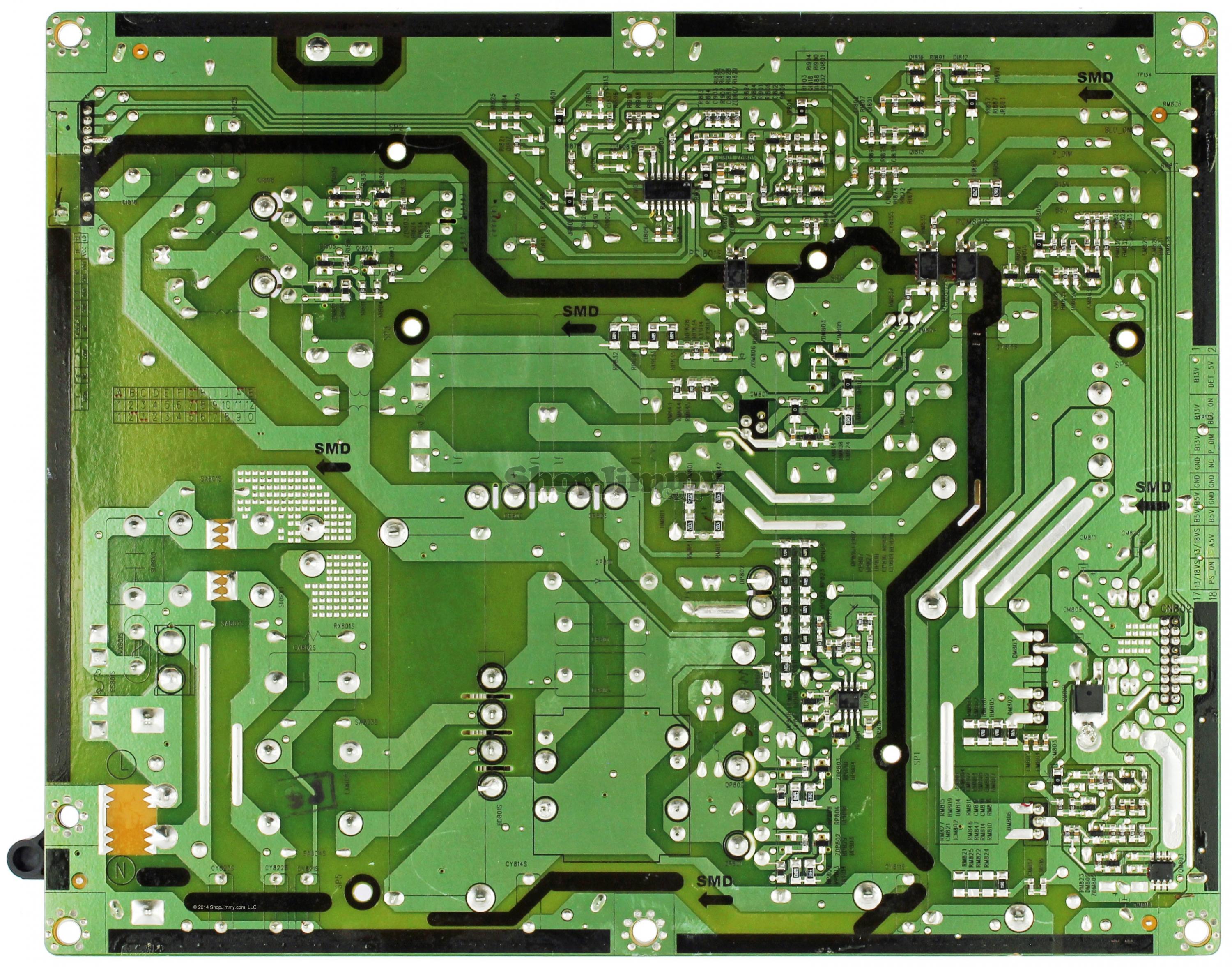

              Re: Samsung LN46D630M3FXZA blinking stby LED
              BN44-00463A
              http://www.shopjimmy.com/samsung-bn4...upply-unit.htm
              Pictures provided by shopjimmy.
