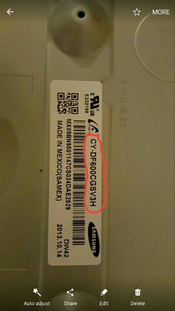

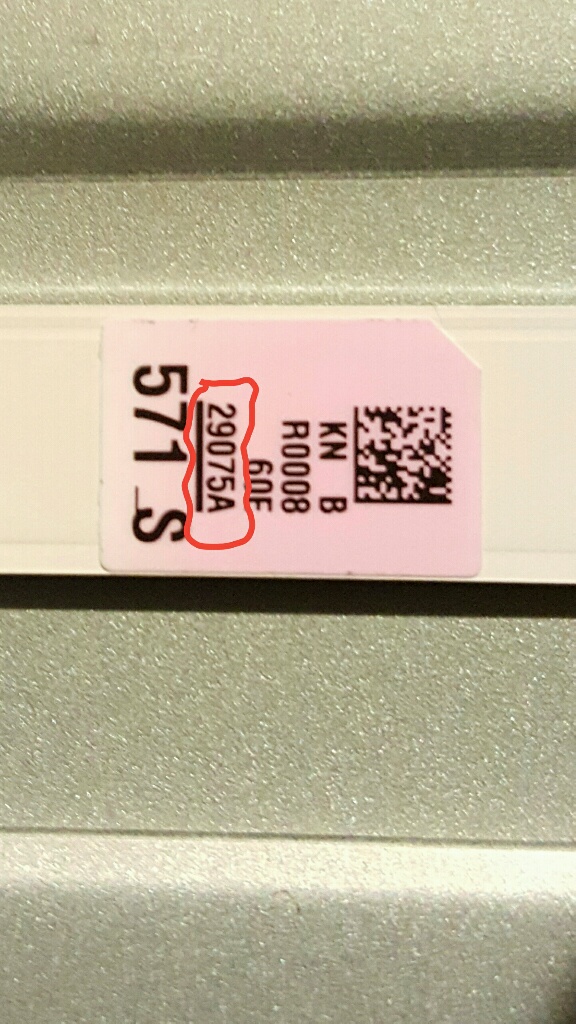

        One last thing, I've found a full set of leds online and they list in the description that these replacement leds will work on a tv with the same panel number as my tv and has the same part number but they came out of a different model tv. I remember watching a video from shop jimmy where they said that leds are panel specific. Does this mean that if the panel numbers and part numbers match I'm good to go?

            Where I'm having trouble though is with all these part numbers. My panel part number matches exactly and the numbers on the led strip match but other numbers don't match

              Re: Samsung UN60FH6003FXZA
              it was a trick question,I have a ton of LED strips and prob could have helped you out.
              Anyways,if you ordered on panel number you should be fine.no worries
                  Ok, I feel like a real douche. I apologize Marino, you were just trying to help me out and I appreciate that. I want to give an update to my repair.
                  Ok, I located a full set of LEDs on Ebay. They came from a different model Samsung tv but the numbers on the LED strips themselves matched do I gambled and it was compatible, awesome, right....yes and no. I had them installed and I tested to make sure they worked and they did. I was so relieved that I finally could get this thing put back together and off the floor in our spare bedroom/wife's closet. Everything was going great and upon snapping in the bezel I hear a faint "tick"sound and I knew what it was. THE SCREEN CRACKED!!!! Are you kidding me? This has been an adventure and I feel that I will succeed next time.
                              Panel: CY-DF600CGSV2H
                              Strips: D3GE-600SMB-R1 and D3GE-600SMA-R2
                              I'd really like to know a part number for the led's only, so I could just replace each individual led. I've been doing it on the LG, Toshiba, and Vizio's. Has turned out great.
