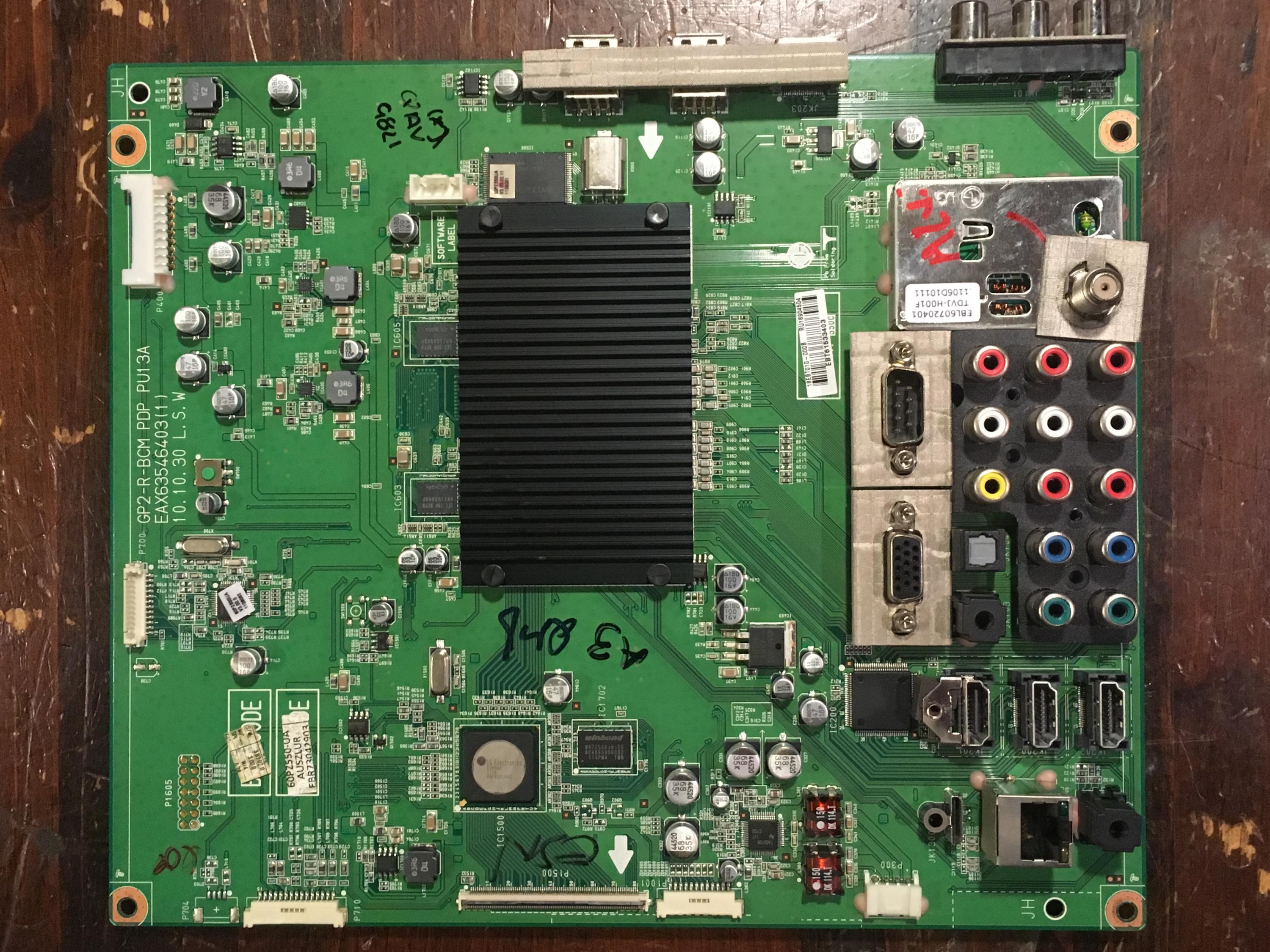

    LG 60PZ550-UA has picture and sound via tuner but no HDMI and no video on AV
    Hi everyone
    I have an LG 60PZ550-UA that has picture and sound via the tuner but no HDMI and no video on AV, but has audio on AV.
    The main board identifiers are: (see attached photos)
    GP2-R-BCM PDP PU13A
    EAX63546403(1)
    10.10.30 L.S.W

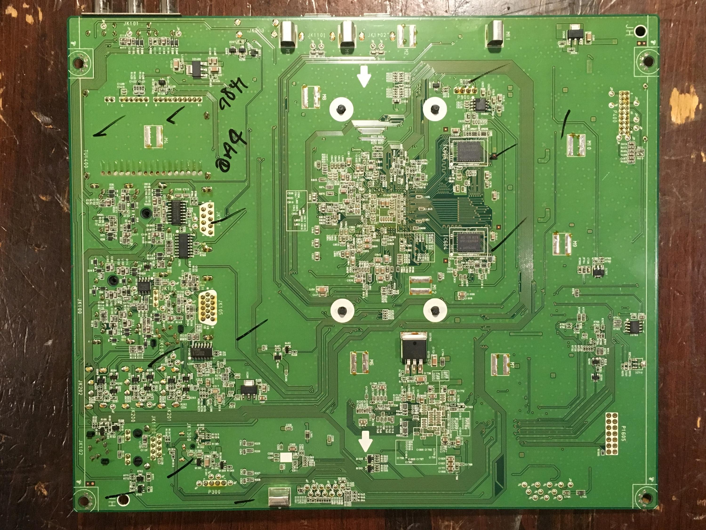

    I have the service manual but have found typos. Some of the typos I have figured out. On the main board I still cannot find L201 or IC200, but I did find an L200 and IC201.
    These are the voltages that I have check and are good.
    Main board voltages:
    L402, L405, L414, L415, L416 = +5V
    L403 = +17V
    L411, L413 = +3.3V
    IC403 = +2.5V
    L200 and IC201 are on the back of the main board. I would appreciate any suggestions on how to measure the voltages on the back of the main board with the cables connected to it.
    My thinking thus far is that I should be looking for something that HDMI and AV (video) have in common.
    Thanks in advance for any help

    Re: LG 60PZ550-UA has picture and sound via tuner but no HDMI and no video on AV
    If the problem was due to a lightning strike then it may have taken down the HDMI/AV chip which looks like IC200 which is alongside the 3 hdmi ports in your photo.

        UPDATE
        I believe the problem is IC501 ( LGE3549XSP). I have since verified that the COMP and RGB-PC inputs do not work, in addition to the HDMI and AV (video) inputs. Since the TV works just fine through the tuner, I plan on replacing the main board.
