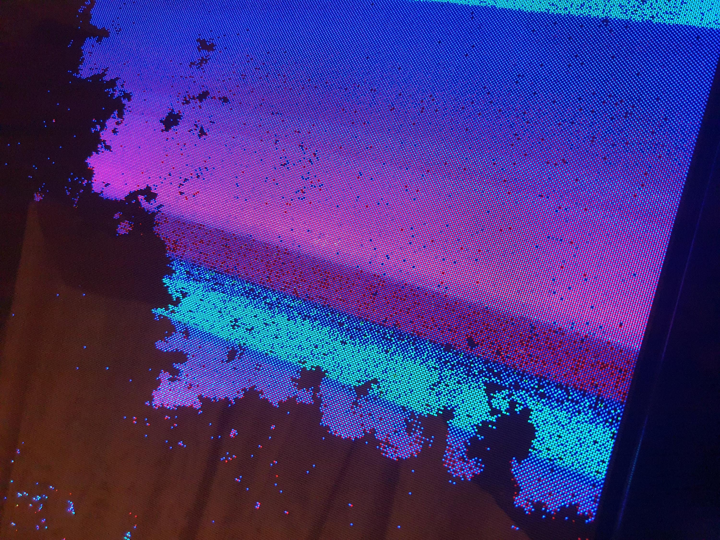

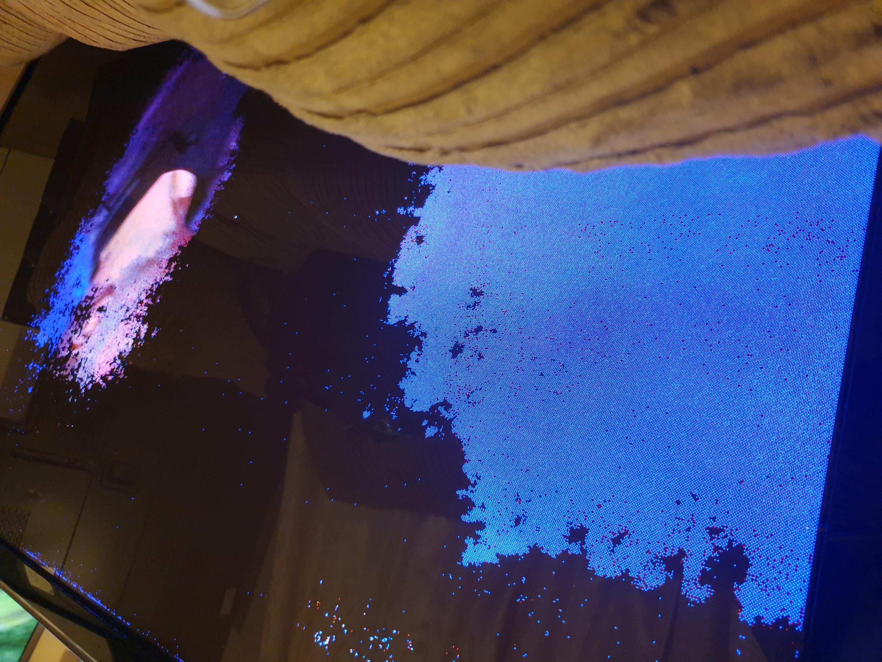

            Hi Reeceyburger123 i read your problem with the screen cracking that same thing happend to my friend with his D series, he did scrapped his in the end. i myself has the same model what you did have. my picture has gone all funny all of a sudden the picture is gone patchy and pixelating parts of picture is missing .. it looks like the y sus or x main board is at fault. or maybe its the screen is shot.. any idears ? i try upload pictures.

              D series has fucked me over a couple of times now mate, not sure what happens. There must be a direct short happening in the panel during ignition stage of the pixels which is slightly more power, shorts out, goes really hot then pops the glass.
              Had one a few months back now, spent ages rebuilding both sustain boards and when powered up big red spot, panel cracked and blew my £30 transistors out again

                X sus is faulty mate there.

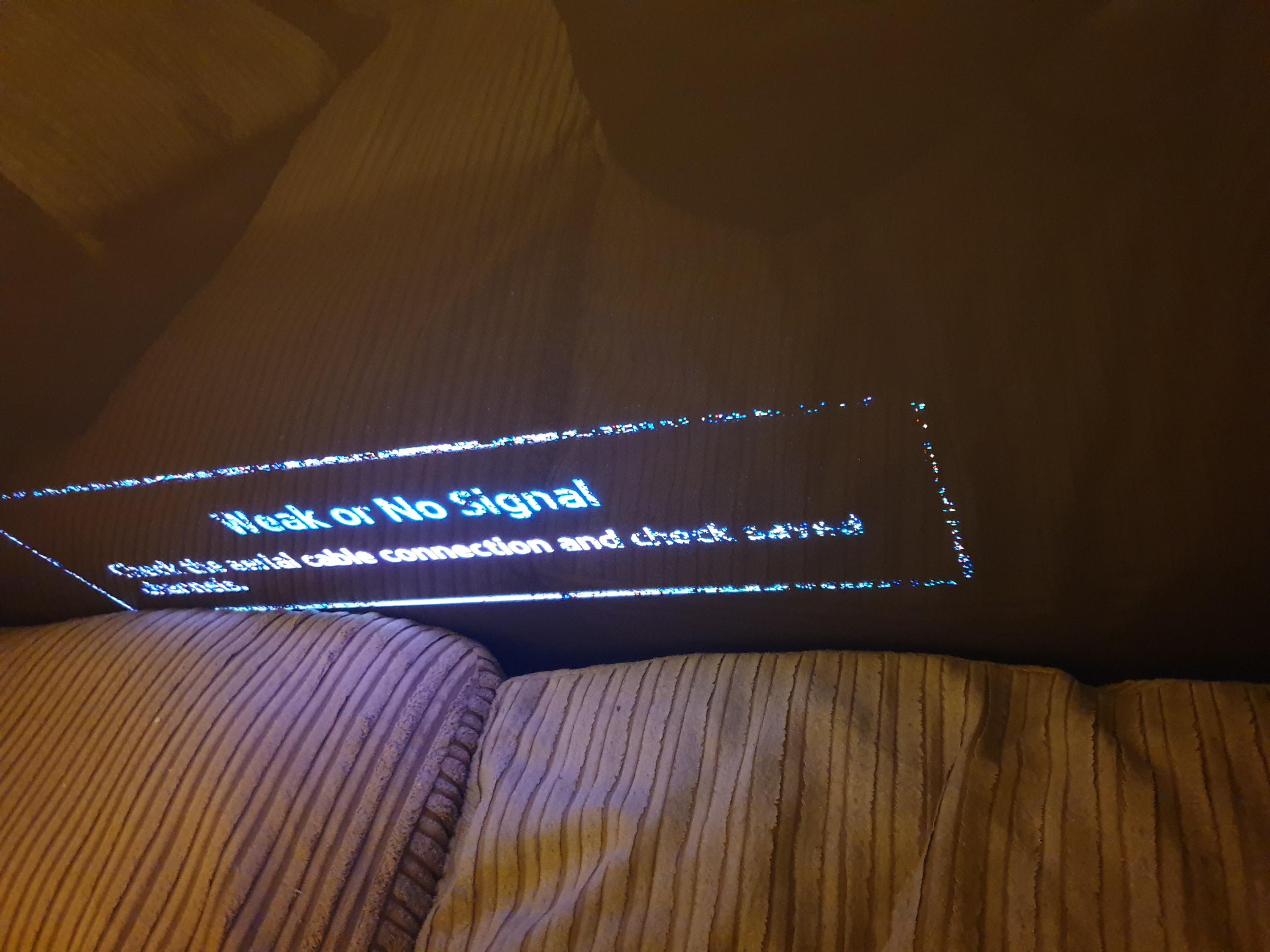

                  I got this 55 inch AU7X00 TV, it was rebooting and showed no image only a blink of the backlights.
                  I assumed it was either panel or motherboard. Turns out it was the panel, and after applying some tape on the ribbon cable that goes to the left side of the screen, the TV turned on with image, then I suddenly noticed a dark spot and the pixels were turning black on the left edge, I was sad and thought I smashed the screen somewhere, found nothing visually, it looked in perfect condition and if it was there before it would've been noticeable while I was inspecting the TV the first time....
