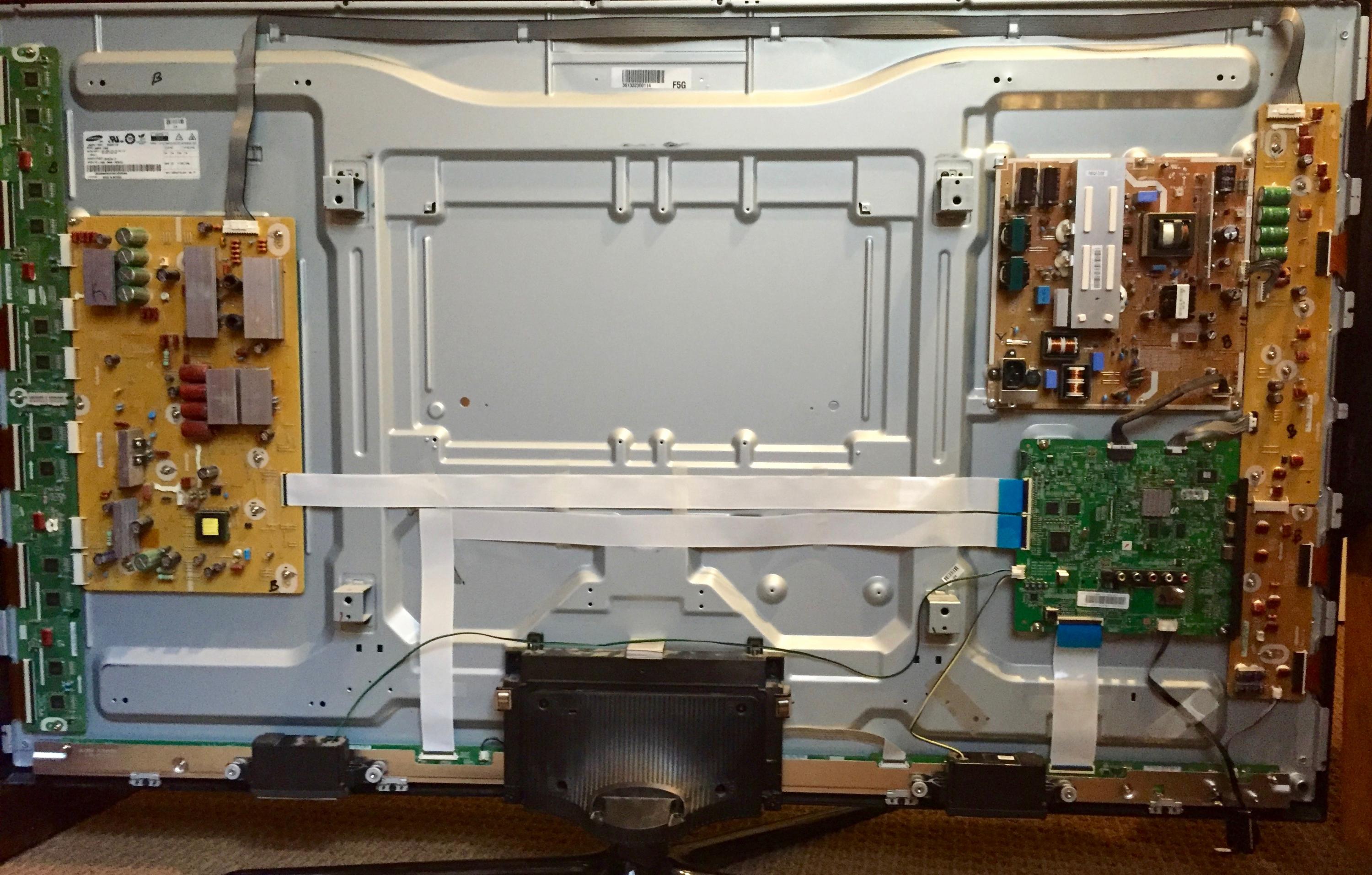

    This is all new to me, so I did some research. Afterwards, I then took the back panel off of it and checked the capacitors. I couldn't find any that were bulging, obviously damaged or leaking. I tried individually unplugging the X and Y sustain boards from the power supply board to see if the TV would turn on, but it still wouldn't.

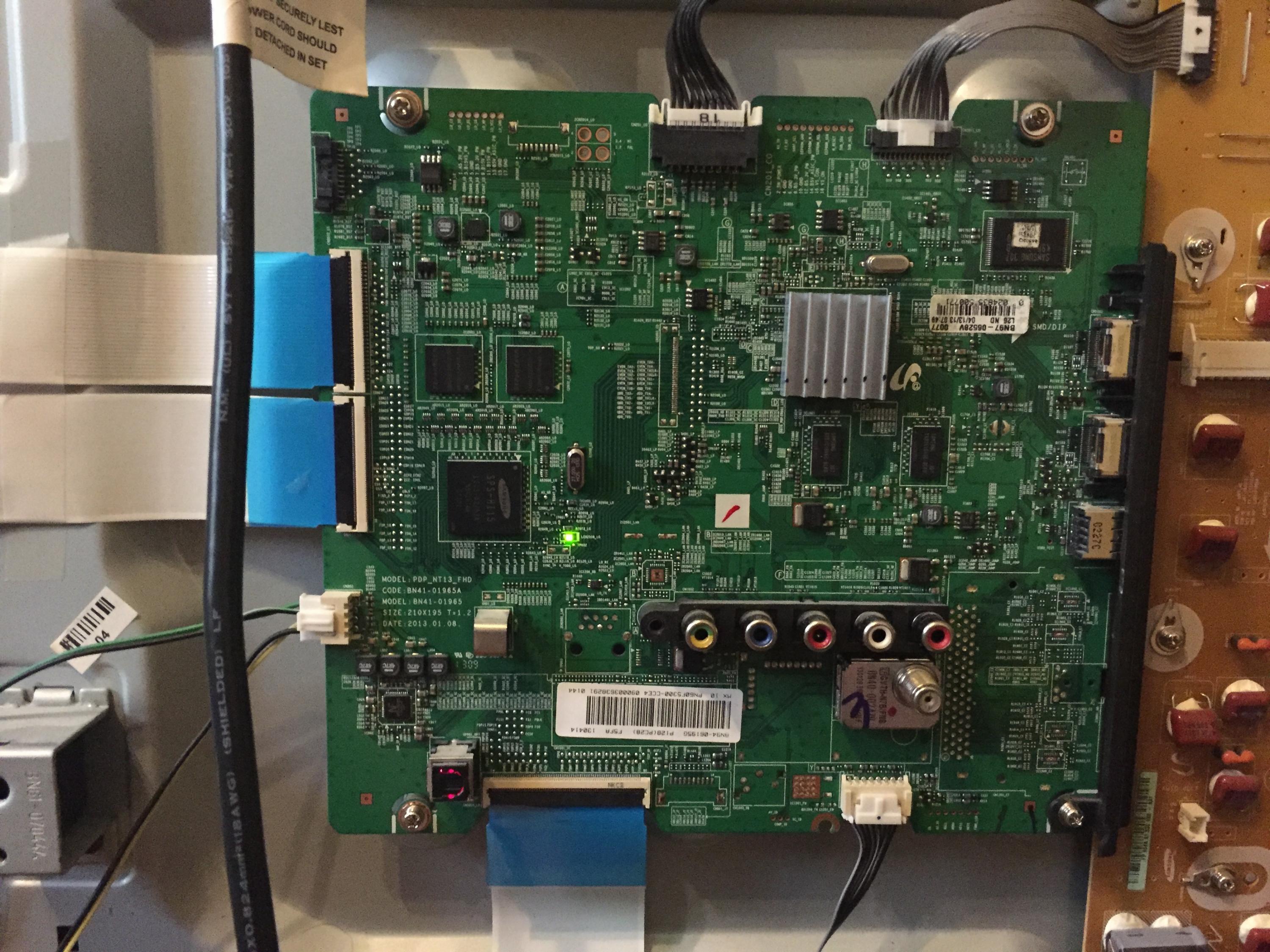

    At the moment (with all the boards connected properly), the standby light comes on solid when plugged in. If I try to turn the TV on with the remote, the standby light blinks about ten times then remains off. (The standby light usually turns off when the tv is on). Any further input from the remote causes the standby light to flash, indicating that the TV is responding to the remote. When I go to turn the TV off with the remote, the standby light comes on solid (which is what usually happens when the tv is off). There is no video and no sound during all of this.

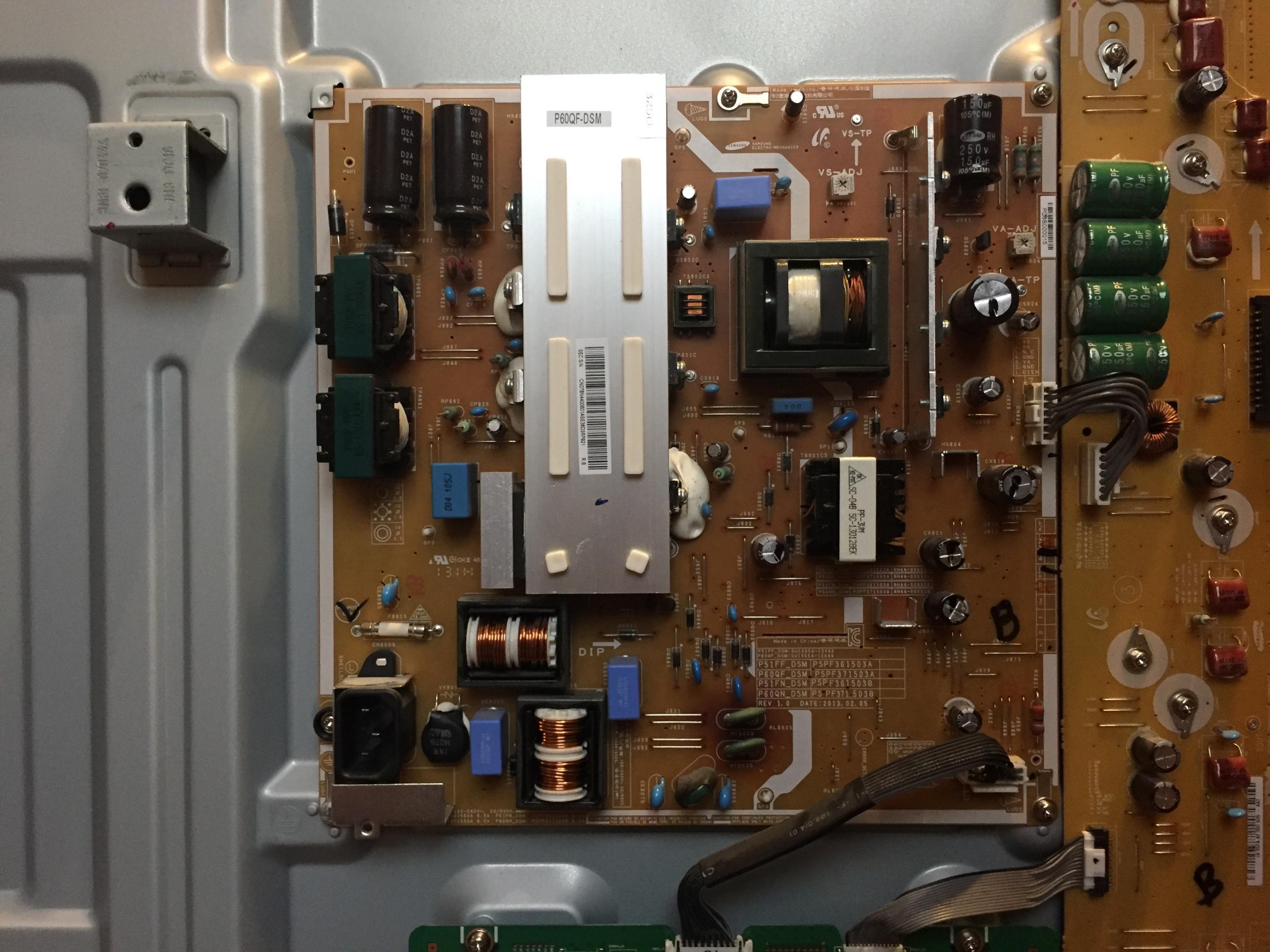

    Also, when I try to turn the tv on, a green light on the main board blinks every five seconds. I've read that this indicates some sort of internal problem. The VS/VA voltage test points on the power board also drop from 208/57 to 11/0, respectively, when the tv is fully connected and turned on. On the Ysus board, the VE/VSC voltage test points stay at 11/0, respectively, which is lower than 108/-192 (what it's supposed to be).

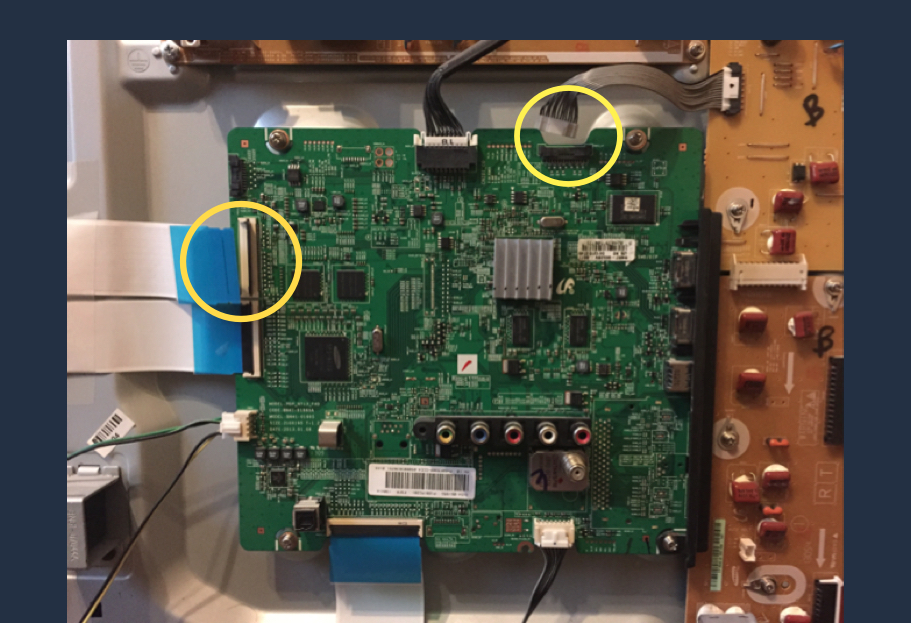

    I tried unplugging different ribbons and cables to see if I got any results.
    I found that when the ribbon cable going from the main board to the Ysus and the cable going from the main board to the Xsus were unplugged (as pictures show), the green light on the main board blinks every second. Which I think is what's supposed to normally happen.

    Ok, so I checked the voltages on the back of the TV with a multimeter and found the Ve and Vsc voltages to be lower than their ratings. These are both located on the Y sustain board. I also checked the voltages coming into the Y sus board through the cable, and they all seemed normal. So, I concluded that the Y sustain board was bad.
    After some research, I decided to replace the Y sustain, Y buffers, and X sustain. (I had read that the Y buffers should be replaced with the Y sustain, and that the X sustain should also be replaced due to the way the power cord is linked between the X and Y sustains.)
    After receiving the correct parts, I replaced them and turned the TV on. The screen came on, but it had red blue and green sparklies all over it. I read that this can be fixed by adjusting the voltages to their proper values. I used the potentiometers to adjust the voltages to their proper valures. This reduced the sparklies, but some still remained (the worst part of the screen was the lower left corner). I then, after some more research, decided to slightly lower the Vs, Ve, and Vsc voltages until the sparklies were not noticable at the proper viewing distance. This worked out and now the picture is nearly perfect. The only problem is that some greys are not represented properly and make whiter images look sort of wierd. But it is watchable.
