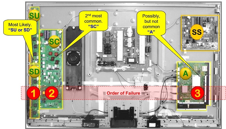

      Re: TCP60ST50 7 blibking red lights
      Decided to have a professional come out. Receiving 3 red blinking lights. They tested A board and power supply. A board and power supply working.
        Well i don't think the panel is bad. With a bad panel the tv will stay on but makes a big buzzing noise ( Cracked panel ) or gives a bad picture.
        It would also stay on with the SC50 jumper because the buffer boards -> panel are not used. Thats why they created a SC50 connector , to let the tv work without the panel.
        The blown mosfet on the SC board is caused by something else. Either bad soldering/fake component or a short because you accidentally touched something. Maybe bad SC board version? for example TNPA5335 AG and you used the BG model.
              Are you trying the SC50 test with the SC board that has a blown mosfet or did you buy a brand new SC board?
              The SC50 test only works if the board is 100% good and all other boards except buffer boards are good.

                    #69
                    You don't need these guys to look at your tv. You are wasting your money!!
                    They told you the tv has a bad panel but they don't even know or tell you that you got a shorted SC board in the tv. Next thing they start replacing capacitors....
                    The Panasonic tv's are designed to detect failures in the whole set. If it detects a failure in a circuit the tv will go in protection so it protects all other boards for shorting out. The error led will give a small hint where the problem is.
                    This whole time you are testing the tv with a shorted SC board. You can try the SC50 jumper for another 500 times but it will never turn on.
                    First thing you need to do is cancel those "professional" guys and order a new or used SC board for your tv. They are on Ebay for $35.
                    When the new board arrives , you need to check the new board for shorts. Sometimes you can get a dead board.....
                    It's easy to test on this shorted SC board. Just get your meter , put it in diode/beep mode and put both propes on the SC2 connector. It will beep and beep is a bad board.
                            Ok , in my opinion they can't say that the panel is defective when you are testing with a shorted SC board. Again , thats my opinion.
                            The blink/repair chart does mention a bad panel when the tv is blinking 3 times but thats with a good SC board! Your board has one and probably more blown mosfets!
                            1 Remove the buffer boards from the tv and test them for shorts as in in the youtube video! No beeps and the buffer boards are probably good.
                            2 Get a used/working SC board and test the board for shorts before you install it in the tv.
                            3 Check the SS board for shorts.
                            4 Install the SC board and leave the buffer boards out of the tv. You don't need them for the tv to work. Use a harddisk jumper or screw and test the tv with the SC50 jumper. ( short the pins ).
                            Tv should turn on with a green led and no image if all boards are good!

                                #75
                                I don't know , they probably read it in the manual.
                                There can still be a chance that the panel is bad but a bad panel usually shorts the buffer boards! It happened when you watched tv right? Im sure one of the boards is bad , we just need to figure out which board is defective.
                                Again! We need a good SC board and we need to test WITHOUT the buffer boards.

                                    #77
                                    This is the chart for this model , found it online!
                                    On the pictures you provided i saw that the buffer boards are connected on the "new" SC board. If 1 chip on the buffer board is bad it can short the SC board also.
                                    Thats why we need a good SC board and check the SS board for shorts.
                                    Im off to bed , i will follow this thread and i think i have the same boards so i can measure if you want to be sure! Could you please tell me the board names?
                                    SU/SD and SC board names please! I will take pictures how to measure the boards with a meter with the same boards.

                                      Thanks. SD board is also short.
                                      • Moreno83
                                        • Jun 2014
                                        • 2008
                                        • The Netherlands
                                        #79
                                        Ok , almost certain thats the reason why your tv turned off while watching tv.
                                        Buy new buffer boards and sc board and tell me when they have arrived and we go on from there!
