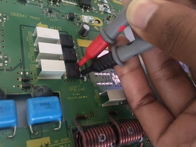

                          Hello! I am currently testing the SS board. When I first touch probes to SC11 prongs, my meter beeps in continuity mode. If I re-test these probes, I do not always get a beep. Testing soldered legs (location DO 51, 52, 53) my meter beeps. I am testing the SS board tnpa5648af.
                          My new SD board has arrived. The SC board will be here Tuesday. I believe, if I'm testing the SS board correctly, that the SS is short.
                          Should I order a new SS board? I am on the verge of buying a new TV. I may still purchase it. However the thought of throwing this TV out, if the panel is working, does not sit well.
                          I have attached a pic of me testing DO51. Looking at Moreno's original pictures. I believe I am doing this correctly.
                          Probe to metal tab, probe to soldered leg...no beep. Probe to soldered legs...beep.
                            #93
                            Re: TCP60ST50 7 blibking red lights
                            All those are diodes and what you described is normal. Doesn't sound like the ss11 is shorted either
                              #94
                              Sorry but I am confused. On page 3, Moreno post 3 pics of himself testing probe to metal tab, probe to soldered leg. He also shows probe to both soldered legs. What is that testing? What should be the result when conducting both test in continuity/beep mode?
                                #95
                                Well I've already discussed on this page what to expect. The other post he states how to test diodes D locations and igbts Q locations. So the first image is a diode and the second is a transistor.
                                  #96
                                  Got it! I just noticed the D and Q on Moreno's pictures and on the individual boards. I also was confused when he said it would beep if short. I've been testing each igbt and diode with probe to metal tab and probe to to soldered legs. No wonder its beeping. I do feel silly but have learned a lot.
                                  With that being said SS is fine. I also went back and tested my first SC board. It also seems to be ok.
                                  I am now going back to test the SD and SU boards. I know I have 1 bad SD board but am curious to see if the original boards were actually bad now that I understand how to test these boards properly.
                                  Is there any other locations I should test on either the SC or SS boards beside the diodes and igbts?
                                  Thank you so much for your help!!! Y'alls expertise has been invaluable.

                                        #99
                                        My ST50 is working!!!! I can't say thank you enough to TW and Moreno.
                                        I received the new SC board and tested it for shorts. Everything checked out. I installed the SC without the buffers and did the SC50 test.
                                        The TV came on, green light on board, solid red led. I then tested and re-tested the new SD and SU boards for shorts. Those also checked out.
                                        After re-connecting everything, I fired up the TV and there was the beautiful picture I've been missing. I did have to adjust the ribbons on the SU board a few times but now I'm back in business.
                                        I could not have done it without this forum and to think I almost threw my plasma out because a "professional" told me the panel was bad.
