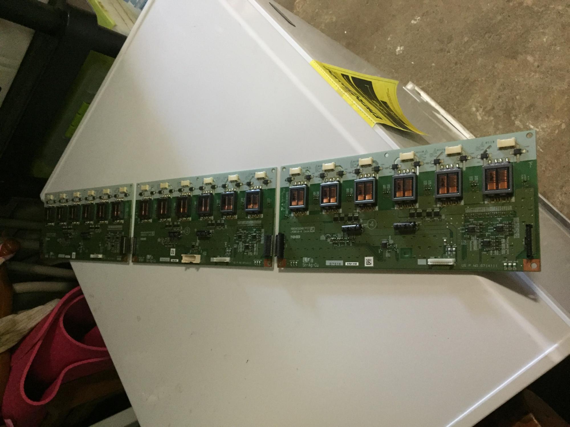

                      #50
                      Re: Please help I'm loosing my mind 65" tv
                      The transformer doesn't have to be lose, just one bad solder connection is enough. The 2seconds to black issue you have sounds like a classical bad secondary on one of these transformers. What happens is that the inverter shuts down because of over current protection kicking in. If a transistor, diode or ic would be bad, the backlight wouldn't come on at all. So either a ccfl is bad or more likely one or more of these transformers are bad. As darker the brown spot under the transformer, indicates more heat. More heat = bad transformer. So compare the secondaries of each transformer. Anything that has a difference of 3%, it is bad.
                      I doubt this thing has 6 inverter boards built in there. Either it has one or two. Can we see high resolution, straight shot pictures of your boards?

                            #53
                            Now is that considered 6 or two and the set on the wood is different the the set on the white freezer

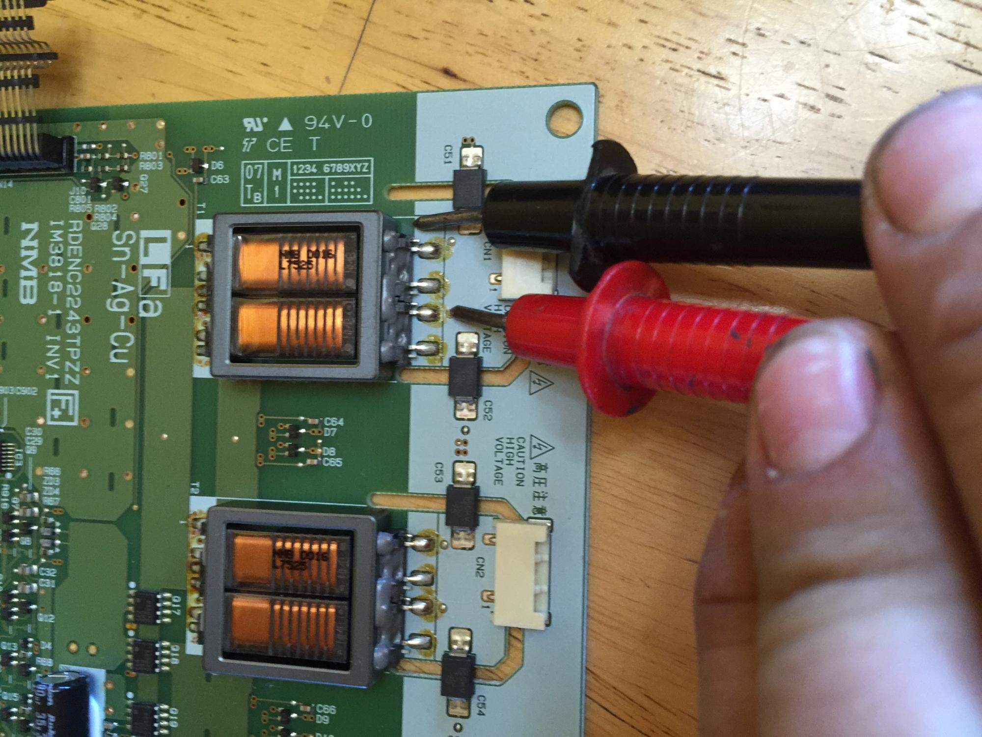

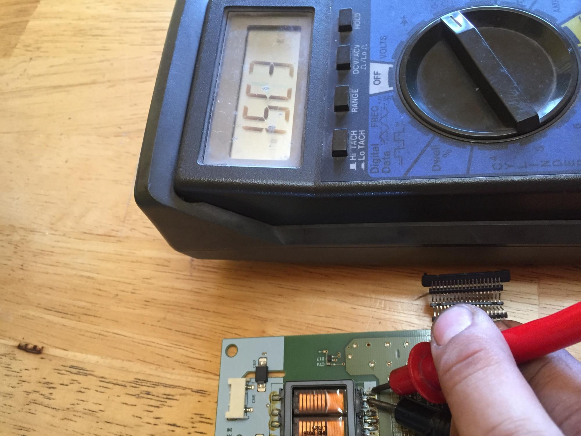

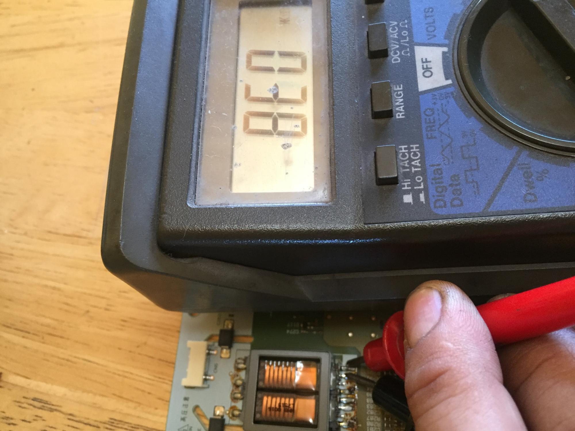

                              #54
                              Ok so on the transforms on the side that has the six prongs if I test the good board the side by side terminals are like 750 and on the bad board or the board I think is bad they are 1550

                                  #56
                                  Ok now you can see where I'm testing and how far off it is

                                    #57
                                    Test the secondaries of the transformers. You tested the primary.

                                      #58
                                      I see now how it works. That's why it is always important to post pictures of all the boards, or even the whole back side of the tv. One pic can say 1000 words to us.
                                      The secondary has 4 pins and there a two transformers in each. So you have 2 outputs. 2x2= 4 pins on the secondary. Test each pair.
                                      Another thing: check the 2 SMD capacitors on each transformer output. Resolder those if nessesary.

                                        #59
                                        Ok so your saying the opposite side with the four pins is the secondary
                                        • Danvagos
                                          • Aug 2016
                                          • 76
                                          #60
                                          This side ?
