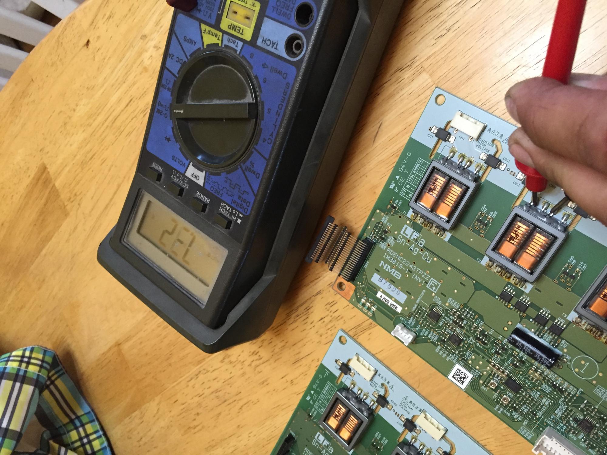

                    I doubt that all transformers are bad on the 3 boards on the other side. Just compare one transformer to all others on one side, then the same thing on the other side. Usually it is the secondary (the high voltage side) that fails.
                    I understand that this TV has actually 2 PSU's? Is the 24V that feeds those boards is good from both PSU's? Both PSUs turn on fully?
                    What do you get with the DMM in OHM mode when you check the secondary of each inverter transformer? Try the 1st pin on the secondary with pin 4. Do that on every board. Post them all here so I can have a look.

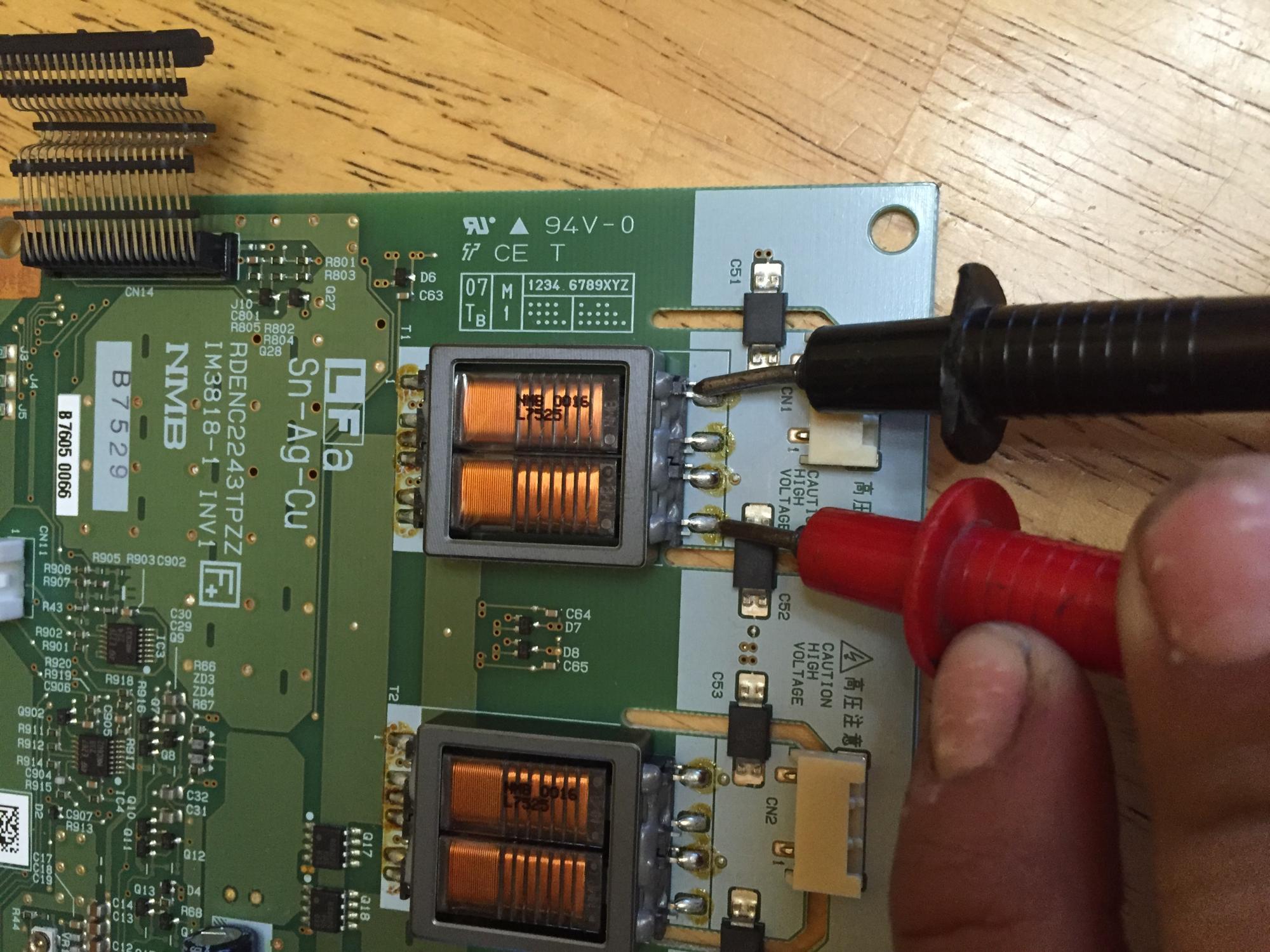

                      These to pins show nothing
                        #71
                        Re: Please help I'm loosing my mind 65" tv
                        Now on the 2 pin and the 4 I get 7.33 +-
                          #72
                          If I hold the board to the light the # 1 and three don't even connect to any thing lol
                            #73
                            3 of them are at 7.33 and one is at 7.15 and one is at 7.45
                              #74
                              And the other two boards are at 7.33+-.01 on all of them

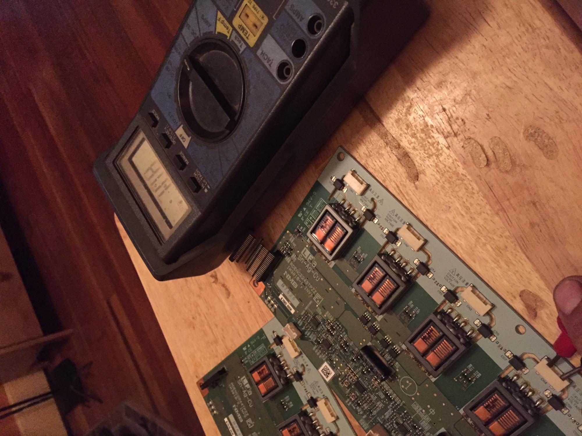

                                Not every transformer pin out is the same. Sometimes we either have to figure it out or look up the spec sheet of the transformer to get the pin out. I was just at it to look the transformer part number up, but had no luck.
                                What do you read on the pins inside the CCFL connector?
                                  #76
                                  Three at 7.33 one at 7.15 and one at 7.45
                                    #77
                                    O.k. that makes 5. I thought there are 6 transformers on one board? So you got 3 more boards to go (the slaves).

                                      Ok at the cclf connector I'm getting 7.28 to 7.33 on 17 out of the 18 on this one side of the tv anyway and the one is at 7.08 and that one is once again on the board that's in question with the little brown spot
                                        #79
                                        this is the one near the brown spot
                                          #80
                                          the transformer measuring 7.08 is the problem
