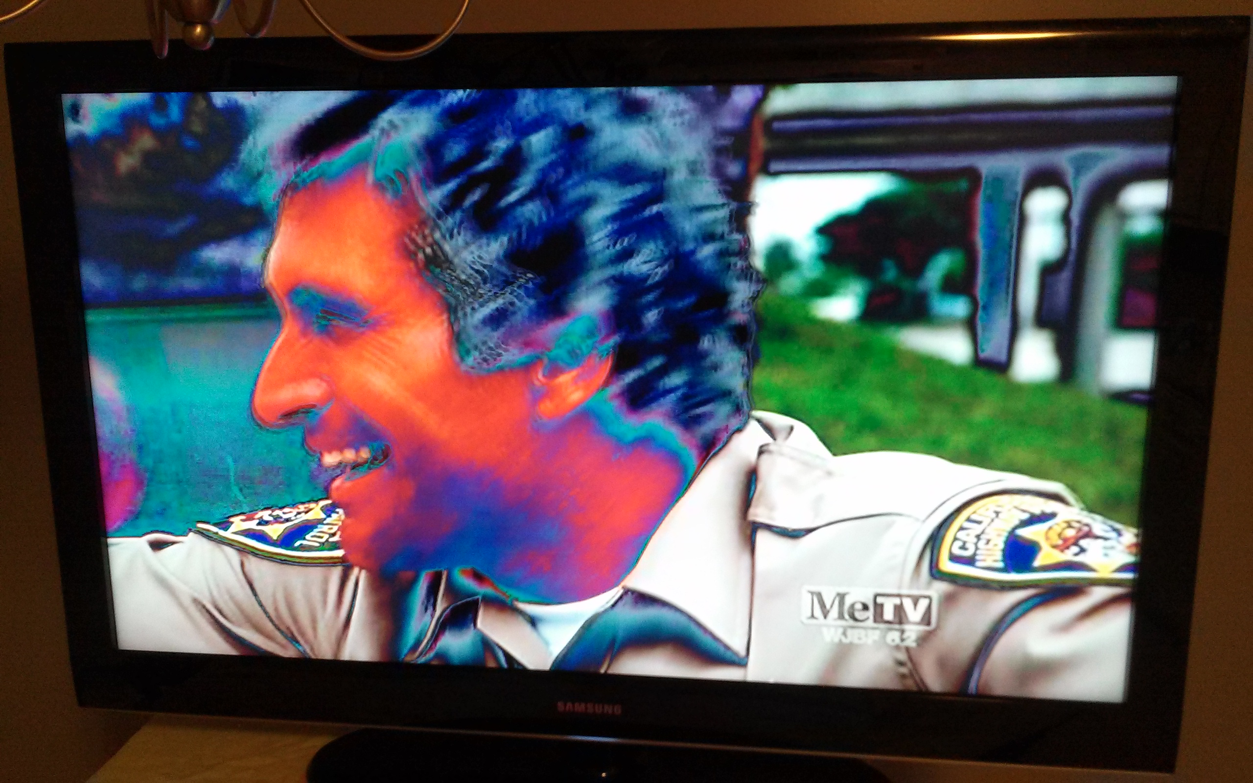

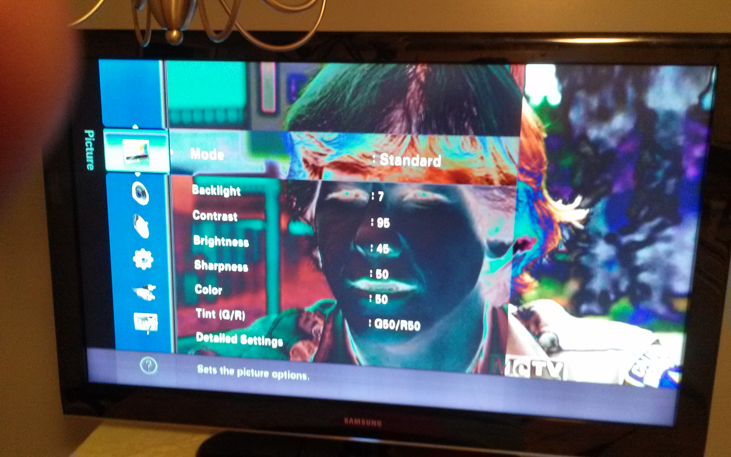

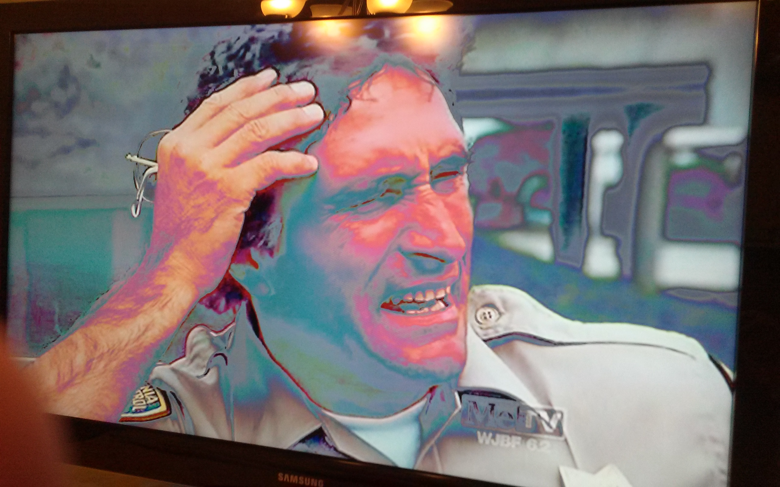

    Samsung LN46A550 weird colors
    Weird colors on Samsung ln46a550 is this a tcon or panel failure
    Re: Samsung LN46A550 weird colors
    Bad GAMMA Voltage.
    We need to see the pictures of the T-CON board.

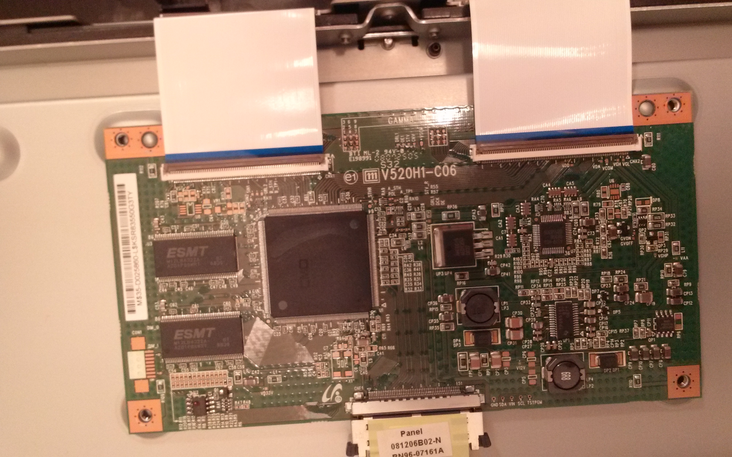

      A55x series has AUO panels with bad as15 chip on tcon, is very well known issue.
        got my vote too for the AS15 being bad.
          This is my tcon , I think this is a chi me panel, found new tcon for 38 us dollars, what u think will it fix it.
            It looks like IC U7 is the GAMMA IC, see if it is AS-15.
            You can also see the test points onthe board for testing the GAMMA Voltages, I will not be surprised if you have bad GAMMA IC U7.
            You need to match the P/N on the barcode sticker for the correct PCB Assembly number, not the PCB (blank PCB number V520H1-C06).
            Go to SJ to find out if there are compatible PCBA.
              It's an AS19-H1G. It's a voltage buffer like AS15, so it has high chances of being faulty.
              This T-CON is also used in 52" panels. Beware if you try to buy the full T-CON: for 46" version, U8 IC position is empty.
