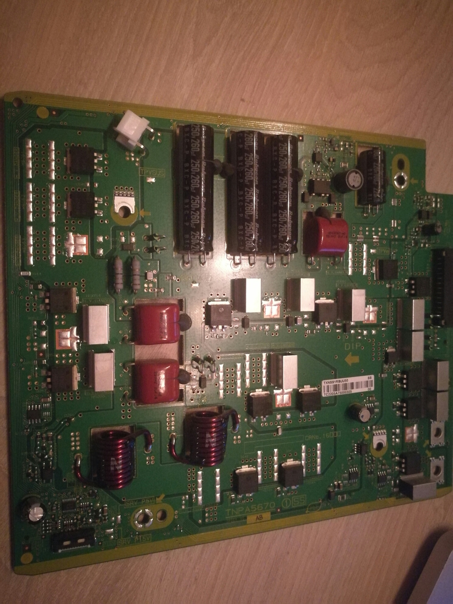

                            Yes I DO I pulled the SS board out. There is no doubt that this board was once repaired. I can see solder residue in 4 areas.
                              Re: Panasonic TC-P55VT60 7 Blinks. Need Advice
                              Soldering appears to be factory could be residue or board coating that has changed color from heat
                                Does anyone have any tips for testing the SS board before I purchase one?

                                    I'd get the right one. There's a difference in the centre of the board with a bunch of inductors. Shopjimmy has Rev AC in stock anyway.

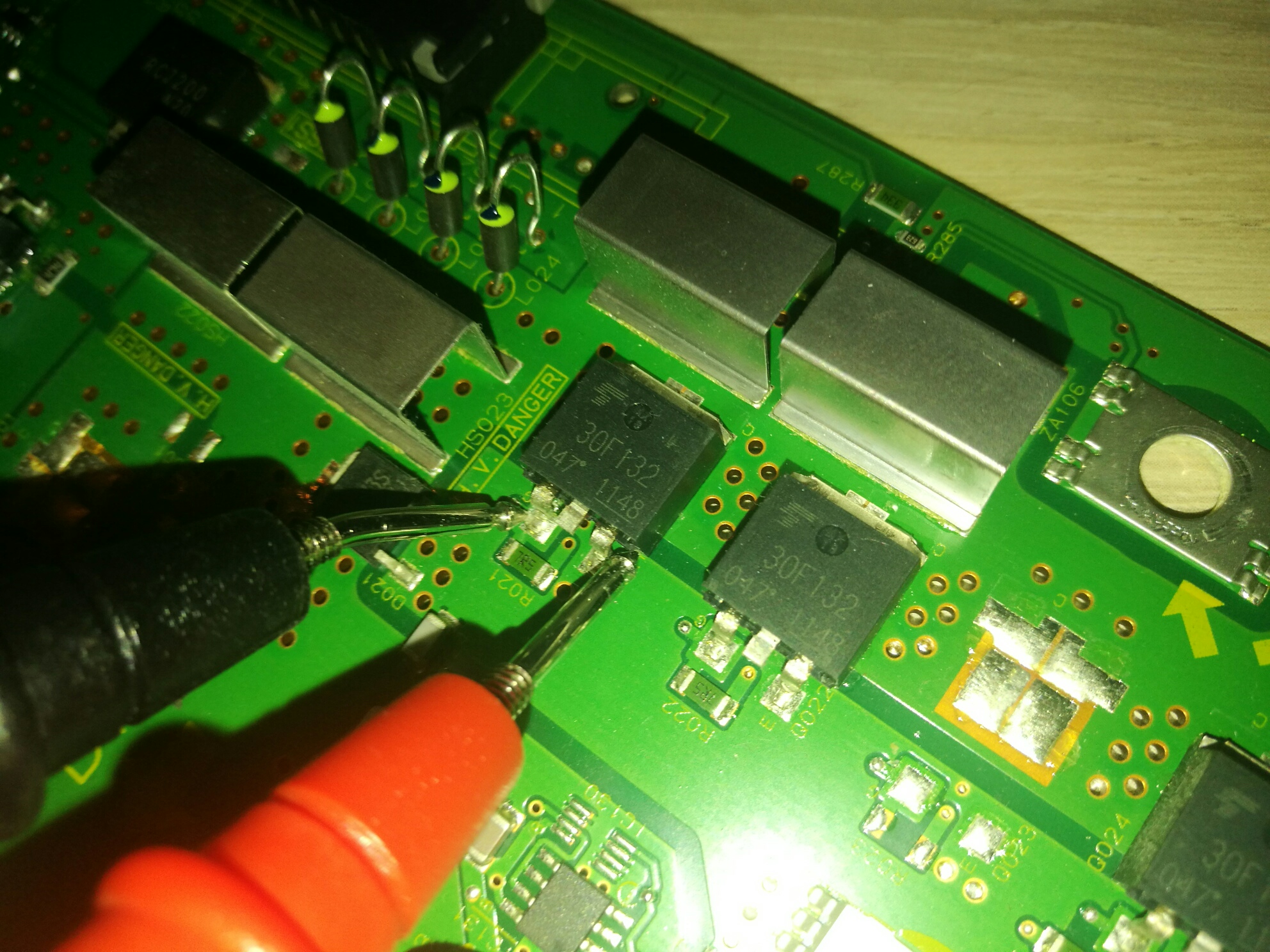

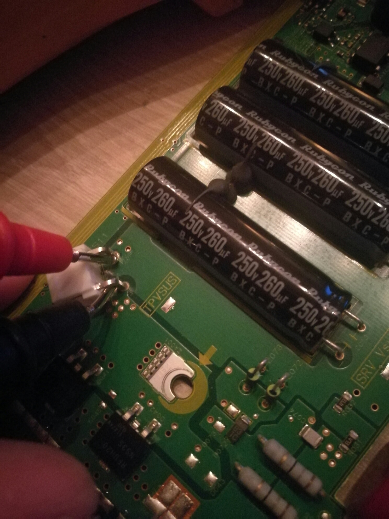

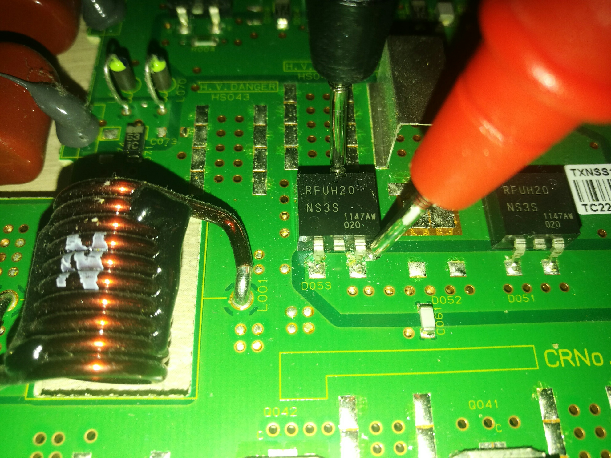

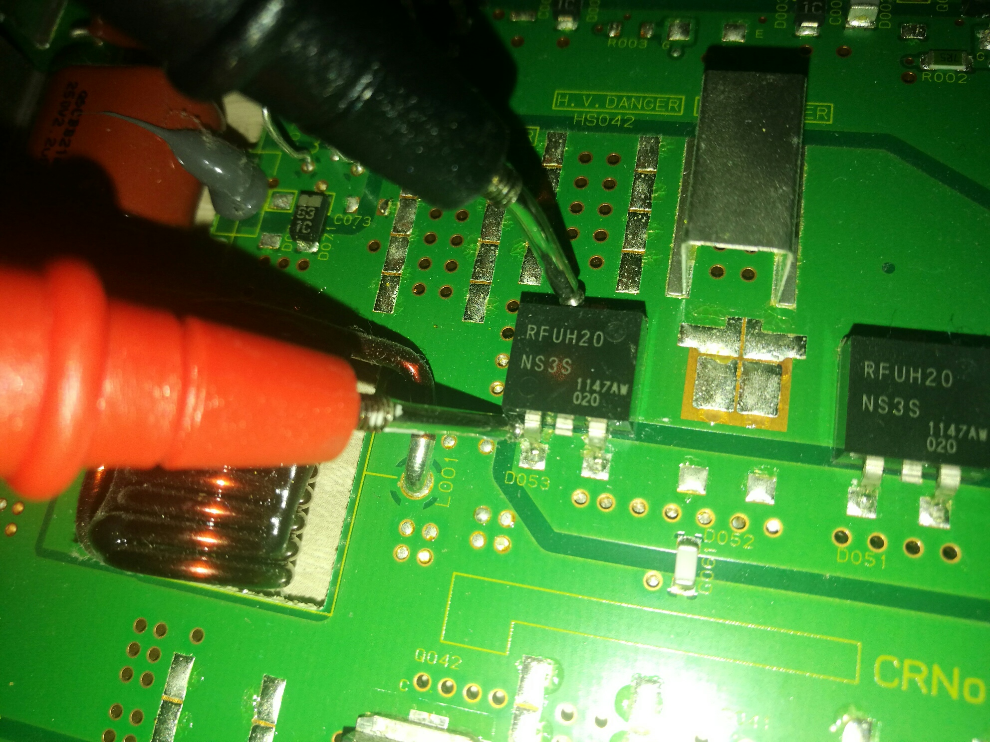

                                      It does not matter what kind of Panasonic tv you have. The measurements is the same.
                                      The pictures are from a 50GT50 SS board. They used the 30F132/45F132 mosfets on these boards.
                                      You need to measure EVERY part on the board as i measured on the pictures. Meter in diode/beep mode.
                                      Q = mosfet --> measure outer legs. Beep is bad.
                                      D = diode --> black on middle pin , red on outer legs. ( left and right leg ).
                                      If you measure outer legs on the diode part it will beep.
                                      The SS prong connector MIGHT give a beep for a short periode of time , if it beeps both ways then its shorted. If it beeps for a short period of time and then goes away then it's probably good. Just measure the parts to be sure.
                                      This is for ALL parts on the SC / SS and powersupply.
                                      Hope this helps you a bit on your way
