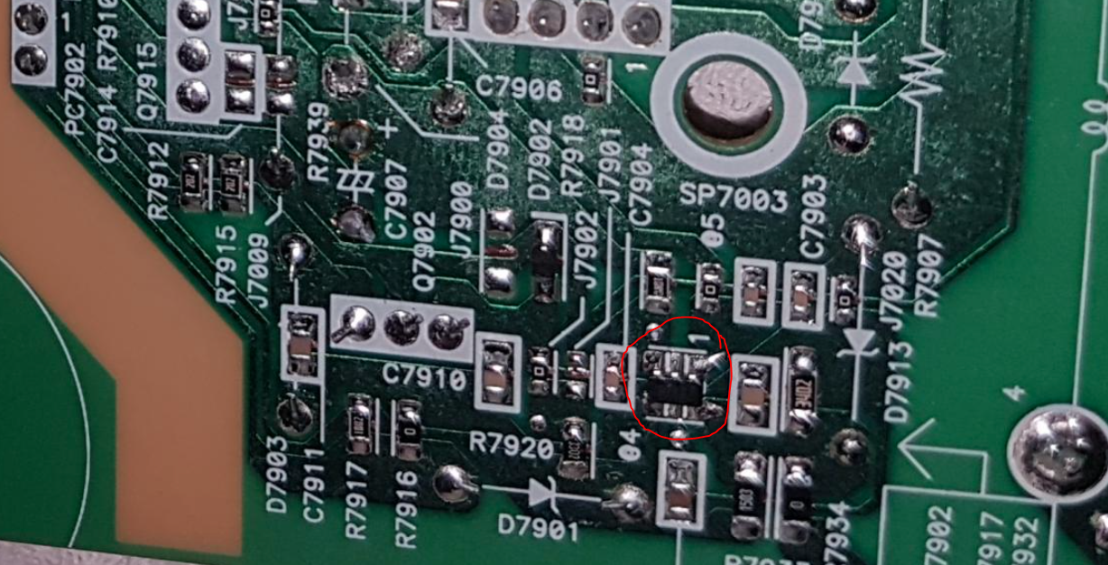

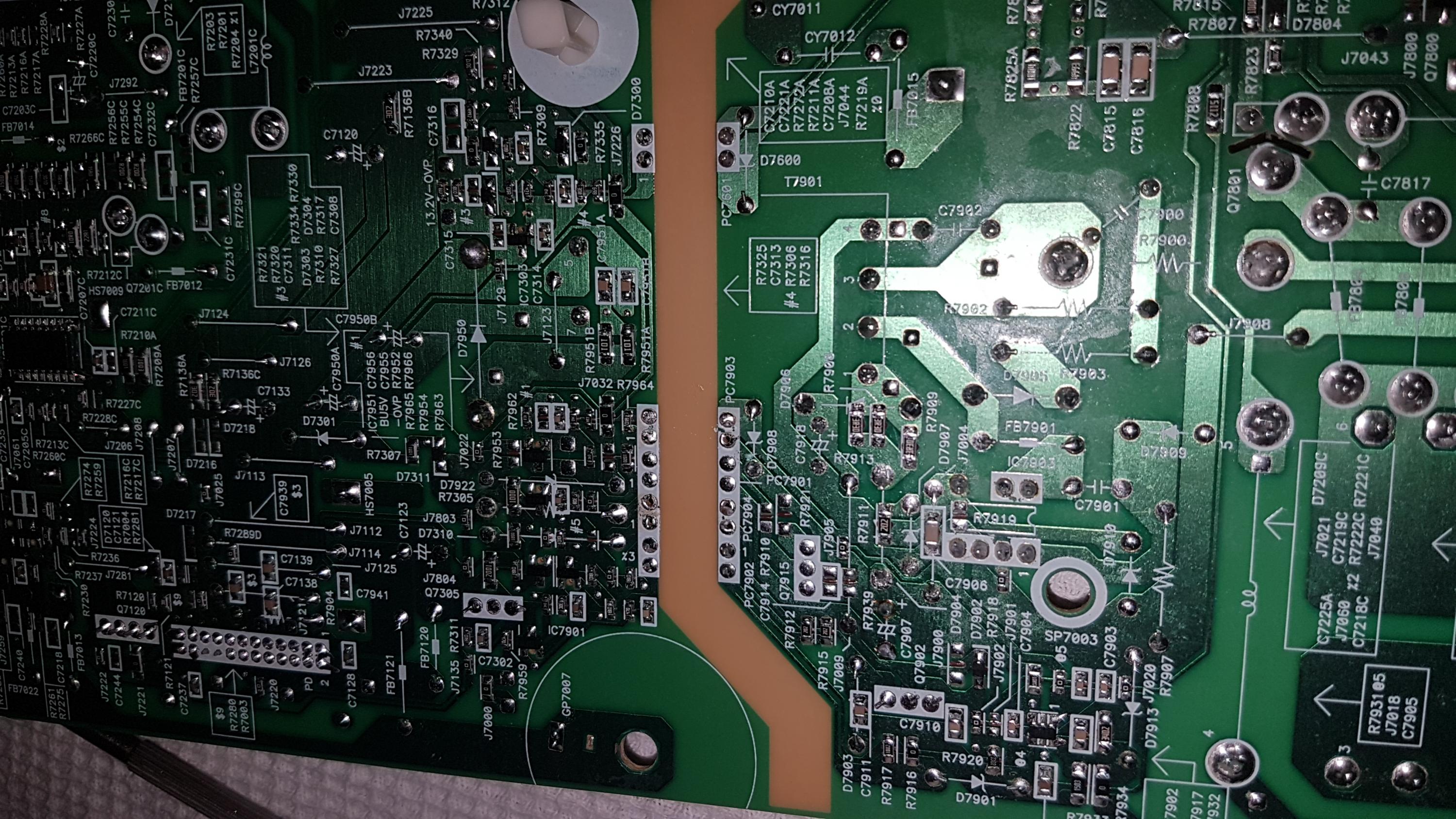

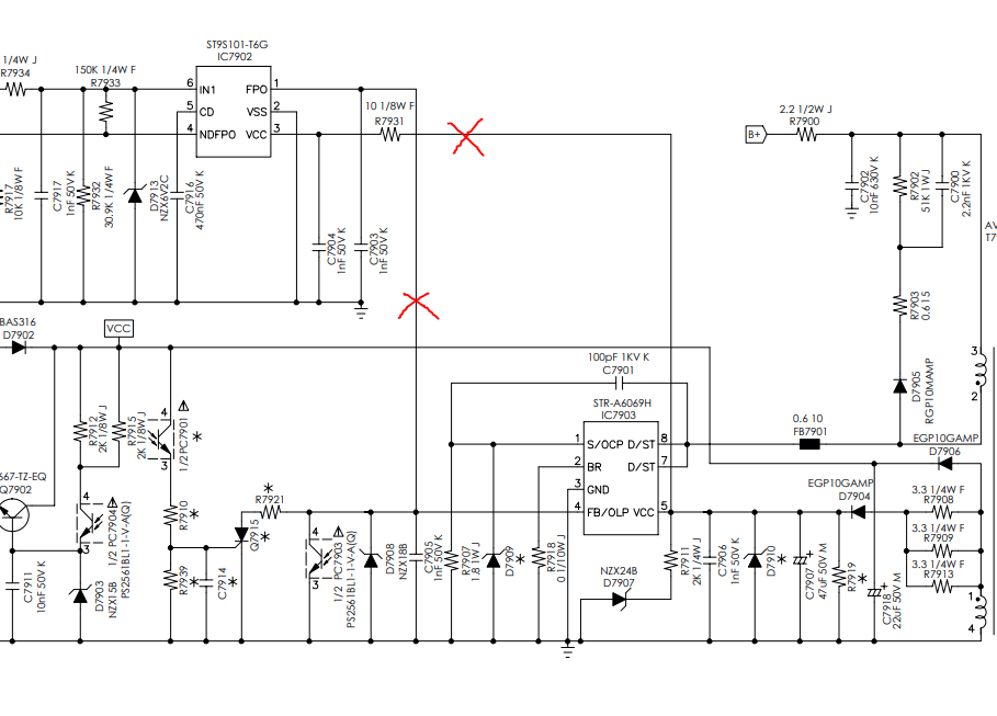

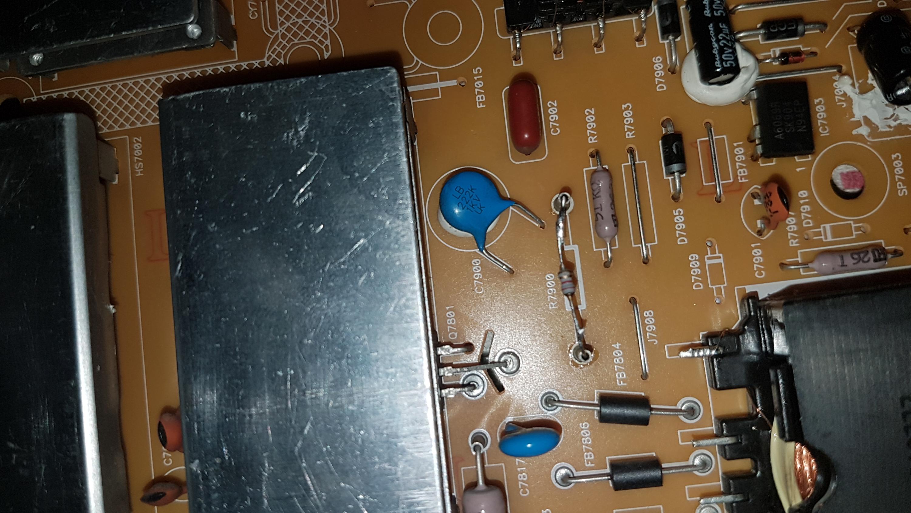

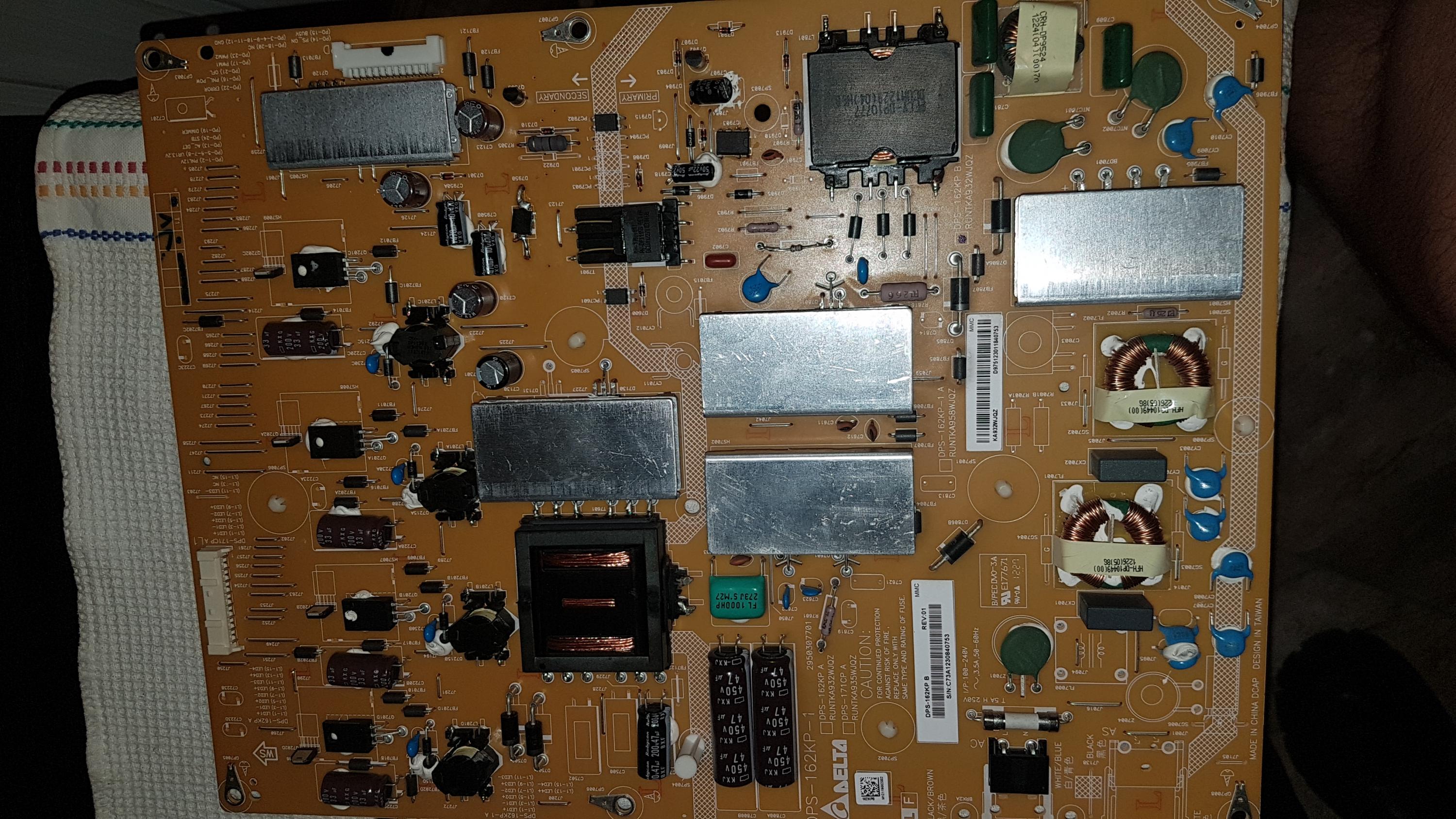

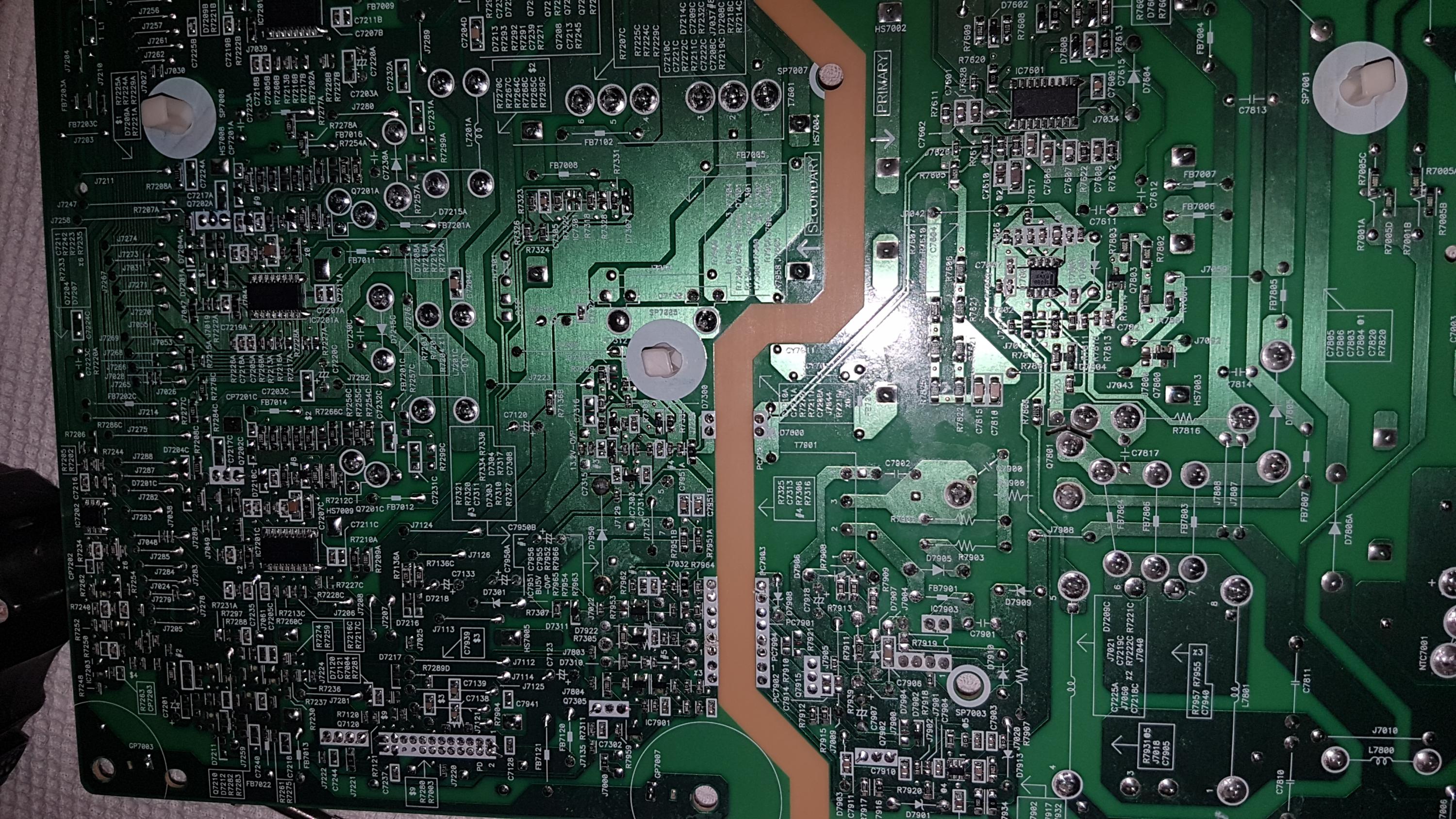

Sharp LC-60SQ15U TV DPS-167CP - No power
  • R_J
    • Jun 2012
    • 9610
    #81
    Re: Sharp LC-60SQ15U TV DPS-167CP - No power
    Originally posted by romasik
    transformer T7901 ? Why 4,5 ?
    WHY? because if that feedback winding is open circuit you will not get the boosted vcc voltage to make the ic work.
    Look at the schematic, It's pins for this winding are 1&4, on your board they are 5&4, pin 4 is ground, pin 5 connects to D7906 and the 3 parallel resistors
    • romasik
      • May 2022
      • 56
      • Ukraine
      #82
      Re: Sharp LC-60SQ15U TV DPS-167CP - No power
      [QUOTE=R_J;1134903]Check the transformer winding between pins 4 and 5, it should be almost 0Ω, then check the resistors R7908,R7909,R7913, if they are good, check the diode D7904, also check the zener diode D7909
      7909 not prsent on my board . R7908,R7909,R7913,D7904 checked all ok. but if 4,5 on transformer T7901 then his open.
      • romasik
        • May 2022
        • 56
        • Ukraine
        #83
        Re: Sharp LC-60SQ15U TV DPS-167CP - No power
        Originally posted by R_J
        WHY? because if that feedback winding is open circuit you will not get the boosted vcc voltage to make the ic work.
        Look at the schematic, It's pins for this winding are 1&4, on your board they are 5&4, pin 4 is ground, pin 5 connects to D7906 and the 3 parallel resistors
        No the transformer is connected as in the schematic.
        • R_J
          • Jun 2012
          • 9610
          #84
          Re: Sharp LC-60SQ15U TV DPS-167CP - No power
          Last edited by R_J; 05-20-2022, 03:56 PM.
          • R_J
            • Jun 2012
            • 9610
            #85
            Re: Sharp LC-60SQ15U TV DPS-167CP - No power
            Originally posted by romasik
            No the transformer is connected as in the schematic.
            Your board is different from the DPS-167CP I was using Your board is a DPS-162KP, I was going by the original post title
            Last edited by R_J; 05-20-2022, 03:58 PM.
            • romasik
              • May 2022
              • 56
              • Ukraine
              #86
              Re: Sharp LC-60SQ15U TV DPS-167CP - No power
              • romasik
                • May 2022
                • 56
                • Ukraine
                #87
                Re: Sharp LC-60SQ15U TV DPS-167CP - No power
                Originally posted by R_J
                Your board is different from the DPS-167CP I was using Your board is a DPS-162KP
                I know I wrote about it at the beginning
                • romasik
                  • May 2022
                  • 56
                  • Ukraine
                  #88
                  Re: Sharp LC-60SQ15U TV DPS-167CP - No power
                  So which pin on T7901transformer to check? may be 1,4 ?
                  • R_J
                    • Jun 2012
                    • 9610
                    #89
                    Re: Sharp LC-60SQ15U TV DPS-167CP - No power
                    Yes, check pins 1 & 4
                    The vcc voltage is initially supplied by the ic's internal startup cell which is bout 9volts, that part of the ic is working. When the power is first applied the internal mosfet should pulse the primary of T7901, this will induce voltage in the secondary winding and also the feedback winding, This will charge C7907 above 15 volts and the ic will stay operating, However the secondary voltage (5V) from D7950 must be regulated, so the optocoupler is used to control this voltage. The fact this feedback voltage is 40mV it is shutting down the ic.
                    • romasik
                      • May 2022
                      • 56
                      • Ukraine
                      #90
                      Re: Sharp LC-60SQ15U TV DPS-167CP - No power
                      on my T7901 1,4 - 0,5ohm, 2,3 - 3 ohm , 5,7 - 0,2 ohm
                      • R_J
                        • Jun 2012
                        • 9610
                        #91
                        Re: Sharp LC-60SQ15U TV DPS-167CP - No power
                        Originally posted by romasik
                        on my T7901 1,4 - 0,5ohm, 2,3 - 3 ohm , 5,7 - 0,2 ohm
                        Yes it is good
                        • dskall
                          • Oct 2016
                          • 2905
                          • usa
                          #92
                          Re: Sharp LC-60SQ15U TV DPS-167CP - No power
                          Originally posted by romasik
                          R7900 is ok, I am writing about C7900
                          You say things are good. Most fixed their problem with just a couple of component changes. How do we know you didn't replace a 2.2ohm with a 220 ohm?
                          • romasik
                            • May 2022
                            • 56
                            • Ukraine
                            #93
                            Re: Sharp LC-60SQ15U TV DPS-167CP - No power
                            Originally posted by dskall
                            You say things are good. Most fixed their problem with just a couple of component changes. How do we know you didn't replace a 2.2ohm with a 220 ohm?
                            2.2 ohm red red gold gold
                            • romasik
                              • May 2022
                              • 56
                              • Ukraine
                              #94
                              Re: Sharp LC-60SQ15U TV DPS-167CP - No power
                              Originally posted by R_J
                              If these are all good, Disconnect D7908 and pins 3&4 of the optocoupler PC7903 and see if the voltage on pin 4 of ic7903 comes up to about 7 volts. If it does not, I suspect the ic is bad.
                              PC7903, PC7904 i desordered for check . PC7904 need soldered back? Disconnect D7908 and power on board for check 3,4 pin on ic7903 ?
                              • R_J
                                • Jun 2012
                                • 9610
                                #95
                                Re: Sharp LC-60SQ15U TV DPS-167CP - No power
                                PC7904 is used to turn on Q7902 to supply vcc_on so it can be left out of circuit for now.
                                If you also remove pc7903 and D7908, pin 4 of ic7903 should be about 7volts, If it does not come up, try isolating just pin4 from the circuit trace, this will eliminate any other component on that line as well.
                                • Diah
                                  • Feb 2013
                                  • 6500
                                  #96
                                  Re: Sharp LC-60SQ15U TV DPS-167CP - No power
                                  finally i saw now he post photos on his PCB.. i were wondering how other write parts No. and there was different model threats..
                                  any way.. you don't have 5 V STB and PFC remain not active..
                                  how are you testing. i cant find you wrote about.. where are the signal we are going to let PFC go high ?? this is not only Hot area work.. its cold area too.. beside i can see your soldering work the most worst i can see.. each part you took it out. you need to recheck the green line print chart 1000000000% you did break the line
                                  • lotas
                                    • Jan 2016
                                    • 4809
                                    • Russia
                                    #97
                                    Re: Sharp LC-60SQ15U TV DPS-167CP - No power
                                    Remove this supervisor IC7902, it sometimes brings problems with starting (the power supply works without it).
                                    • romasik
                                      • May 2022
                                      • 56
                                      • Ukraine
                                      #98
                                      Re: Sharp LC-60SQ15U TV DPS-167CP - No power
                                      Originally posted by R_J
                                      PC7904 is used to turn on Q7902 to supply vcc_on so it can be left out of circuit for now.
                                      If you also remove pc7903 and D7908, pin 4 of ic7903 should be about 7volts, If it does not come up, try isolating just pin4 from the circuit trace, this will eliminate any other component on that line as well.
                                      I check without pin 4 0V, I bought another a6069h today and soldered it in, but nothing has changed on 4 pin 45mV on pin 5 9,5V
                                      Last edited by romasik; 05-21-2022, 08:15 AM.
                                      • romasik
                                        • May 2022
                                        • 56
                                        • Ukraine
                                        #99
                                        Re: Sharp LC-60SQ15U TV DPS-167CP - No power
                                        Originally posted by lotas
                                        Remove this supervisor IC7902, it sometimes brings problems with starting (the power supply works without it).
                                        Possible unsolder resistor on pin Vcc for off power supervisor? It's enough?
                                        • lotas
                                          • Jan 2016
                                          • 4809
                                          • Russia
                                          #100
                                          Re: Sharp LC-60SQ15U TV DPS-167CP - No power
                                          Try like this.
