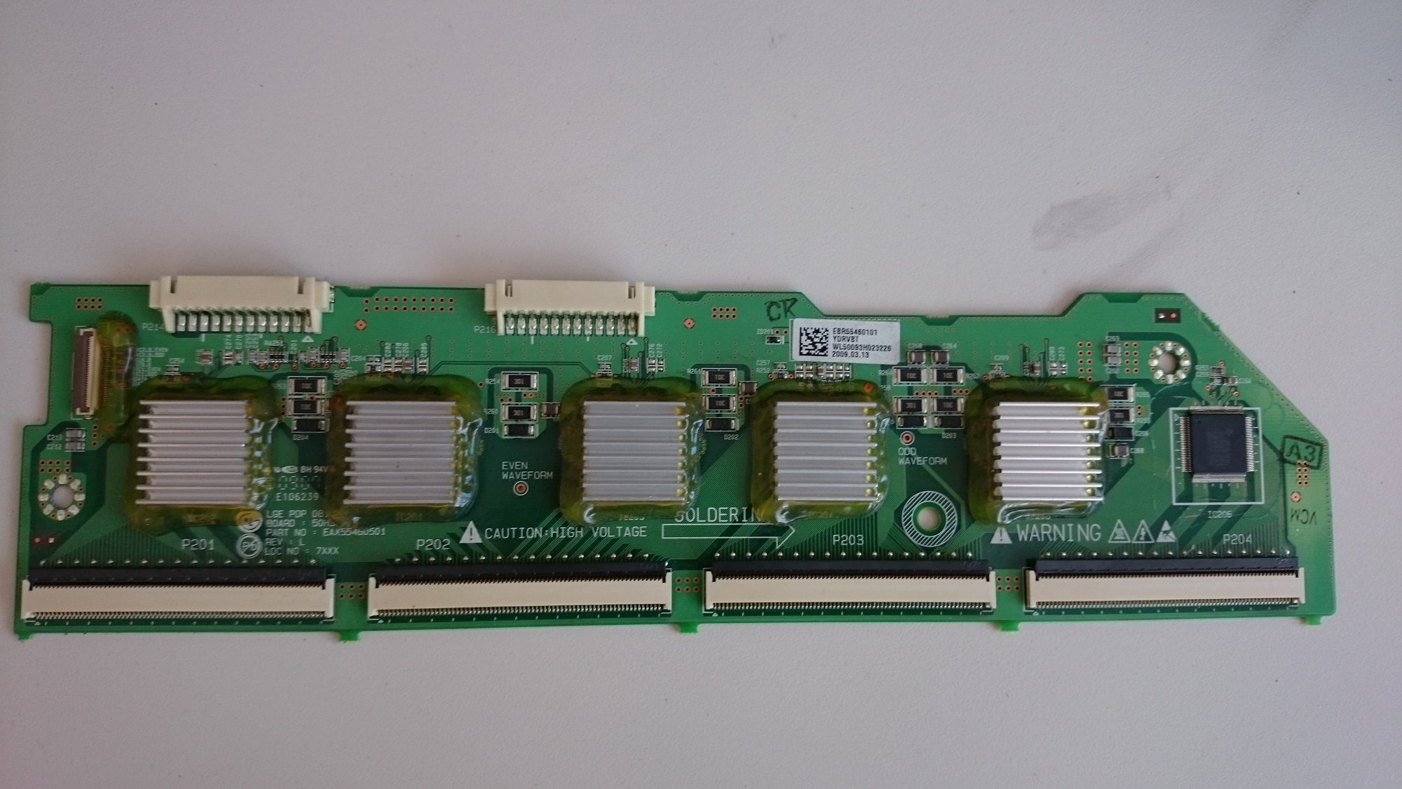

    Right ok, so with the buffer removed what do the sustain voltages do ?

      Hello,I have the same problem maybe you could help me .
      My tv when plug in has a white flash and no picture (sound ok),If disconect Z-sustain I should have a dimm picture ?
        Re: LG 50 Inch Plasma 50PS3000 - Picture but no sound
        You need to check the Vs and Va voltages first with your DMM.

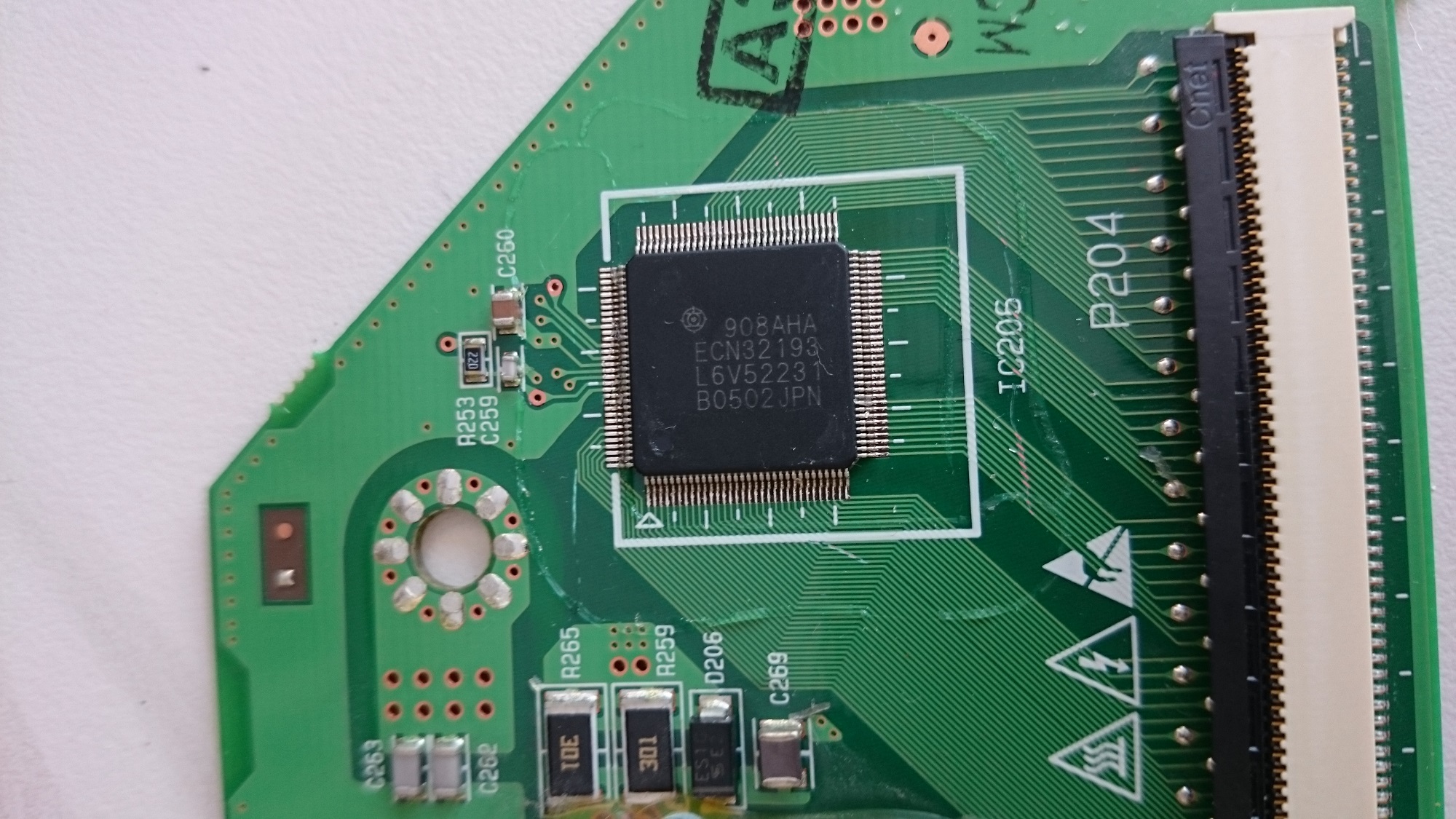

          Hi,I just checked the buffers and the lower one is shorted to ground .
          Whit the lower buffer off I have nice clear picture top half screen .
          I order lower buffer and see .
            Ok good work keep us updated.
              All working now,was shorted lower buffer EBR55460101 EAX55460501
              Bad-Shorted IC206 .
