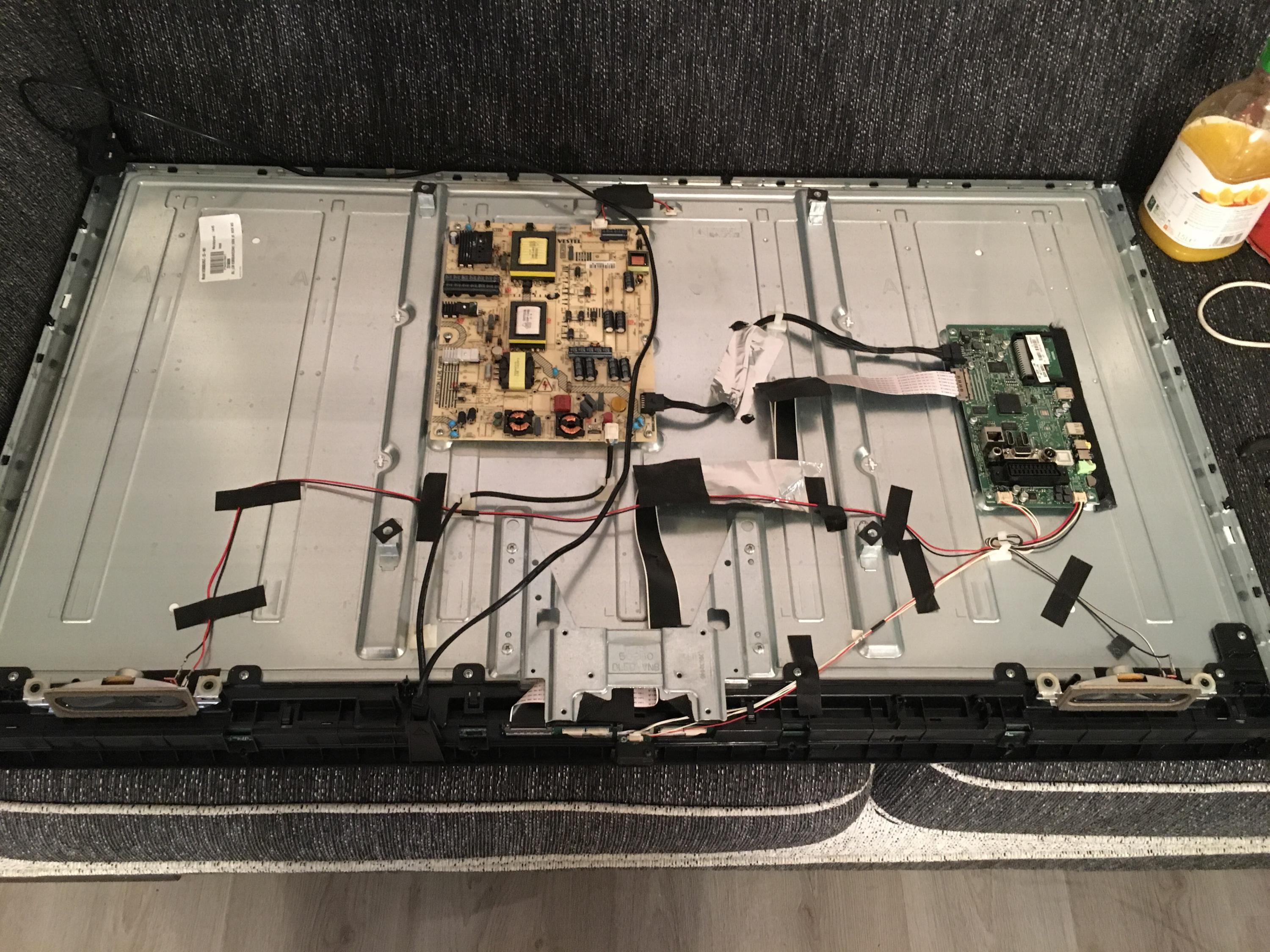

        Ive put the old psu back in and ive now got backlight but still no picture so i have sound and backlight but no display lol where do i go from here ps the new board i bought from ebay will be getting sent back
          Re: Panasonic tx50a300b 11 blinks tv wont come on
          Unplug half the t-con and see if you get a picture.

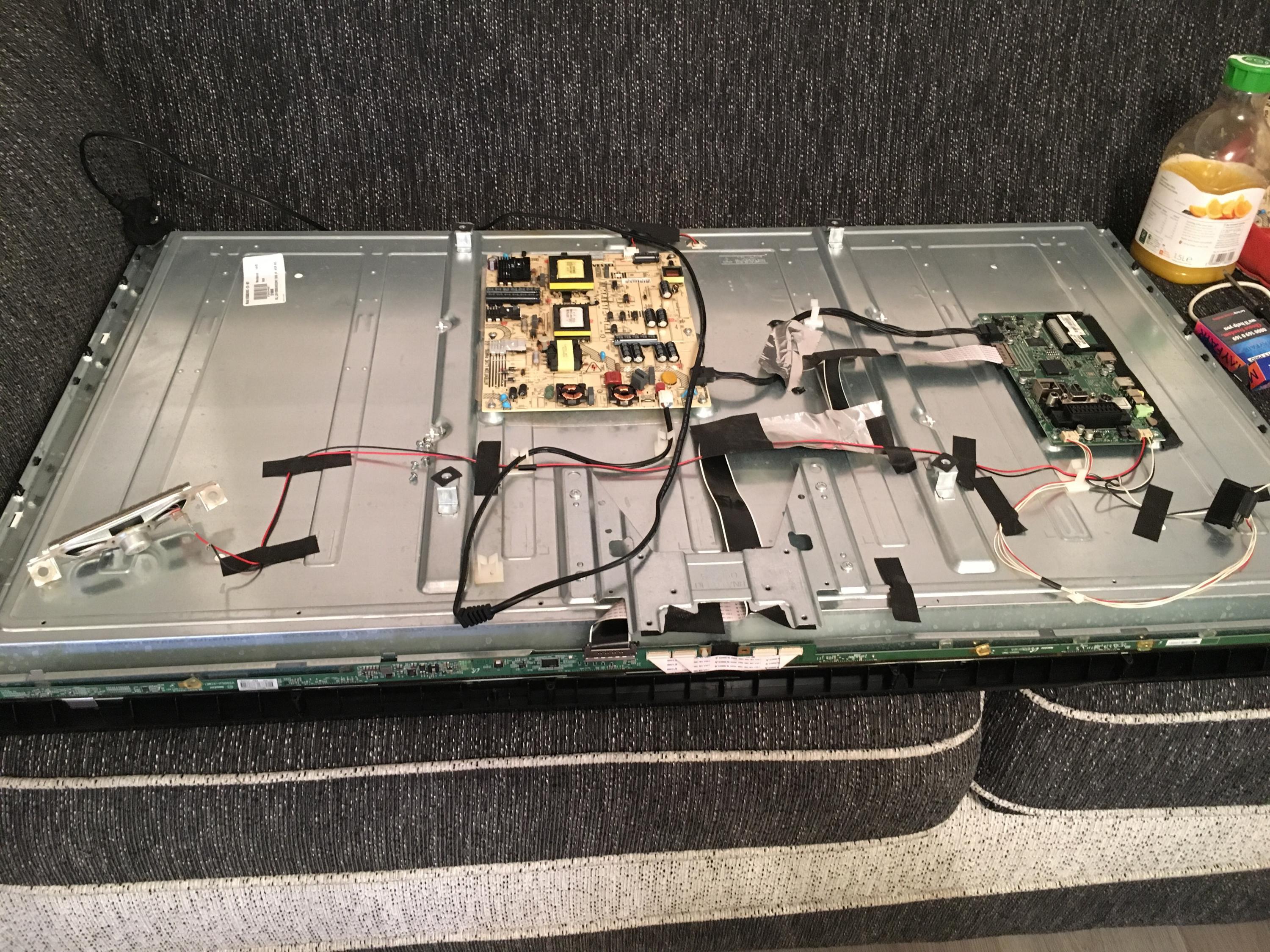

                  What is happening here, originally you said no backlight but lcd working, then flash of backlight, now backlight no lcd ?
                    #29
                    A had no back light to start with n bought psu from ebay then once fitted a was just getting a flash so stripped screen done yhe soldering of connectors n stuff tested all the leds then still just a flash so a tried the old psu back in it and now the backlight is on and working but i dnt have any display on screen just sound and backlight lol im not a pro ha just tryin to learn

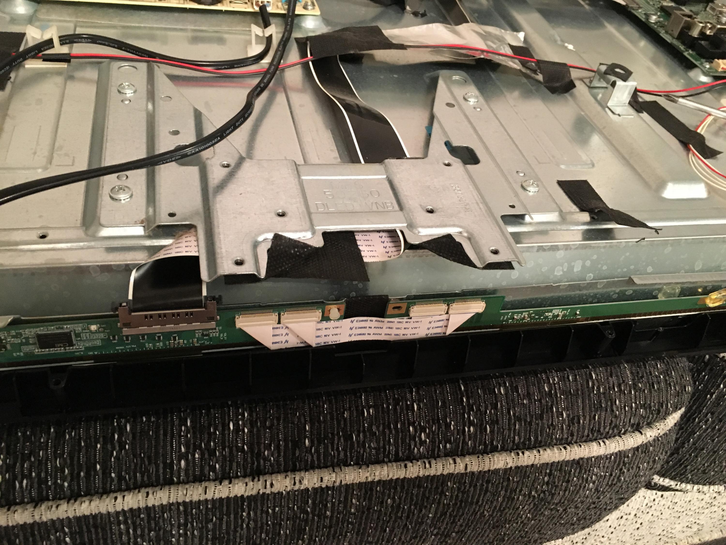

                      Ok take the plastic cover off and make sure the two ribbons going to the screen boards are in properly.
                        #31
                        Theres only 1 ribbon goes to the screen boards
                          #32
                          There should be two, they come out the Tcon into the two boards bonded to the Lcd screen ?
                            #33
                            Theres no seperate t con board the ribbon comes from main board straight to one of the screen boards then theres 2 small ribbons connected between the 2 screen boards
                              #34
                              The full back
                                #35
                                Ahh right thats an Cmo panel, also you see the two little ribbons that link the two boards try reseating them.

                                  Bingo m8 a wee reseat and i have menus ill try it way the sky box after my coffee cheers
