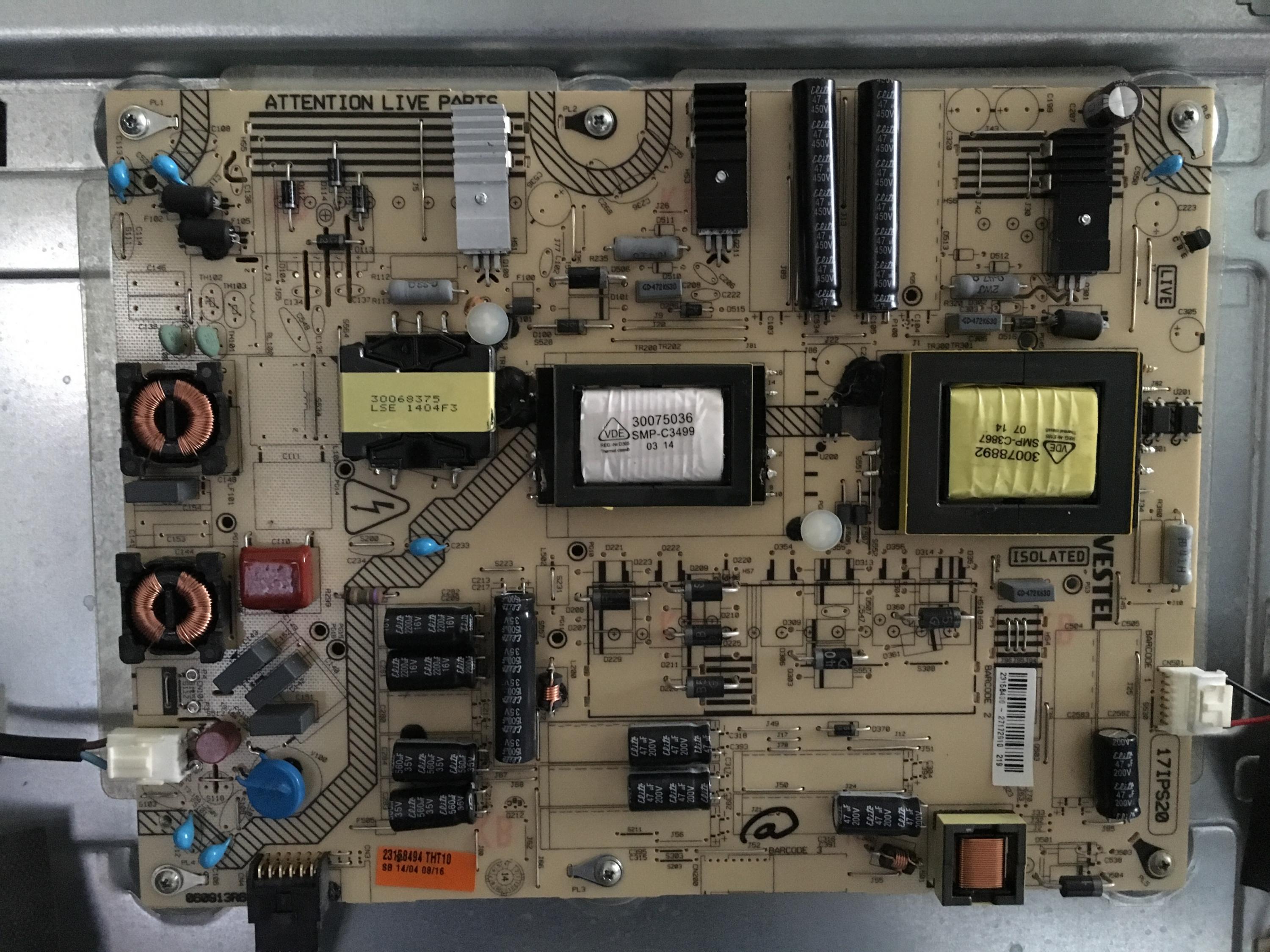

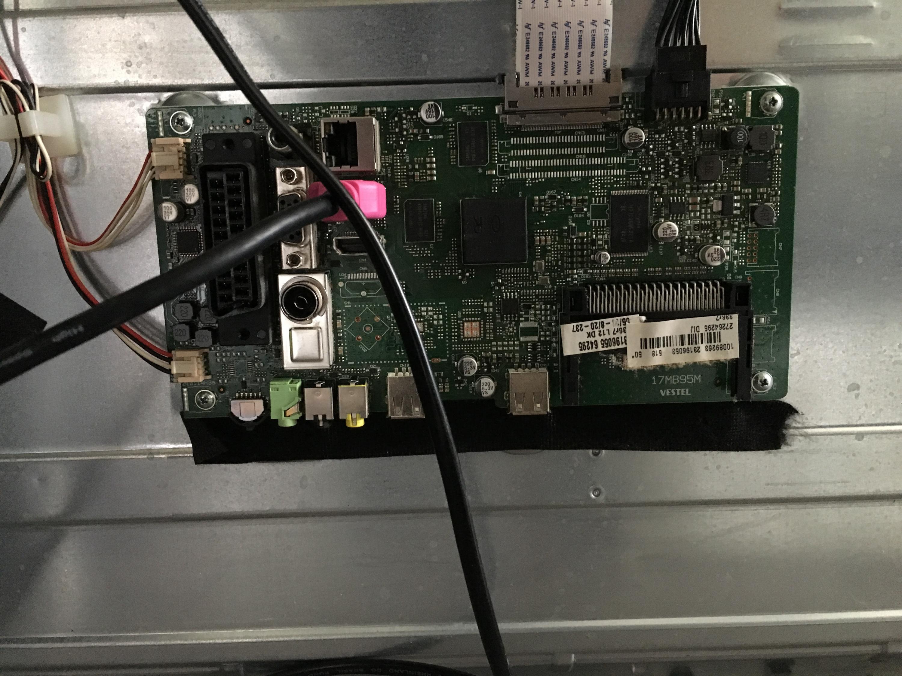

      Re: Panasonic tx50a300b 11 blinks tv wont come on
      Images of the boards please ? Also A300 is Vestel not real Panasonic so there wont be a flash error code just the normal boot up led.
          Boards
            Other board

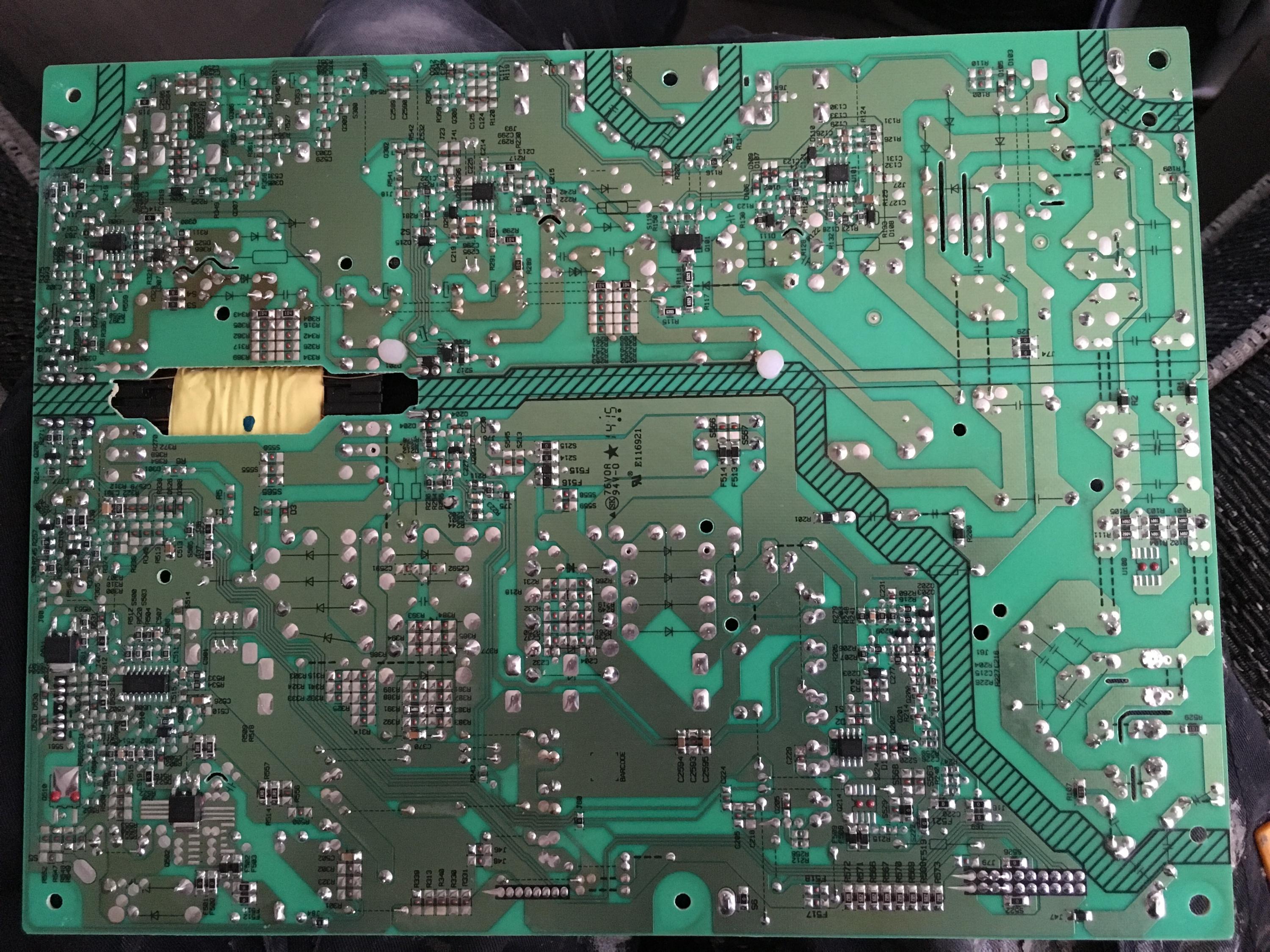

                Back of psu
                  Yeah Vestel shit, watch this video and test the Psu if the Led voltage is good and it should be about 200 volts plus at start up at the Led connector, if thats ok then you have a failed Led.

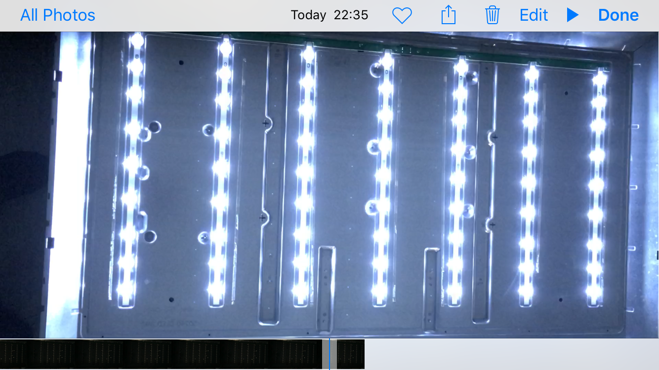

                          Hello ok so ive stripped down screen and when i turn on set im getting a flash for split second ive recorded video the picked out the frame when they are on and all leds are lit does this mean the led sets are ok ? If so what would cause it to do this ive checked voltage going to led and it goes up to nearly 200v yhen slowly drops down
                            Pic of leds
                              Is there any discolouration around any of the leds where they may be overheating?

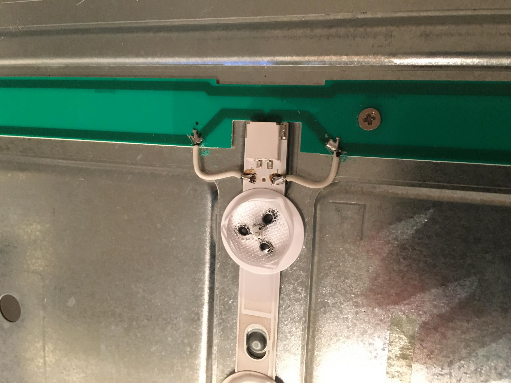

                                    Originally posted by ReeceyBurger123
                                    The Leds are, its probably the little connectors that limk the strips together that have broken down. Watch my video and you will see how to sort this by bridging over the little connectors.
                                    Ok so i decided to solder each strip to board to bypass connectors but still the same😞

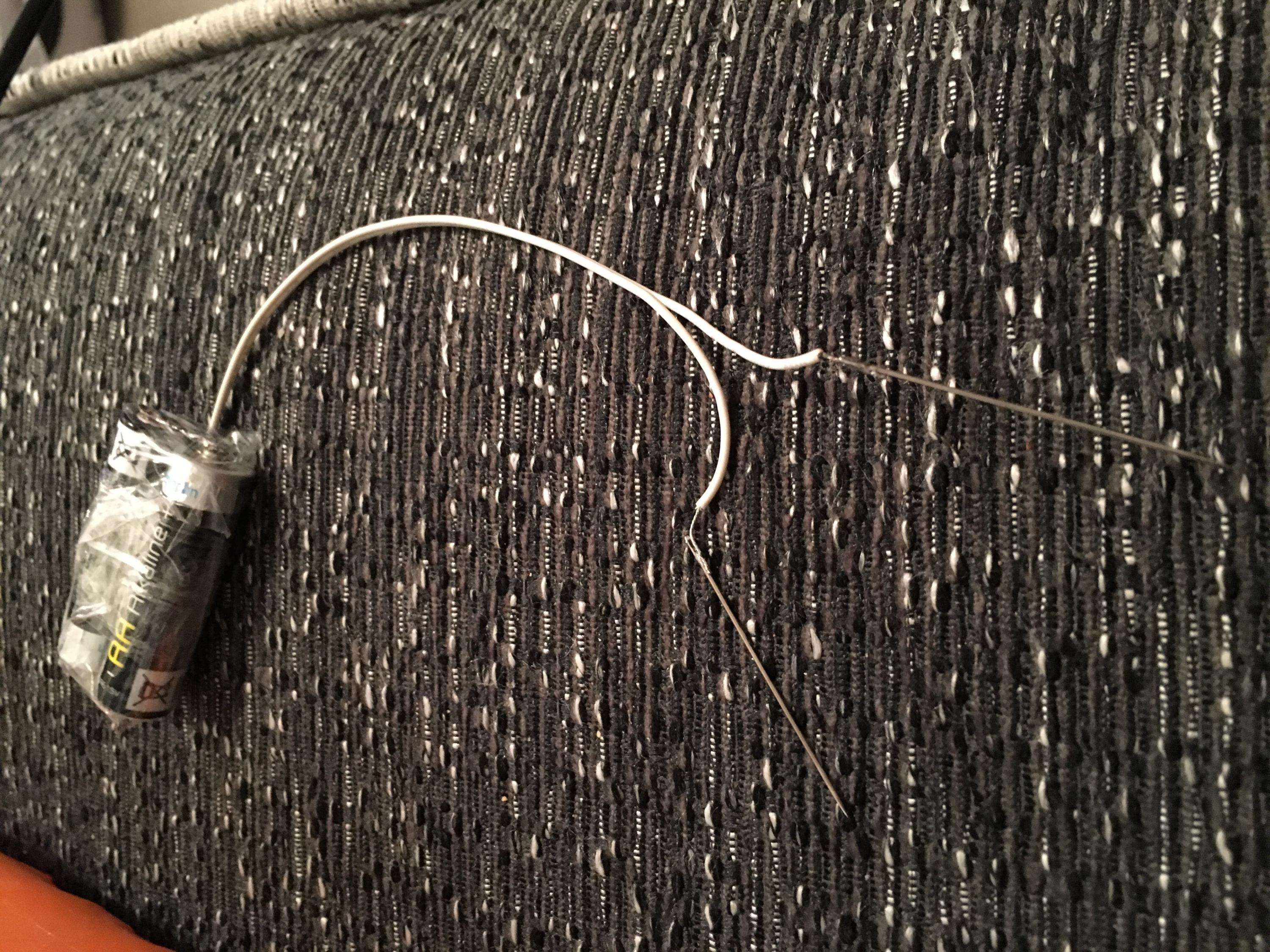

                                      Also ive tested each individual led with 3.2v direct they all light
