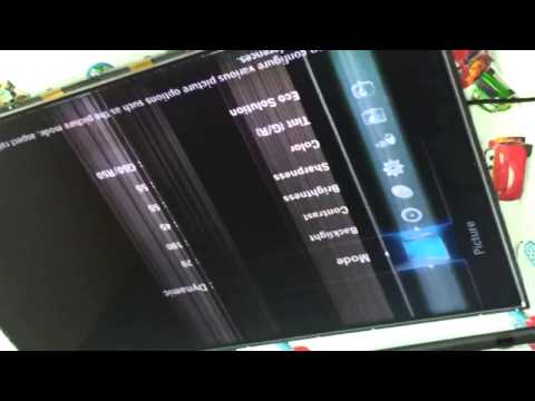

    Hi guys
    just for information reasons got this tv today straight away i thought it was panel failure
    but ended up being the tcon at fault
    not the exact image but not far away due to not taking a picture of the fault in the first place

    Its lose ground or bga solder connections on the Tcon seen this before with Samsung and Auo buddy nice work This a Vestel set too if so what Panel VES500xxxL or VES500xxxS ?
