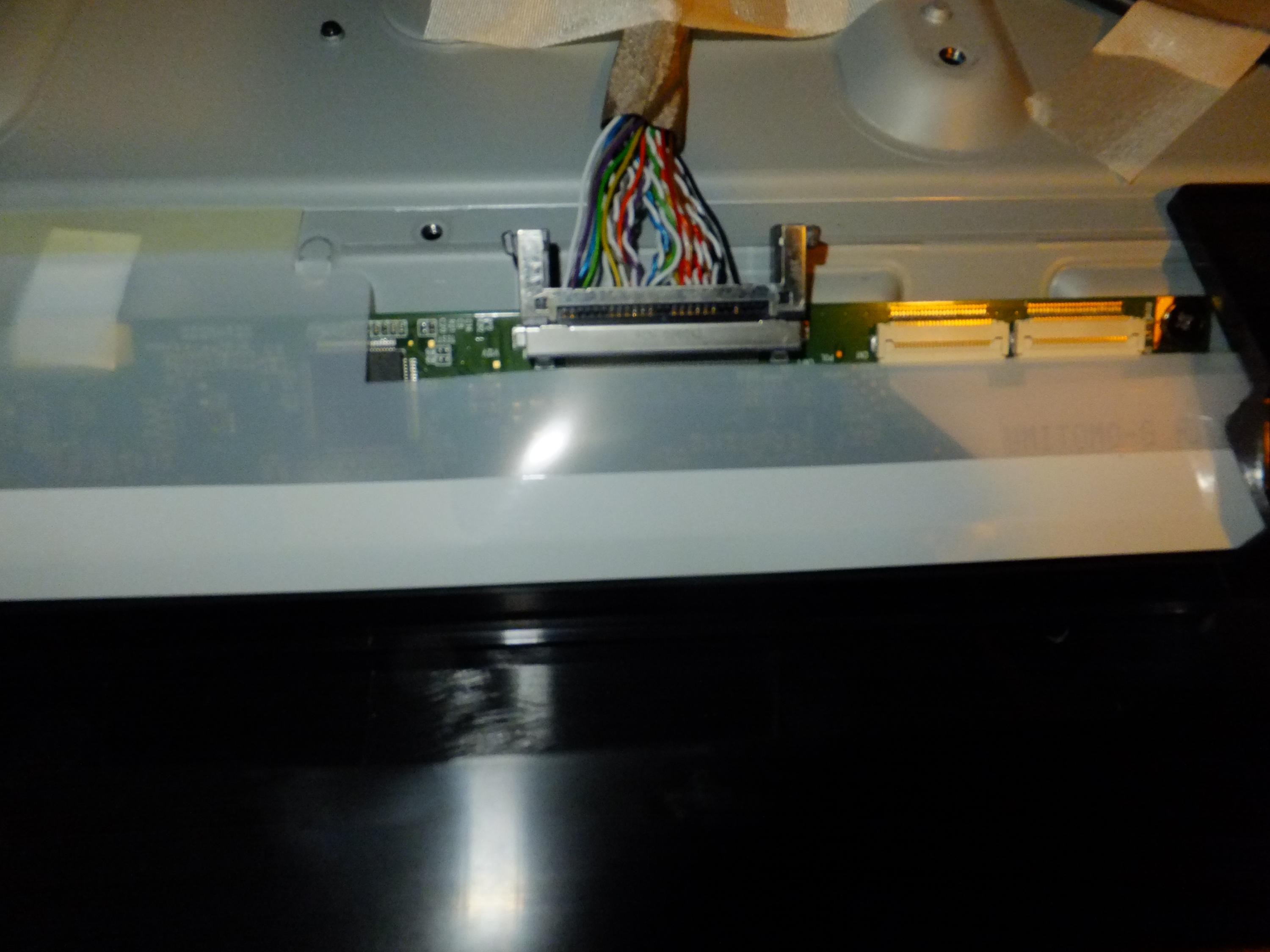

            I wonder if the LCD panel LVDS pin has a control line that put the screen into panel self-test mode and that control line get activated.
            May have to look for the LCD PANEL spec sheet to get the pinout of the LVDS connector.

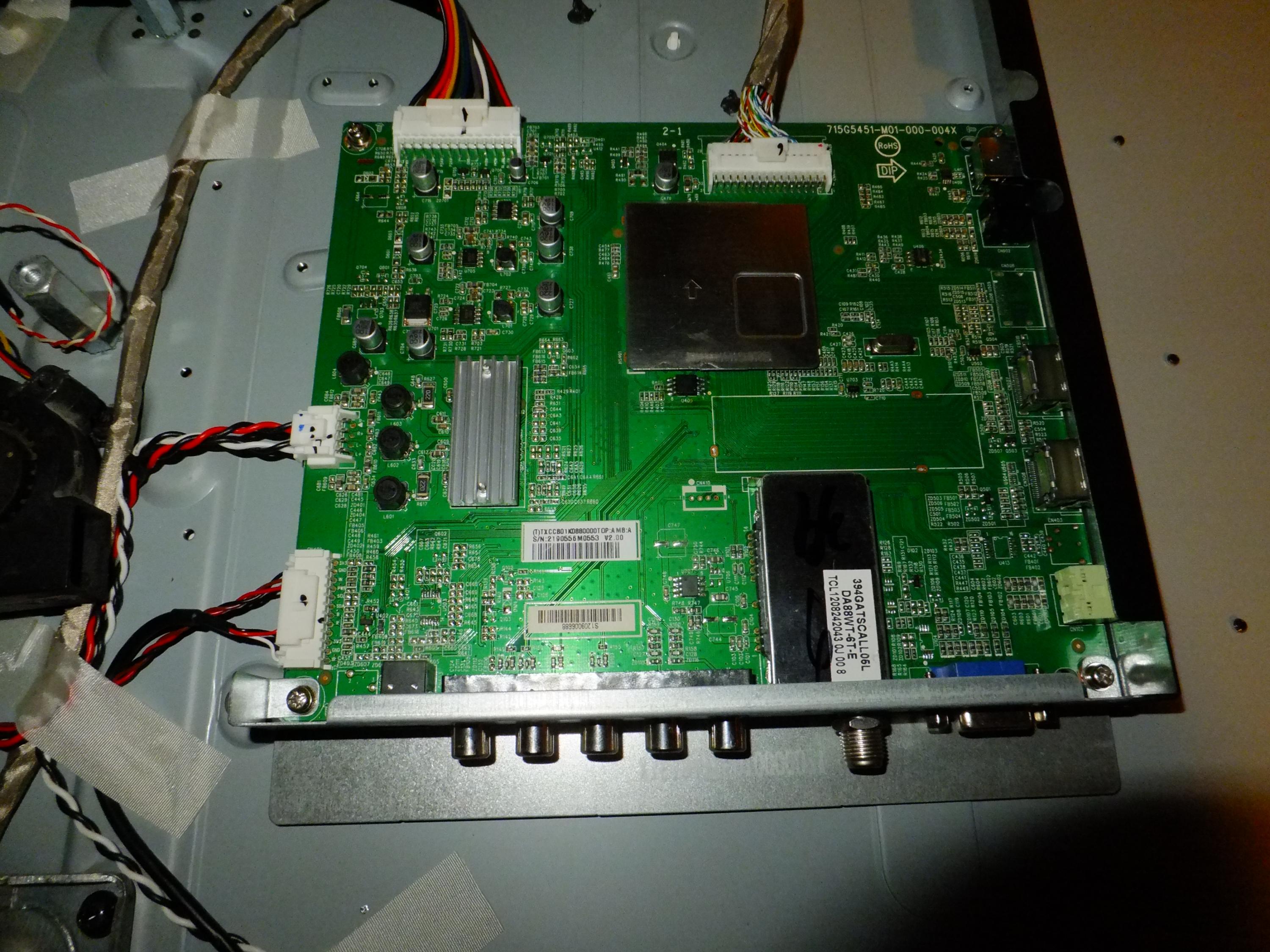

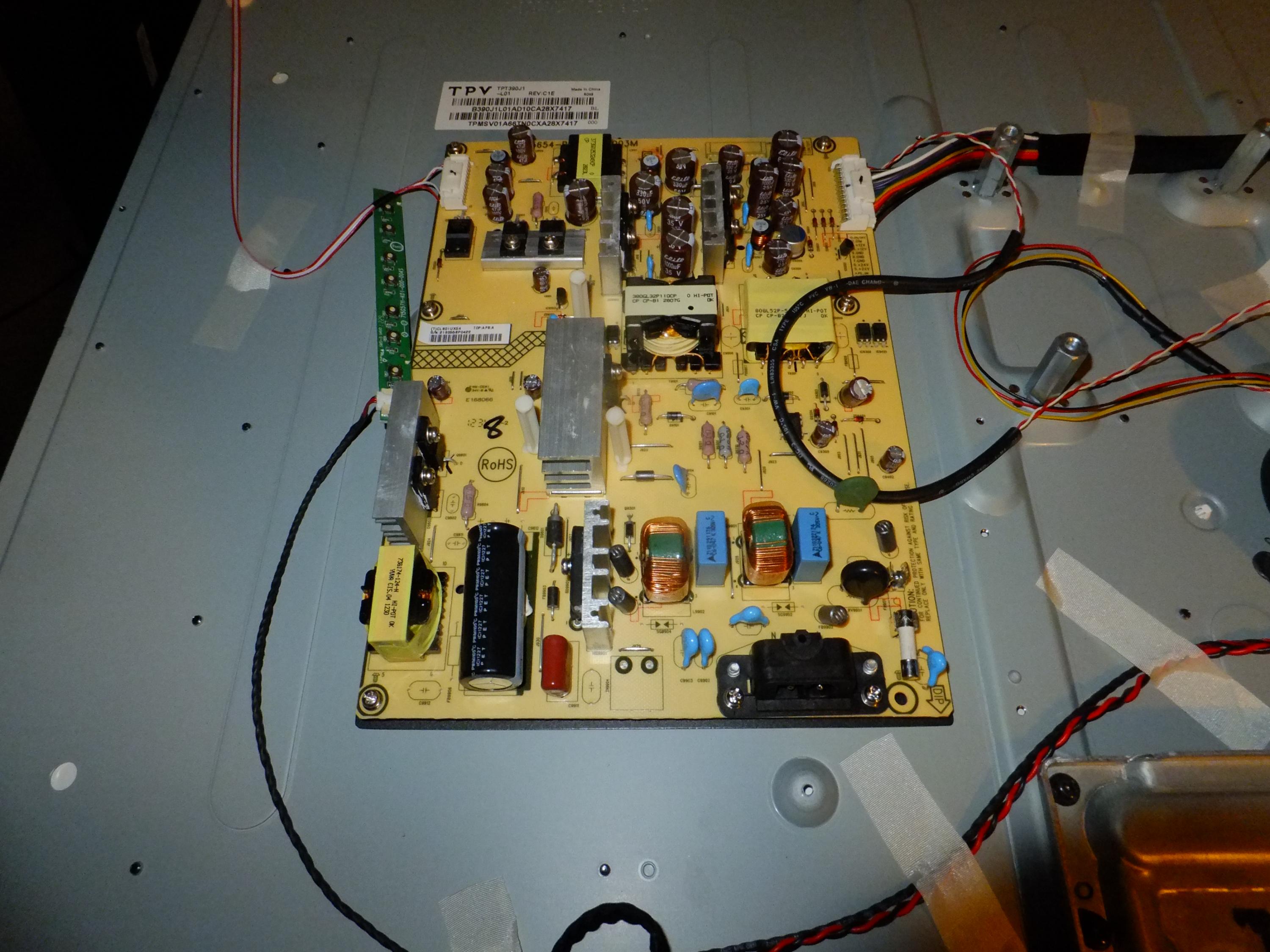

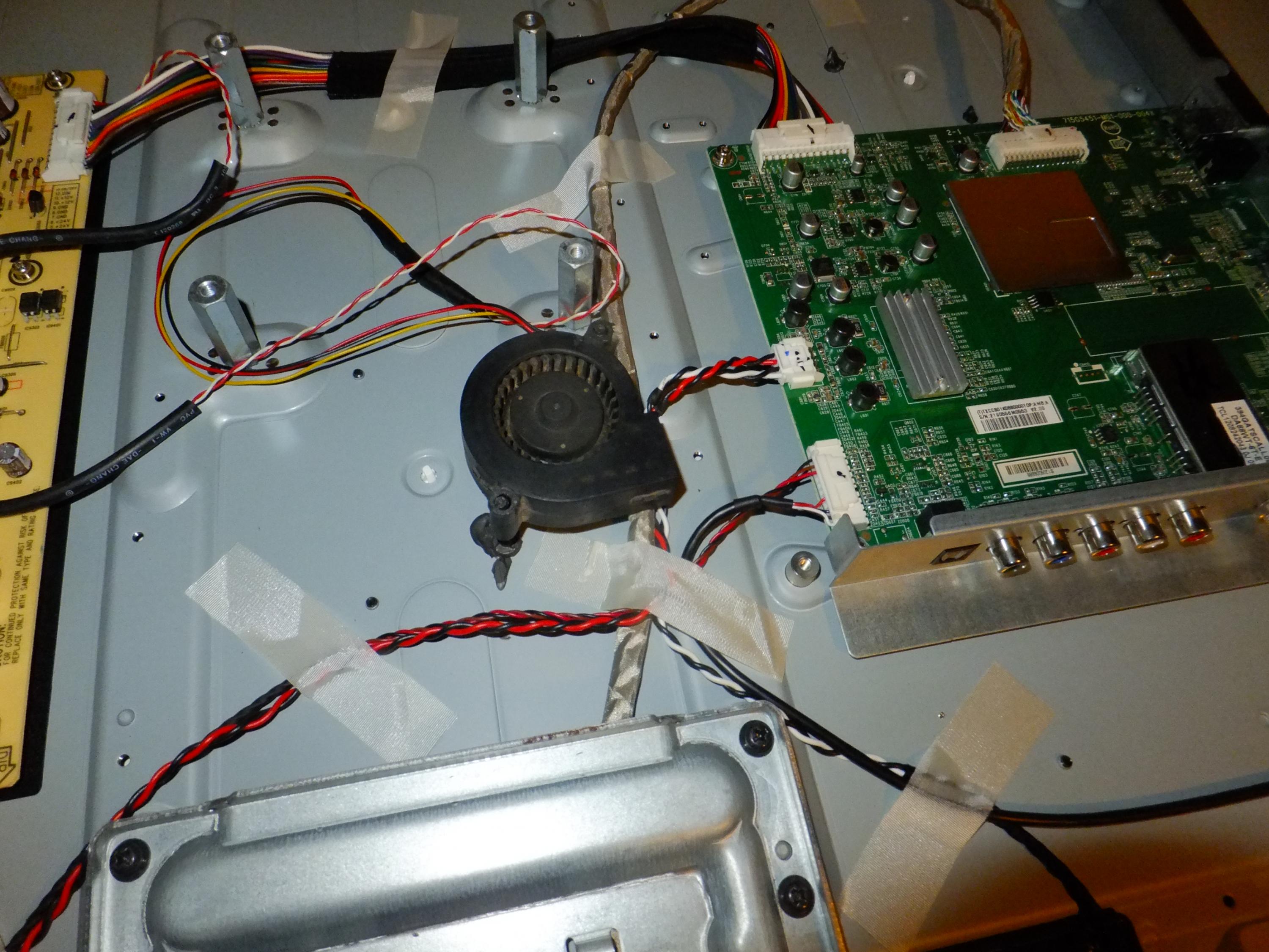

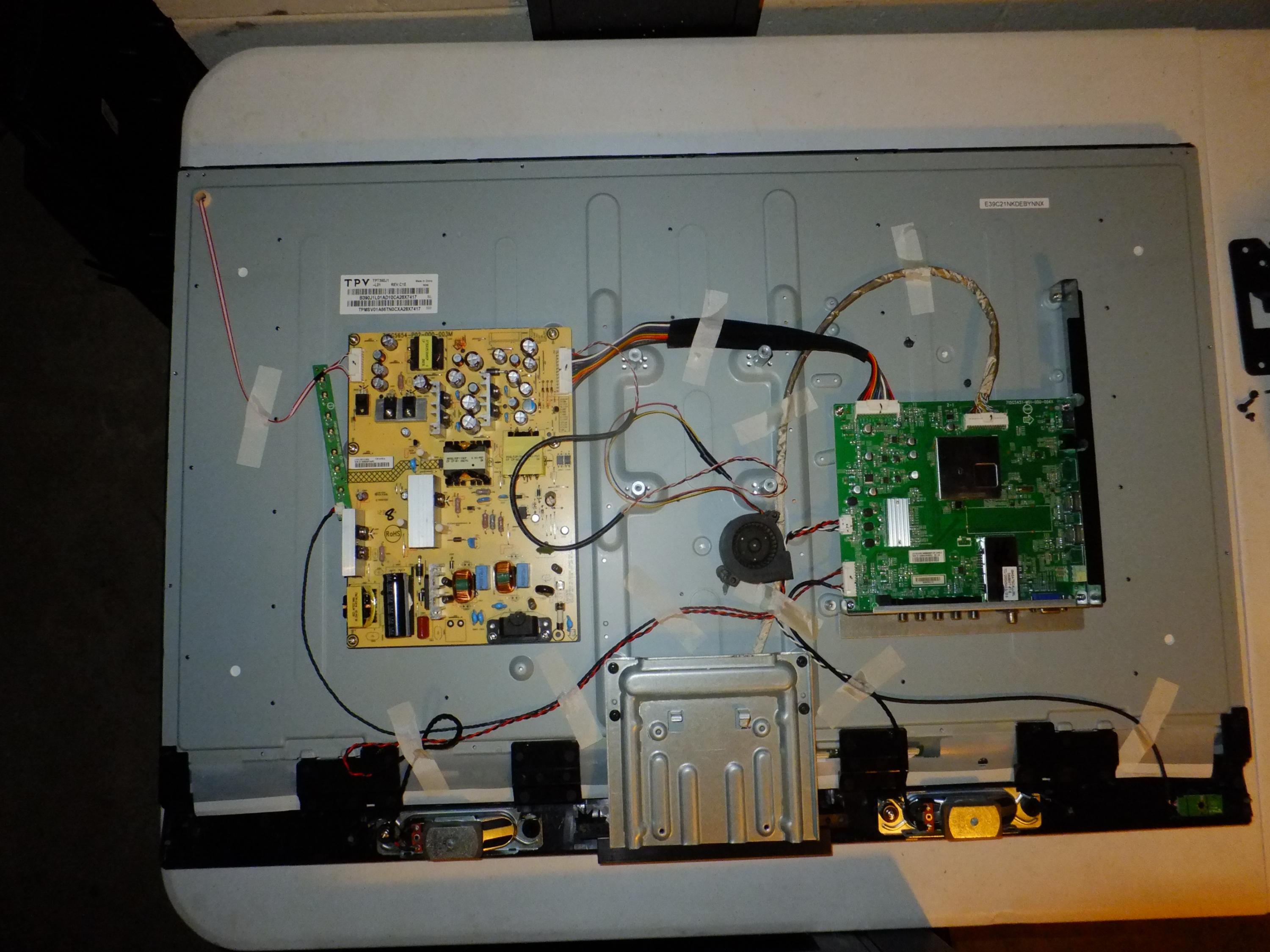

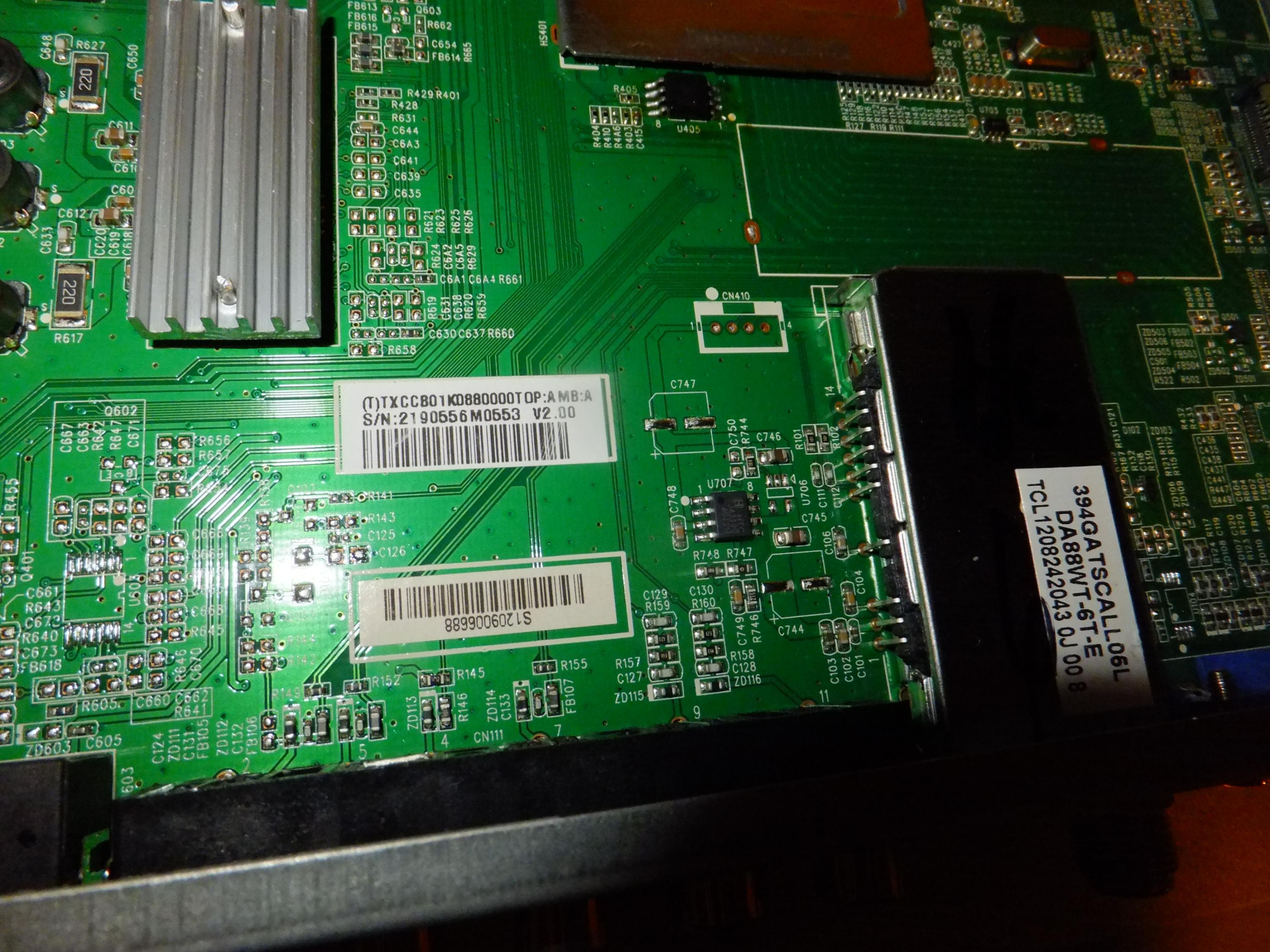

                    About the LVDS pin not sure what you mean but anything that fixes the problem is good. modification would be just fine. Here are some pictures. As you can see I added a cooling fan, I forgot why. I had these TV for over a year and have not been able to fix it.

                      Re: Insignia NS-39D240A13 Cycling Colors
                      I have a main board for a Insignia NS-32L121A13 and it is the same board but the LVDS cable is different. I am thinking it will work if I can connect it to the panel.
                      • capwizard
                        • Jun 2016
                        • 1991
                        Never try with different screen penal. OK, they made main boards for different bland name. with different EEproms, and different LVDS connections.
                        I did with two tvs have same LVDS connection, same pinout ,still need to change EEprom , then find out picture is upside down.
                        One tv you will find out has 4 different panels. Why ! With million of tv sales, panels always out of stock.
