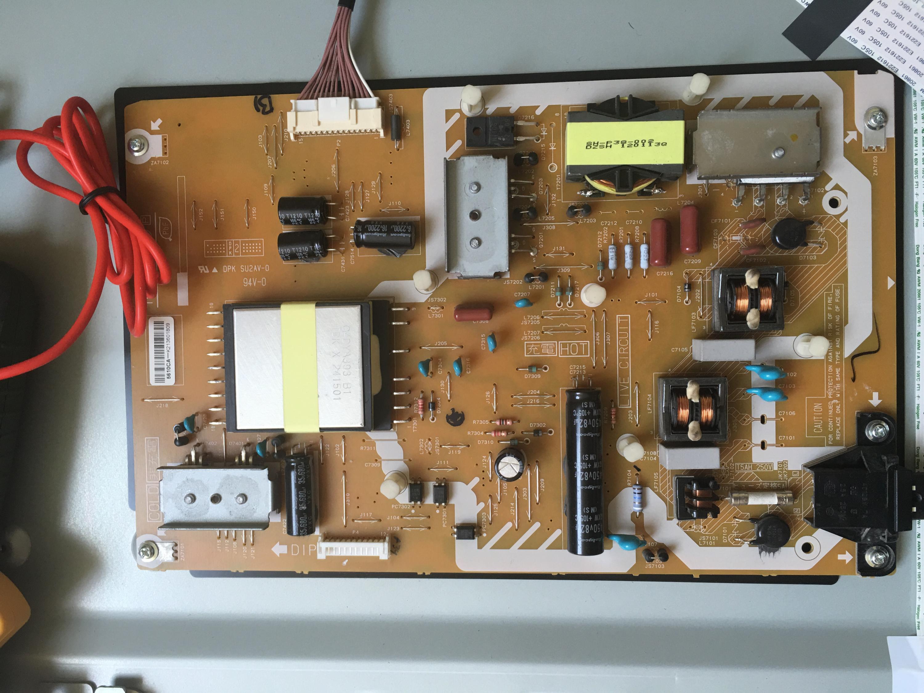

    hi,
    my tv dont turn on, only blink 3 times on the red led, and dont turn on, only blink, i looking in internet but i cant find the service manual for this tv panasonic viera model tc-l55et5x
    i need to know what could be the problem if only the power supply or something else,

    here you are the service manual. tips start with trouble shooting the power board. then go to main boards.

        I check the power supply and show this voltaje in some cases the volt going to zero when i heard a click (al oir click), the clixk sound is where the blinking light is turn off.
        1 - 16v going to 0 when hear a click
        2- 16v Going to 0 when hear a click
        3 - 16V going to 0
        4 - 0 always
        5 - 5.2 Going to 0
        6 - 0 always
        7 - 0v to 2.5v when hear a click
        8 - 3.3v to 0v al oir click
        9 - 3.3v to 0v al oir click
        10 - 3.3v to 0v al click
        11 - 0 always
        12. 0 always
        13. 0 always
        14. 0 always
        15. 0 always
        The connector to led deover
        1. 0 always
        2. 0 always
        3. 3.3v down to 0
        4. 0v always
        5. 0v always
        6. 0v always
        7. 23v down to 0
        8. 23v down to 0
        9. 24 Down to 0
        10. 3.3v down to 0
        11. 3.3v down to 0
        12. 0 always

          first disconnect P4 socket from power board to LEd driver Board you may have LED BL SOS signal. so you can check the 16 volts and 24 stay stable ?

            I check and inhave this voltage in the output to led driver:
            1. 0v
            2. 0v
            3. 3.3v and i hear a click show 0v
            4. 0v
            5. 0v
            6. 0v
            7. 0 and when hear a click 25.4v
            8. 0 and when hear a click 25.4v
            9. 0 and when hear a click 25.4v
            10. 3.3v and when hear click its 0v
            11. 0v
            12. 0v
            The tv show 3 led blinks. Keep the same state

              also pin 7,8,9 after relay click it show 25,4V and stay so, not drooping down to 0 .. right ?
              how about the pin reading on the socket which go from PWB to main board ?

                The pins 7, 8 and 9 drop to 0.. Dont stay
                About the connector to main board disconnect i going to test....

                    i check de power supply with disconect the cable to main board, and only the pin 5 have 5.2V

                    the problem in the manual says:
                    3 blinking times => STM IROM BOOT PROGRAM SOS => check P-board and A-Board
                    or if you want the version firmware it have the last, firmware version 1.270
