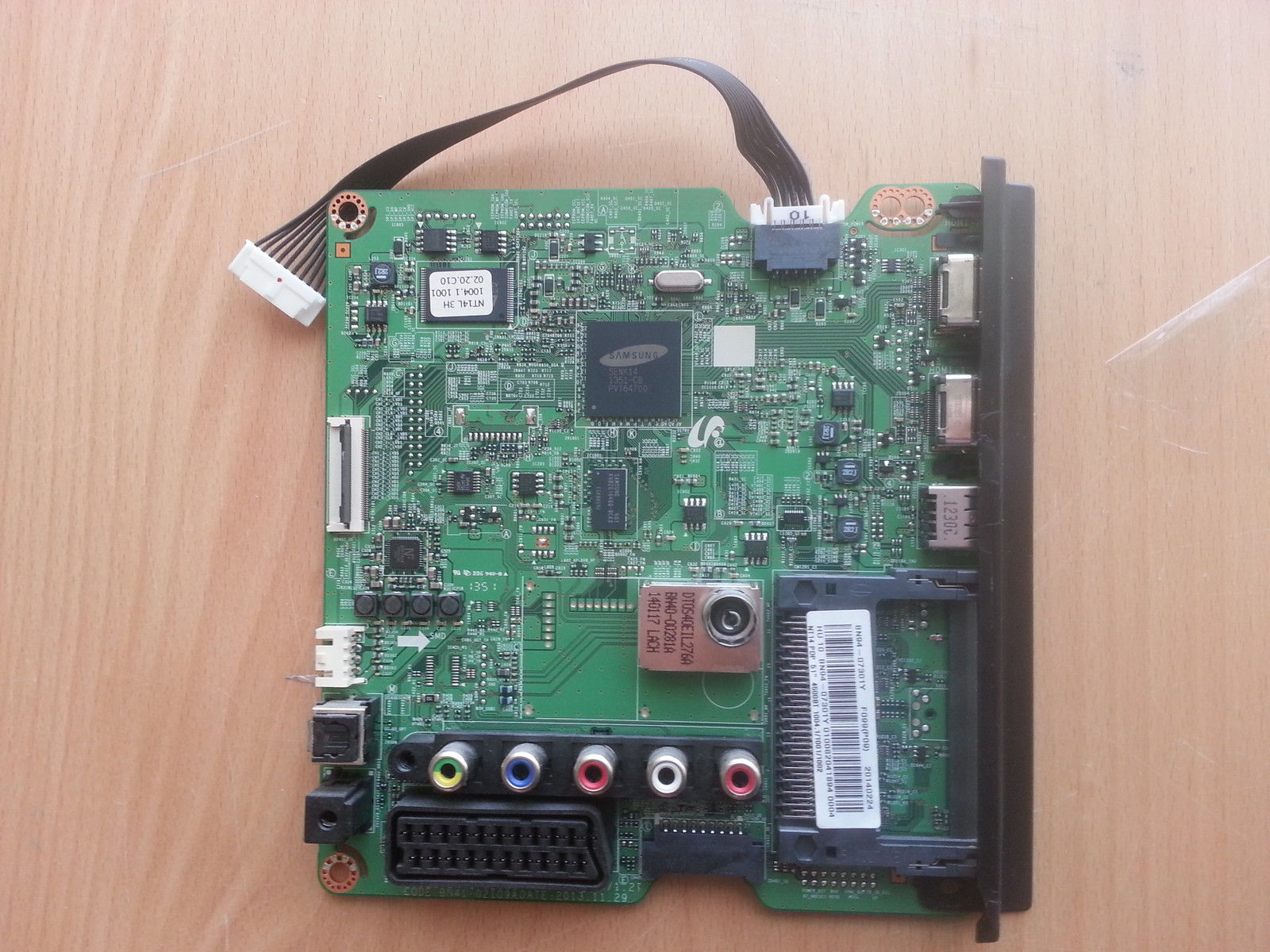

      Re: Samsung plasma pa51h4900
      Here is the board for the samsung plasma, i also noticed the processor being hot
        Need photos of all the boards hooked up like you just had taken the back off the set.
        Then clear close up shots of each board individually.

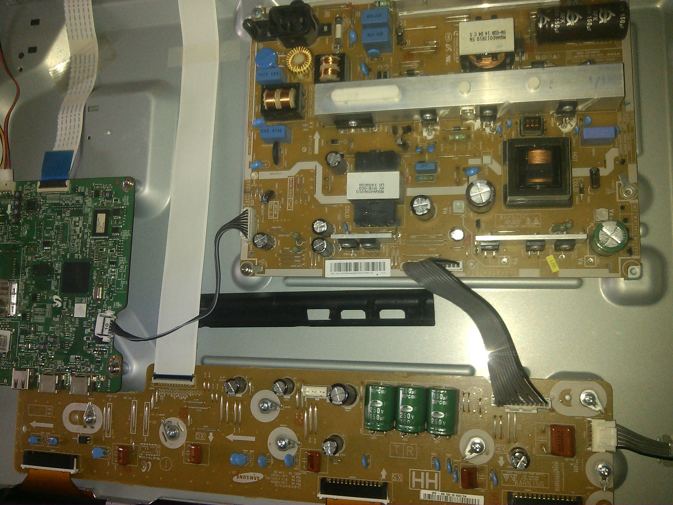

          Here is the board for the plasma

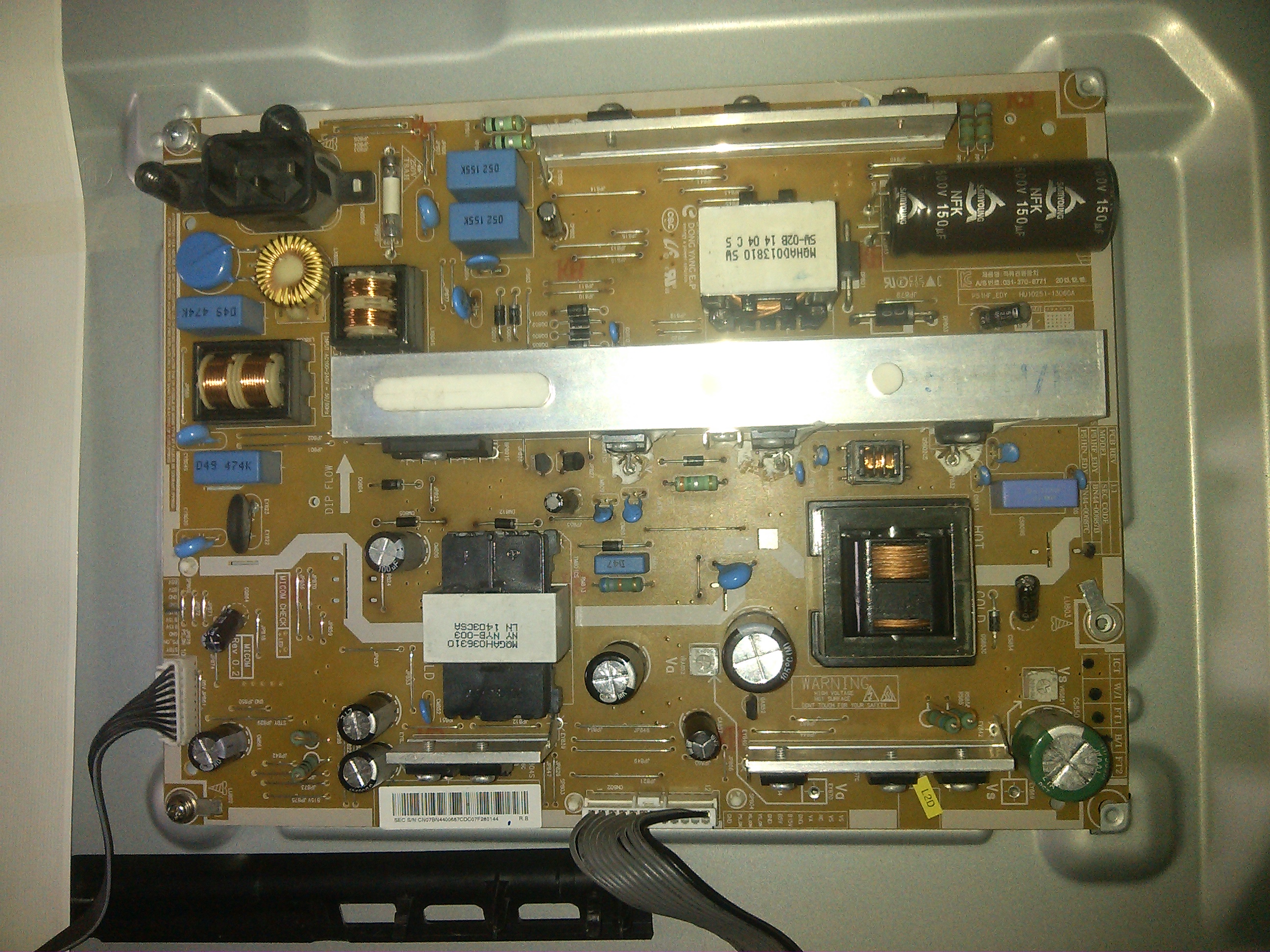

            another part of it, but i have a question you said i should check vs va and others, if those voltages are missing will it stop the standby light from lighting? because i checked there is stby 5v present from the power
              When you press the power button on remote it triggers 5v standby to go to the main board and a return signal is then sent back to the power board (ps-on or rl-on or similar) telling it to turn on all the other voltages including Va Vs. Read through other posts on how to jumper stdby and ps-on so that main board is bypassed. If voltages then all come up the main board is suspect if they don't come up then powerboard is suspect but check again with y and x boards disconnected.
