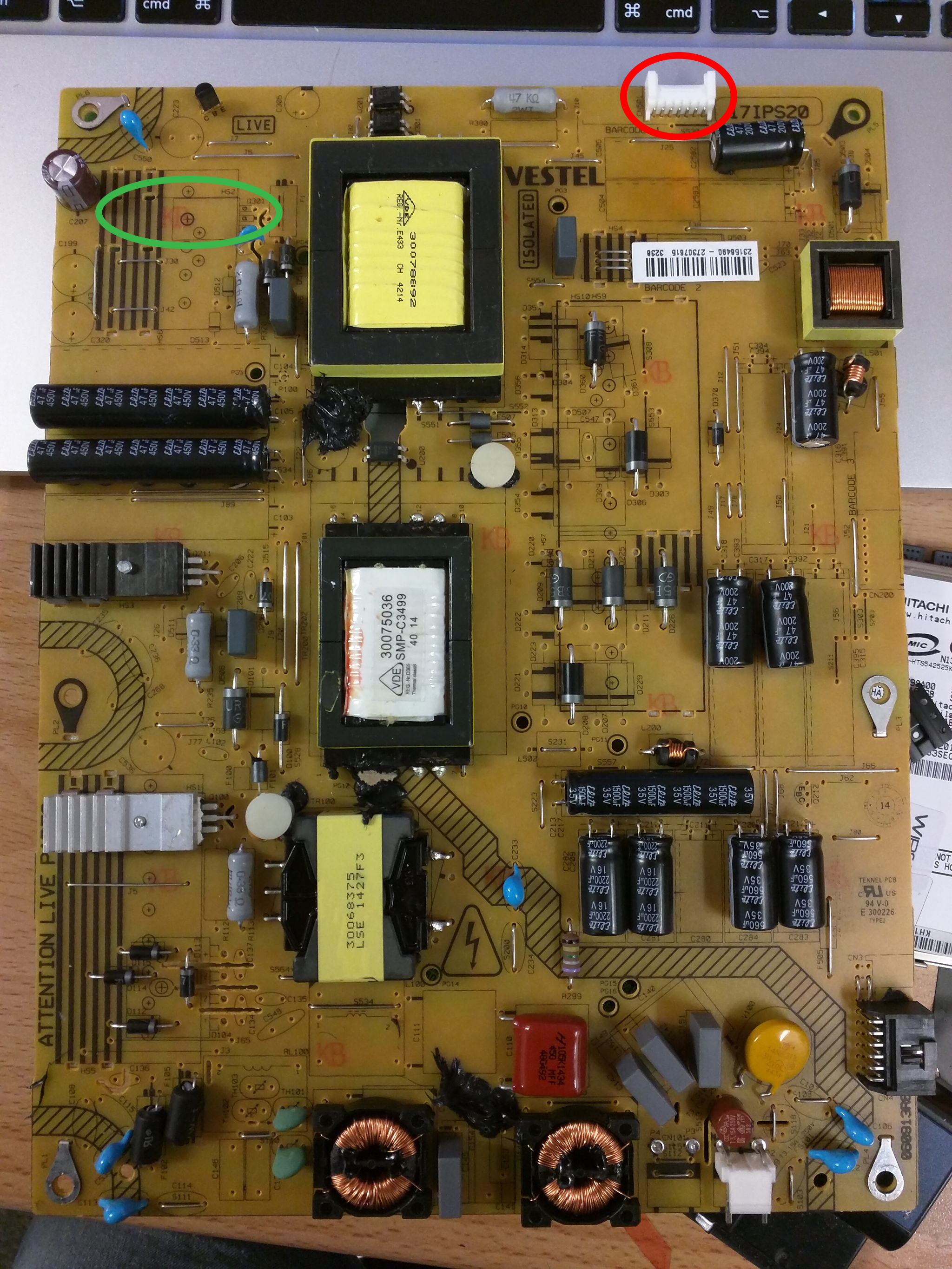

    17IPS20 No LED Voltage Output

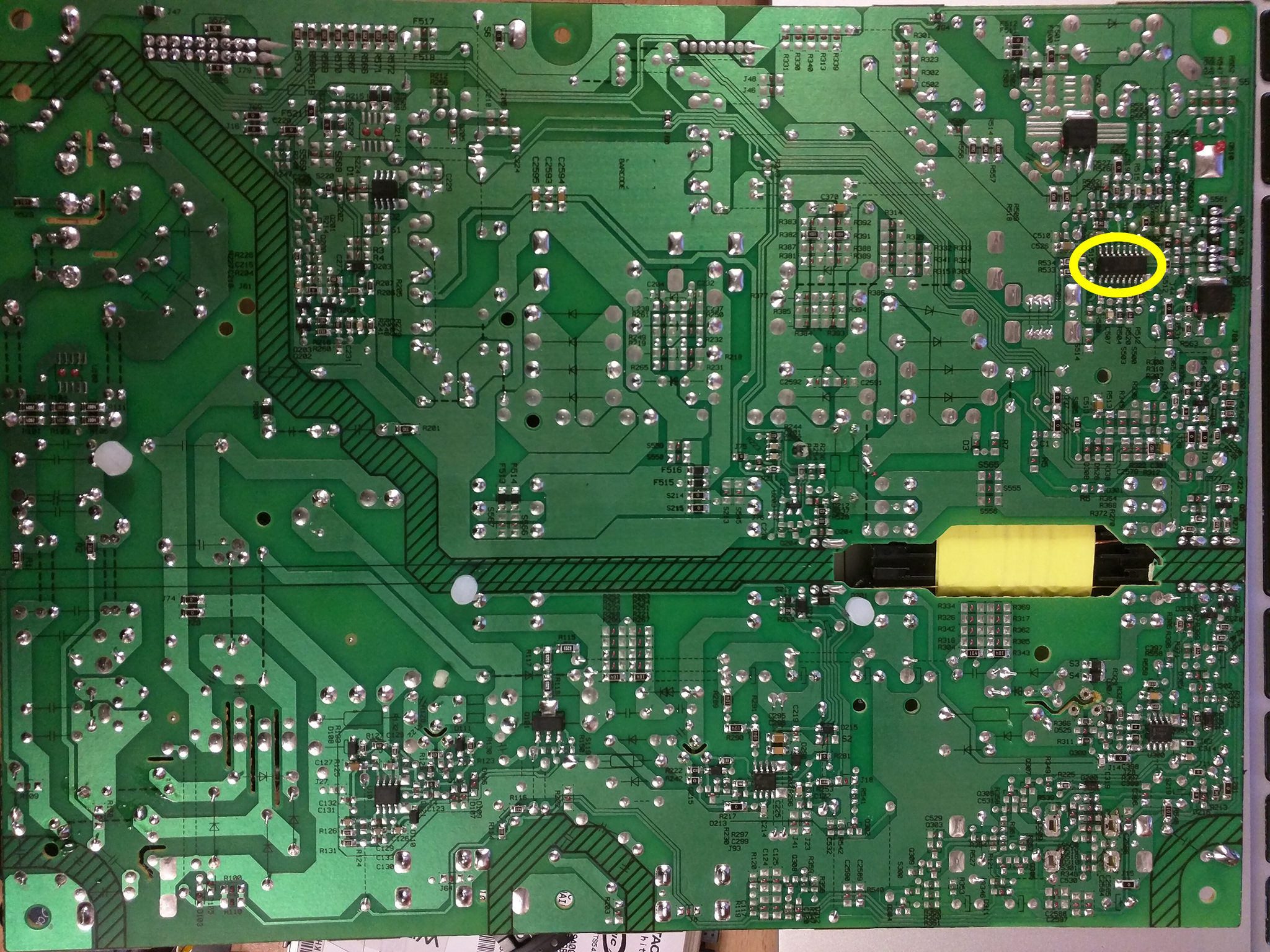

    Mine has no led voltage output (red circle)
    Green: took out for testing, it's ok.
    Image:
    Yellow: Change with new off ebay, same issue.
    Other two fets seems ok so never changed. Anything else to check, please?

    Re: 17IPS20 No LED Voltage Output
    Change the Smps controller for that mosfet if thats failed the fet wont be turned on. Its a small chip near the mosfet on the bottom side of the Pcb. Also consider testing the led mosfet and diodes for S/C just incase. That controller turns on that fet for the Led circuit I have had this issue before will be doing video soon.
      Hey. Where exactly? U201/U301? If you mean yellow circle: U500, done that but same.

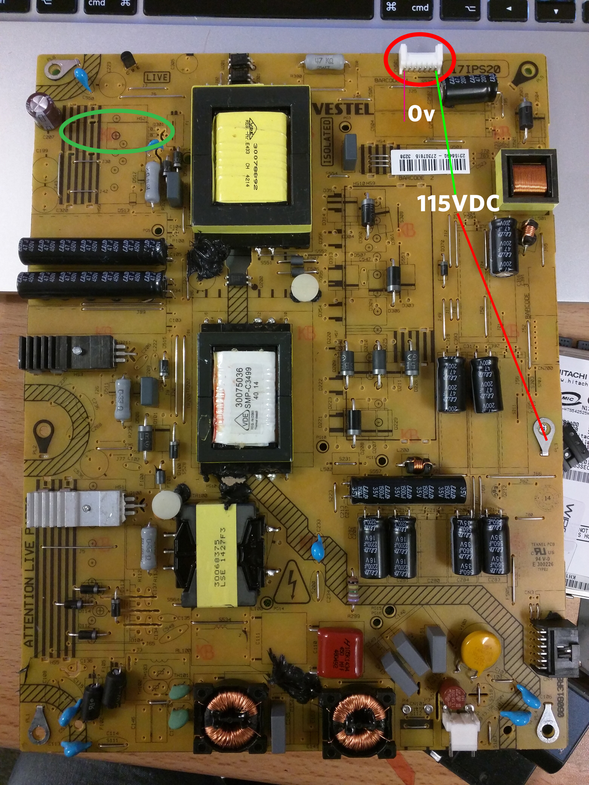

        More testing, I get 115VDC on the positive pin in red: A probe on + pin and a probe (-) on the negative part of the board. When I put both probes in red circle, no voltage. So something is faulty on the negative side in red circle.
        The cap beside the red circle, on the (+) pin, I get 115VDC.
            What are you saying...When you turn the TV with the RED probe on the +ve pin to the LEDs you have 115V wrt chassis GND and when you turn the TV with the RED probe on the -ve pin to the LEDs you have 0Vwrt chassis GND?
              exactly, voltage measured between chassis GND and (+ve) is 115V and if you measure it between +ve and -ve on connector is 0 V.
                No Voltage reading between -Ve and GND means you have open circuit in the LED string some where.
                  hmm. I mean that I have disconnected the leds from power board connector. I measure it directly on power board pcb. So on the on the connector marked with red circle on picture (speedpro posted) on his last post.
                  If I measure on power board connector between +ve and -ve I got 115 V
                  If I measure on power board between connector +Ve and chassis GND I got 0V.
                  So I assume that there is sth on negative side...
                    1) TV off
                    2) all connectors back in place.
                    3) Keep black probe on the chassis, red probe on the +ve then turn TV on and see how high the Voltage jumps up to, then turn TV OFF
                    4) Now move red probe to -VE, turn TV on and see how high the Voltage jumps up to.
                    5) Report those readings.
                      Originally posted by budm
                      1) TV off
                      Results
                      3) black probe on the chassis, red probe on the +ve then turn TV - voltage jumps to 195V and that goes down to 115 V
                      4) red probe on -VE, turn TV on .
                      Voltage is constant on 11 V
                        So the booster circuit kicks on 195V but then it goes into over Voltage shutdown so it goes back down to 115V which is the feeding Voltage to the input of the Boost converter circuits, you have open circuit in the LED string, wiring, connector problem some where.
