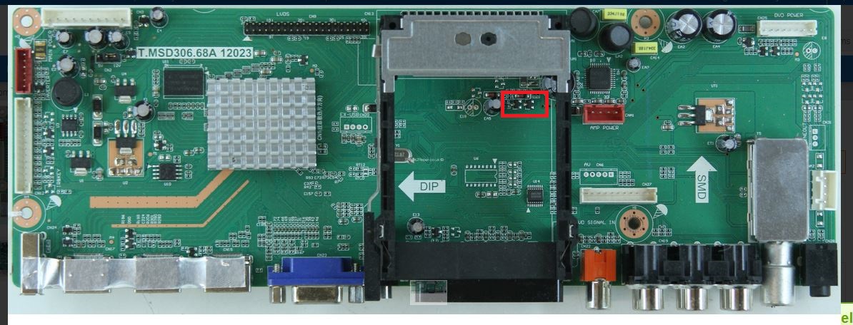

    Picked up this set a few days ago with symptons no sound. Opened up the back to take some measurements and the sound returned. No amount of flexing and tapping the board would stop the sound.
    Main Board T.MSD306.68A 12023
    After running for about 4 hours the sound dropped out again and again no amount of tapping, flexing or cooling around the audio amp (R2A15122FP) would bring the sound back.
    Out with the meter. Supply voltages on VD1 (Pins 13 & 14) and VD2 (Pins 37 & 38) were both present at 25V.
    Checking the mute input (Pin 34) the voltage change on the pin when mute was selected on remote was 3.4V to 2.9V.
    Followed the mute control line back to the two smd transistor (H1A & H2A) close to the audio amplifier "Power In" connector.
    Resoldered the two smd transistors and problem now appears to be solved.

      Unfortunately, my sound problem has re-appeared and can drop out after the set has been on for many hours or refuse to come on at switch on.
      Using an oscilloscope, I appear to be losing the signal input to audio IC. Applying an external signal to the chip gives me audio output so confirming the IC is still working.
      The main processor on an identical board I have is an MSD306PT-LF-Z1 but I cannot find any information on it and think the audio codec is probably integrated on this chip.
      Has anyone information on this IC since googling doesn’t seem to bring up any useful information.
      I notice that many makers are using this main board (T. MSD306.68A 12023) and they all look identical having the same main board identification number but driving different make and size LCD panels.
      My question is, are theses boards interchangeable into other maker’s sets using this main board if you exchange U10 supposing of course U10 is still working.

        Out of curiosity when I go into the service menu it says the checksum is correct so can I assume that this is not an EEPROM (SPI) fault and therefore I can only think that I must have an intermittent problem on the main board MSD306 IC?
          Re: Veltech LC-39GL12F - Intermittent Sound
          Reluctantly replaced the main board and fitted a Bush LC-39GL12F mainboard model T.306.68A 12023 Panel V390HJ1-L02
          Set is now up and running. On screen menu looks identical to the Veltech menu.

              The MSD306 main BGA IC was losing the audio output to the audio amplifier. Heating the chip did not help so finally gave up on it.
