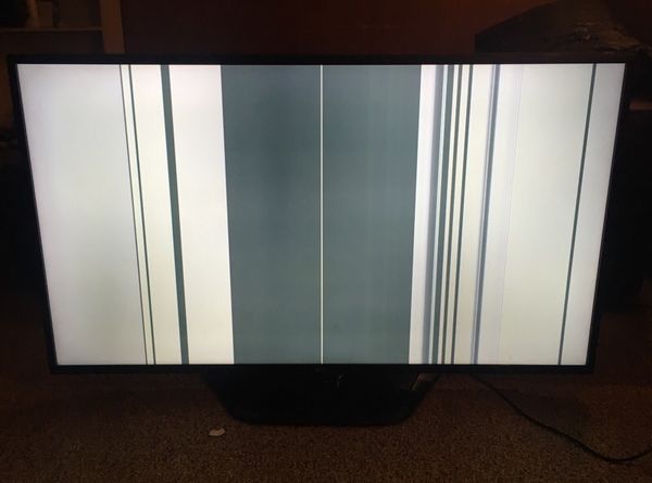

    What type of "Failure" does this look like?
    My friend is selling their TV for parts and I wanted to help fix it so they didn't have to scrap it. I've seen Tcon failures before but not in gray scale with that large of bands. Does this look like a panel failure? It is an LG 55" but I don't know the model. Just getting this thread started but I won't get a chance to go over to look at it until this weekend to pop it open and try to clean the connections and check to see if they are solid. Just wanted to get a head start if anyone has seen one like this before. Thanks

    Looks like panel failure to me. Try disconnecting the ribbons to the panel from the Tcon, one at a time.
      Re: What type of "Failure" does this look like?
      Agreed on panel failure.

        Sure this isn't a plasma ? I've seen a similar fault in an LG plasma that had shorted buffer fets.

          With the symptom going the whole way across the display, you may possibly have a T-con failure. It's 50/50, but would be worth it to substitute a T-con to check. Usually if you have that same symptom in only a portion of the display, then it is 98% a display failure.

            Well, Thanks for the replies. I'm gonna smack my buddy up side the head. Stopped by this weekend and he was actually wanting to buy this tv and just forwarded me the picture. How do you delete a post? Sorry for wasting time. I was actually looking forward to trying to fix it on the cheap.
