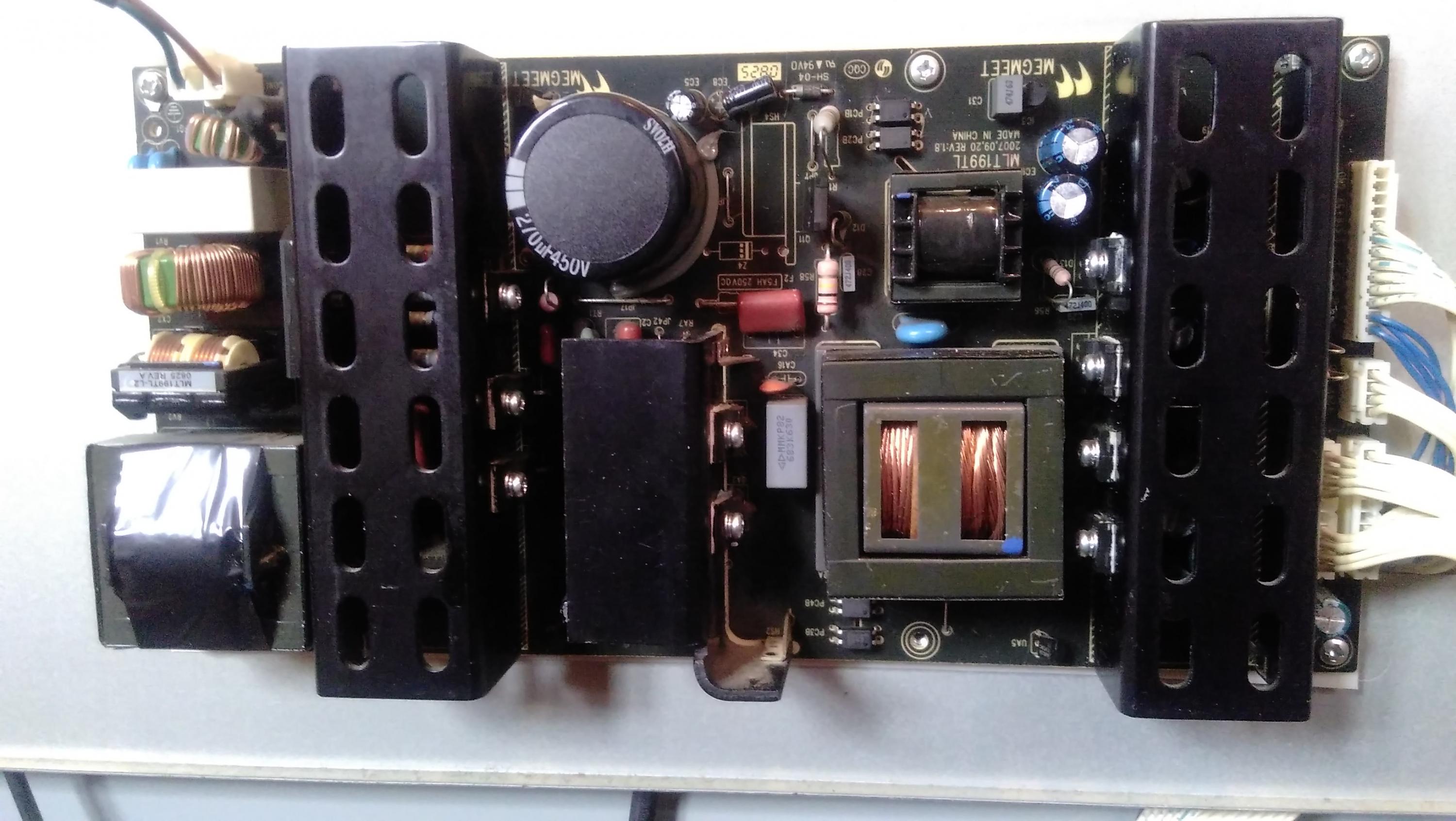

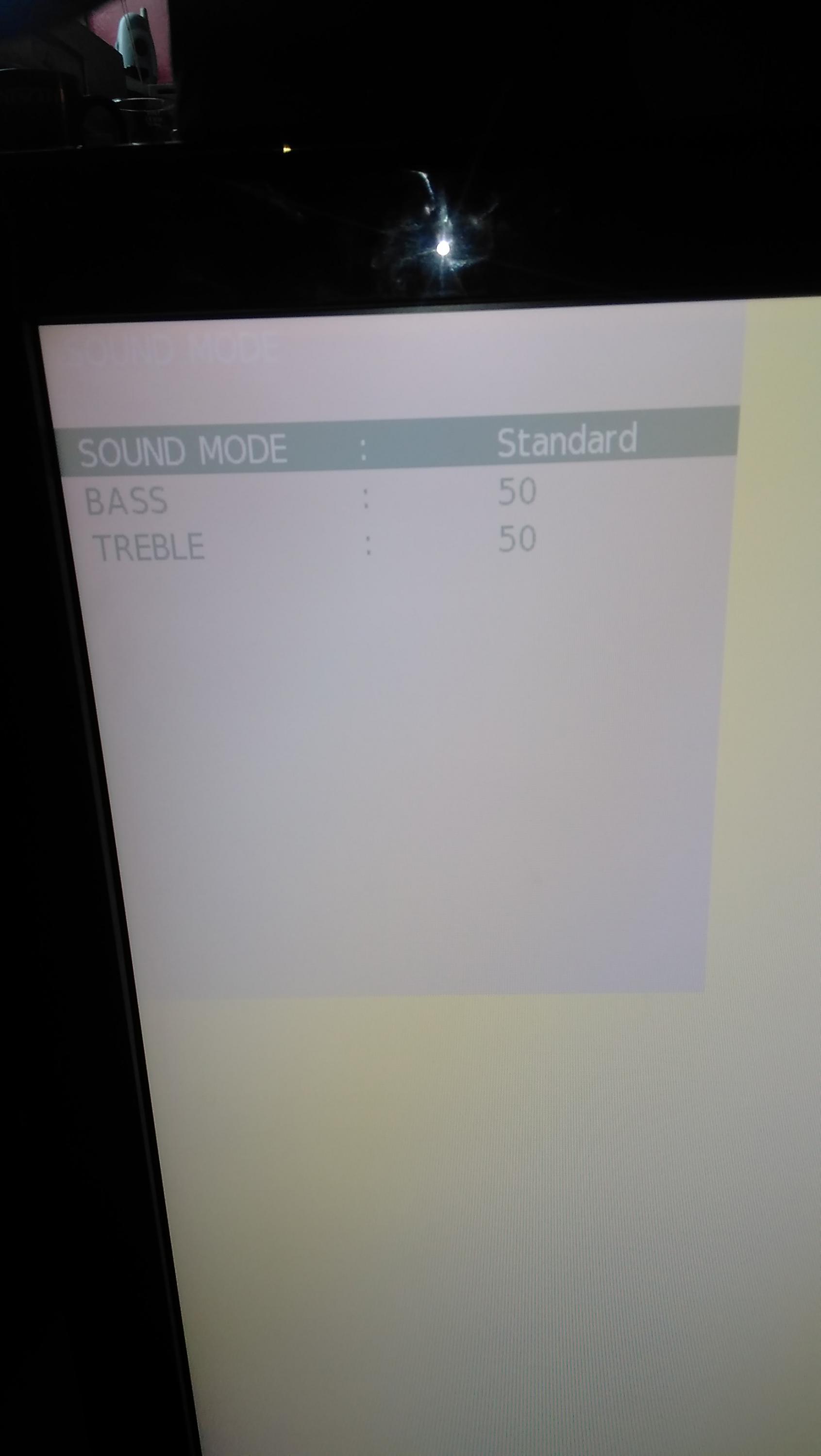

    I have This TV, all of a sudden it gave me problems getting out of stand-by, (red light would just flash away).
    So I replaced 5 of the Capacitors, Now the unit switches on from stand-by quite happily.
    However, Now the screen appears to be extremely bright pinkish white. Can still see the image displayed on screen, the picture seems like a negative.

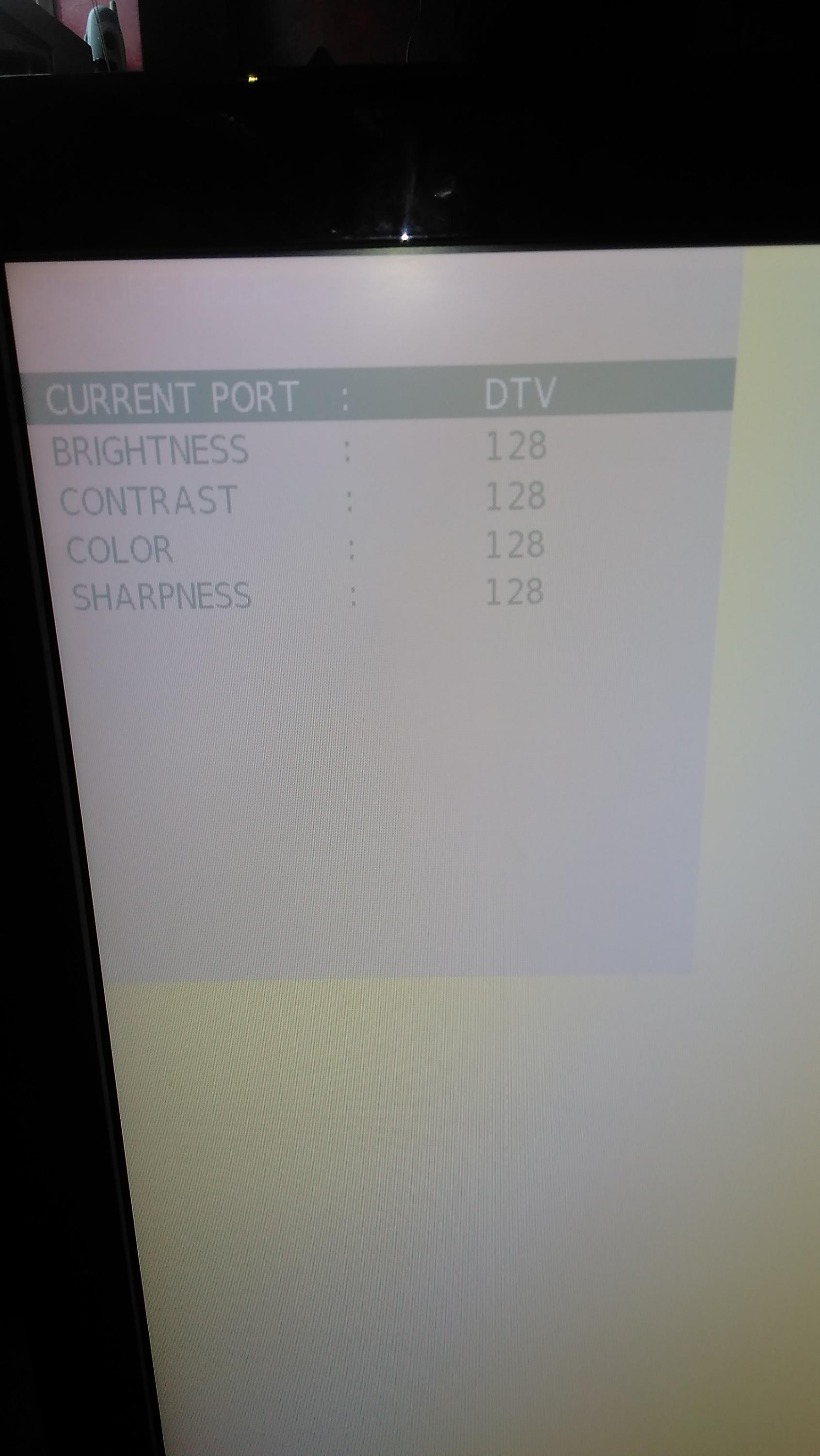

    entered Factory Mode (source 2 5 8 0) no eprom reset option there,
    so where do i go from here?
    Any help/Guidance will be greatly appreciated

      Hi and thanks for the reply.

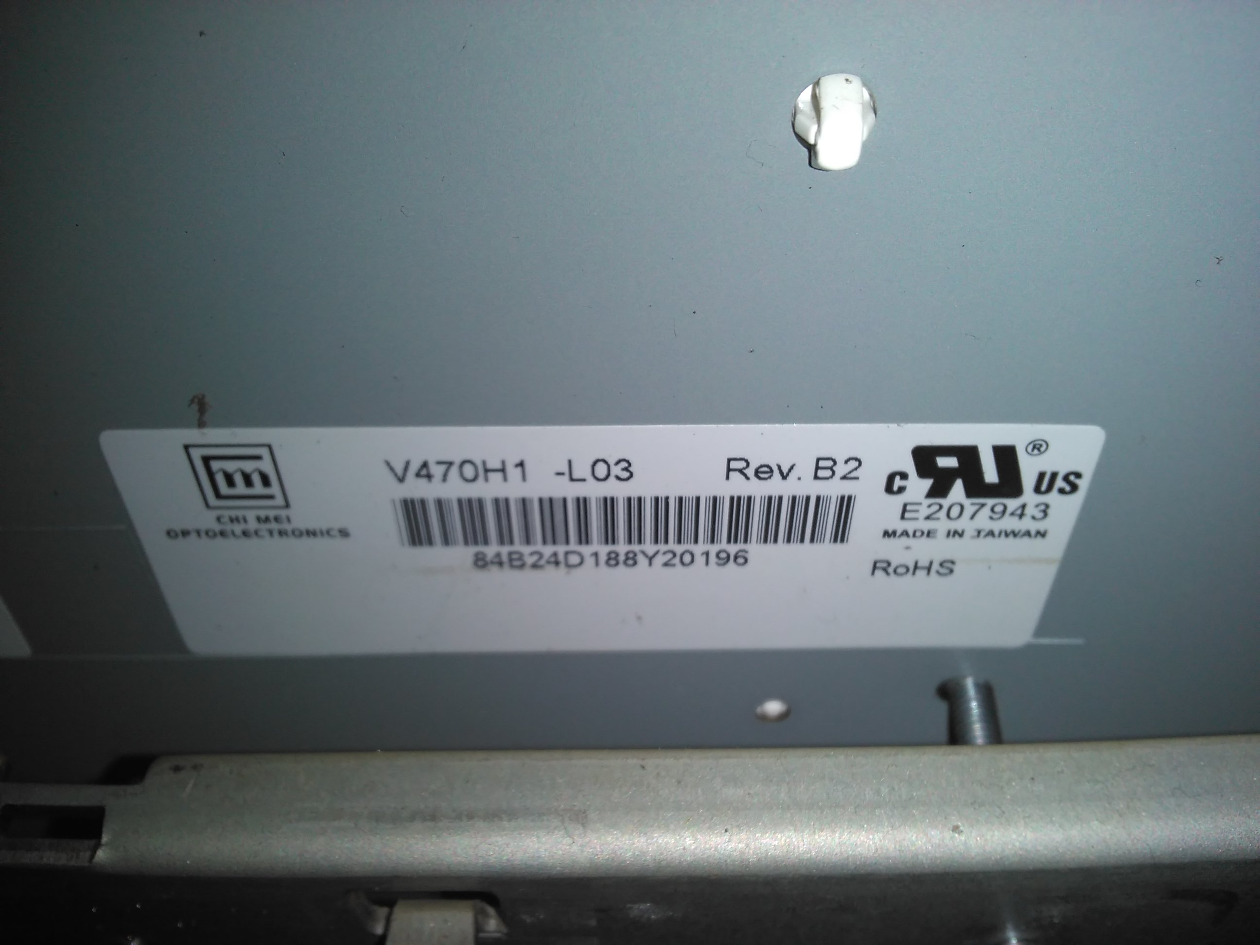

      Although I don't know if it would make much difference, the screen on this unit is CMO.
      I've managed to get into the menu (source 2580) but unfortunately there is not a reset option, only thing available is "shipping mode".
      I was informed that I more than likely have corrupted firmware, and was told to look for a bin file. I have found one which I will attach, however I am not 100 percent certain that it is the correct one, not to mention that I require a pointer on how to flash it as there are not any usbs on the unit.
      So any help and advice I will greatly accept!
      Regards
      Ben.

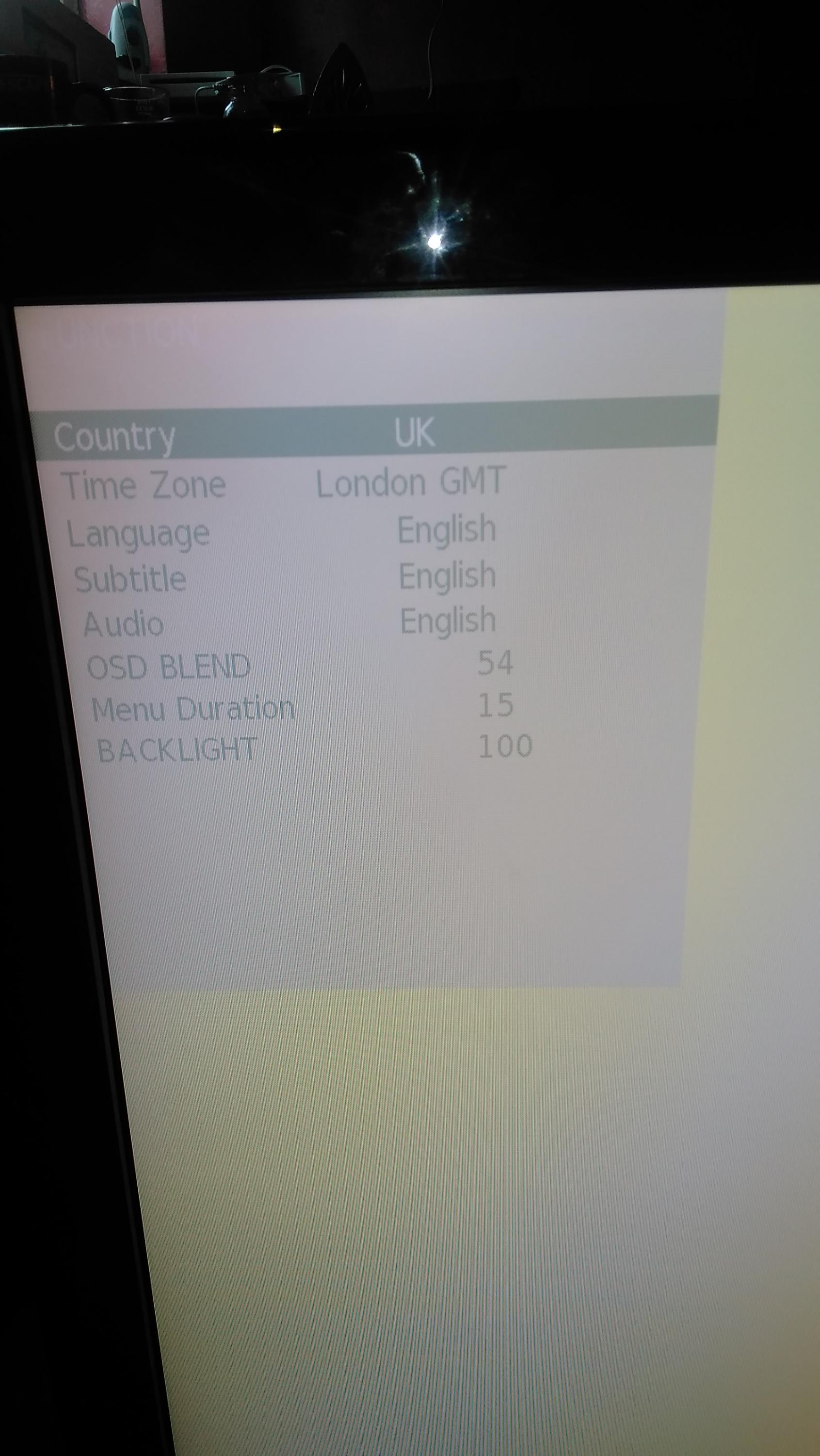

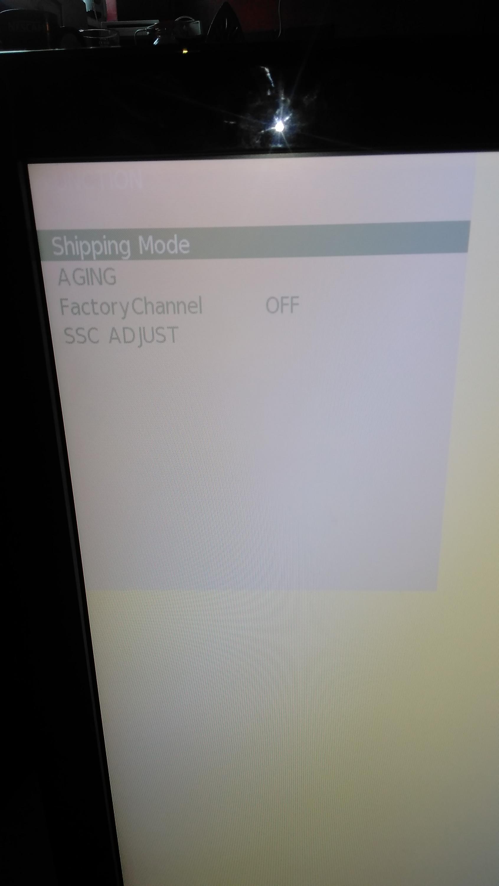

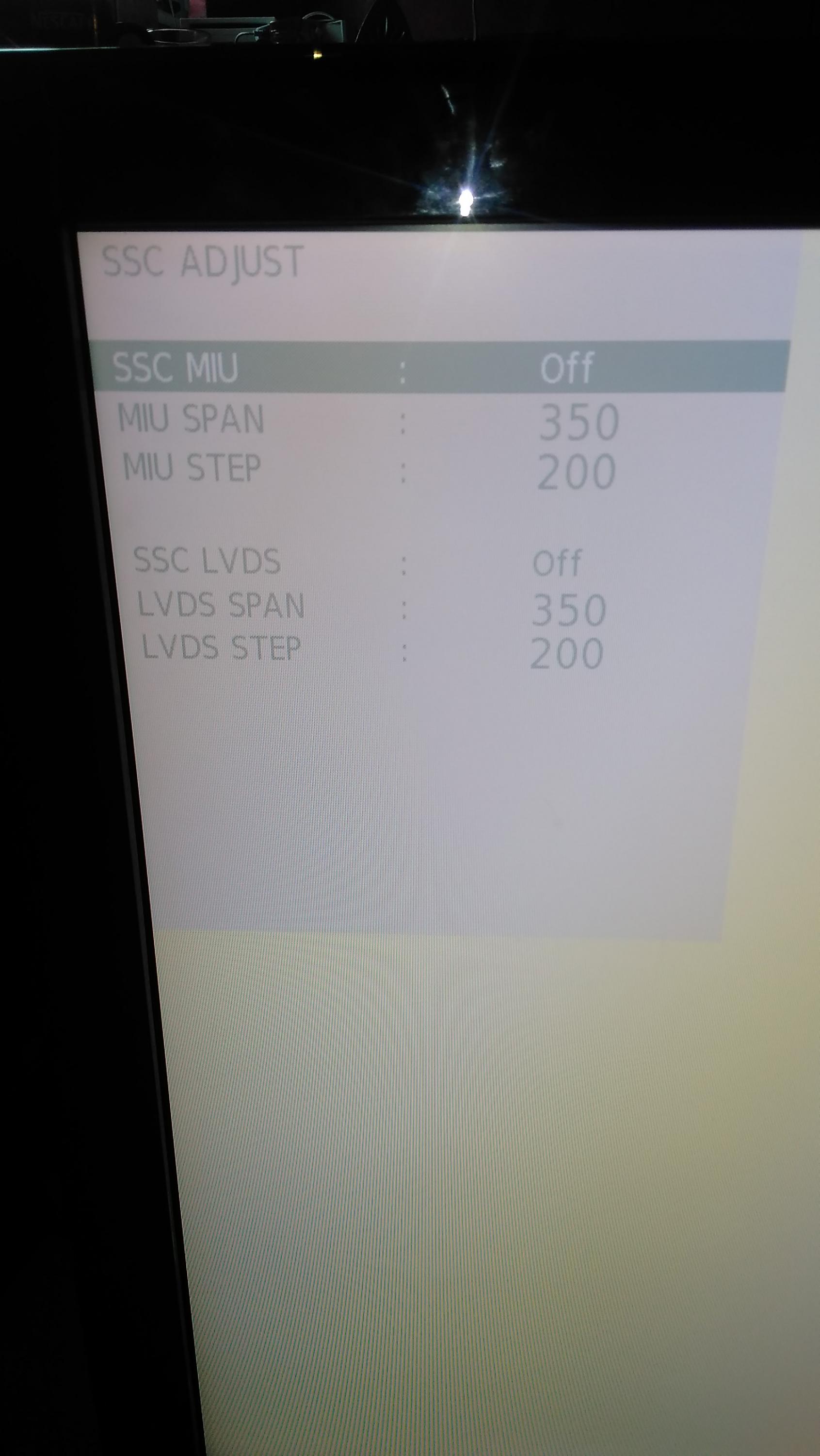

        Also noticed that two settings are set to "off" position, they are:
        ssc miu and ssc lvds
        Is this correct

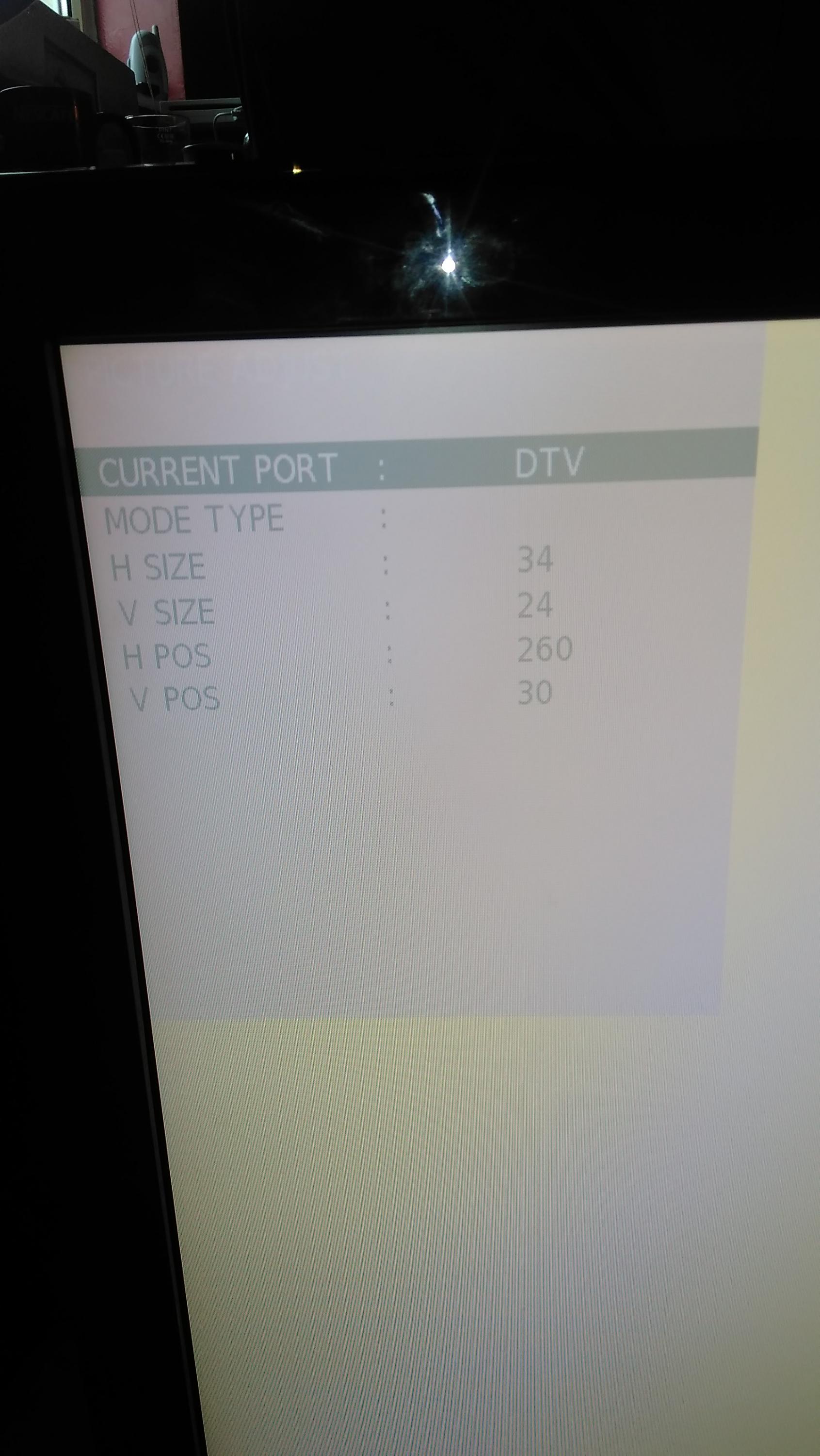

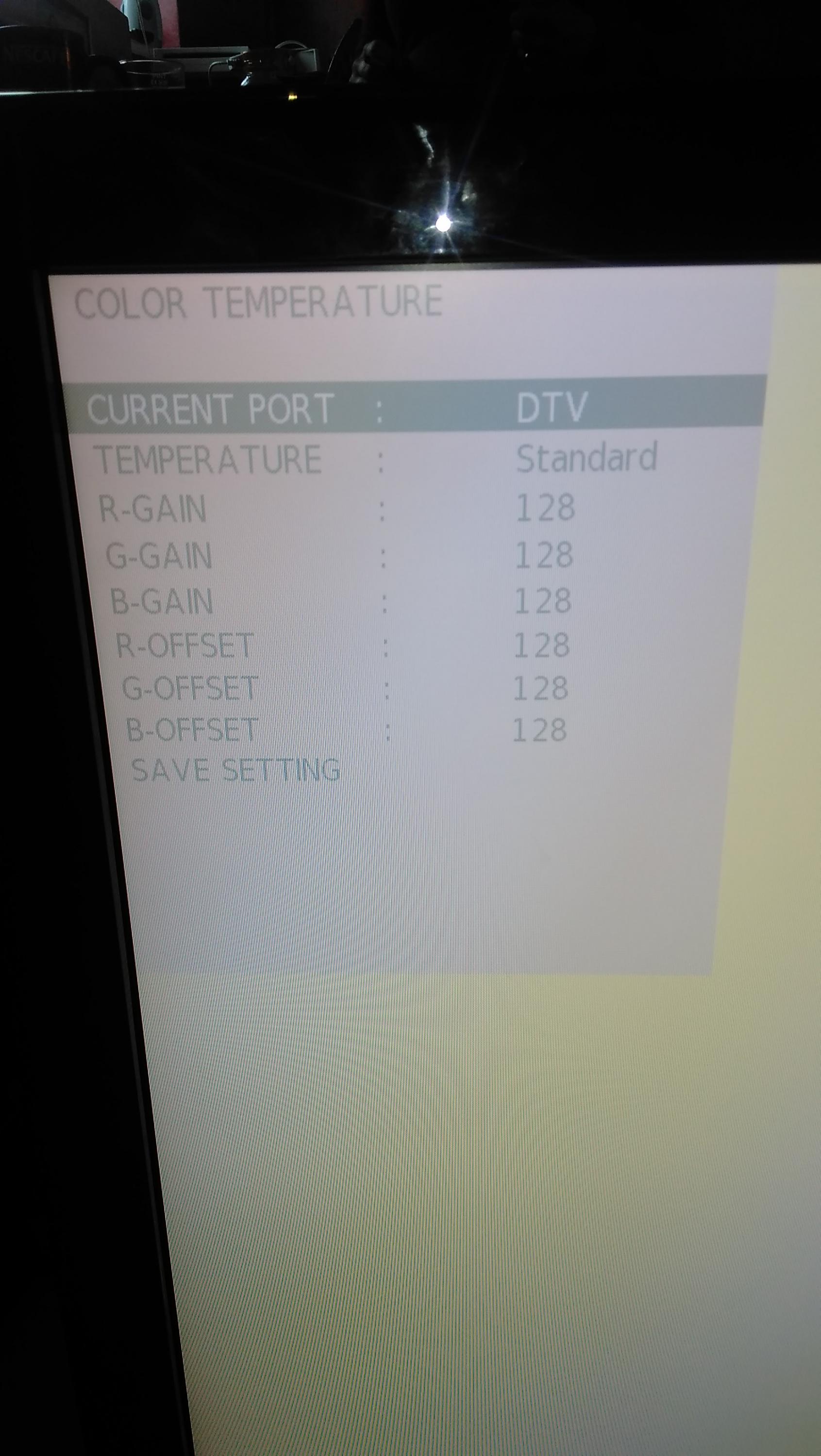

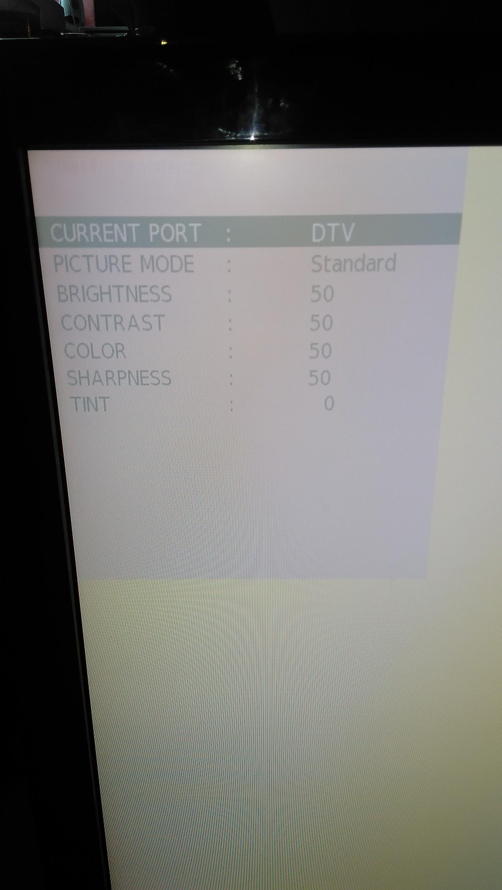

          Maybe have a play with the Lvds settings first before ordering an epprom. Also have you got an image of the service menu please ?
          • benjamin.d.bird
            • Jun 2016
            • 45
            • United Kingdom
            Re: Baird jo47.
            I e taken a picture of every menu and sub-menu

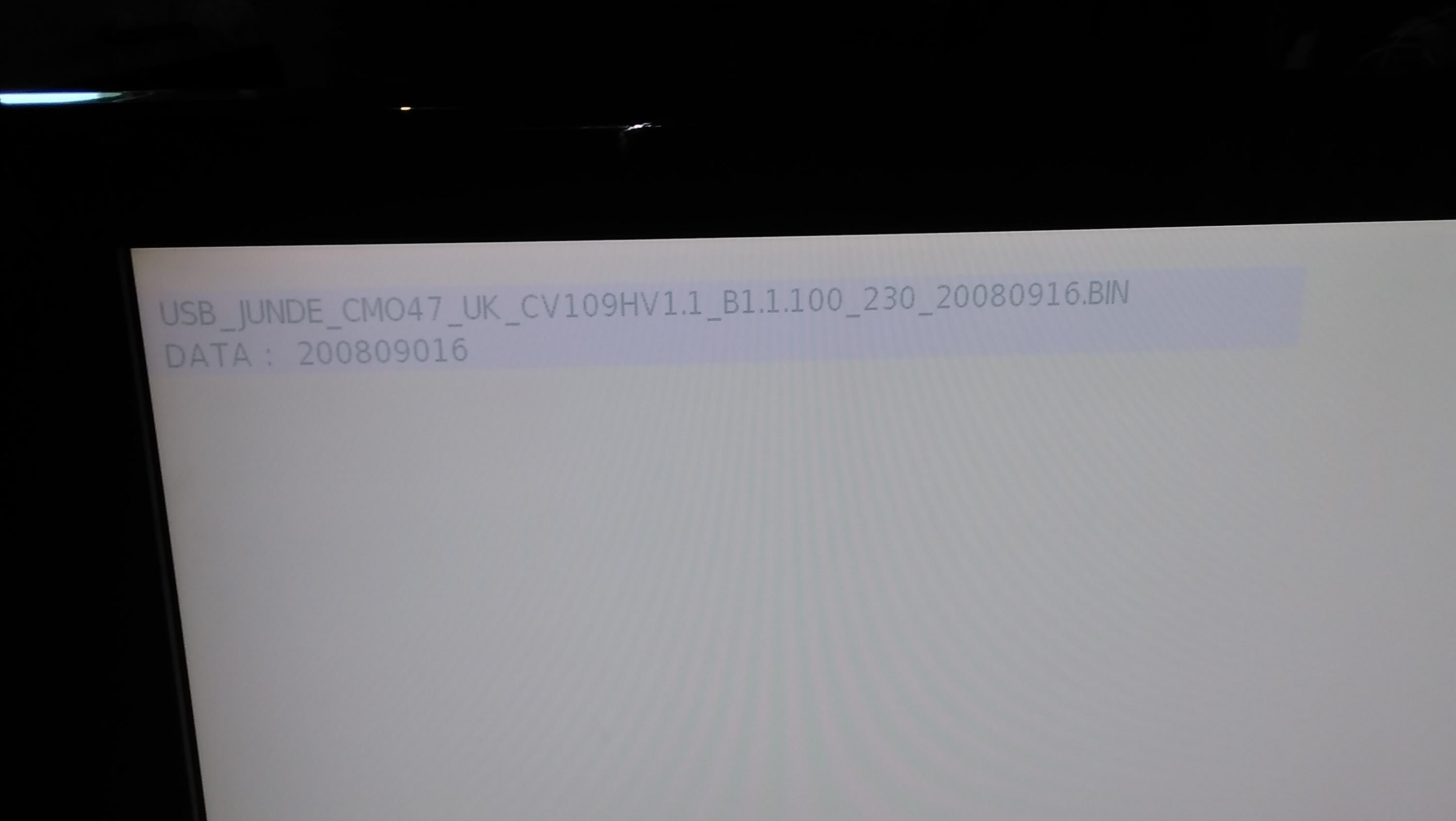

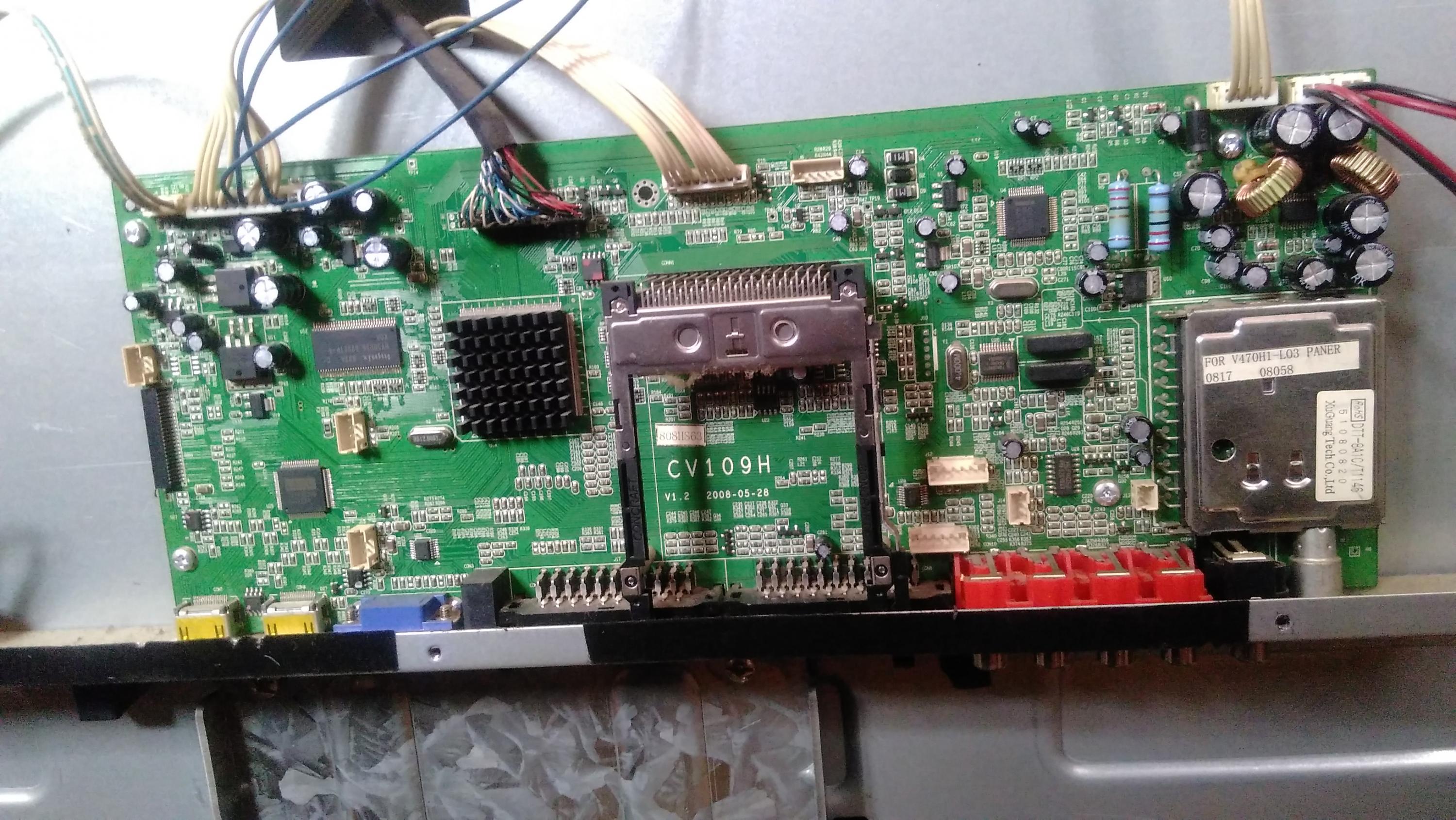

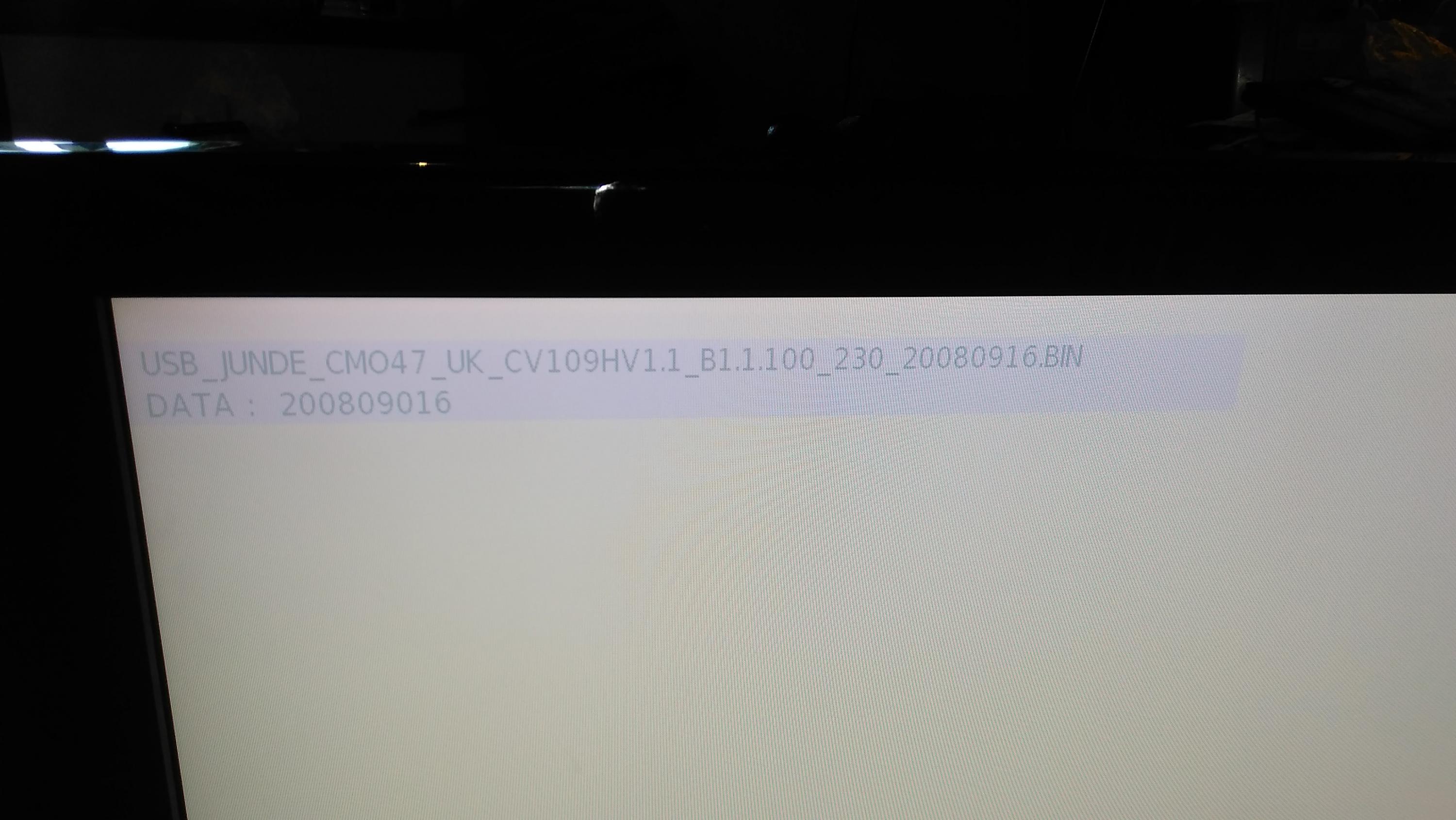

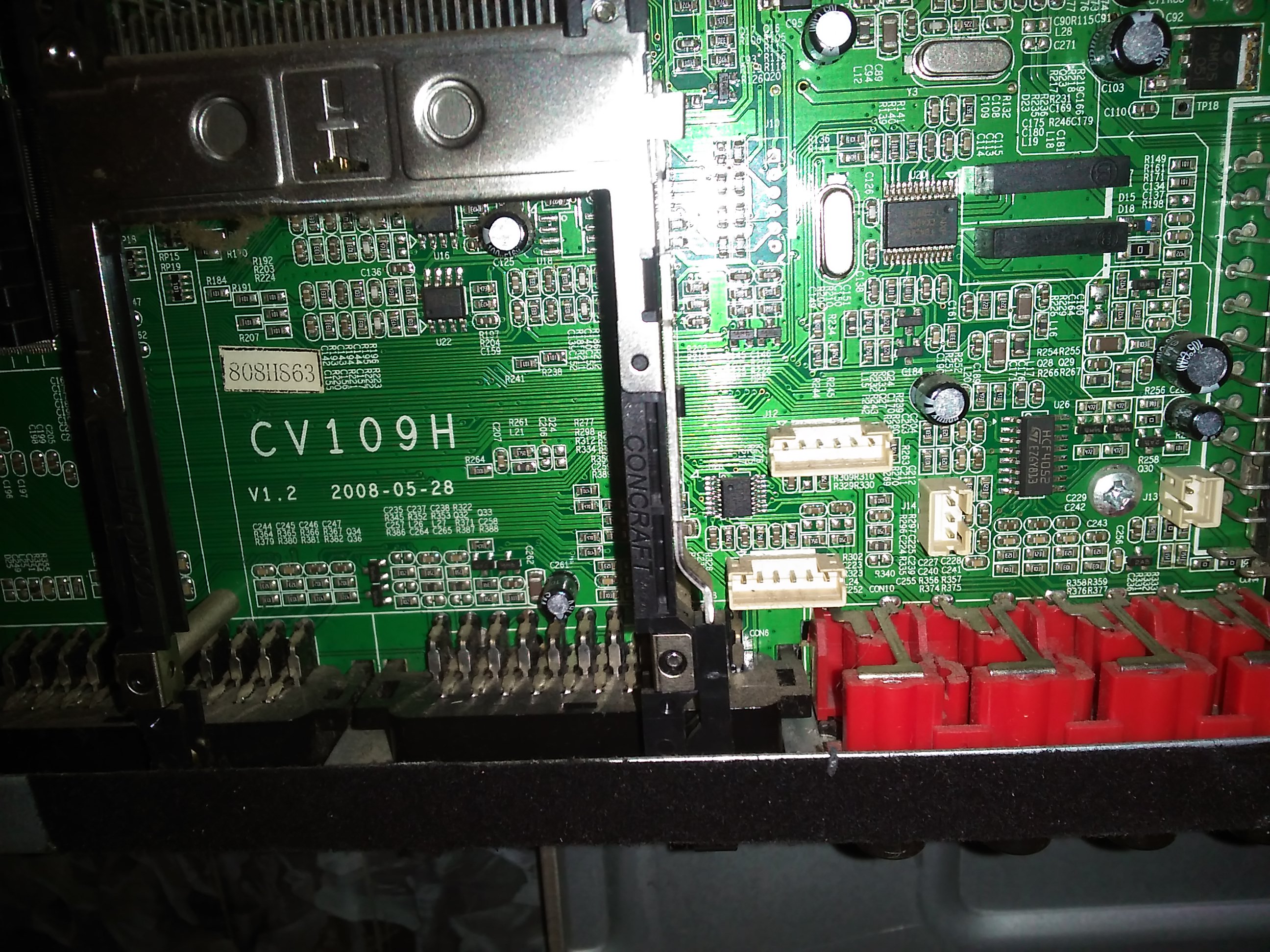

                    your link looks like that firmwares for a lg screen looking at the panel sticker in your picture its a cmo screen
                    or this from ohms supplies
                    http://www.ohmsupplies.co.uk/JO47-BA...GRAMMED-EEPROM for cmo screen only
                    please note though this may not be the issue with your tv so its up to you if you want to try it.
                    • benjamin.d.bird
                      • Jun 2016
                      • 45
                      • United Kingdom
                      Re: Baird jo47.
                      In the PIC it says cv109h v1.1 where mine is a v1.2, would that make a great difference
                      • vinceroger69
                        • Mar 2012
                        • 6714
                        • uk
                        Re: Baird jo47.
                        im not 100% sure maybe send them a email and ask they are a good company ive used them a few times.
                        but just too be clear the eeprom may not be the issue with your set so its up to you if you want too go down this route and try it.

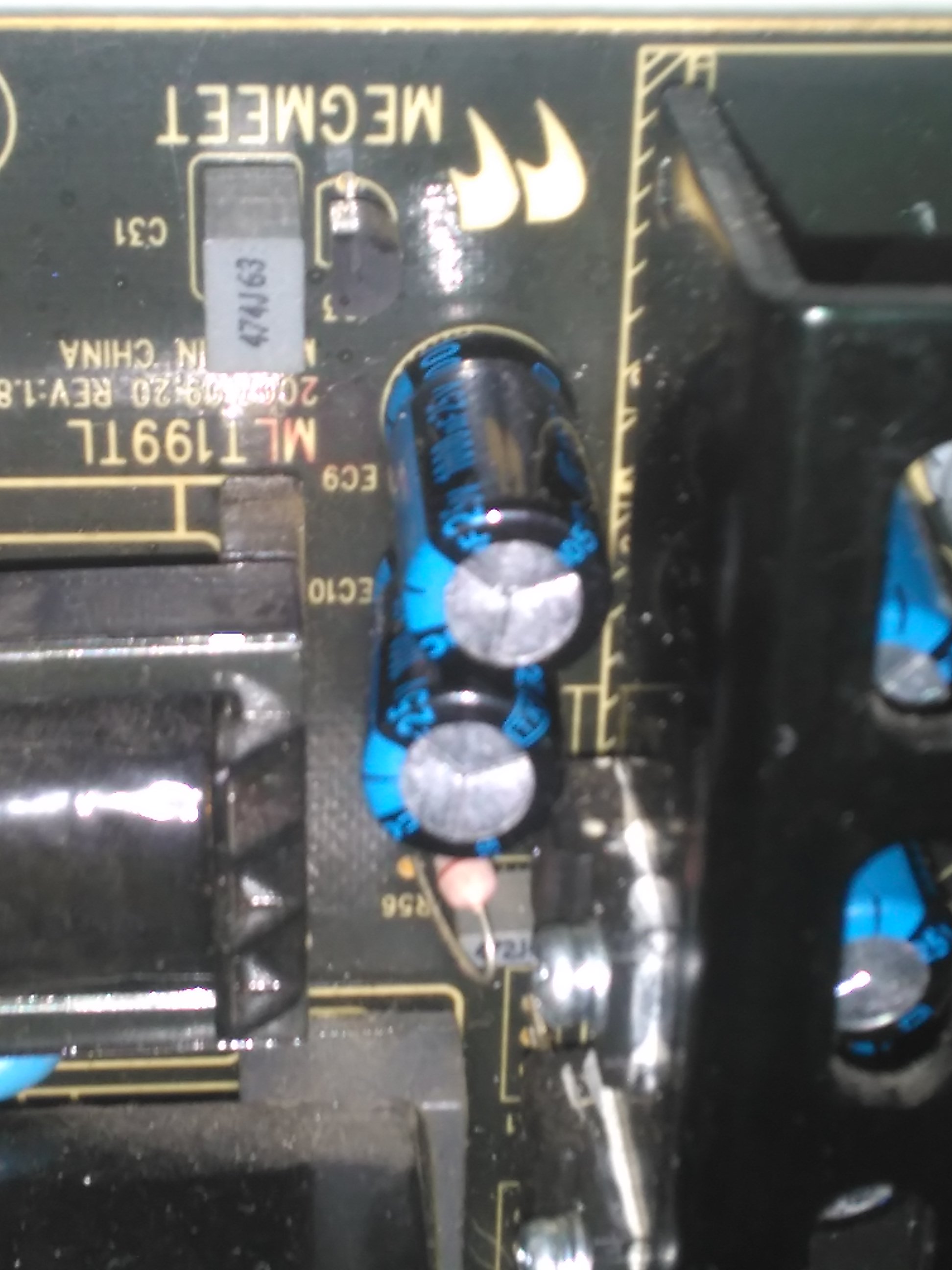

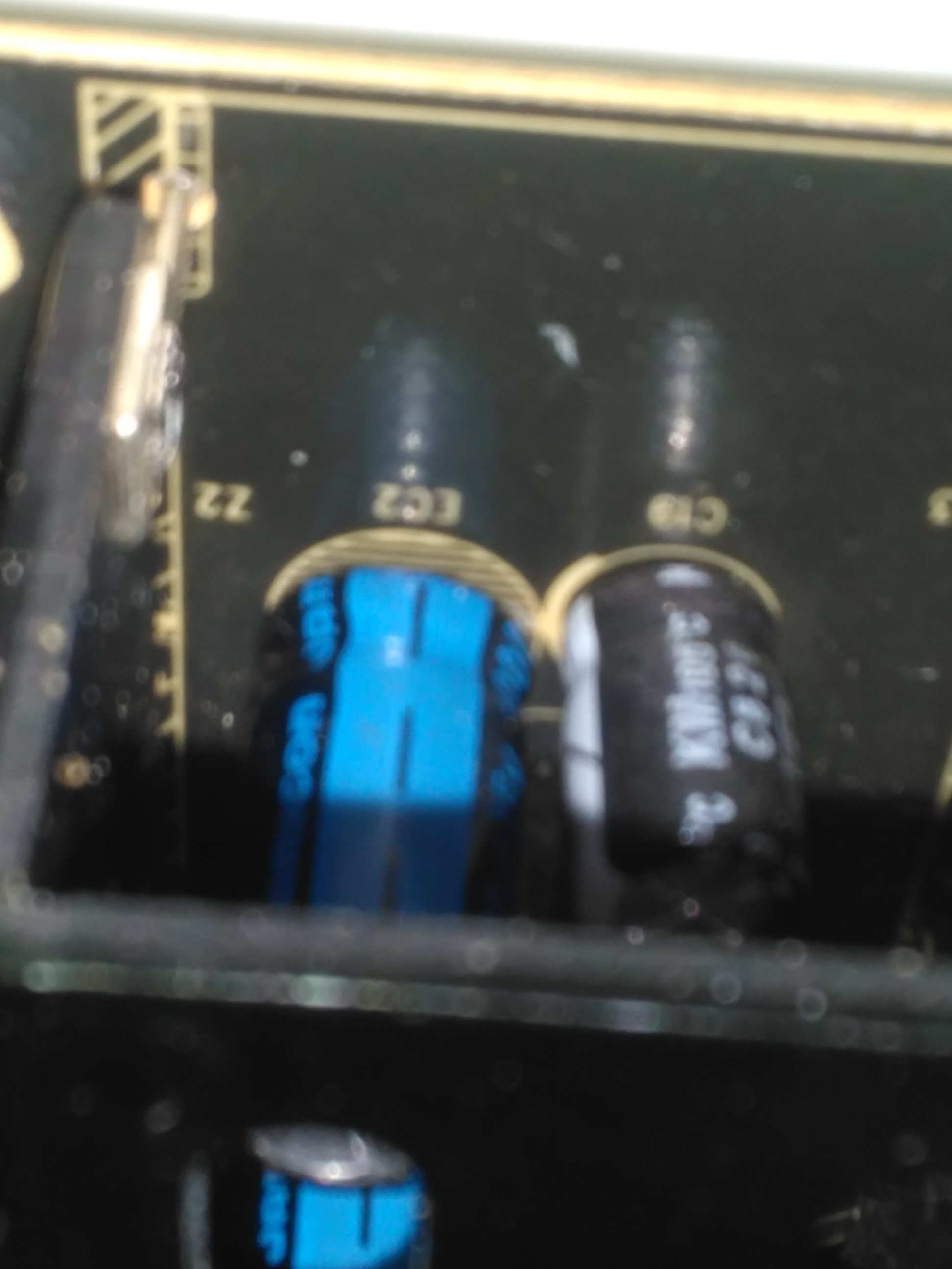

                              i just wounder you had replaced 5 caps where they are ? and you didn't mentioned on VDC reading did you measure them if they are fit enough to support the main boards video process ??
                              • benjamin.d.bird
                                • Jun 2016
                                • 45
                                • United Kingdom
                                Re: Baird jo47.
                                I attach a photo of the caps that I have replaced, the two that are together (ec9 & ec10) had obviously gone, the other 3 (being ea3, ec2, & ln2)

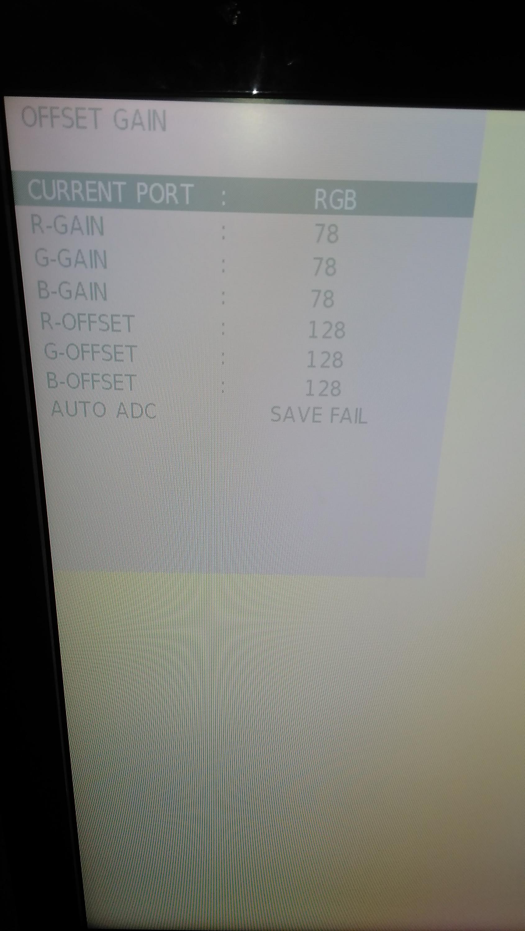

                                • benjamin.d.bird
                                  • Jun 2016
                                  • 45
                                  • United Kingdom
                                  Re: Baird jo47.
                                  Reece do you have any idea what the settings should be?
                                  • ReeceyBurger123
                                    Never Give Up !
                                    • May 2014
                                    • 7325
                                    • Britain
                                    Re: Baird jo47.

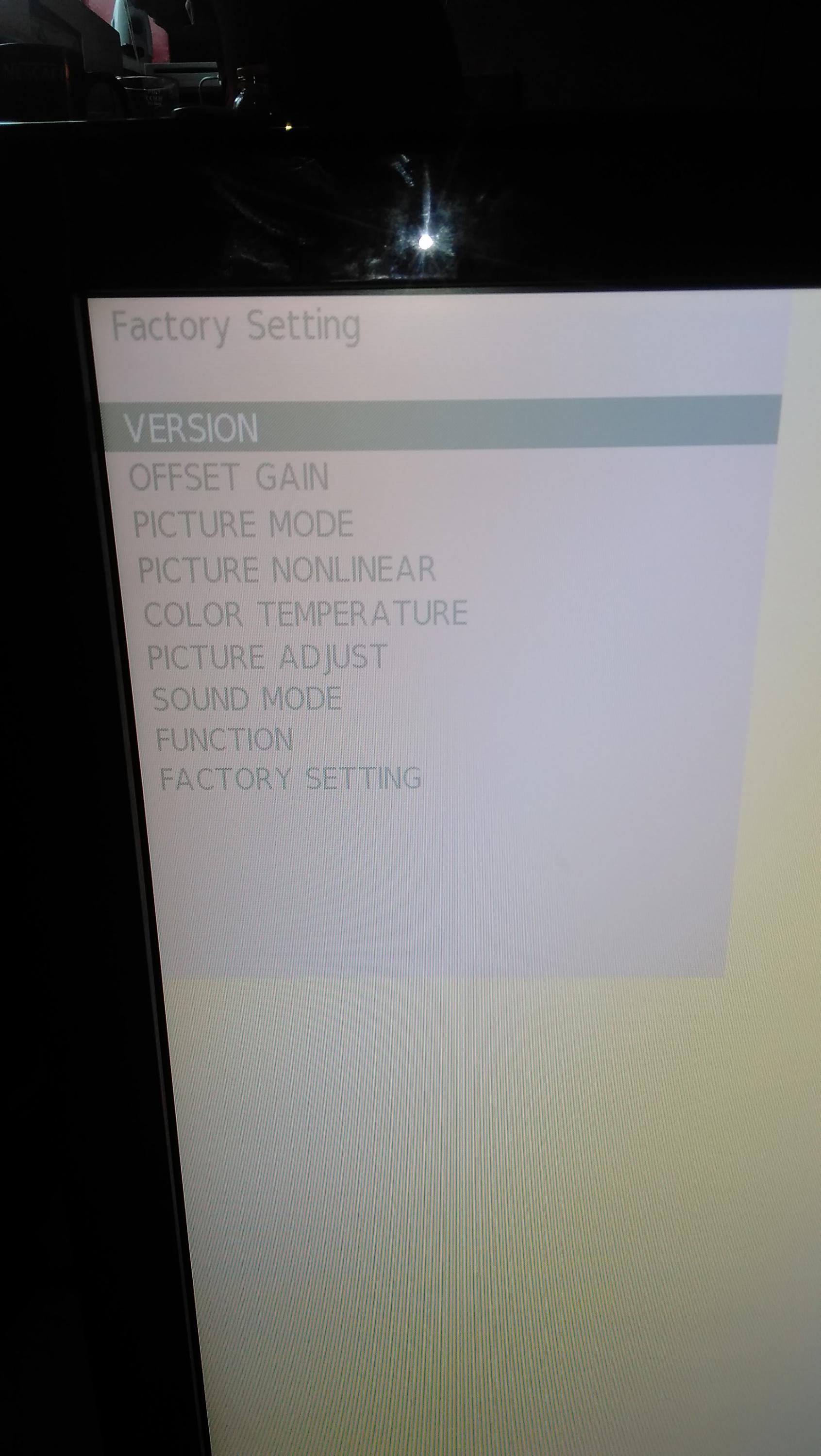

                                    Sorry I cant open the picture of the service menu ? Same board as mine so you might not have done it right. Also the Psu is fine its the mb for sure.
                                    • benjamin.d.bird
                                      • Jun 2016
                                      • 45
                                      • United Kingdom
                                      Re: Baird jo47.
                                      I've re uploaded them
                                      • ReeceyBurger123
                                        Never Give Up !
                                        • May 2014
                                        • 7325
                                        • Britain
                                        Re: Baird jo47.
                                        Go into factory setting if I remember the reset option is there.
