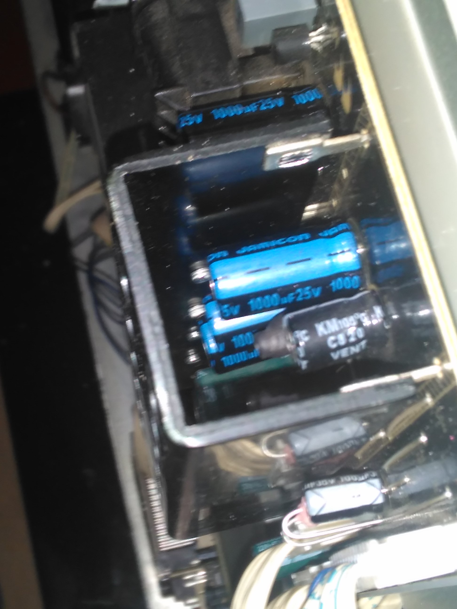

Baird jo47.
  • vinceroger69
    replied
    Re: Baird jo47.
    Im not sure what your next steps are then i guess either find another main board really cheap that matches your panel make etc or try a eeprom change but theres no gaurantee i guess its either of them i wonder if it could be a lcd panel issue? i just dont want you wasting your money on parts that may not be at fault.
    Leave a comment:
  • benjamin.d.bird
    replied
    Re: Baird jo47.
    Just asks for confirmation then powers down, when I power it up again same scenario
    Leave a comment:
  • vinceroger69
    replied
    Re: Baird jo47.
    no idea too be honest have you gone into shipping mode and looked whats available in that sub menu
    Leave a comment:
  • benjamin.d.bird
    replied
    Re: Baird jo47.
    Any idea on the procedure
    Leave a comment:
  • vinceroger69
    replied
    Re: Baird jo47.
    Maybe it is shipping mode? im sure ive read something about this doing a reset.
    Leave a comment:
  • benjamin.d.bird
    replied
    Re: Baird jo47.
    The only settings in the factory settings sub menu are shipping mode, aging, factory channel and ssc adjust. Cannot find reset anywhere
    Leave a comment:
  • ReeceyBurger123
    replied
    Re: Baird jo47.
    Go into factory setting if I remember the reset option is there.
    Leave a comment:
  • benjamin.d.bird
    replied
    Re: Baird jo47.
    I've re uploaded them
    Leave a comment:
  • ReeceyBurger123
    replied
    Re: Baird jo47.
    Sorry I cant open the picture of the service menu ? Same board as mine so you might not have done it right. Also the Psu is fine its the mb for sure.
    Leave a comment:
  • benjamin.d.bird
    replied
    Re: Baird jo47.
    Reece do you have any idea what the settings should be?
    Leave a comment:
  • benjamin.d.bird
    replied
    Re: Baird jo47.
    I attach a photo of the caps that I have replaced, the two that are together (ec9 & ec10) had obviously gone, the other 3 (being ea3, ec2, & ln2)
    Leave a comment:
  • Diah
    replied
    Re: Baird jo47.
    i just wounder you had replaced 5 caps where they are ? and you didn't mentioned on VDC reading did you measure them if they are fit enough to support the main boards video process ??
    Leave a comment:
  • vinceroger69
    replied
    Re: Baird jo47.
    im not sure myself lets see what the others think a factory reset may of sorted it but i cant find any information regarding this starting with the basics do all of the power supply voltages test ok etc.
    Leave a comment:
  • benjamin.d.bird
    replied
    Re: Baird jo47.
    Hi Vince,
    Many thanks for your advice, I'll leave the replacement eeprom on the back burner for now.
    As for my next step...... I'm totally lost, where would you suggest that I go from here?
    Regards
    Ben
    Leave a comment:
  • vinceroger69
    replied
    Re: Baird jo47.
    Originally posted by benjamin.d.bird
    In the PIC it says cv109h v1.1 where mine is a v1.2, would that make a great difference
    im not 100% sure maybe send them a email and ask they are a good company ive used them a few times.
    but just too be clear the eeprom may not be the issue with your set so its up to you if you want too go down this route and try it.
    Leave a comment:
  • benjamin.d.bird
    replied
    Re: Baird jo47.
    In the PIC it says cv109h v1.1 where mine is a v1.2, would that make a great difference
    Leave a comment:
  • vinceroger69
    replied
    Re: Baird jo47.
    your link looks like that firmwares for a lg screen looking at the panel sticker in your picture its a cmo screen
    or this from ohms supplies
    http://www.ohmsupplies.co.uk/JO47-BA...GRAMMED-EEPROM for cmo screen only
    please note though this may not be the issue with your tv so its up to you if you want to try it.
    Last edited by vinceroger69; 06-16-2016, 02:19 PM.
    Leave a comment:
  • ReeceyBurger123
    replied
    Re: Baird jo47.
    i wonder if this is a gamma ic problem? i know reece had one a while ago on a 47 in set although was a diffrent baird model number so maybe newer.
    Thats the thread I linked, turns out it was the firmware lol
    Leave a comment:
  • benjamin.d.bird
    replied
    Re: Baird jo47.
    For some reason the attachment didn't upload
    Leave a comment:
  • vinceroger69
    replied
    Re: Baird jo47.
    i wonder if this is a gamma ic problem? i know reece had one a while ago on a 47 in set although was a diffrent baird model number so maybe newer.
    Leave a comment:
  • tvguy12012012120
    by tvguy12012012120
    02-07-2025, 05:13 PM
  • ngml
    Repair of an LG split AC system indoor unit PCB
    by ngml
    I am trying to repair an LG split AC indoor unit, which does not start and gives a CH05 error code.
    This indicates an error in the communication between the outdoor and the indoor unit.
    The outdoor unit is fine, so the problem is the indoor PCB.
    The indoor unit is an LG PC09SQ NSJ (3SNM09JA2FA), and the PCB has the following type number: EAX35907219-1.2 (see photo1)
    I changed optocouplers ICO1X & ICO2X and the NPN transistor S9013 which drives optocoupler ICO2X (see photo2), but this did not remedy the fault.
    Does anybody have the schematics of this board,...
    02-01-2025, 12:55 PM
  • fharris1977
    Vizio D50u-D1 Dead Set No Standby
    by fharris1977
    Hi. I got a Vizio with no power or standby, and won't turn on with remote or button. I checked the voltages on the connector and all read 0.00V or nearly 0(0.050 ON/OFF pin). None of the pins are labeled STB for standby although I do see some 5V pins. Other than the obvious standby led, which isn't coming on, is there a way to check for standby voltage on this PS. I'm trying to see if my problem is the PS or mainboard. Some Vizios I have fixed with no standby led me to think it was the PS but it turned out being the mainboard. Any experience with this set would be greatly appreciated.
    12-28-2023, 10:25 AM
  • Crystaleyes
    Samsung BN44-00259A standby question
    by Crystaleyes
    Hi all.
    I started a thread while back regarding TV power supply standby circuitry as it is something I am not quite on top of.
    SMPS theory and function is becoming more familiar, however the standby part is still a bit of a mystery.
    Anyway, a friend has this TV with the above mentioned power supply board which has no standby voltage, nor any other voltages leaving the board.
    The mains AC comes in fine, gets filtered and rectified with power is on the main filter cap as well as the transformer and drain pins of the ICE3B0665J, but that's it.
    08-11-2023, 05:15 AM
  • CoinCoin88
    Garage door RX unit (Cardin S38C) does not short relay to send opening signal
    by CoinCoin88
    I'm turning to the Badcaps community to help me troubleshoot the radio Rx card from my (old) garage door opener. While I could just ditch that card and replace the whole system, I first would like to understand "why" it suddenly stopped working, because that's just how I am wired...!
    Some basics: the receiver works on a 30.875 Mhz frequency. Yes, I'm aware this is not in use anymore in a looot of places. It does not use any rolling code, it's just a regular dip-switch code that you have to set up on both the receiver and transmitter. The receiver...
    09-15-2025, 03:36 AM
