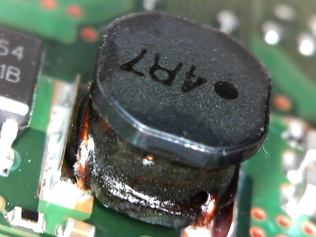

    I was lead to believe the COXA (or on my ZG stamped board COTA 18) transistor is one of the main, if sometimes the only component to go out on these things. Further investigating it looks like this SMD labeled 4R7 is burnt?
    Without getting the new board in i cant compare, but does this look normal to anyone?

    That's a 4.7uH inductor, probably for a voltage converter circuit. Where are you seeing burning? The windings are secured with a varnish. It would take a lot of current, probably more than can be supplied, to burn this device.

      That was my other guess, that it was some kind of varnish or glue. It just looked burnt to me.
      I was hoping to repair the board by just replacing that COTA transistor but if this chip were burnt then I didn't order everything I need. Thank you for your help!

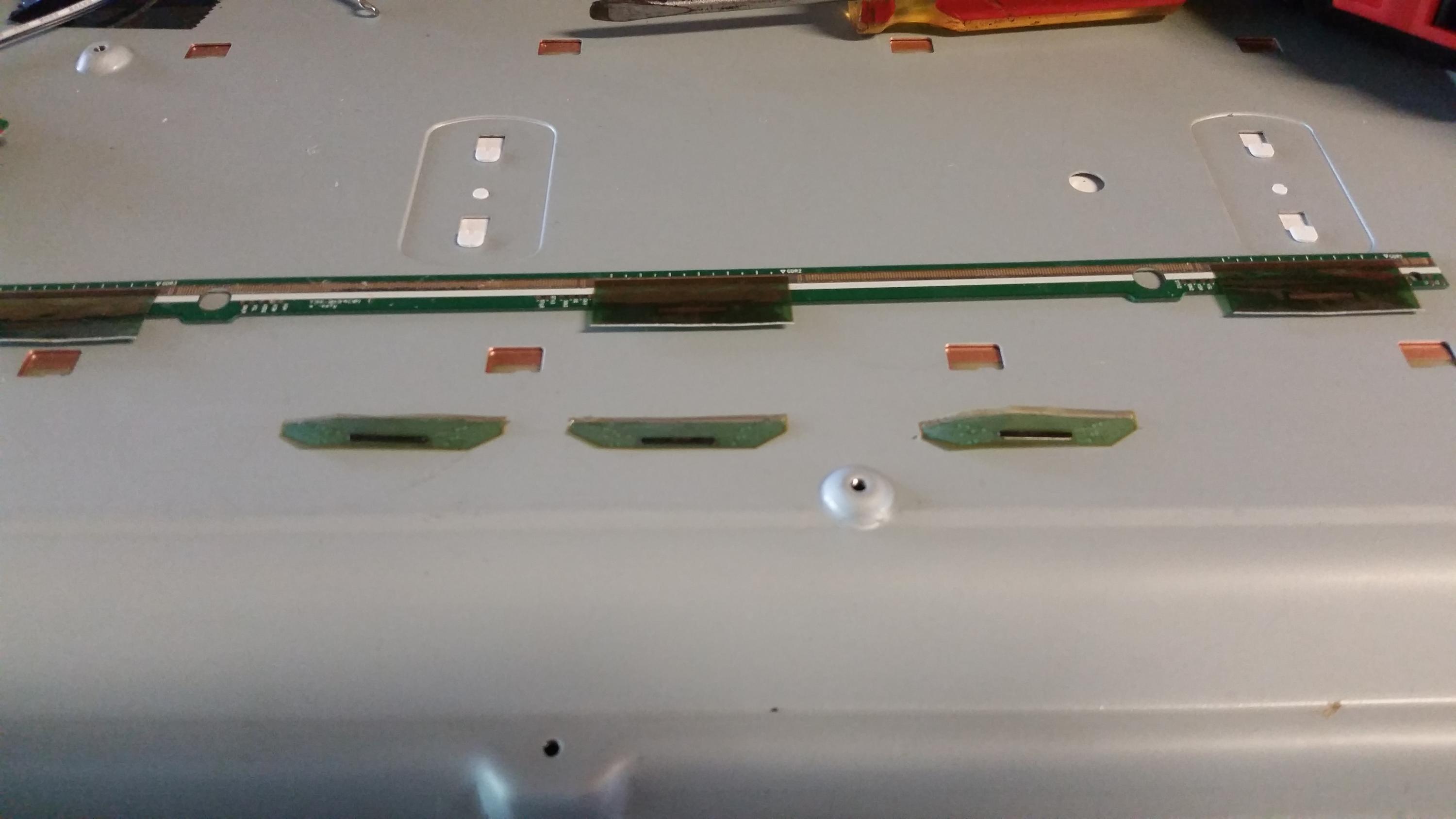

                  U can do it removed.....this tabs aren't the same as the 70 because they used boards.....I did a job on a sony kdl60ex645 and each time I added a new t Con the screen burn the coxa transistor so what I did I inspection the side drivers which they are much smaller than the 70 vizio or sharp....one of those smaller ic tab are bonded to the screen I peel the bad side off....how I did know it was the bad side ..one of the ic tab got to hot that were it used to laid down was plastic and for that it melted so rigth away I did know that's was the bad side...since I inspection the other side and no signs of burns or melted plastic......I'll pos pics later today

                      Yes that am sure I have the kdl60ex645 and this set have sharp as well the 70s tvs but of course they have diferent ic drivers the 60inch it is bit smaller and the 70 have a board which u removed everything with tab and the strap board that is connected to the ic tabs and also connected on the corner with white flex this is on the 70 tv.... ajsterr4 add some pic of what u doing

                        Here an example of 2 diferent types of ic drivers...one with strap board with tabs and the other are single ic drivers....this single ic driver some lcd or led tvs from 32 to 42 some am not saying all they just have 3 side drivers ic... some 42 to 60 have 6 side drivers and sharp is one if them, that it has 6ic tabs on 60inch tvs...the 70inch vizio and sharp have the strap board with the tabs as shown in the pic......in this case post pictures of your work. So it can be more understandable...thank hope u get it fixed

                          that explains where the "other end" of the tabs are.... there isn't one. :-)
                          It looks like they are just "daisy chained" without boards.
