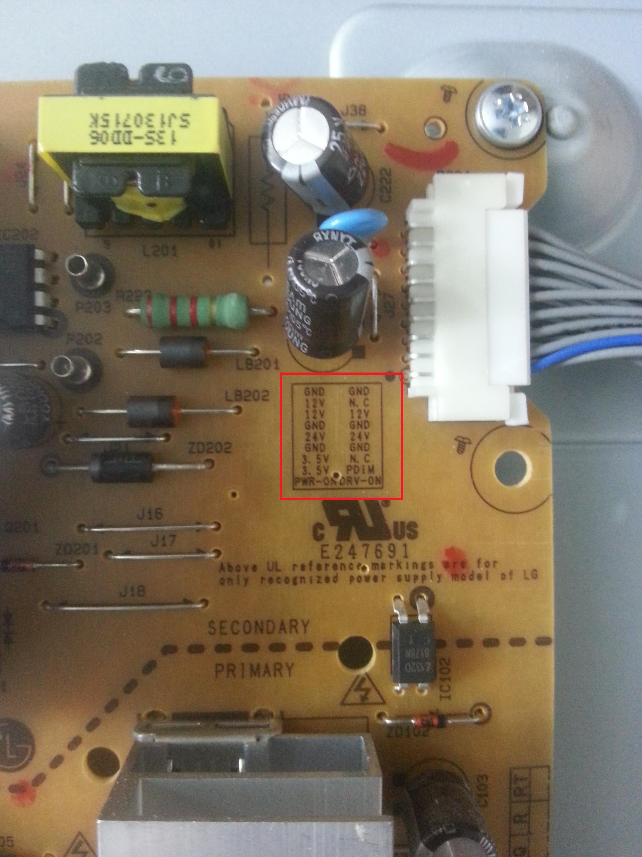

          I've fitted the cap but i'm still getting the enable voltage fluctuating and too low.
          I'm missing something...

                  Re: LG 42LN5400 no standby.
                  What voltages are you measuring with everything connected and powered up as shown in the box???
                    Also what voltages do you have at the various pins as shown in the attachment. You also need to make sure that the chain of resistors attached to pin 4 are exactly as they should be.

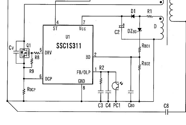

                      There are no voltages present on that connector with everything connected
                      With just the PSU receiving power the voltages on the SSC1S311 are
                      1) 316mv
                      2) 0v
                      3) NC
                      4) 266v
                      5) 0v
                      6) 0v
                      7) 11-14v fluctuating
                      8) 0v
                      I do find 2.5v on Q802 though, I wonder if this is a low standby voltage ?
                        OK so no secondary voltages.
                        Resistances leading to Pin 4 all checked ?
                        IC Pin4 nice high voltage but don't know if its's what is should be
                        Suggest you change the IC.
                          #32
                          Did you find and replace the start up cap that is connected to the VCC pin? You are sure that it is C103?
                          Per spec of the IC, the Vstart (Vs) is between 18~24V, 21V typ.
                          I suspect the IC as well, but you should also check the rectifer in the secondary side to make sure they are not shorted.
                            Thank you, I appreciate the help.
                            Yes, pulled the legs on all of the resistors and diodes to check.
                            Is the startup cap C108 ? 0.1uF 50v ? It's a tiny ceramic cap i have no way of measuring.
                            Could you help me identify the rectifier on the secondary side please.
                              #34
                              OK, you have the diagram, I wish we get to see that from the beginning.
                              C103 is the startup/running cap.
                              Per diagram: Rectifiers in the secondary cold side are D201 (for standby +B24 which feeds the switched 24V) , D204 (for standby 85V DD), D203 and D205 for the 3.5V STBY.
                                start testing D201, D203, D204, D205 to start with. Have you checked C103, D102, D103, ZD103, Where did the schematic appear from?
