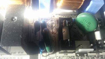

        I did found a fuse with a crack on it.
        • dick_barton
          • Aug 2015
          • 6643
          • Wales
          Re: vizio vp50 hdtv20a black screen but sound works
          Ceramic fuses don't generally crack. I've see glass fuses vapourise. I would remove the fuse and check that there's no short circuit before replacing it.
          There's no photo's so I don't know where this fuse is in relation to your set.

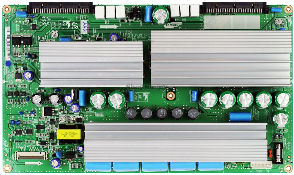

                  Is this the board? samsung panel?
                  As far as I'm aware, the lit LED on the ymain indicates a fault.
                  This series is well known for blowing the upper y board and usually takes the ymain with it.
                  you could probe the FETs for short cct. the 88N30W are common ones to short out.
                  The upper buffer often you'll find a pin hole or burn. But you may have to use a meter to see if the buffer outputs are shorted.
                  I don't think you will get any image running just the lower board.
                  There should be some videos around for the buffer checks.
                  Not sure how obtainable those ybuffers are. They were hard to get about 4-5 years ago.
