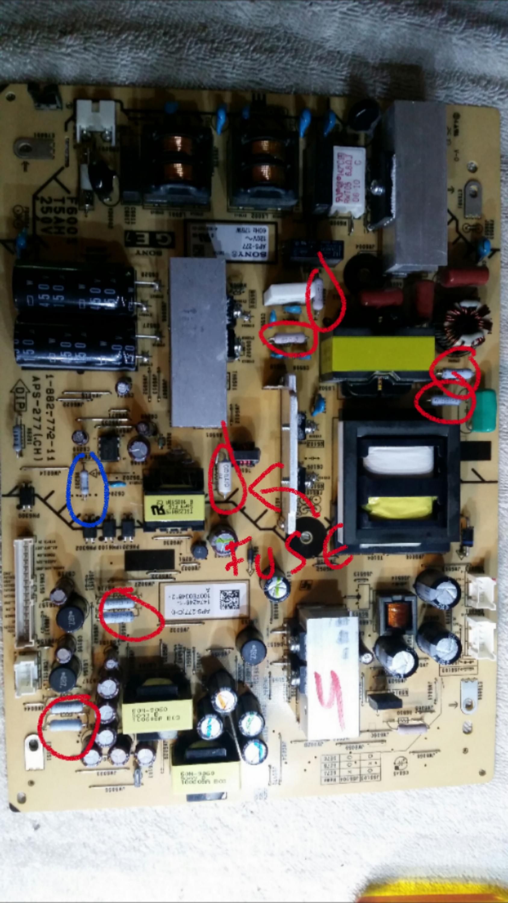

Sony google tv nsx-40gt1 3 red ligth blinks
  • hmendez86
    • Jun 2015
    • 344
    • united states
    THIS IS A GOOGLE TV THEIR ARE BIT RARE TVS. WHAT IT DOES I CONNECTED TO AC AND CLICKS 3 TIMES LIKE TRYING TO TURN ON AND RED LIGHT COMES ON 3 BLINKS. SONY GOOGLE TV- nsx-40gt1.,,,THERE'S SOME RESISTORS THAT BEEP ON CONTINUITY...,, I THINK THEY ARE FUSE RESISTORS ONE OF THE SEVEN WONT BEEP ON CONTINUITY ANY IDEAS...

    First off:stop YELLING. Second:Pictures,we need pictures. "some resistor beeps,others don't" really doesn't say much. Pic from general back setup,one of each board and maybe a close up with arrows pointing t the mysterious resistors that beep?

      The red circles are fusible resistors and on continuity the beep even if out of circuit, don't know much about this resistors. One of them which is in the middle is a fuse I think is good beeps on continuity......the blue circle is the one won't beep even if it's out of circuit, and it's a 104j resistor....
