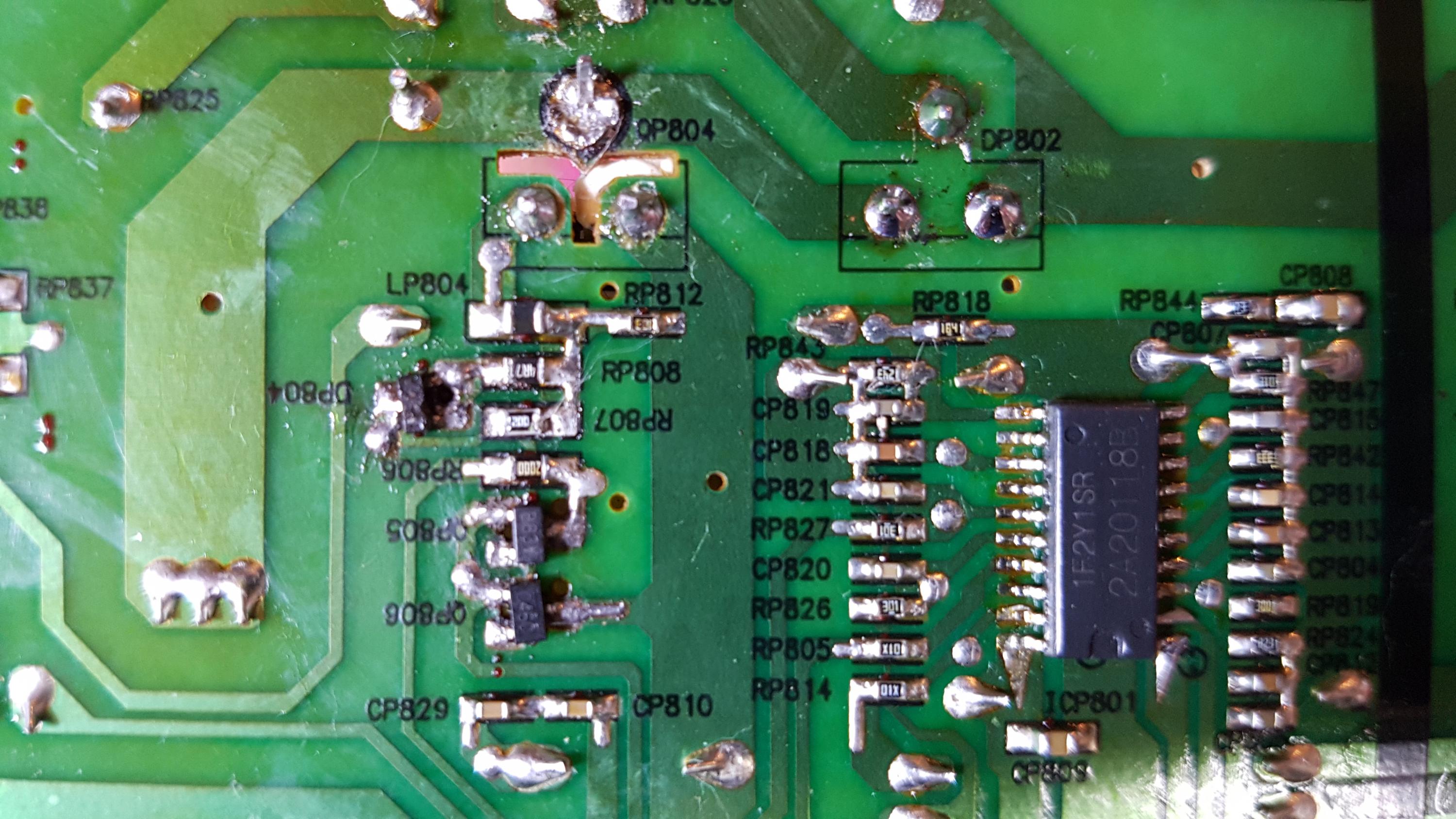

    Upon further inspection DP804 looks like the adjacent legs are bridged.
      Re: Samsung BN44-00445A failed
      That one also looks bad to you too, right? I do not know how the rest of the board is like.
      • 97Kouki
        • May 2016
        • 23
        It does but a continuity test between QP804 and each side of it should determine if my eyes are playing tricks, but it looks burnt and separated. Fixable in any case though.
        • genius312
          • May 2016
          • 23

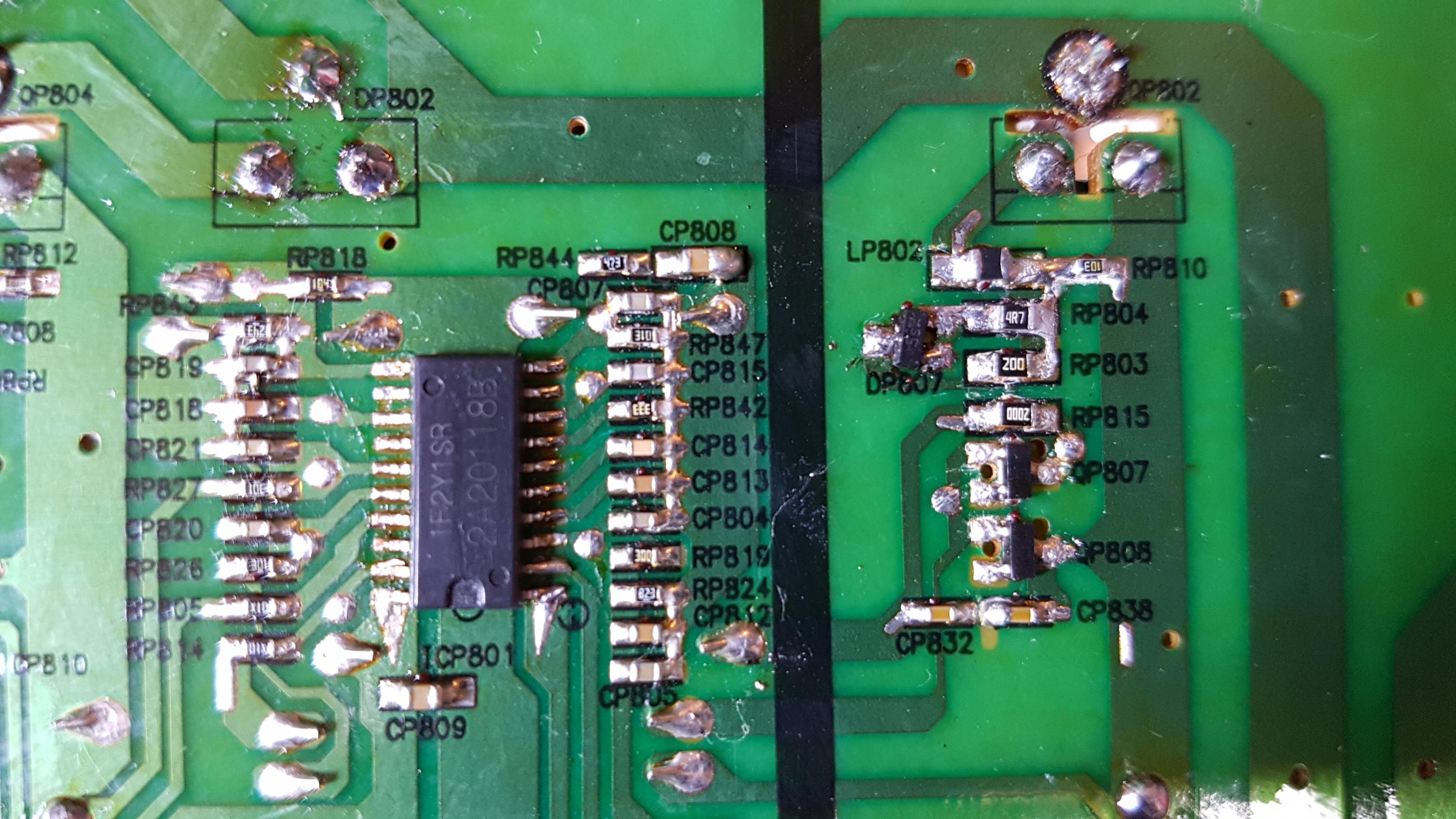

          I did a connectivity test for almost everything i soldered and it is fine.
          Only dp804...the 2 right pins seams to be on the same "network" and so are connected together.
          Here are some more pictures.
          But both qp are soldered correctly

            QP804 is driven by the ICP801 (2A20118B), you you need to find the spec sheet of that IC to get the pin out and then verify that it is getting the VCC between VCC pin and GND pin.
              I found the spec for the IC: 2A20118B
              • genius312
                • May 2016
                • 23
                I replaced that ic !
                Thank you for the spec I'll see what i get

                  Looking at the soldering on the board I believe you will have great difficulty completing a successful repair and it may be best to look for a replacement board. The smd devices are not the easiest things to solder and does take practice.

                    #29
                    The ic is perfect no ? I did replace it.
                    I know some might look horrible but the contacts are ok !
                    • genius312
                      • May 2016
                      • 23
                      #30
                      Finally 1 pin has not been soldered correctly and had no contact from the IC !
                      I resoldered this pin and the T is working
                      But the front glass cracked when I lift it from the floor so now it is completly broken !!
